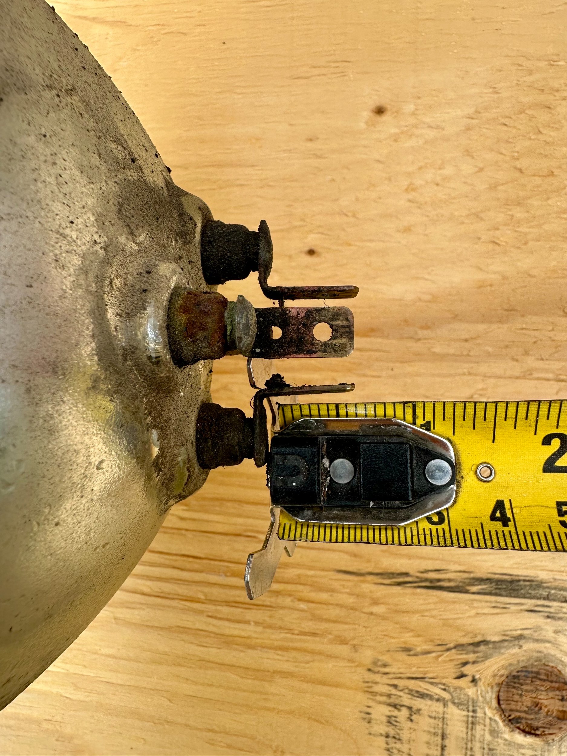

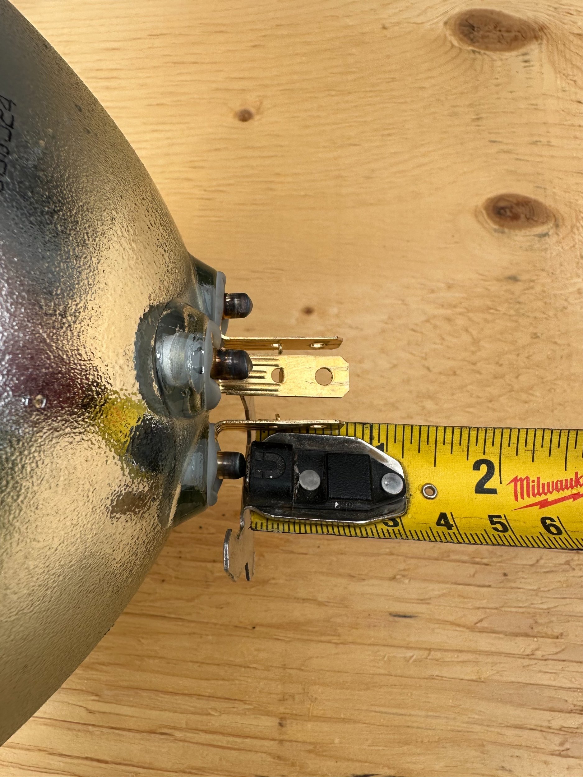

Hello! Just joined the forum. First question...
I am replacing my sealed beam headlights.
I am keeping the 1997 stock and OG! (so no LED upgrade)
The manual lists the part as H6024.
I bought the H6024 part but the "pins" are longer (3/4") on the new headlight, than the short pins (.5") on the original headlights.
The socket does not slide totally over the pins and leave 1/4" bare & exposed.
The lights work.
Would this be a problem (short circuit, moisture, corrosion, contact?)
Can I use the long pin?
Thanks,
John

It looks like the pins are actually about 3/16 longer. Cut that amount off of the new pins so they will seat fully unexposed.
