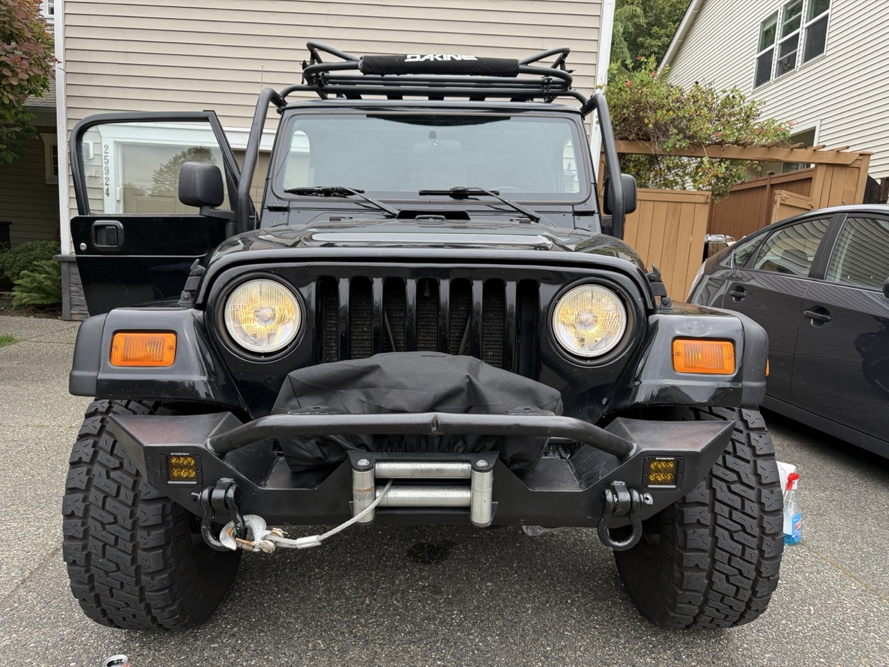

Old ones:

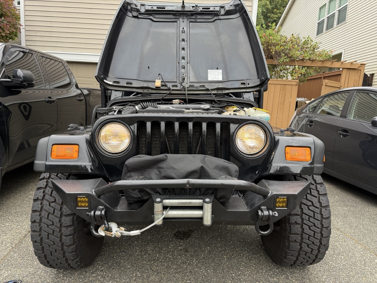

New ones. (yeah I know, you cant really see the difference here):

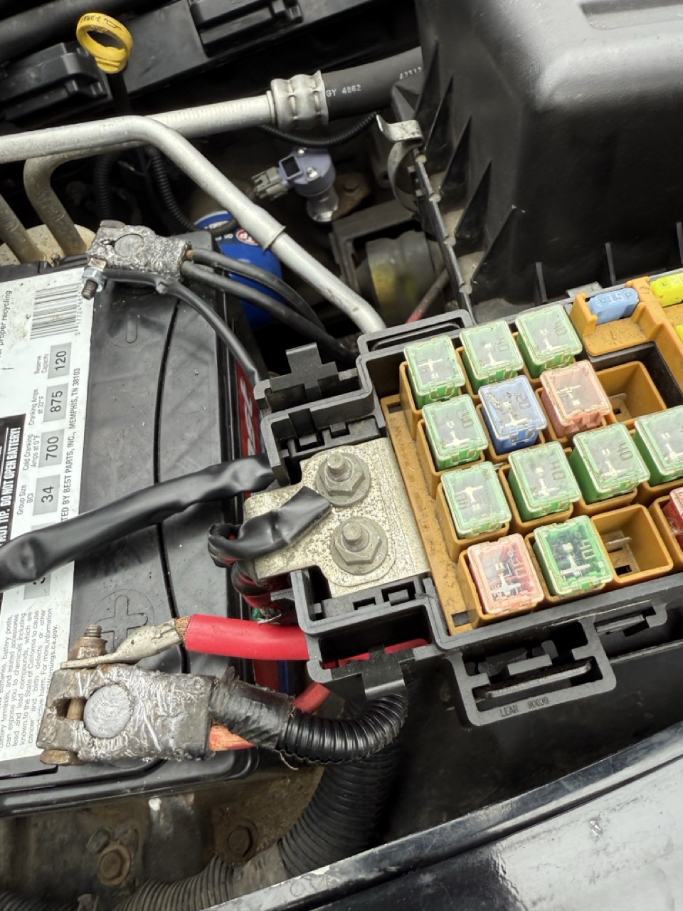

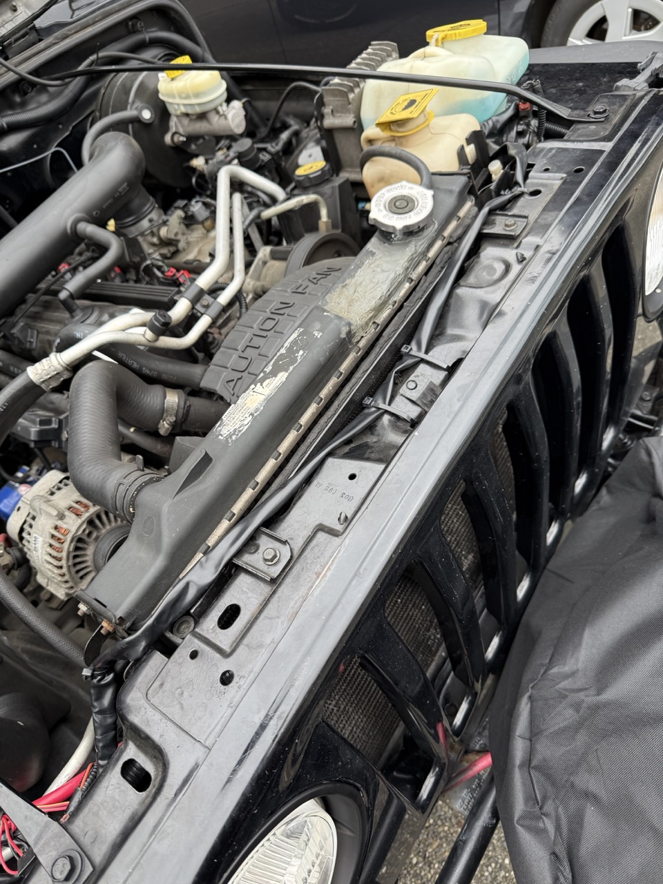

Now, here is how I hooked it all up under the hood. I was mainly concerned how to attach my harness to the battery. But that turned out alright. The positive I just attached to the relay box, and the negative straight on the the battery terminal.

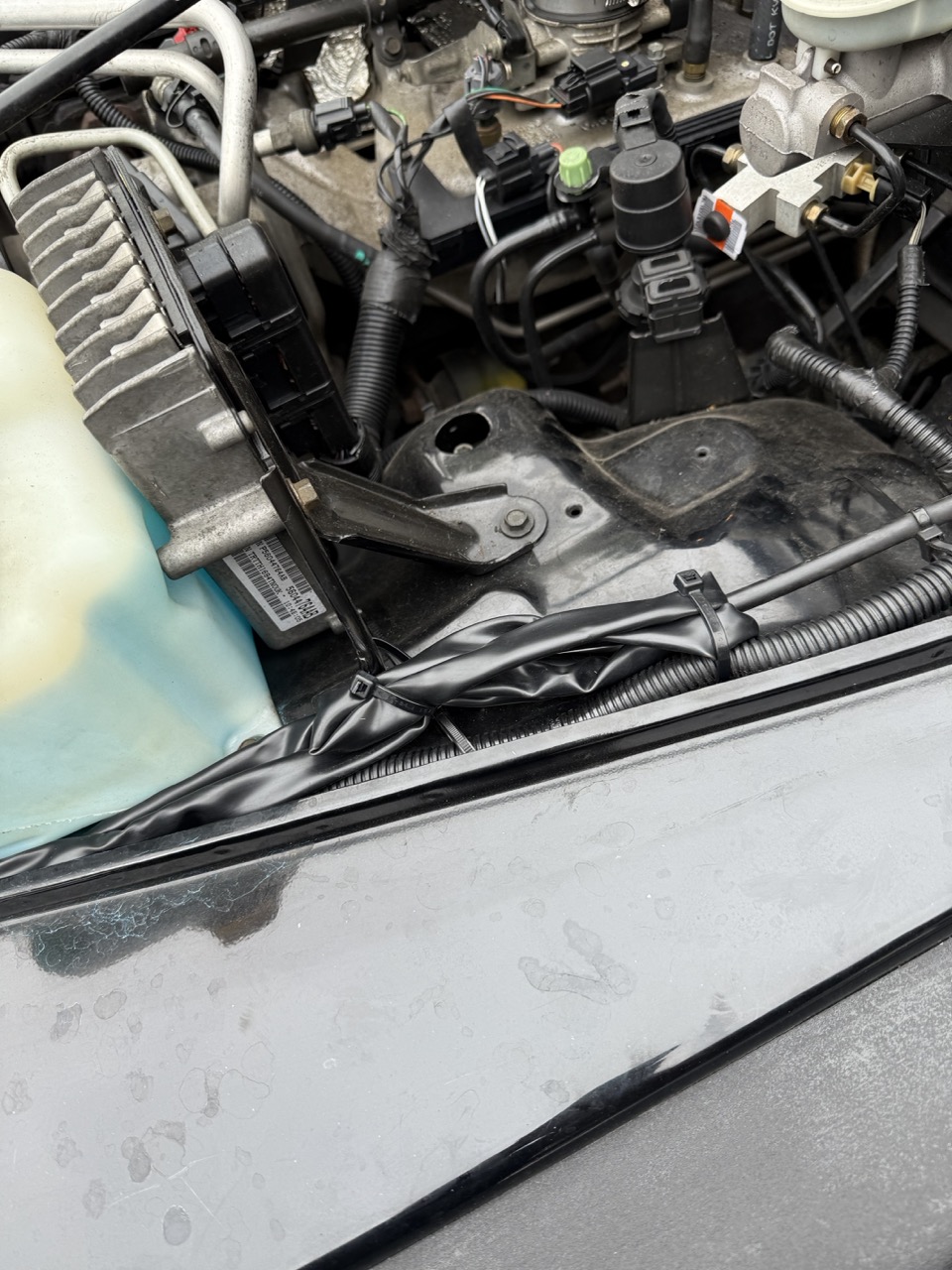

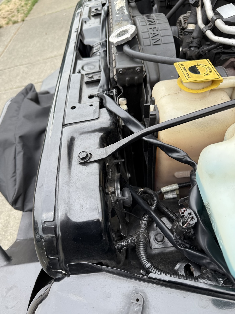

Some cable management shenanigans:

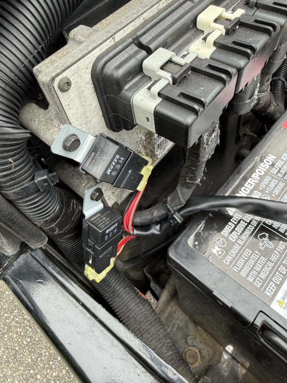

OH, here is where I attached the relays. I could not really find a better place:

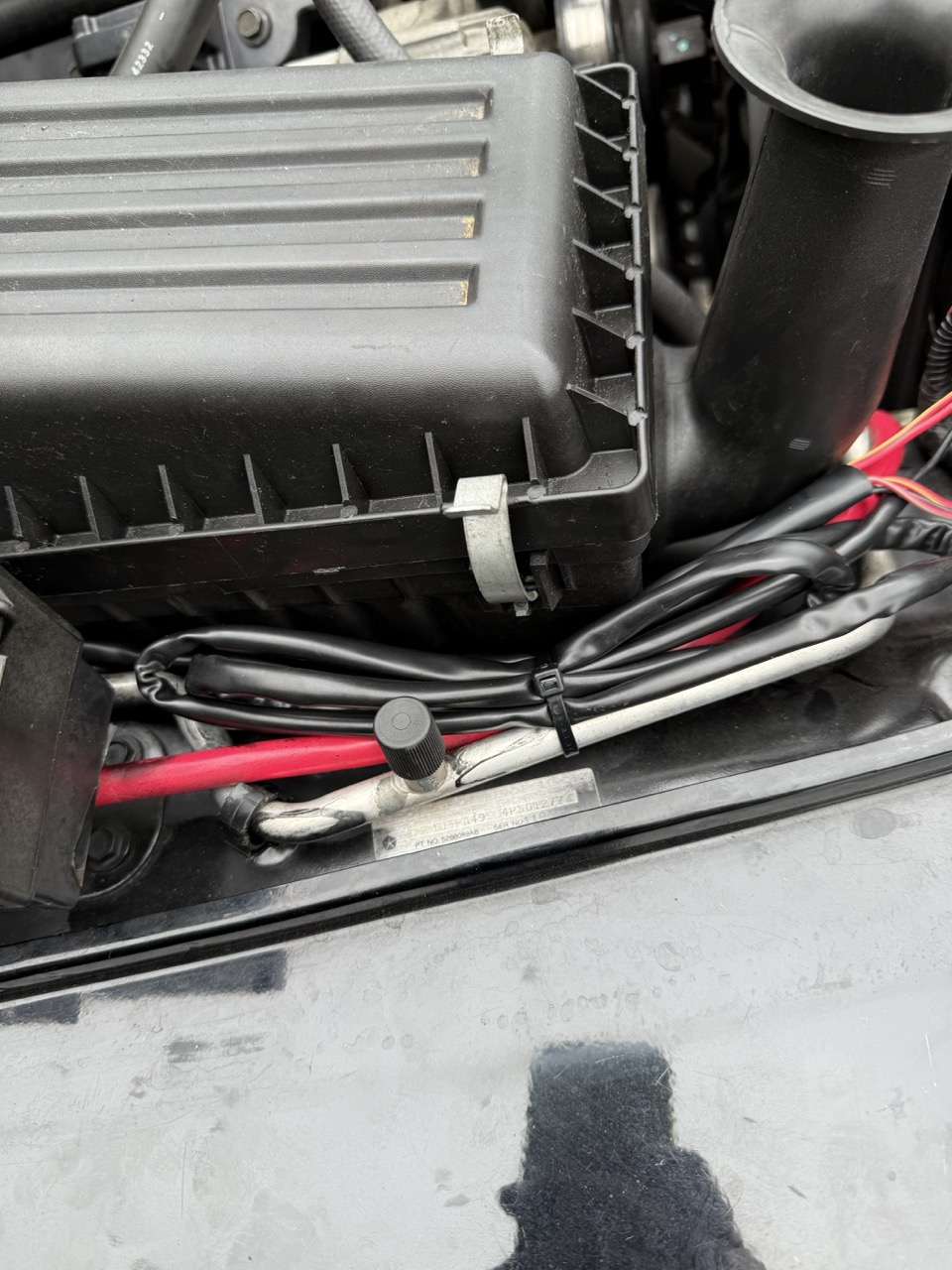

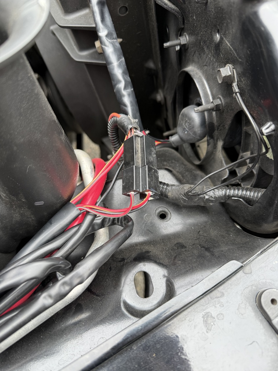

My last thing I need to figure out is how to encase the connection between the harness and the headlight connector cable:

Old ones:
