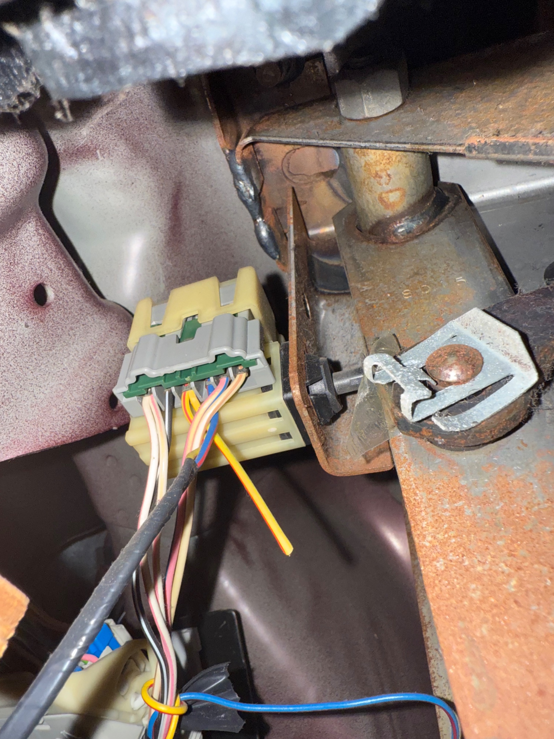

I got under the dash to interrupt the ignition start wire, and found they cut both yellow wires with a red stripe, the blue wire with a red stripe, and spliced them together on the pcm side of the harness. At this point I’m a little out of my depth - up until now a lot of YouTube and this forum and a solid history of legos had me pretty prepared to learn how to work on my jeep. At this point I really just need someone to explain this to me like I’m five. I SUSPECT this is what contributed to blowing the asd relay a month ago - I was fixing some wiring - the drl wire has been repurposed to run the ac compressor and the radiator fan that the internet says I’m supposed to have is gone, and I’m struggling to located the correct wires upstream. Unfortunately my usual job is destruction or stopping damage rather than fixing things so I’m out of my depth.
If I can I would like to repurpose the way these wires have been cut to install a momentary switch on the starter wire - but I want to ask someone smarter than me the correct way to fix this.
Trace one circuit at a time to make sense of it. 👍
One yellow and red comes from the pcm. The other appears to go to the fuse.
The blue/ red goes to the starter.
That wasn’t the issue so much as I’m having trouble making sense of this in my brain and just need a bit of help.
To be specific, I already did what you’re suggesting - as this is a hobby, I really need someone to tell me how to fix this in the best way possible - I want to put a hall switch in the starter circuit, and with all the cuts and splices made, I’m having trouble making the jump from identifying circuit and wires to the best solution possible.

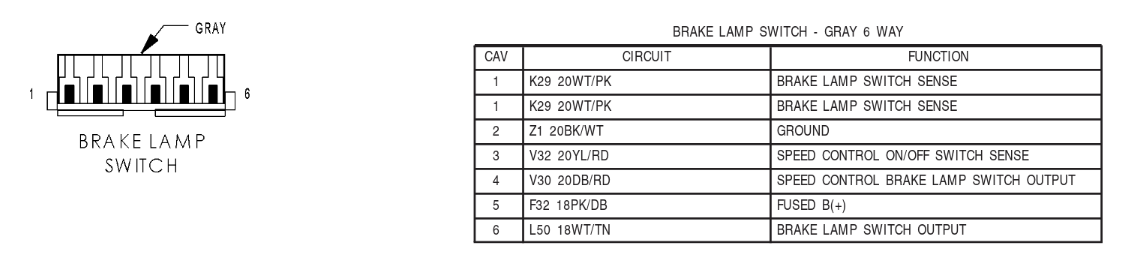

So it looks like what you're looking at there is the brake lamp switch. From the 2004 service manual:
Now...wtf is the "speed control" system? Cruise control? Is this what kills cruise control when you hit the brake pedal? Was the PO trying to hotwire it so it wouldn't do that? My Silverado has seemed to have an issue with the brake pedal prematurely turns off cruise control, maybe they were trying to remedy something like that?
I'm sure you can figure this out though. I help design, build, and troubleshoot industrial machines and I still need a quiet room and an entire afternoon to get through some wiring diagrams. I gotta say though, once you get the hang of the ones in these Jeep manuals, I think they're actually pretty well laid out and easy to use. You have to jump pages a lot, but pretty much everything you want to know is in there somewhere if you can find it!
