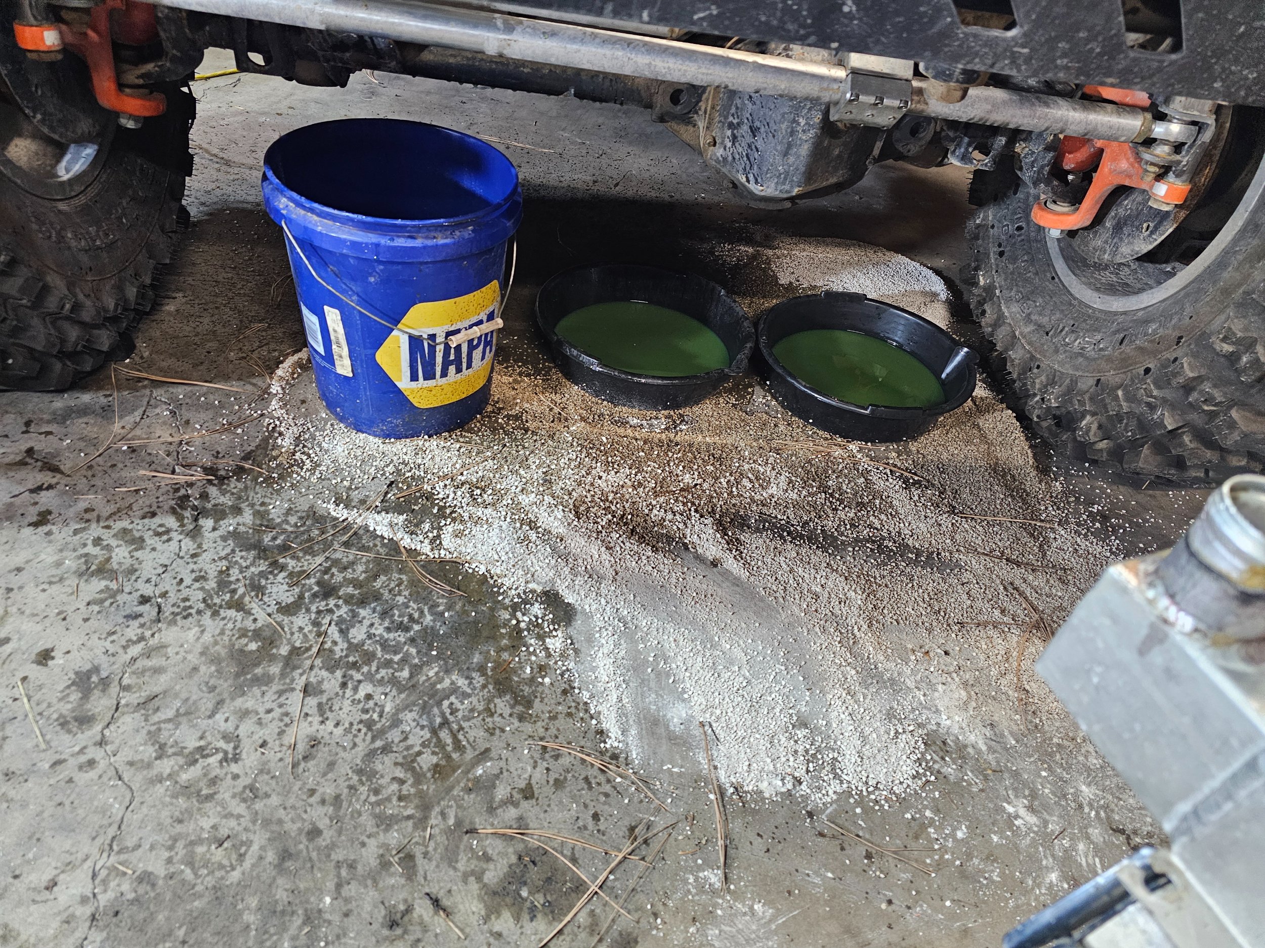

Started draining the radiator tonight and will pull the lower radiator hose in the morning after I run into town and pickup to more 5 gallon buckets so I can flush the radiator better. Then I can pull the radiator out and get the new fan installed plus the thermostat & water pump. Then reinstall it and then pull the front tires & work on the steering.

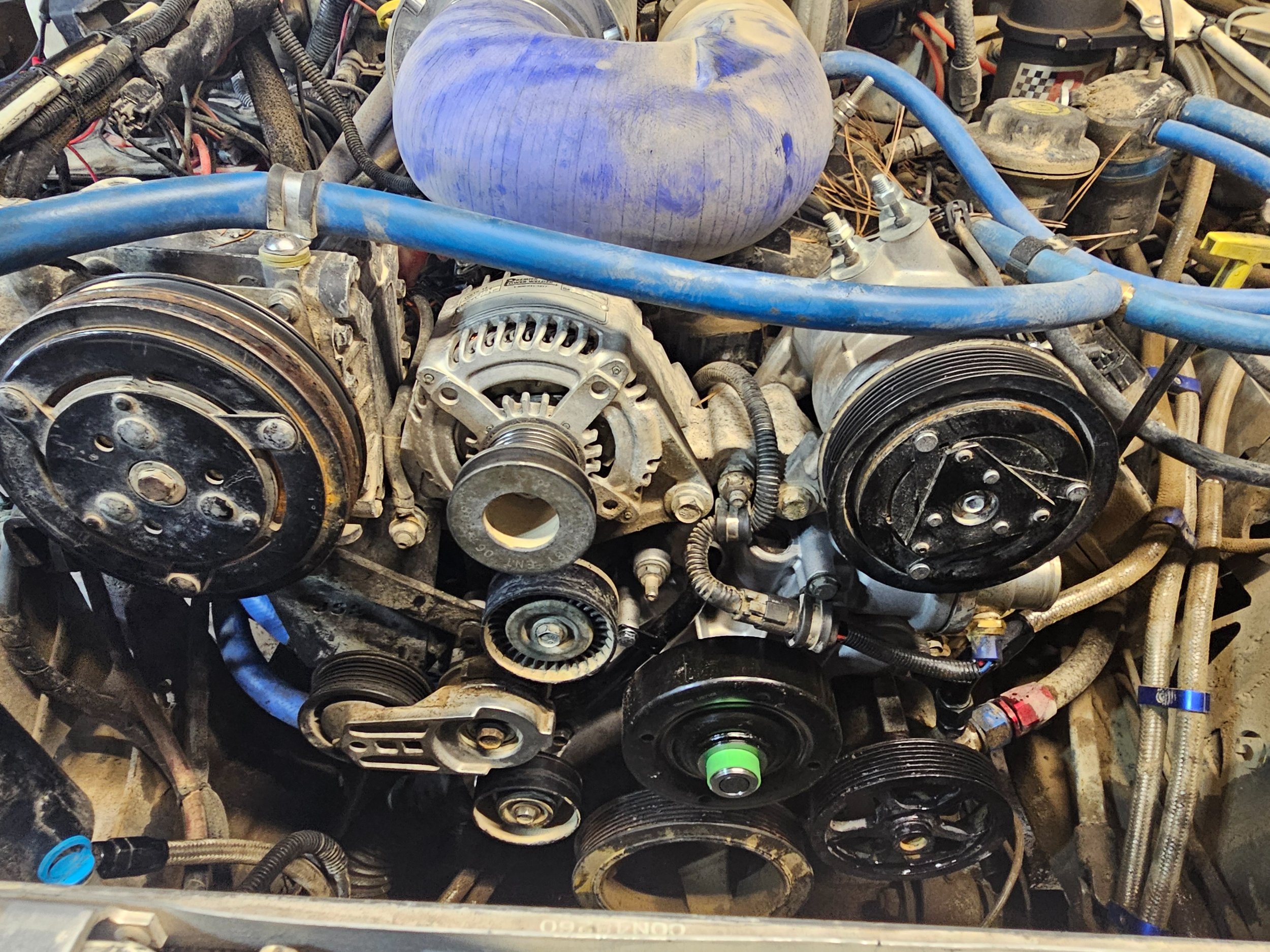

I'm going to stick the radiator in without the electric fan on it and see if I could fit the mechanical fan also.
Plus then I can check the clearance for the Camero fan.

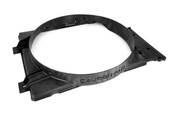

2) Run the mechanical fan. If I go this route I've got to find a 4.0 shroud. And make it fit my radiator.

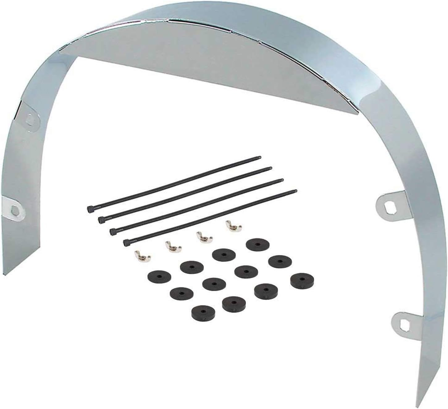

Spectre makes one. Might have to move the mounting tabs to work with my radiator. Or mount it to the core....
https://www.amazon.com/Spectre-Performance-4348-Chrome-Shroud/dp/B000RTYO9M/?tag=wranglerorg-20

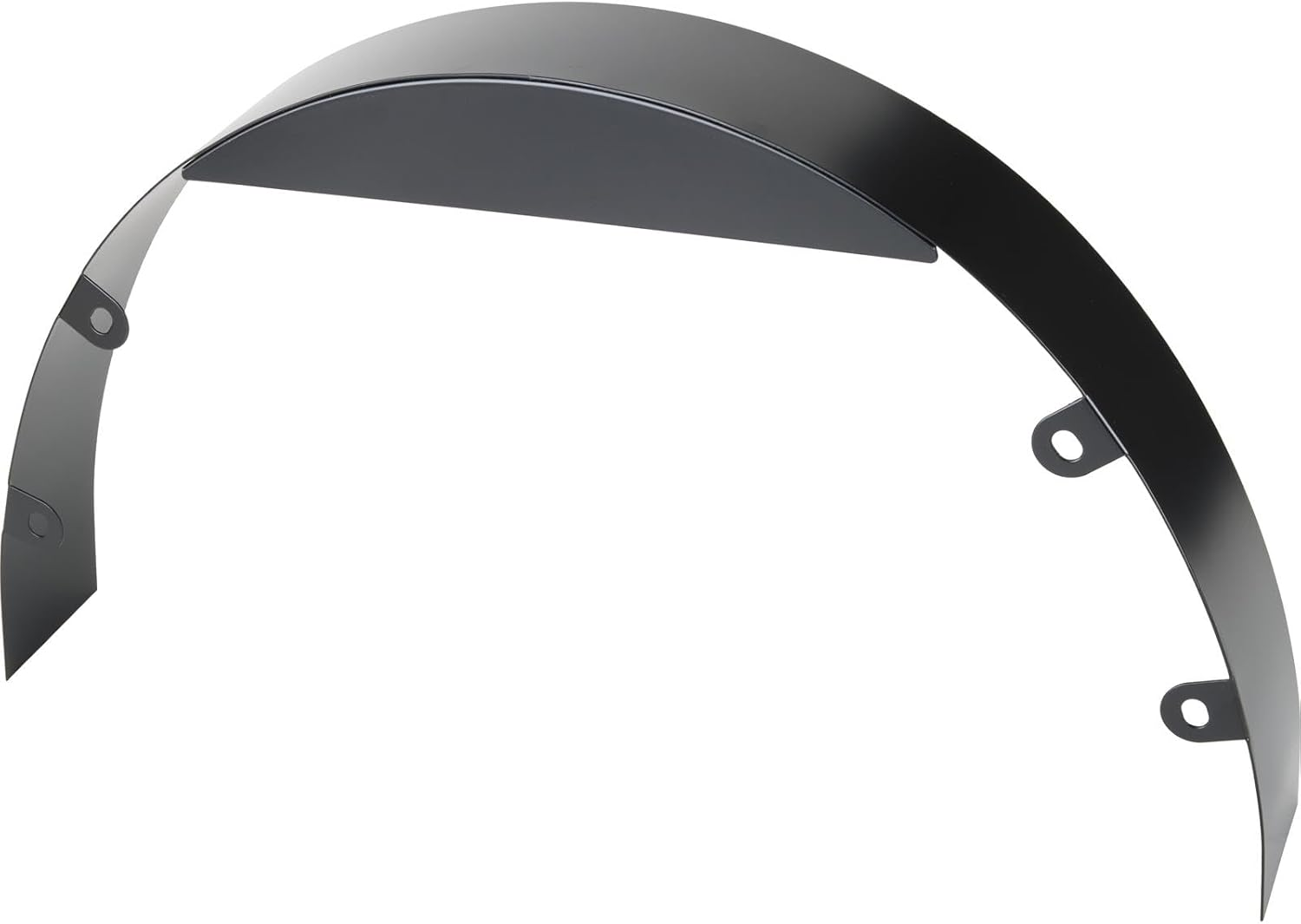

Rugged Ridge makes a replacement shroud for the 4.0
https://www.northridge4x4.com/part/...l_NJtE7Jpj-_dHO_2MgPXtKbtDApSNK86c4syS4pUUuMI

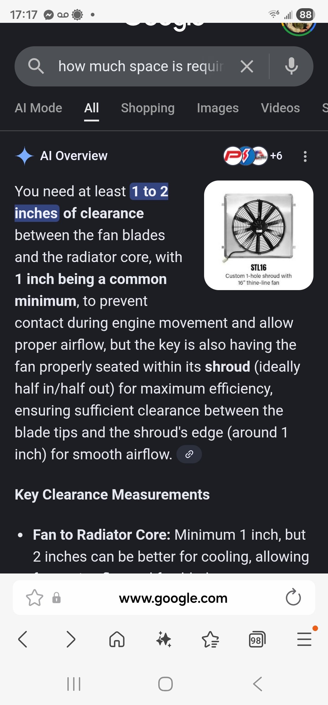

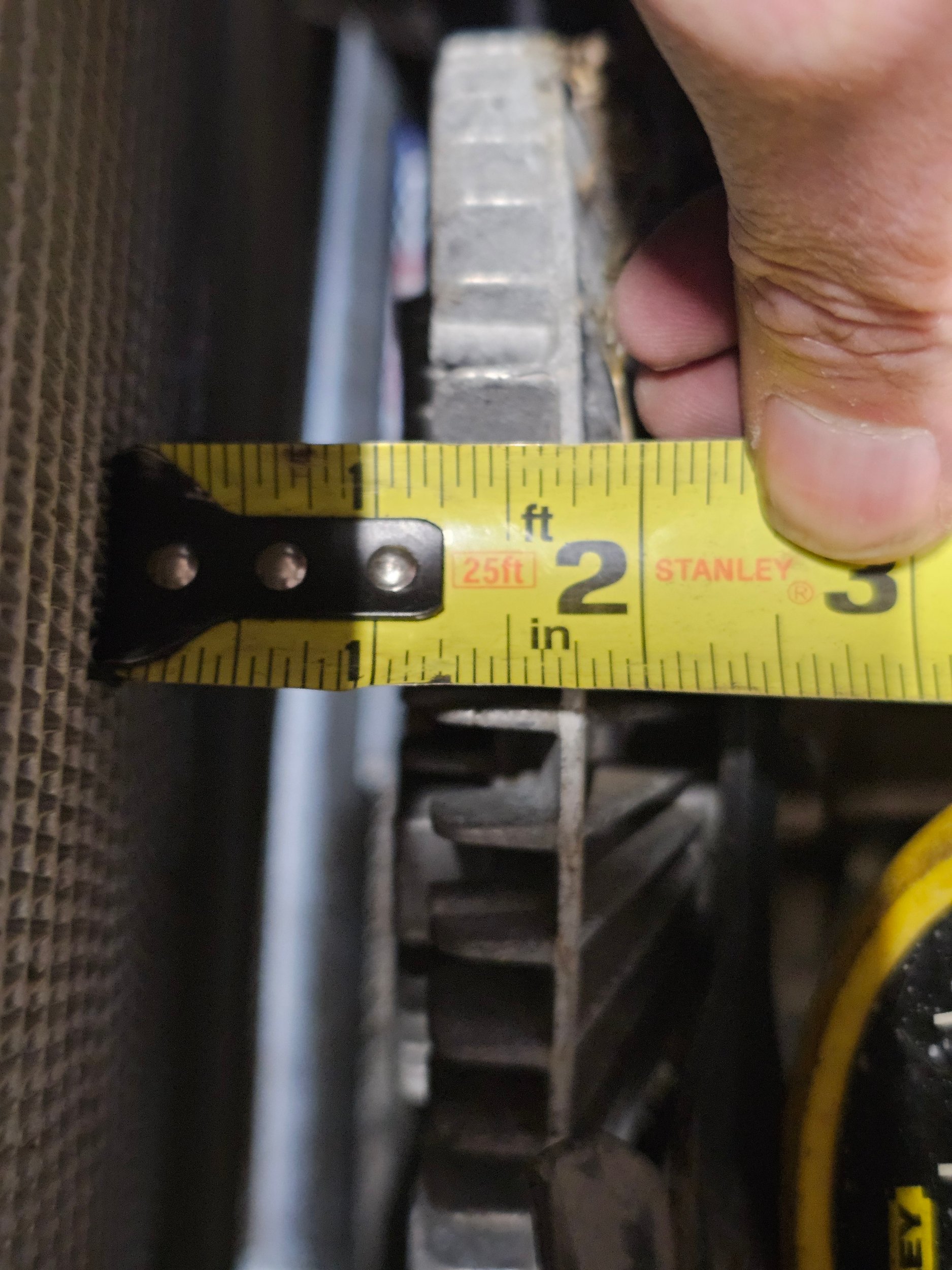

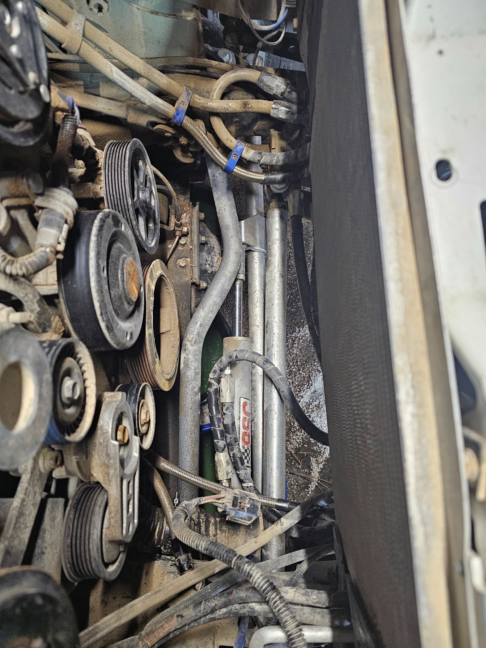

Just out of curiosity I'd measured the distance between the fan clutch and the radiator.
And a AI search gave me this:

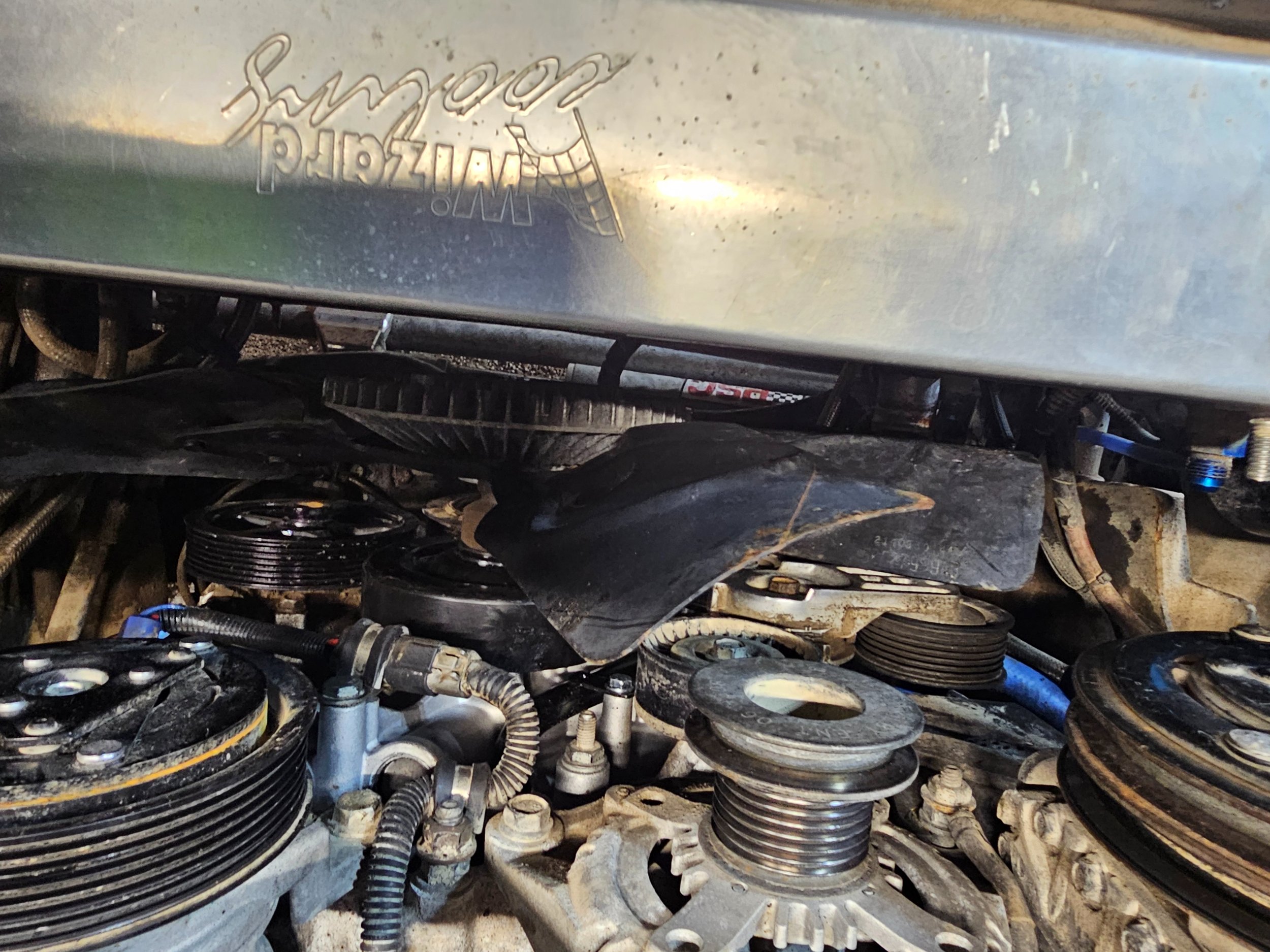

Now to measure the fan blades and figure out what the circumference is of the fan blade I have.

You should be pretty close to spot on shouldn't you?
As far as distance from the radiator? Yes I think I'm good.
What I'm concerned about is that I think the fan blades circumference looked like they were wider than the radiator core but I've got to double check it and didn't feel like running back out to the garage right now. But I'll run out there in a little while and verify.
For now I am thinking I'll run it without a shroud... But would like to have something before the trip if at all possible. And now I've got a DAMN Camero fan I'll have to unload.
