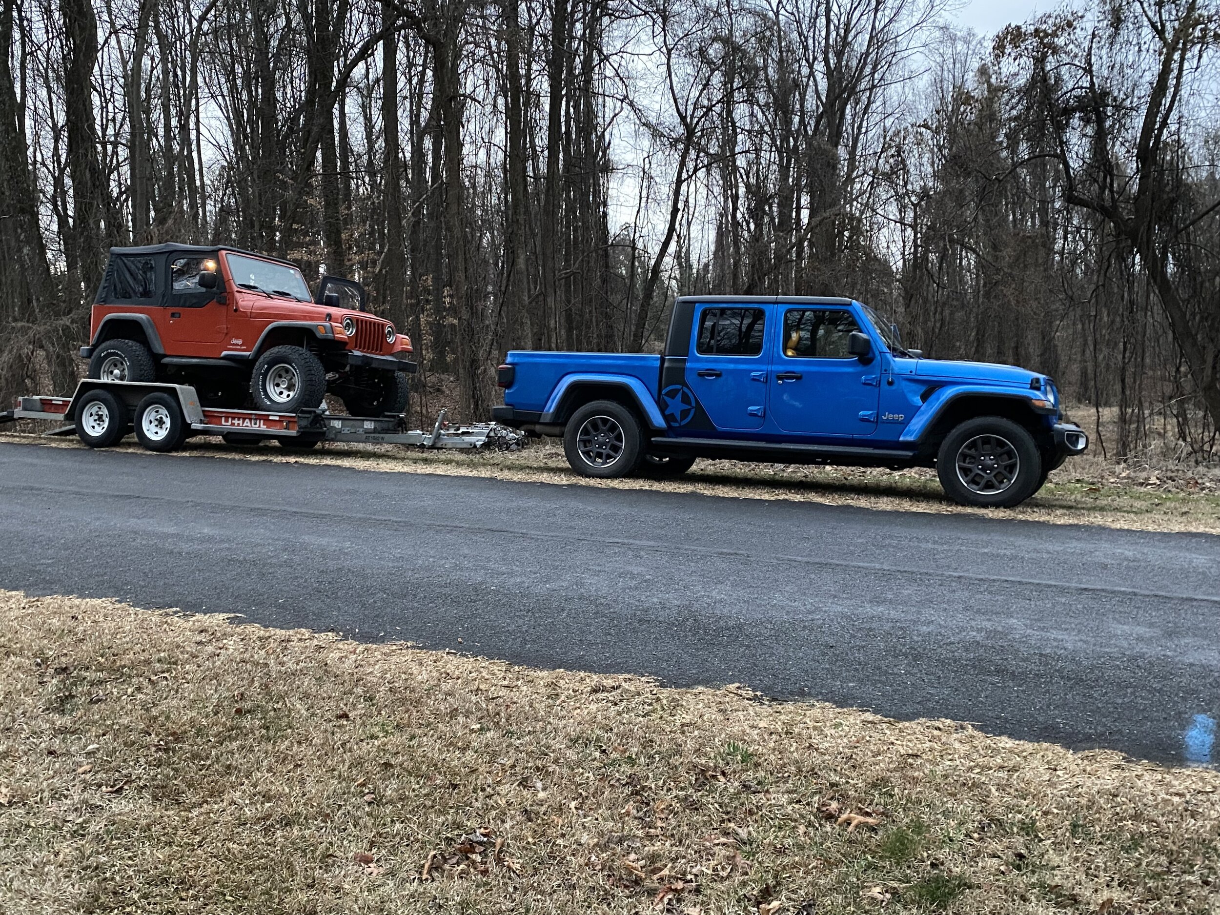

So in late 2023 ~ early 2024 I started planning on getting the build done with the intention of moving everything over to a clean idential Impact Orange TJ that was Left Hand Drive instead of Right Hand Drive. In 2024 I found a clean base model Left Hand Drive Impact Orange 2005 TJ Wrangler:
This 2005 TJ Wrangler has the PowerTech 2.4l DOHC 4-Cylinder Engine with a NSG370 6-speed Manual transmission. No Cruise Control, No AC, No ABS, this is a base of base models which is perfect for me since I’m about to yank the entire driveline out of the TJ Wrangler for my build. I would have liked to have found an automatic, but everything else on this TJ was perfect so I went with it.

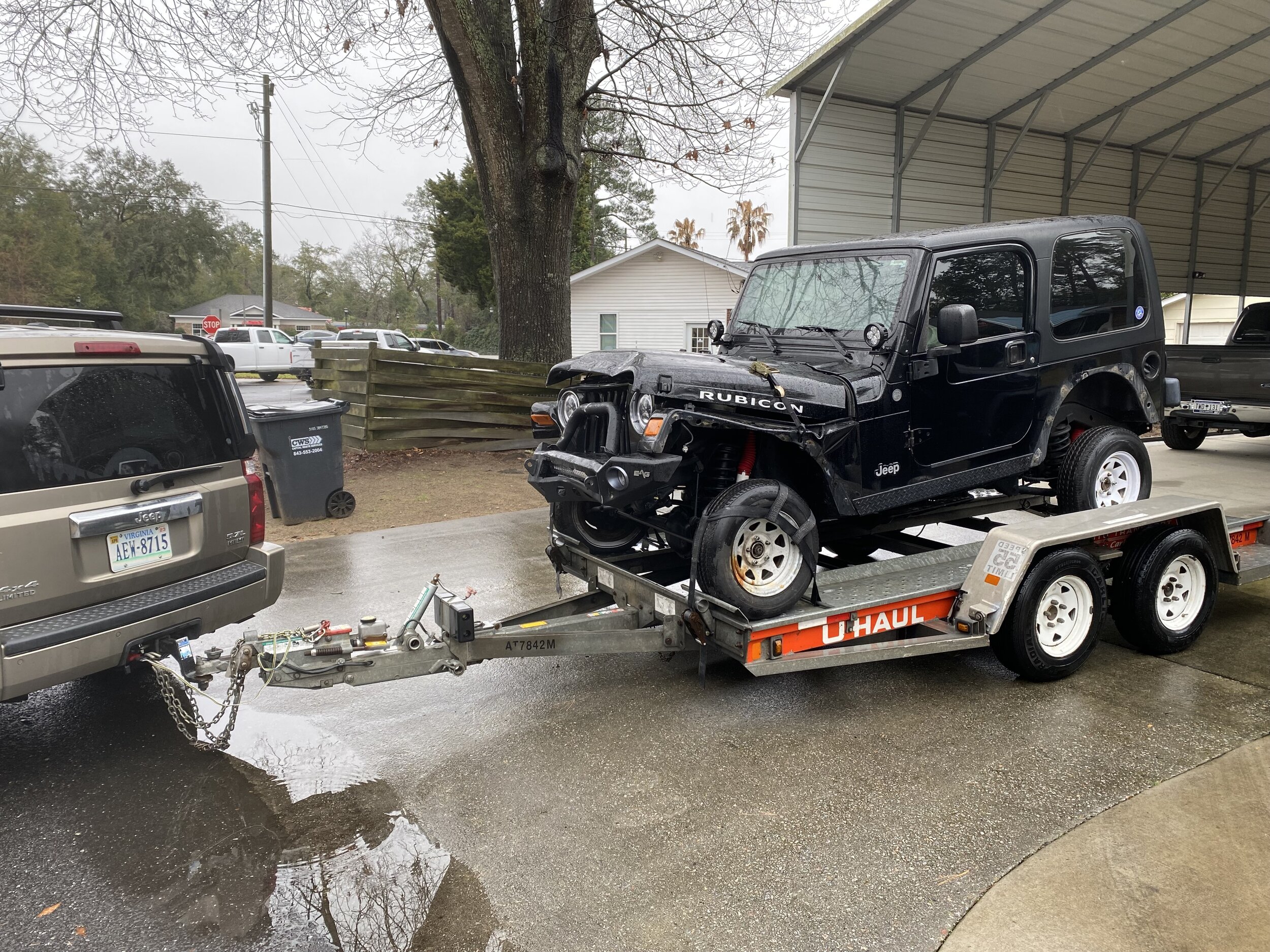

So here is the plan for the build: I’ll be combining a wrecked 2004 TJ Wrangler Rubicon, a 2005 Left Hand Drive TJ Wrangler (the focus of this build), my 2006 Right Hand Drive TJ Wrangler and the engine out of 2014 VW Jetta TDI which comes with the Common Rail CJAA TDI Engine.

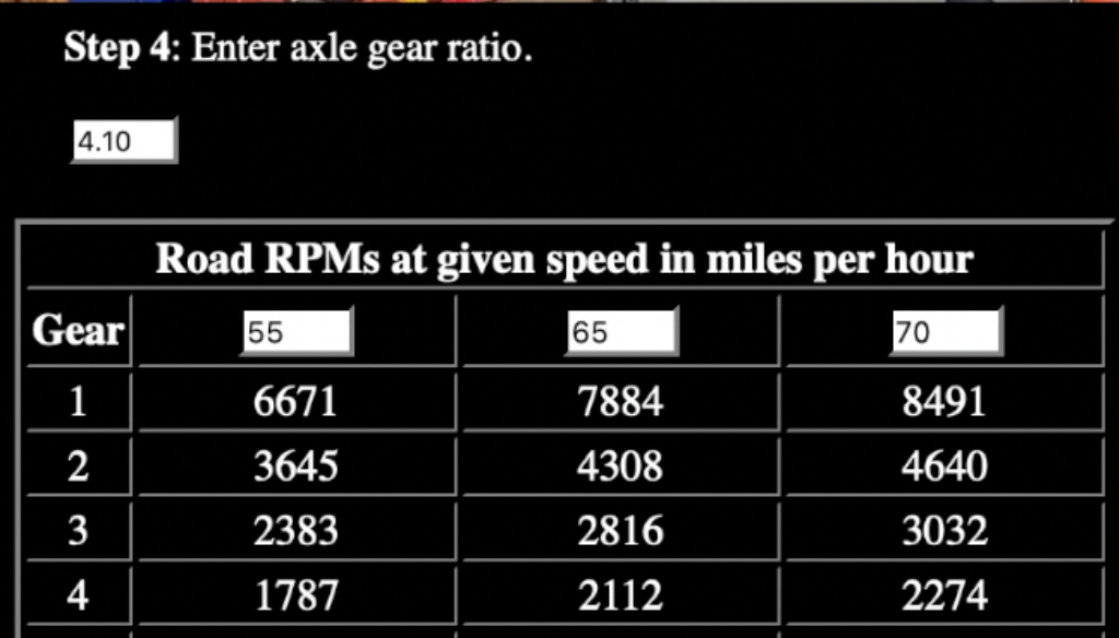

The combination of the lower factory idle, smoother idle and lowered minimum cruising RPM speed of closer to 2000 rpm for the CJAA TDI engine instead of the 2200rpm for my BEW TDI engine will allow me to get better use of my AW4 automatic and lockup torque converter. Check out the following graph which is calculated with 4.10 gears in my Rubicon axles with my current 235/75r16 Tires:
With my BEW TDI I was good in 3rd gear for 55mph but to do 70mph, I would still be in 3rd gear OR in 4th gear torque converter unlocked. While I’m over that 2200rpm threshold, the air dynamics, or the lack there of, for the TJ means I need to be closer to 2400rpm minimum to cruise in 4th gear with my BEW TDI.
With the CJAA engine where the minimum cruising RPM is around 2000rpm, I’m almost 300rpm above the minimum cruising RPM speed when doing 70mph in 4th gear. This is because of the crossflow head design and 4-valves per cylinder for the CJAA TDI engine vs the 2-valves per cylinder in my BEW TDI engine.
