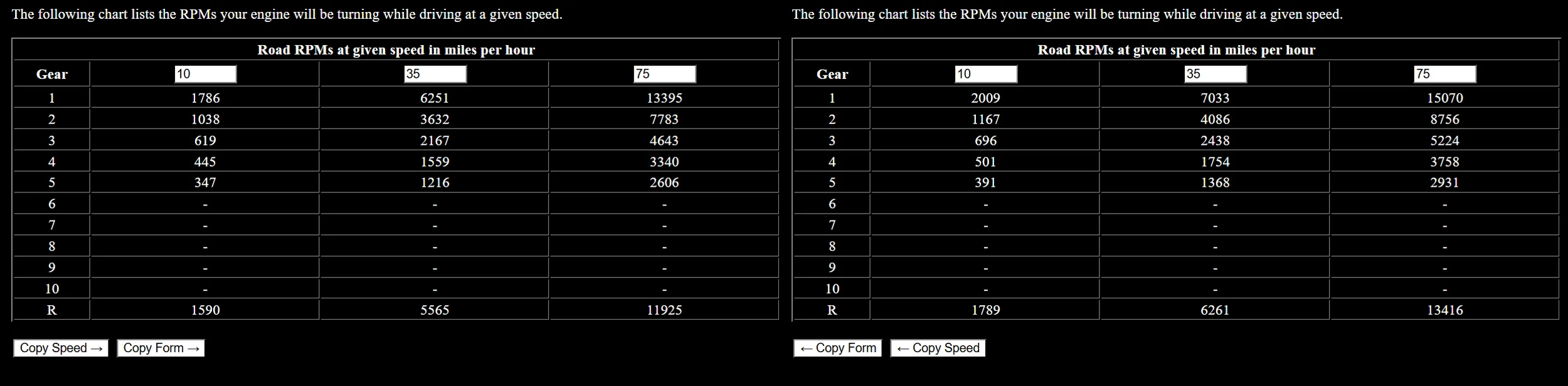

Mr. Blaine, thank you for your polite answer and question. I drive right around 75mph on the freeway, my rig is a 5 speed as I have said, and the RMPs usually around 2000-2200 in fifth gear. In your opinion, are 4.88 a good all around gear ratio for 35s? Why would you choose 4.88 over 4.56? More power, keeping RPMs higher? Lets not get into mythology and just have a mature conversations, if possible.
What engine RPM do you think it is "happy" at when you are running 75 in OD?
To ponder- 2000ish is not enough RPM to maintain speed on other than very flat roads. You have to downshift for minor increases in elevation or push the throttle more than is prudent to try and maintain 75.
There is no such thing as a good all around gear. There are two schools of thought. Gear it for driving up hills at tolerable RPM and a slightly lower MPH and geared for flat land with lower RPM in OD. Or, more pleasant driving in OD with the RPM much higher but a much lower scoot up hills with higher RPM.
4.56 on the left, for comparison, 5.13 on the right. Roughly, I can get it closer if you give me an exact RPM and MPH that you have now.
