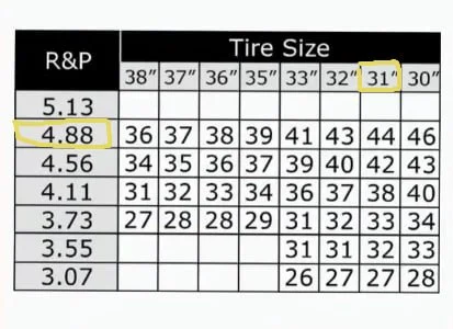

What gear ratio should I install in my Jeep Wrangler TJ / LJ? (and other re-gearing FAQs)
