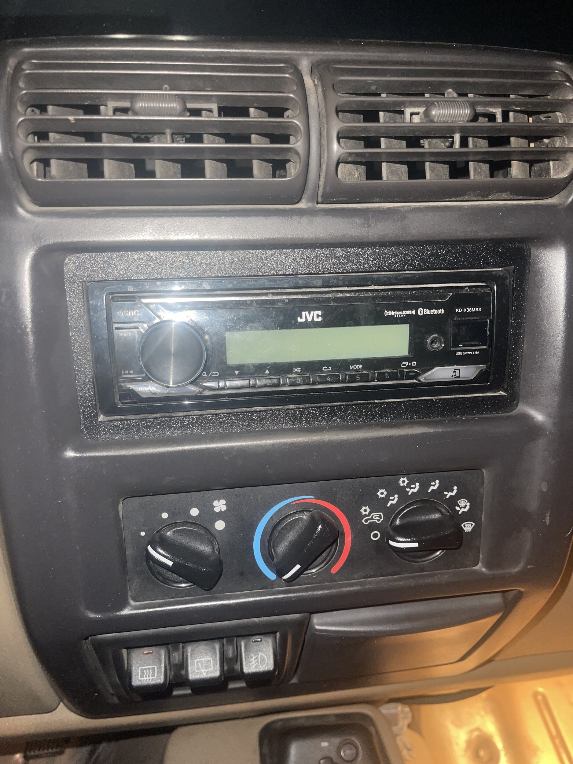

Just wanted to share my setup that I'm relatively happy with. Still plan on putting my small amp back in, and installing a subwoofer somewhere.
HEAD UNIT:
https://www.crutchfield.com/S-5vLBewoPpV5/p_105KDX38MB/JVC-KD-X38MBS.html
This is a pretty sweet head unit. Lots of control on EQ (with presets) and has options for screen brightness, so when you're topless you can actually see the damn thing. Can do a good bit of fine tuning. MOSFET amp.
FRONT SPEAKERS:
https://www.crutchfield.com/p_151XL52SS/PowerBass-XL-52SS.html?omnews=18257433
https://www.crutchfield.com/S-u3y6l...MIzuSbwqv_jgMVUF3_AR0W6CpkEAQYASABEgLpH_D_BwE
The Select Increments 5 1/4 pods made a pretty considerable difference. The 4.5" speakers suck. Install is pretty easy. Some Jeeps you have to chop a bar out of the way with tin snips.
The Power Bass speakers work pretty well. I have these in my Mariah Shabah Z202 as well as my TJ. Pretty great for the price.

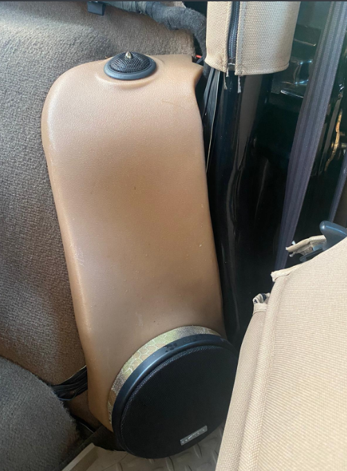

REAR SPEAKERS:
https://www.crutchfield.com/p_206KM654L/Kicker-45KM654L.html?omnews=18257433
These big bastards WILL fit in the stock sound bar for the 97-02 TJ. They fit TIGHT. These with some poly fill are pretty damn awesome. I'd generally considered Kicker to be a cheap Walmart brand of speakers, but I'm genuinely impressed with these. They also have LED's built into the ring around them, if you're into that sort of thing.

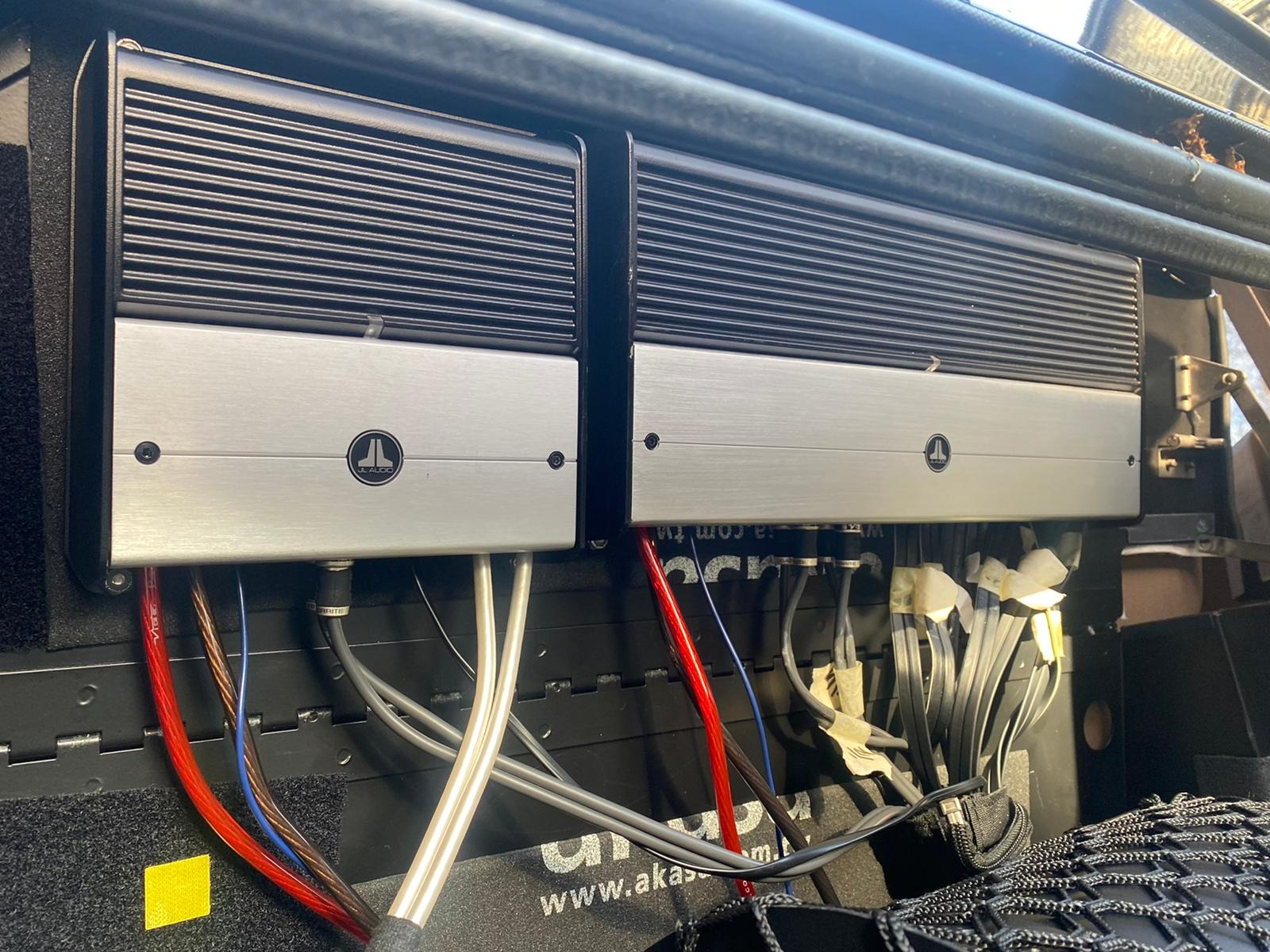

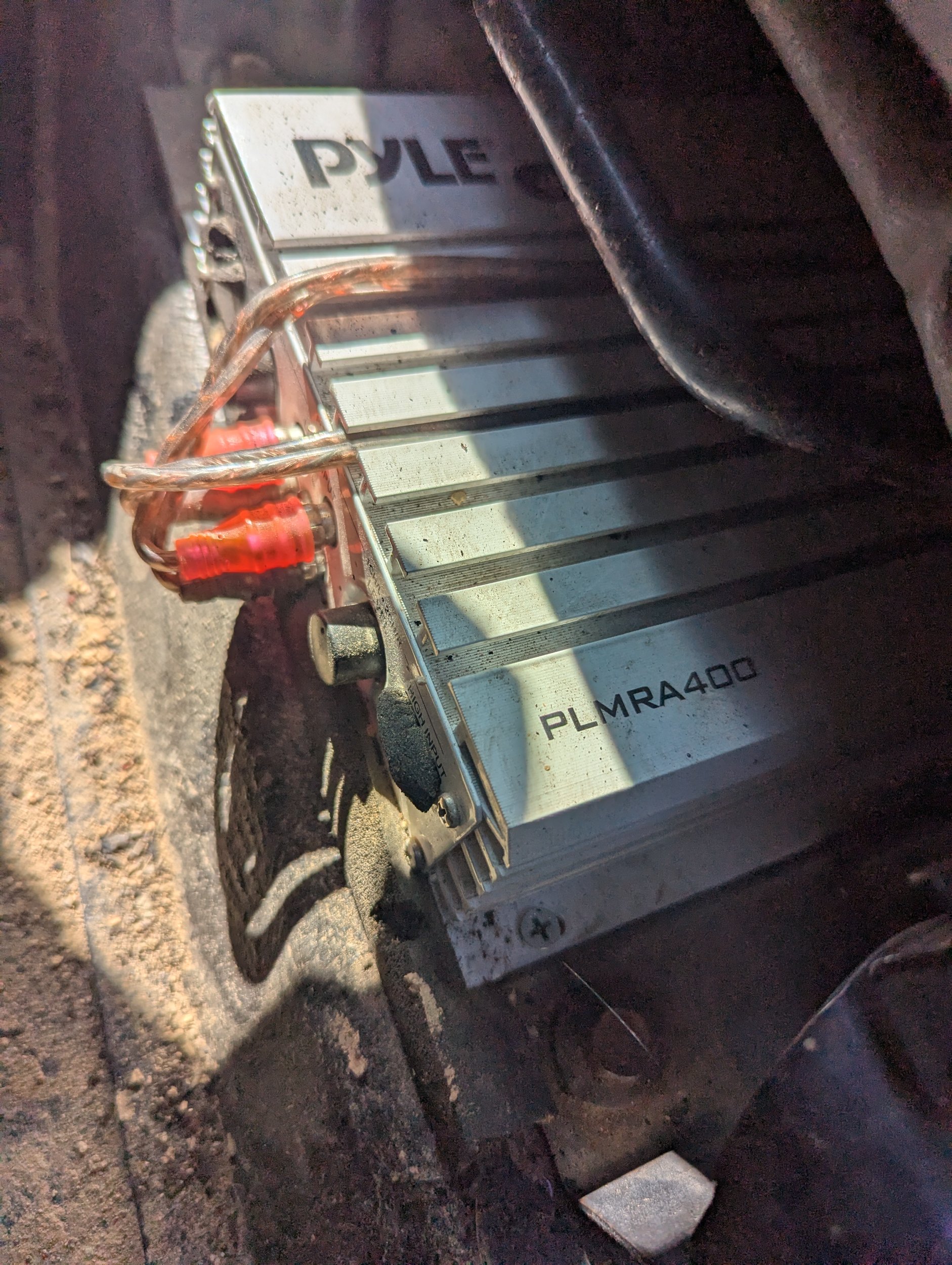

You may be surprised at how small these JL audio XD amps are, this is the XD800 and XD300 sitting next to each other behind my back seat/ storage box.
I don't use my wrangler as a boat but once its folded back down the amps are as high as my steering wheel and hidden away when I have the roof off.

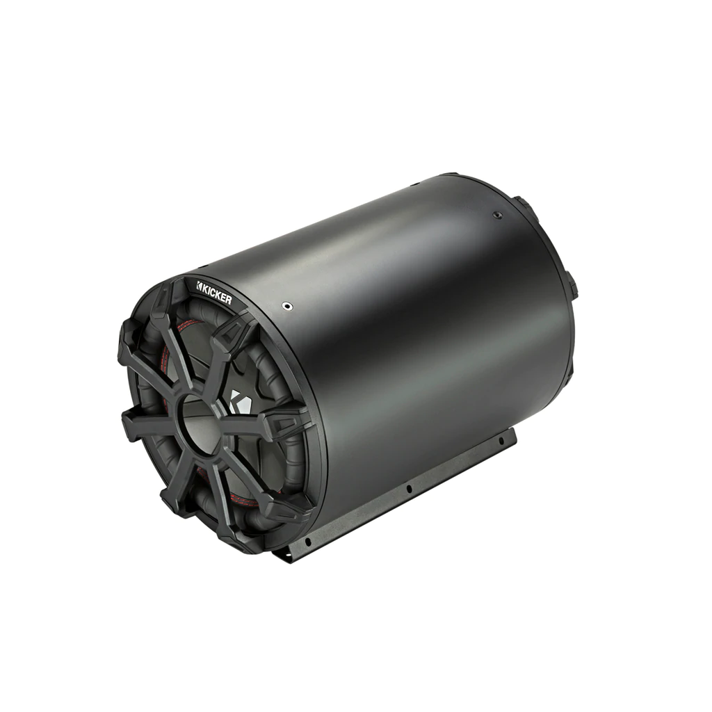

the JL XD300 mono block is connected to this passive sub in the back Kicker KA46CWTB82
The XD300 melted the kicker speaker so replaced it with an Alpine SWR-8D4 the kicker enclosure is top quality and the speaker was good 300watt RMS and 600watt peak but the alpine can handle a bit more at 350watt RMS and 1000watt peak.
The XD800 amp is connected to a whole load of component speakers using passive crossovers.

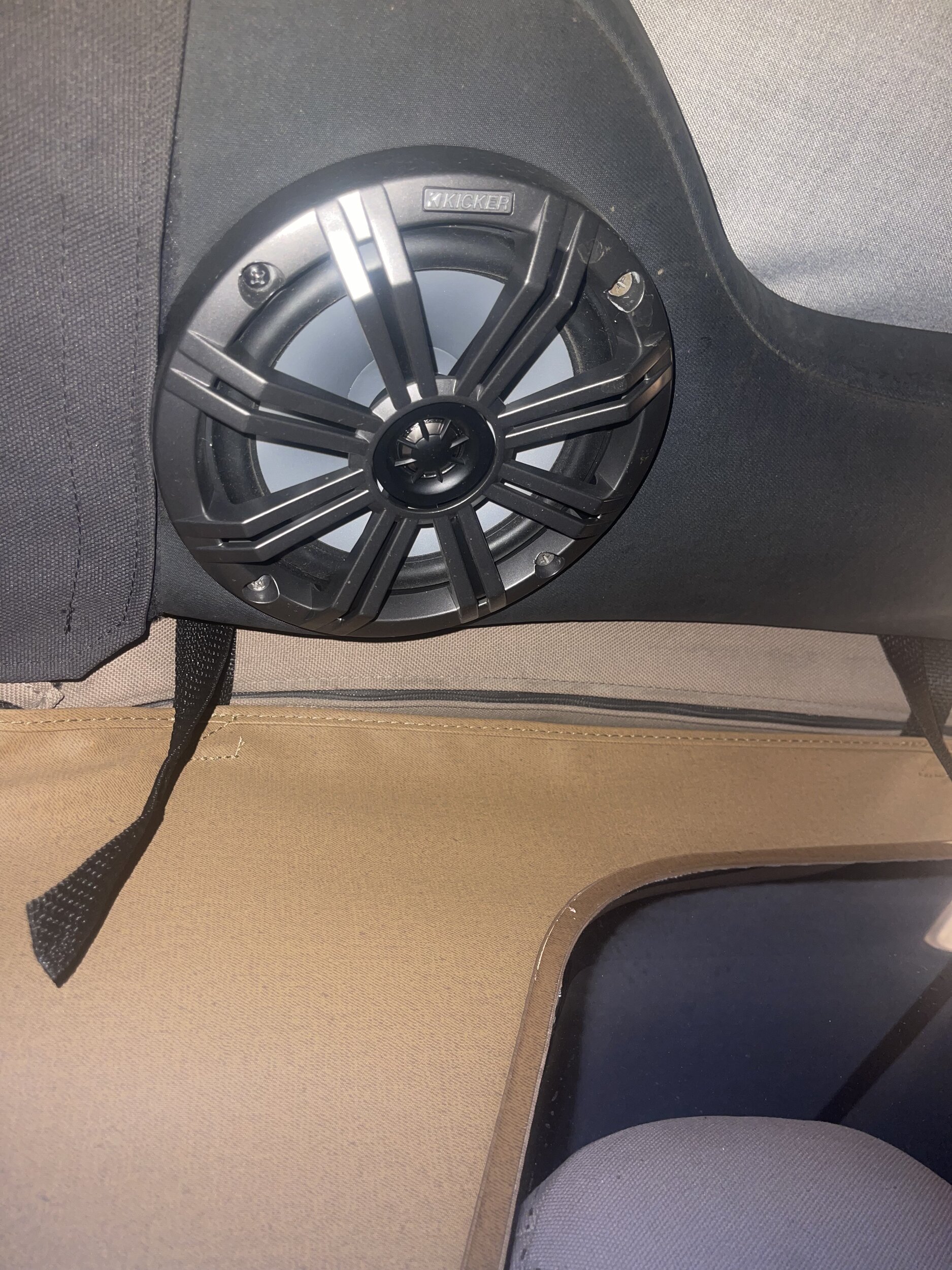

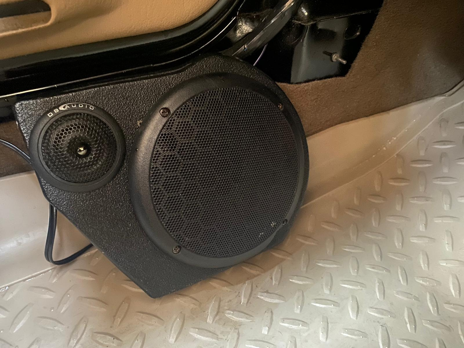

DB Audio Systems T-Rex 5.2C 230W 13cm 2-way component speaker below the front doors and in the sound bar
I am using the Focal TiS 1.5 tweeters in the sound bar instead of the DB audio ones.
Then the slightly larger DB Audio T-Rex 6.2C 250W 17cm 2-way component speaker in the back

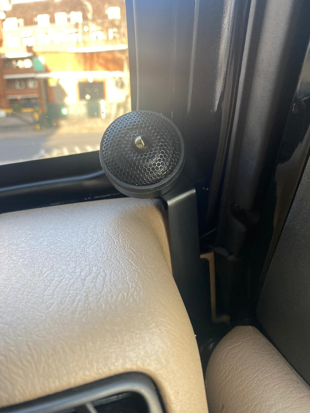

DB Audio tweeters above the dash

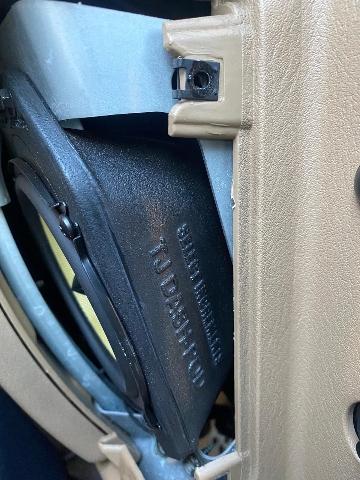

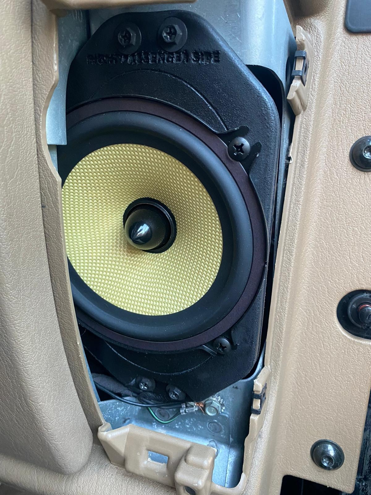

I have these speakers inside the dash but have completely forgotten who makes them.

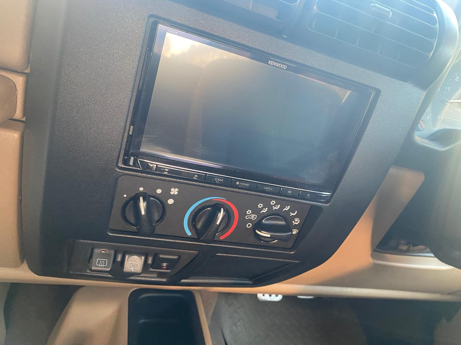

my head unit is a the Kenwood DDX9906XR it has 5v pre-outs so it was important to get the gain set correctly on each channel. its got apple carplay, android audio and a dvd player and 2 usb connections.
