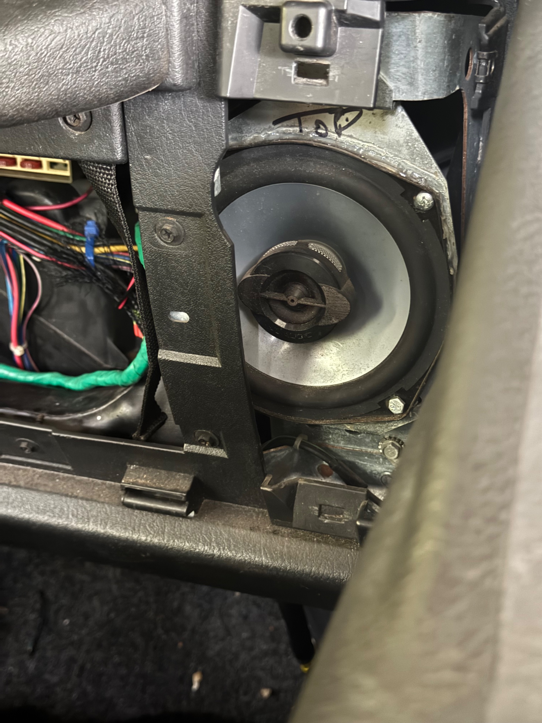

The closed-back pods are too small. But the sides of the speaker mounts are open which means there's almost no baffle. I sealed around the sides and that helped.
They're too small to get the most bass and midbass, but with the size constraints of the dash we're stuck with them unless we want to get really custom with our install. Sealing around the sides definitely helps. I use a layer of butyl rubber between the plate and the pod, it made a noticeable difference.

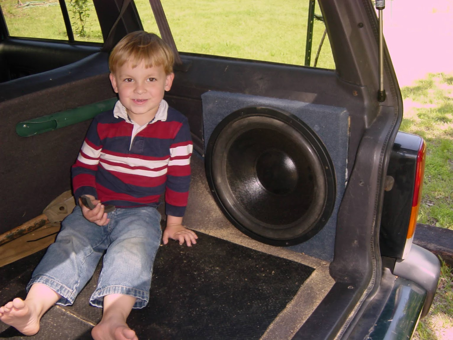

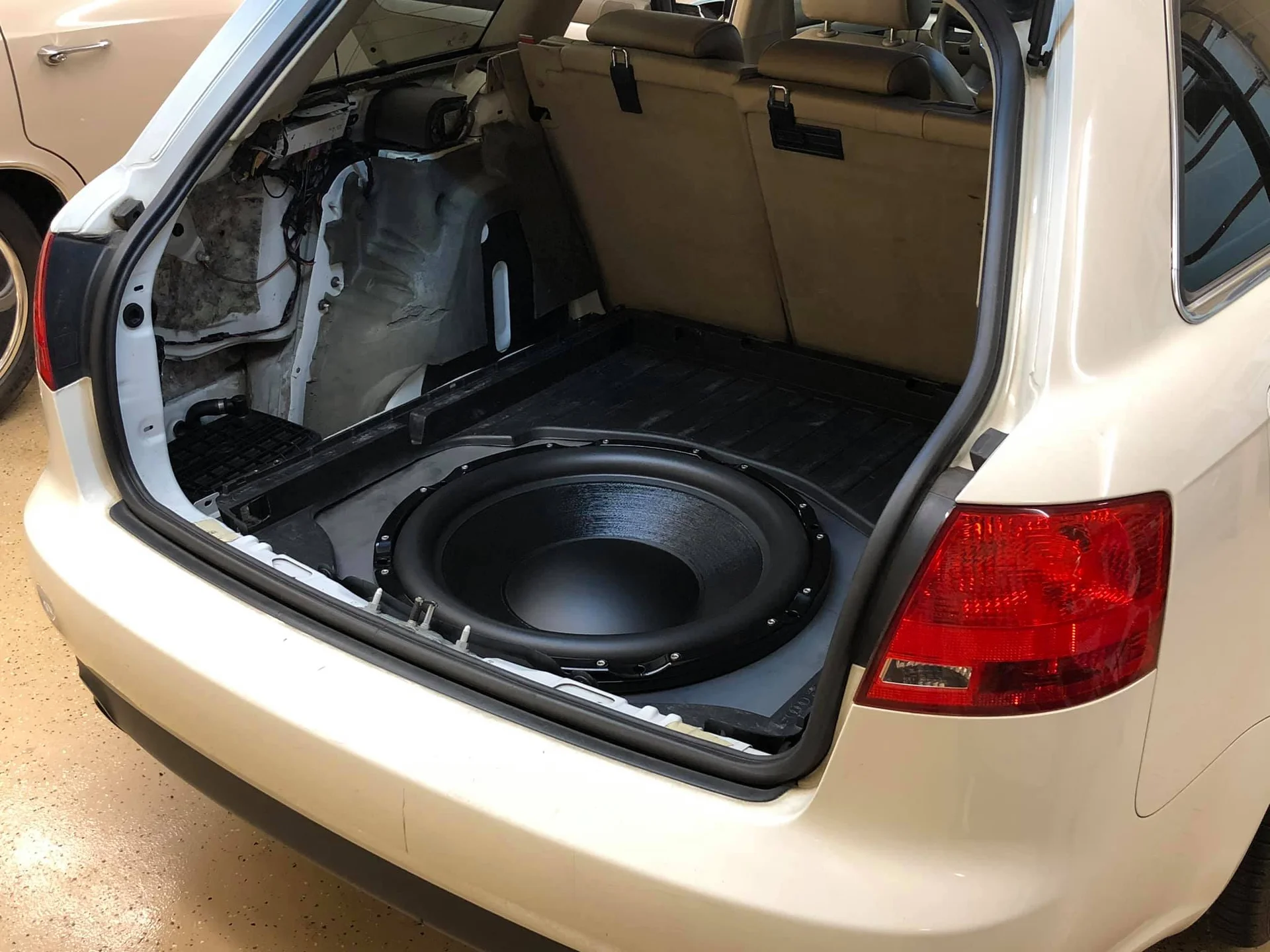

Here's a good example of an IB build:
Instead of needing a massive enclosure for this sub the vehicle itself acts as the enclosure. A box for a sub this size would take up most of the back cargo area, but with this setup the back of the sub empties directly to the outside. It lets you bypass the normal volume requirements for an enclosure while still getting a ton of low-end.
I went IB in my XJ 16 years ago. Saves space and is the best for very low frequencies, as boxes act as a high-pass filter. This is a 15" fi car audio sub. Wish they were still available.
I'd like to try IB in the TJ as there's even less storage space than the XJ, but I haven't figured out a good solution yet.

Respectfully disagree… after market speakers to fit for example in the dash are not made for or require a closed pod.
They will sound better without it particularly the higher quality speakers you go with. The secret is bridging the space between the front of the speaker and the TJs grills. The reflections you refer to are just of no concern in a vehicle. ( at home bouncing of side and rear walls sure) I’m making a suggestion, that’s it , take it or leave it. I would say I’ve never seen any examples of where a pro intaller would add these. Just sayin👍
So based on this we should all cut the backs (tops) out of the factory ROPs pods then? :sneaky:
I would. The only thing these will do is keep any dirt ets getter my to the coil. You’ll much more if you create a speaker ring to fill the space between the front of the speaker and the grill. This helps get all the sound into the cabin.

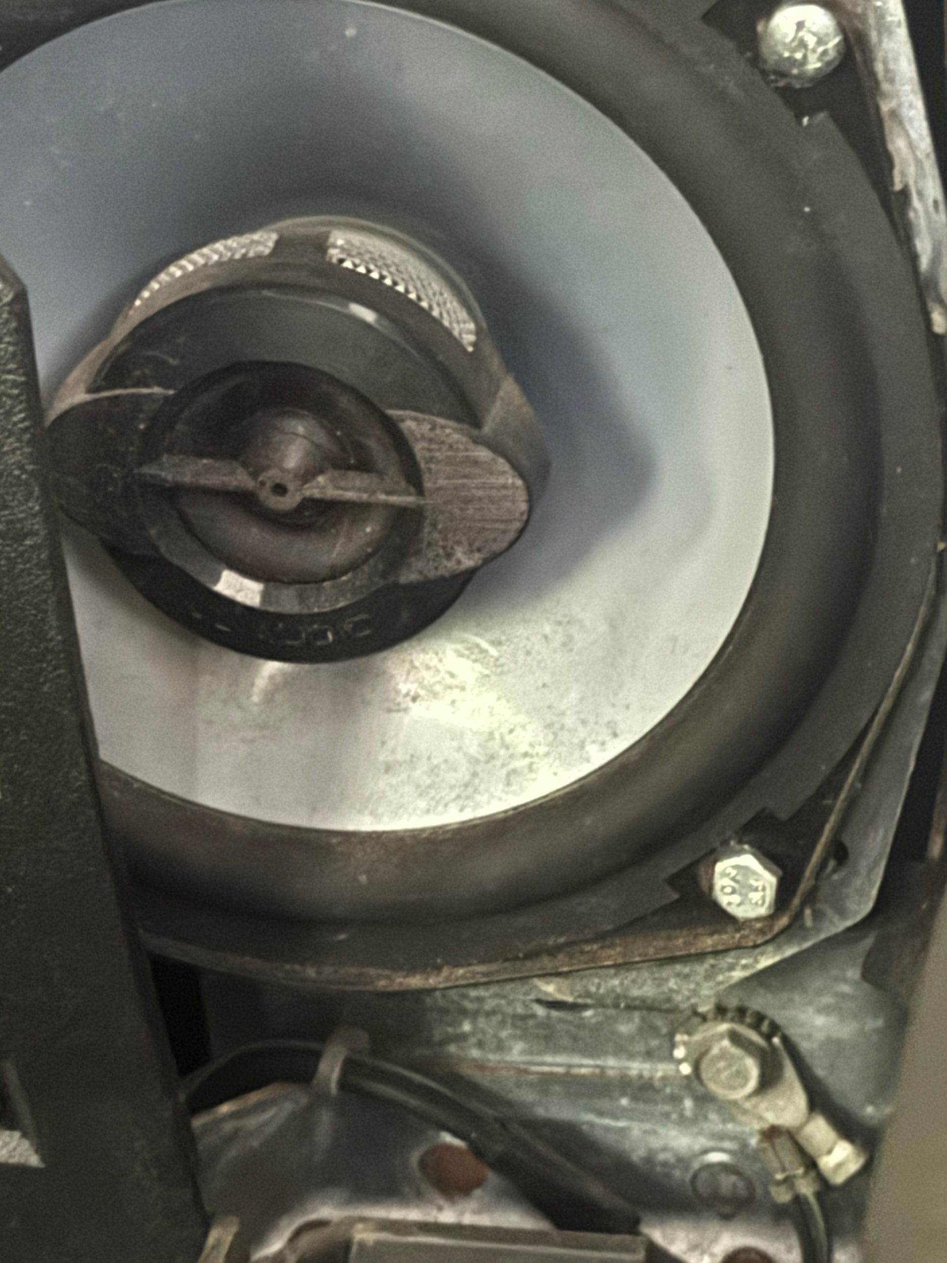

I run Polk DB522 speakers front and rear in the stock locations, with a Bazooka 6.5 sub also in the stock location, all driven by a Soundstream Nano PNS 640D Class D amp. The head unit is a Kenwood DNX697S.
The dash speakers are mounted in soft pods - based on the last few pages here I'm not sure whether that is good or bad - although it does sound like sealing the space between the speaker face and the dash grills would help.
Performance is good, with plenty of power, but to my untrained ear the clarity is a bit lacking. I'm thinking of adding component tweeter pods on the dash - something like this:

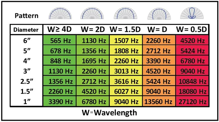

The speakers in the factory dash location do not face toward the listening position, where your ears will actually be while you're listening (unless you put your head in your lap while you jam). They face towards the driver, but with a slight downward angle. Given the directionality of sound waves when the wavelengths are shorter you face directionality issues, especially if those speakers are playing full spectrum.
As the wavelengths get smaller (higher frequencies) they become more directional. If you're running the factory 5.25" speakers you can see that over 2700 Hz the dispersion pattern starts to narrow, so now those frequencies are "beaming" straight out from the woofer instead of dispersing. When the speakers aren't aimed towards the listening position you start to lose sound quality.

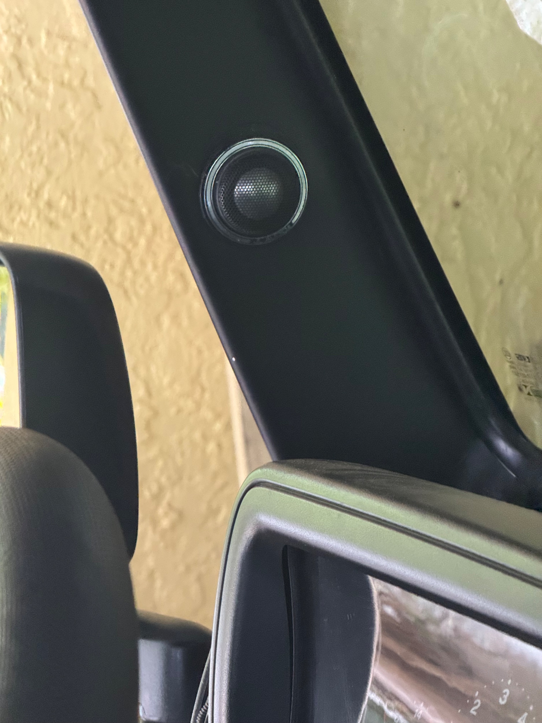

Currently: Tweeters in A pillars. Mids in dash. 6” mids in footwell with separate angled tweeters. All JL audio.

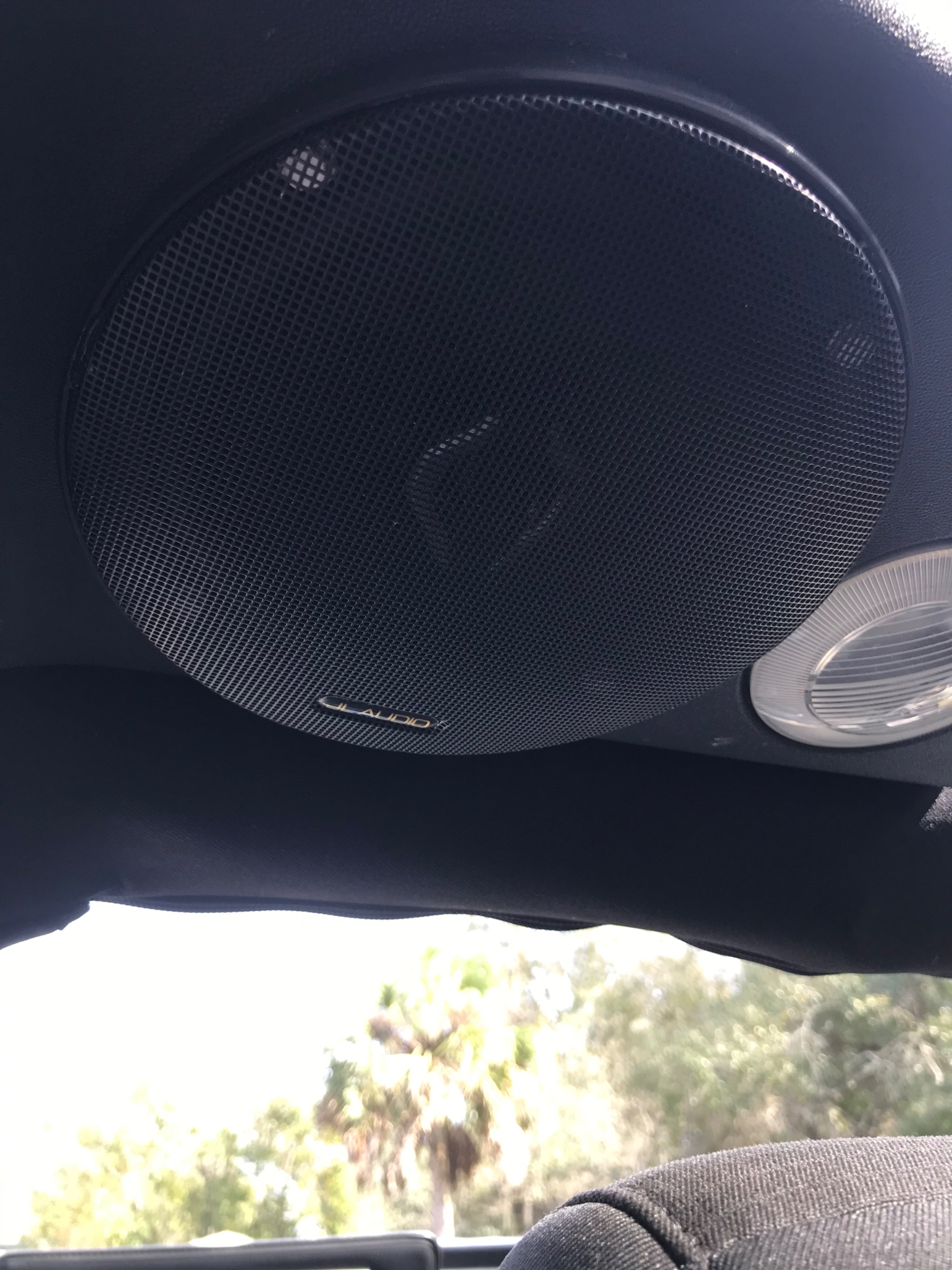

Overheads have Hertz speakers with overheads inside treated with sound deadening ( huge improvement).

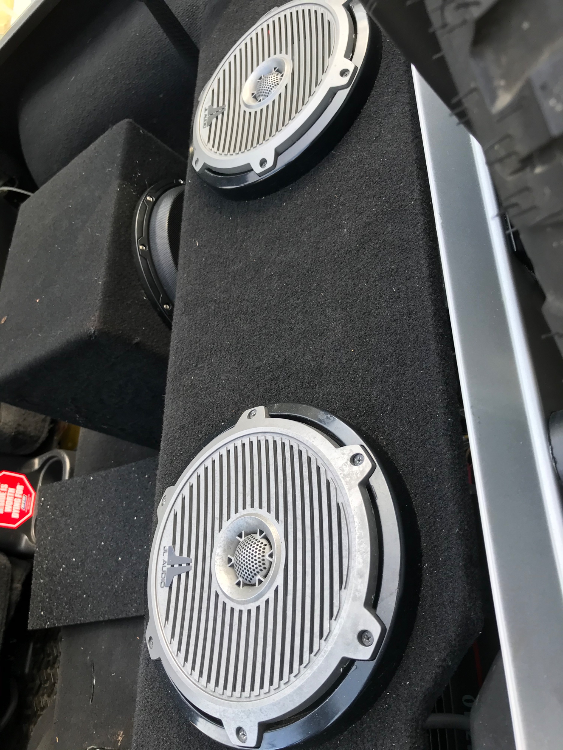

Rear: two marine 8” recessed into trunk ‘parcel shelf ‘ . A 10” Sub in sealed box is in trunk area. All driven by 3 marine amps and a JL sound processor that takes the sound from the head unit and processes it to deliver a pure, quality signal to the amps. A JL Bluetooth receiver is also fitted right beside the radioradio in dash. This allows streaming from phone at CD quality, it’s great. The factory sub in the console was replaced by a smaller Kicker competition sub with whole thing treated with roadkill.
Some pics here are just for fyi if interested. This week I’m currently tidying up the installation at the back. I’ll let you see when finished. 👍
