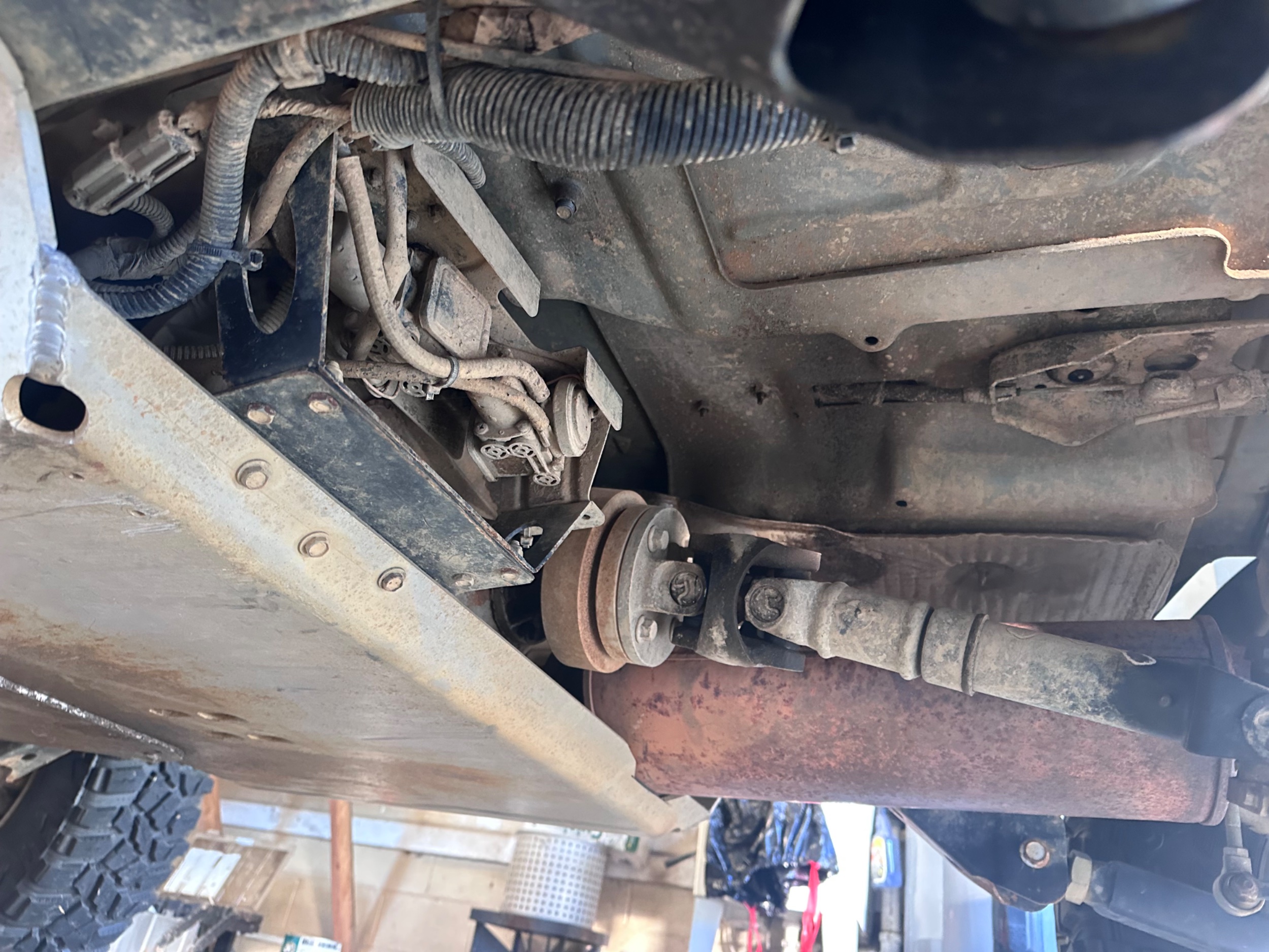

When I get home if I can remember I’ll send you an image of mine- I cut the part off the stock skid plate the stock bracket mounts to and bolted to my Ucf skid- it had the next effect of raising the pumps close to the tub.
I know you aren’t asking specifically for this but it is worth a look…I was really surprised and pleased at the result.
Here you go- I got frustrated trying to make the ucf option work if I remember correctly and got out the angle grinder. It got the pumps way up, required no changes to the factory pump wiring or plumbing.
