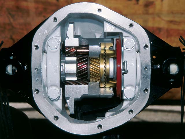

1 of 2 issues. Either the actuator is not engaging, or the limited slip has bit the dust and the helical gears are broken. Latter being common on the stock lockers. They're not serviceable. Most here will recommend ARB air locker or an Eaton electric.
