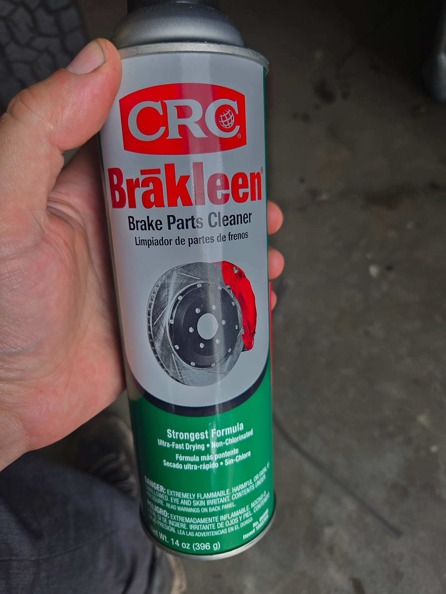

Attempted brake kleen multiple times, was not getting any volume into the system at all.

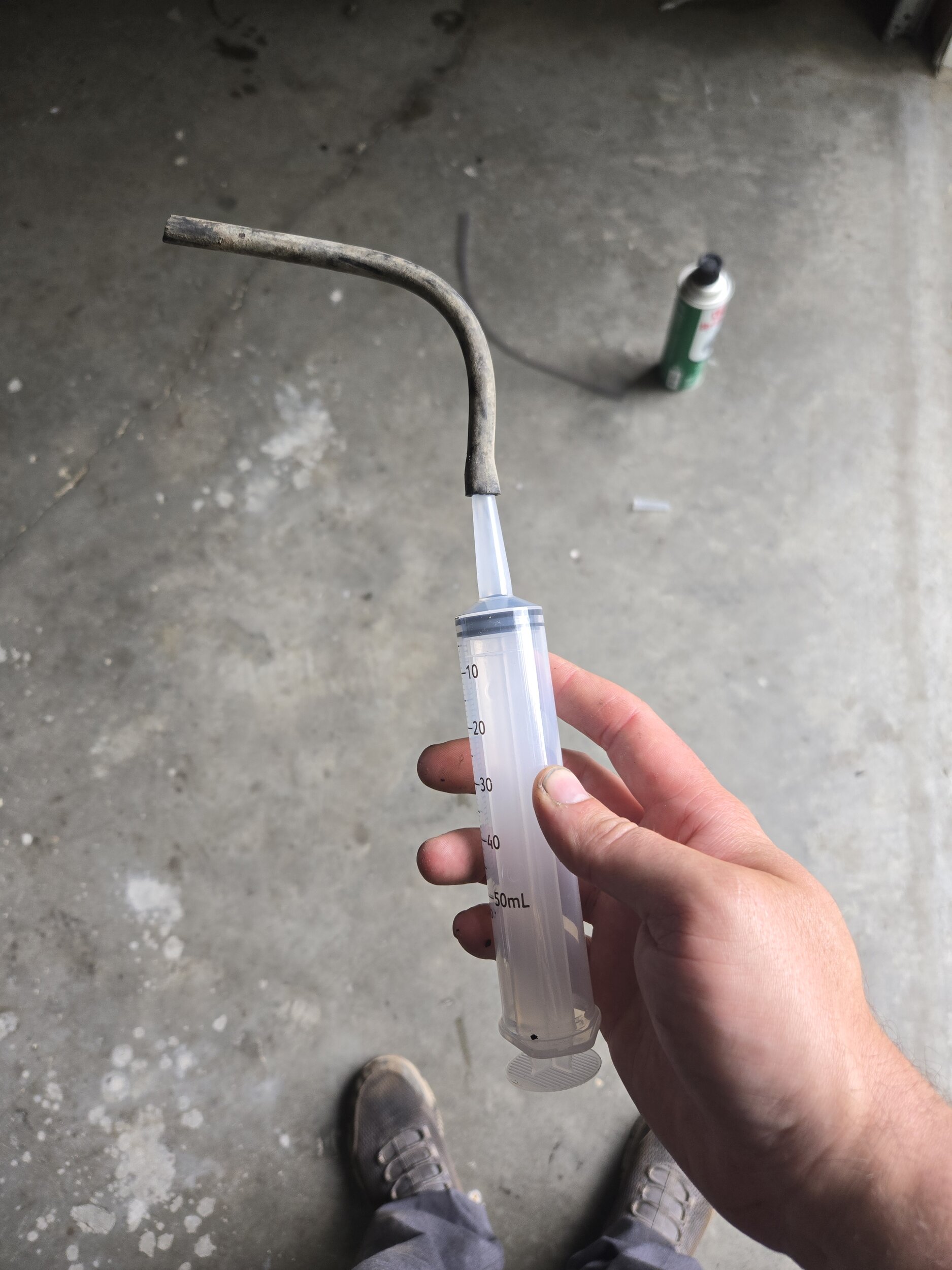

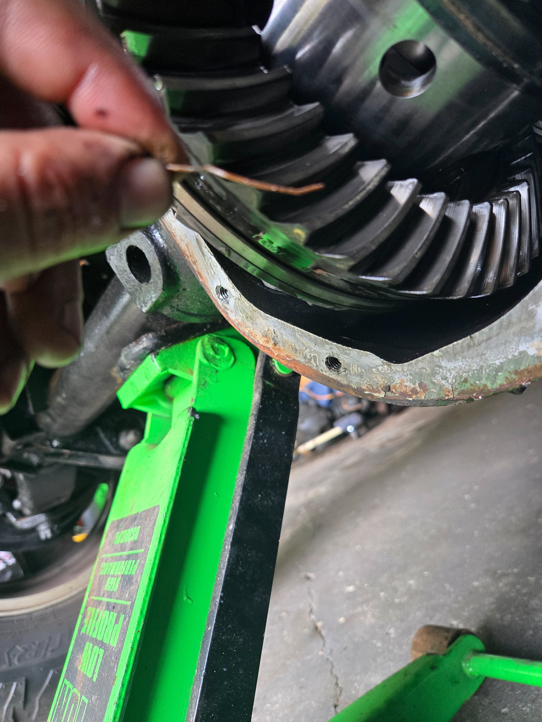

Took a small piece of welding wire and tried fishing into the fitting for any obstruction, got to the first elbow with the wire getting stuck. Slightly bent the wire and very slightly bent the elbow out towards the diff cover with a 7 mm wrench being careful not to kink the tube (ymmv), and was able to advance the wire slightly farther and it came out rusty. Did this repeatedly, and now the actuator actuates and holds air. Cleaned it out with brake kleen at the end. Attached are pictures of everything used as well as the jeep in question.
