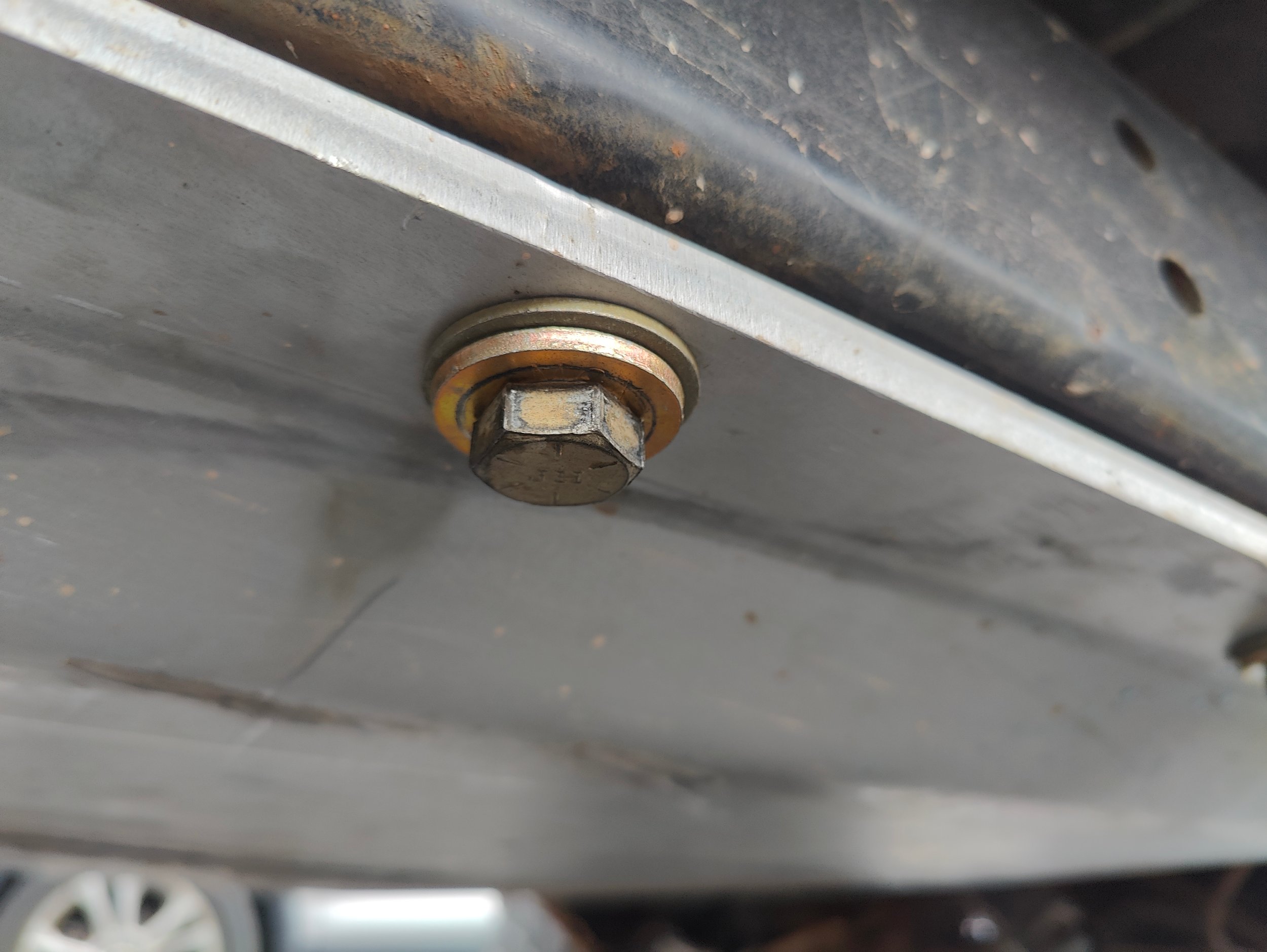

This is my ucf, I went with steel so i could weld it the way i want
