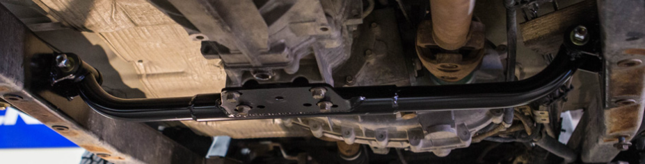

I did the Barnes 0" flat belly several years ago, 1-1/4" body, 1" motor, SYE, Novak cable adjust. I only had one place I had to clearance on the tub and all I did was put a large socket on the "extrusion" on the trans case that was touching... jacked it up until it was lifting my tub... lowered it and wha-laa... it was clearanced... lol.
I also installed the Genright Trans Crossmember... which is awesome and has saved my bacon on the trail bc you can drop your skid without having to support the engine / transmission.
