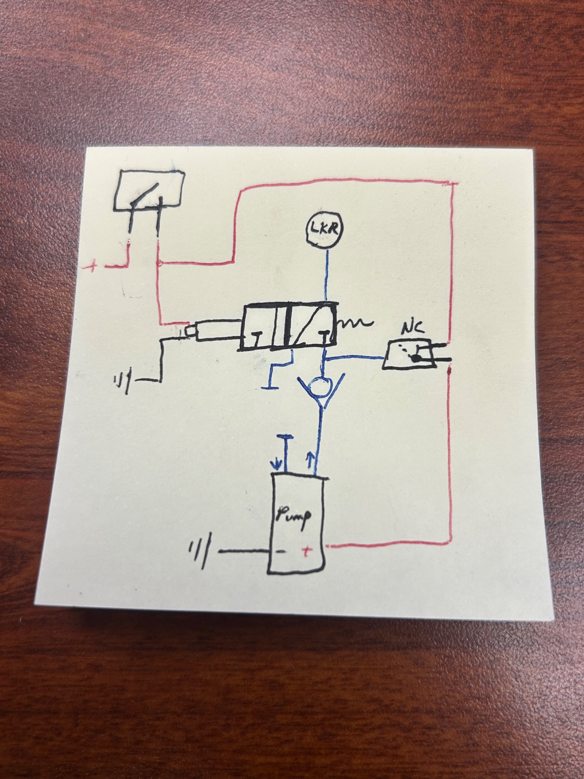

Doesn't he care that when he turns off the pump, it let's air out and disengages the locker? That was his question from the way I read it.
It can happen. My front stock Rubicon pump takes about 10 minutes to bleed off the pressure and unlock. Also unlucky for me, the rear locker had internal damage so I swapped in a full case Detroit for the rear, removed the front pump and swapped the connectors to use the rear pump for the front, so it unlocks normally now.
