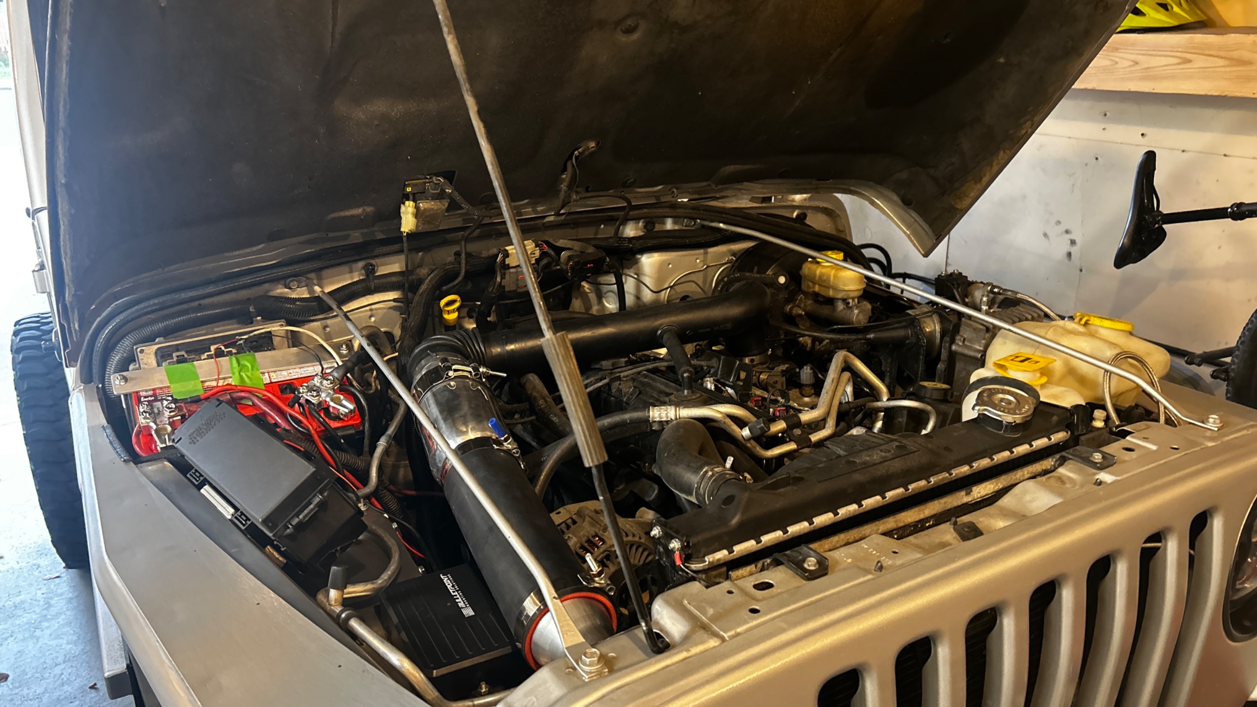

I just swapped to this filter housing set up. Had a THOR, it was terrible for many reasons but the specter solved all my issues except it’s still an oiled filter. I’m not super worried since I’m in the north east so I don’t see dust but I’d still like a paper if I can get it. Anyone know of a paper filter what would fit this housing?
I know the windstar housing and filters are preferred bc they’re paper but having to find a used housing makes things hard to find.

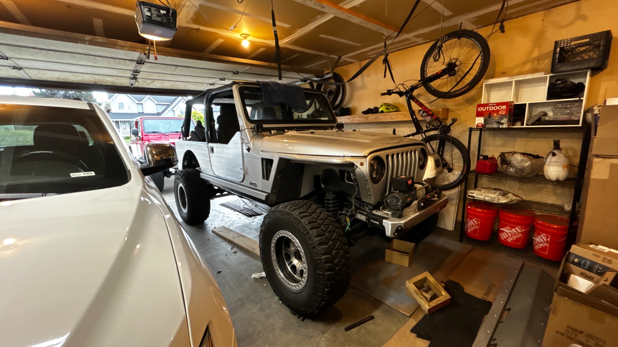

I’d say the passenger side is 90% done. The slider is on, the battery is tied down in a way I’m not happy with, but it’s tied down. Everything works. The hood is cut. That went pretty easy. Cut it while it was on the rig and then worked with the flap disk for awhile. Got the turn signal and side marker mounted and working. Not so happy with the side marker, but I don’t care that much. I had all these LED’s from years ago just sitting in the attic, so I’m using them. Still have to decide on hood pins. I can think on that. If I want to move the side marker I can do that too because that section of aluminum can completely be cut off and not affect anything. NO idea why it’s so wide. The earlier GR non-Hiline is not that wide. Oops, just noticed I didn’t take any pics of the turn signals and side marker lamps. Tomorrow. Very happy with the slider. It looks phenomenal to me. This is a big project but very rewarding. I just hope I can get the overall battery system better. Tomorrow I’ll put the cowl on, turn it around, and get started on the drivers side. I need to do the Cats too, so this may take a bit.

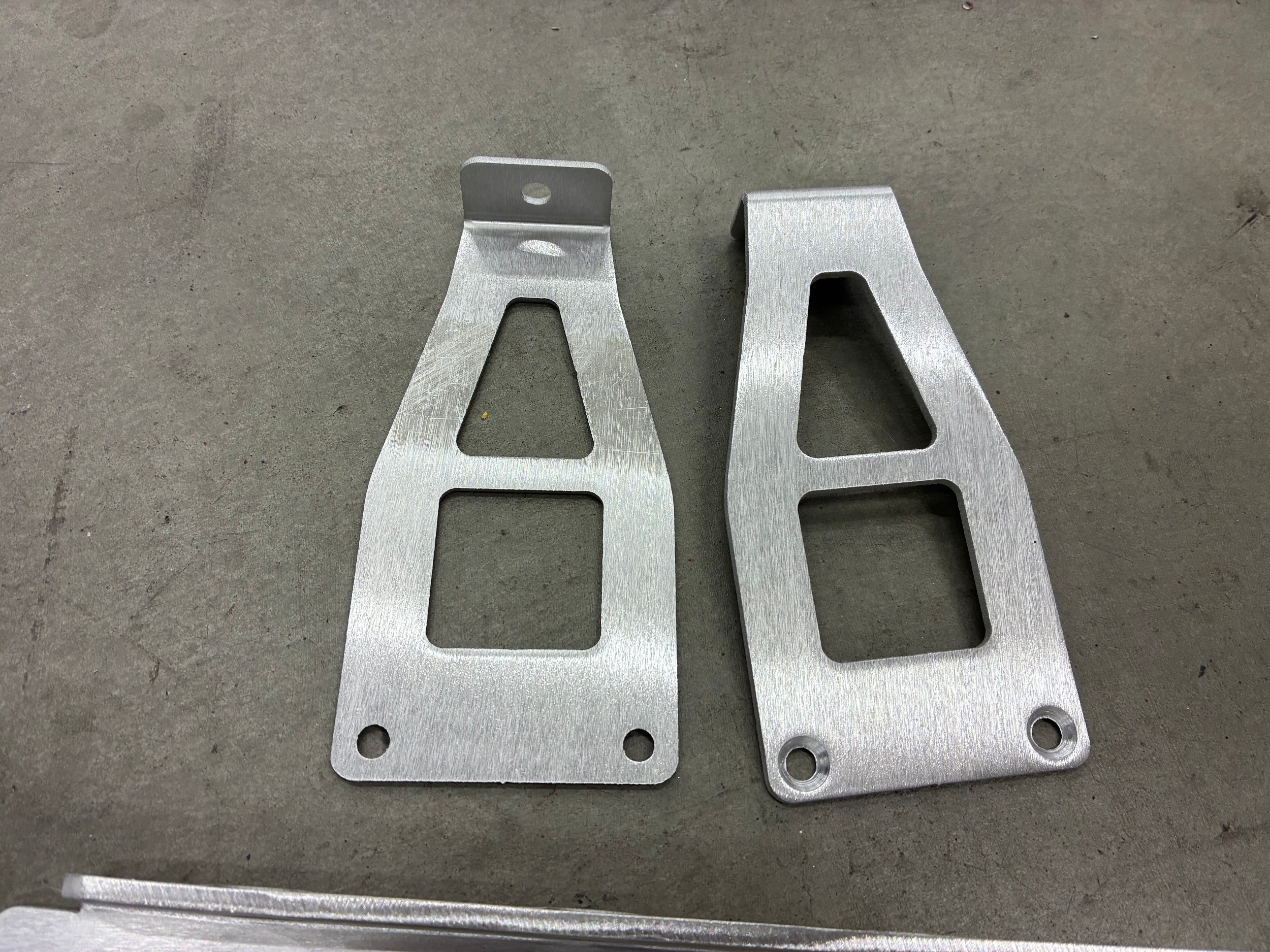

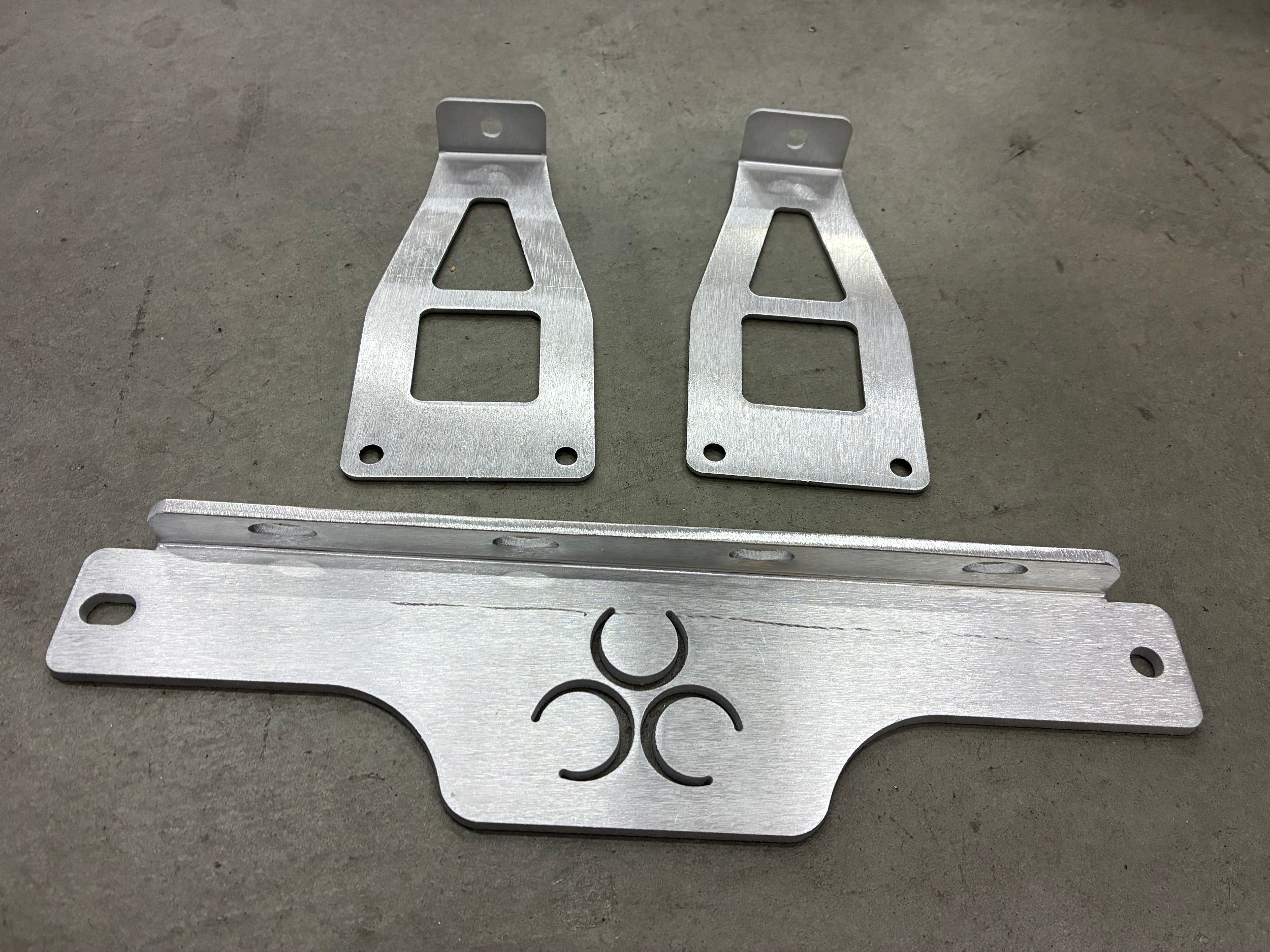

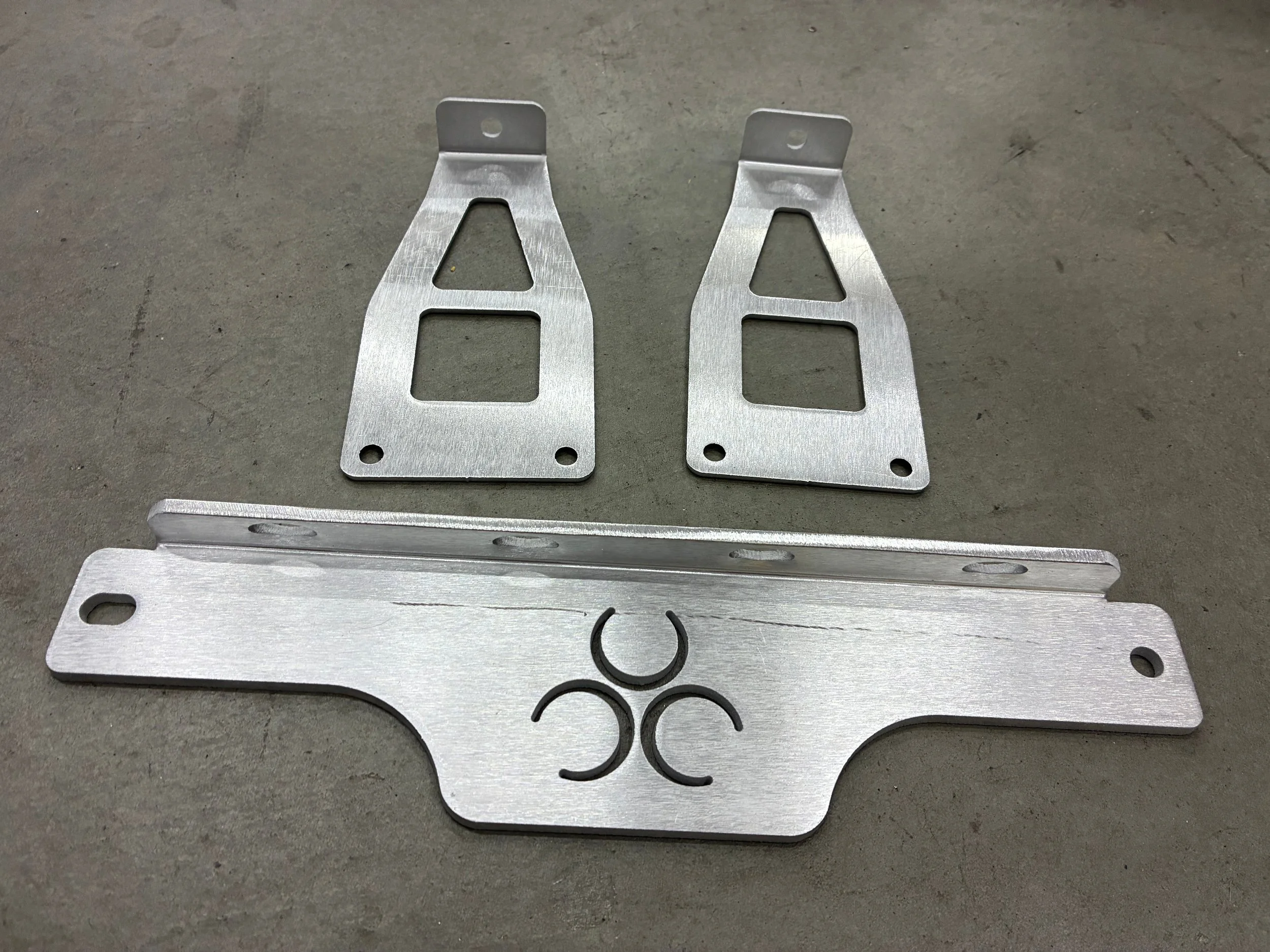

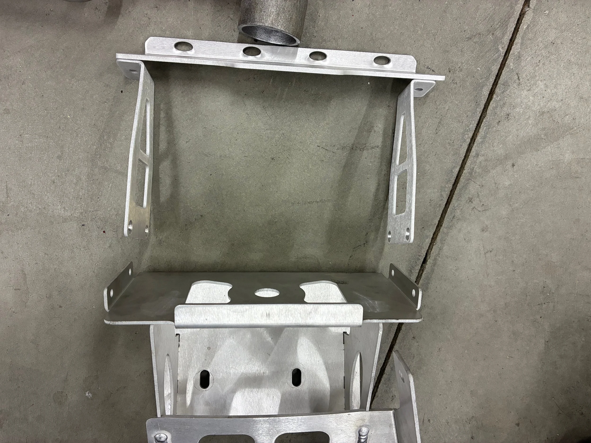

I agree with Abendage, the bolt-on battery uprights that he an I both used are solid. I can post a picture of the pieces in that kit if you want me to. It would be simple to make something similar to adapt to the GR tray.

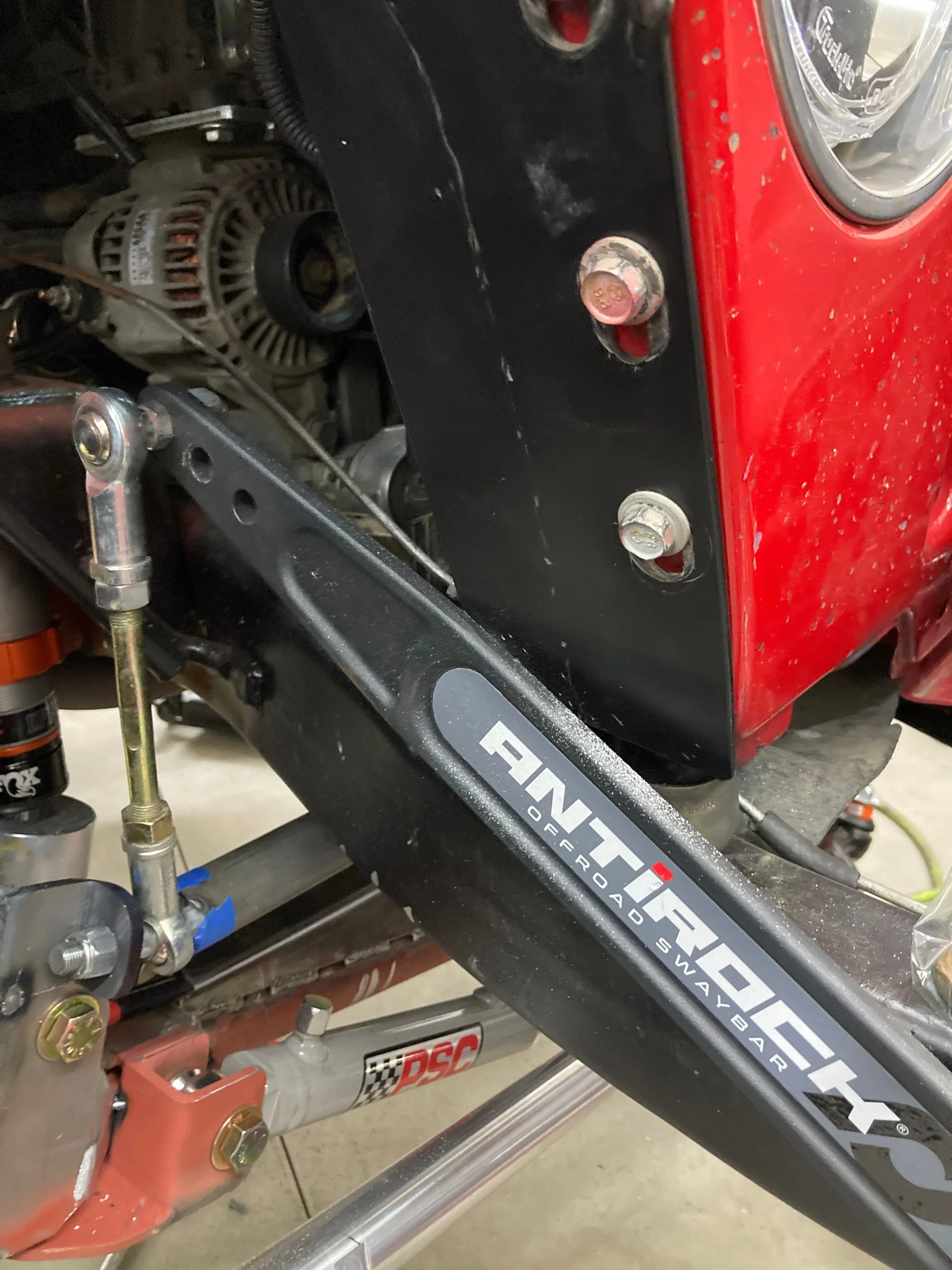

I was also wondering why GR made the fender so wide at that location. I was originally going to trim it out, and then figured it was a waste of time. The cut line I was pondering is marked in this picture.
My Antirock did hit the fender on up travel and required a 45 on the lower inside edge of the grille to fender attachment. You may have to do the same unless the SwayLOC clears this location better.
I think I see what you’re saying, but ‘bring it’! It would help to see. Thank you!
The uprights are 1/8" with countersunk hardware. The hold down is 3/16".

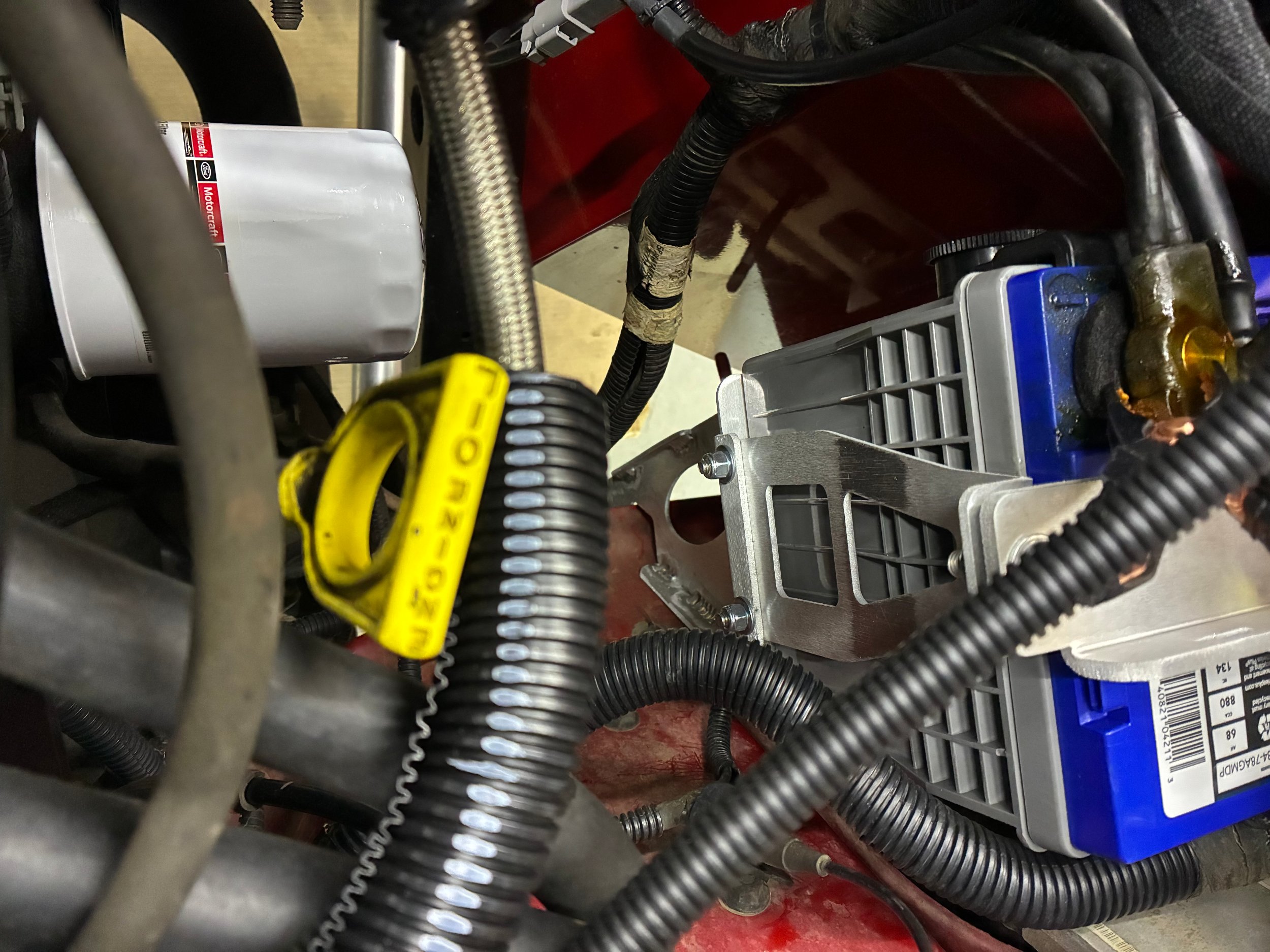

I have the older design that only takes the Optima battery unfortunately. But when my Optima craps out I’ll either buy the new setup they have, or more likely I’ll make a tray similarly shaped that bolts to the old style lower support. The new design the support and tray are one piece. Old design they are 2. All depends how much time I have when the need arises.
