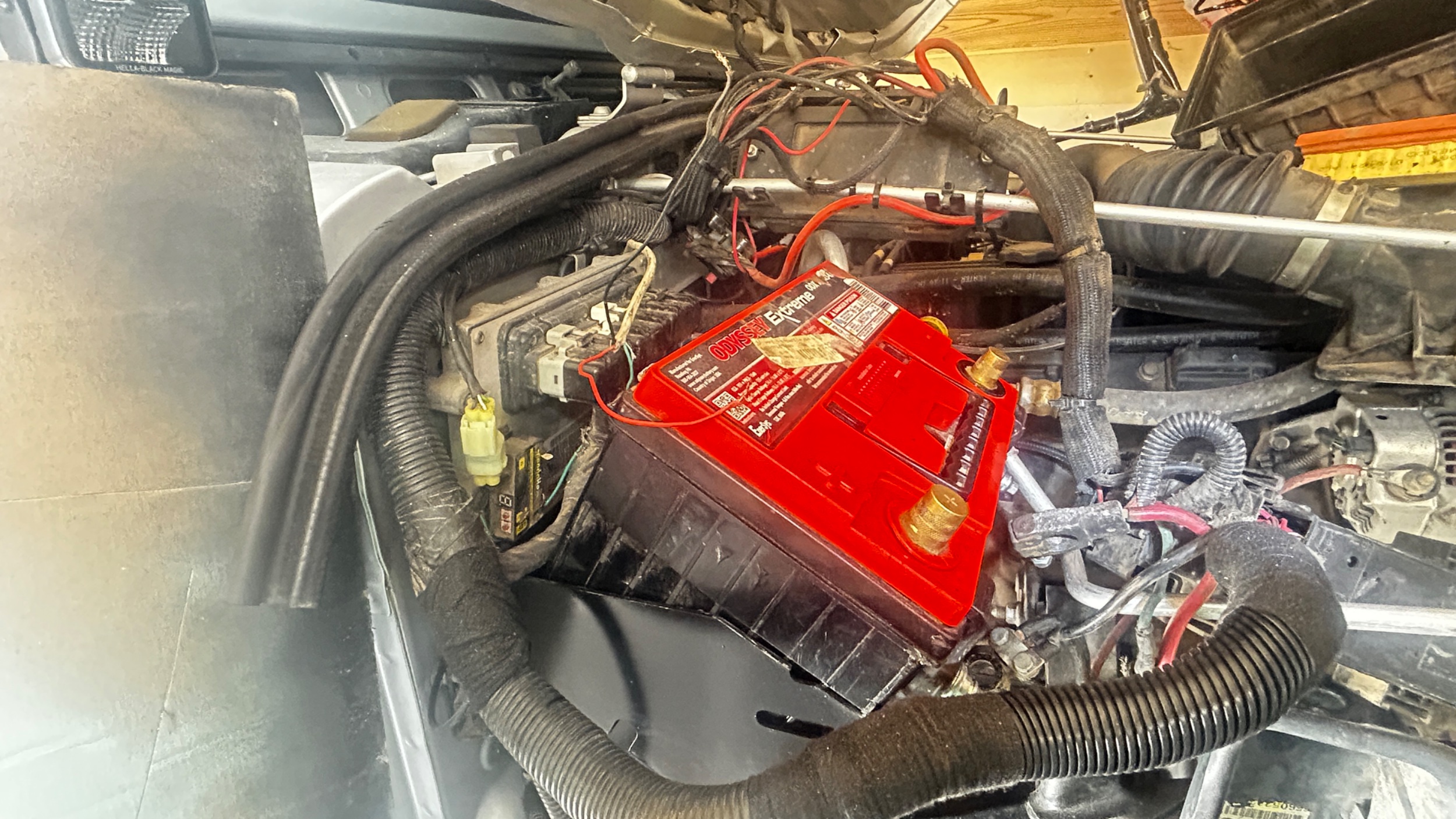

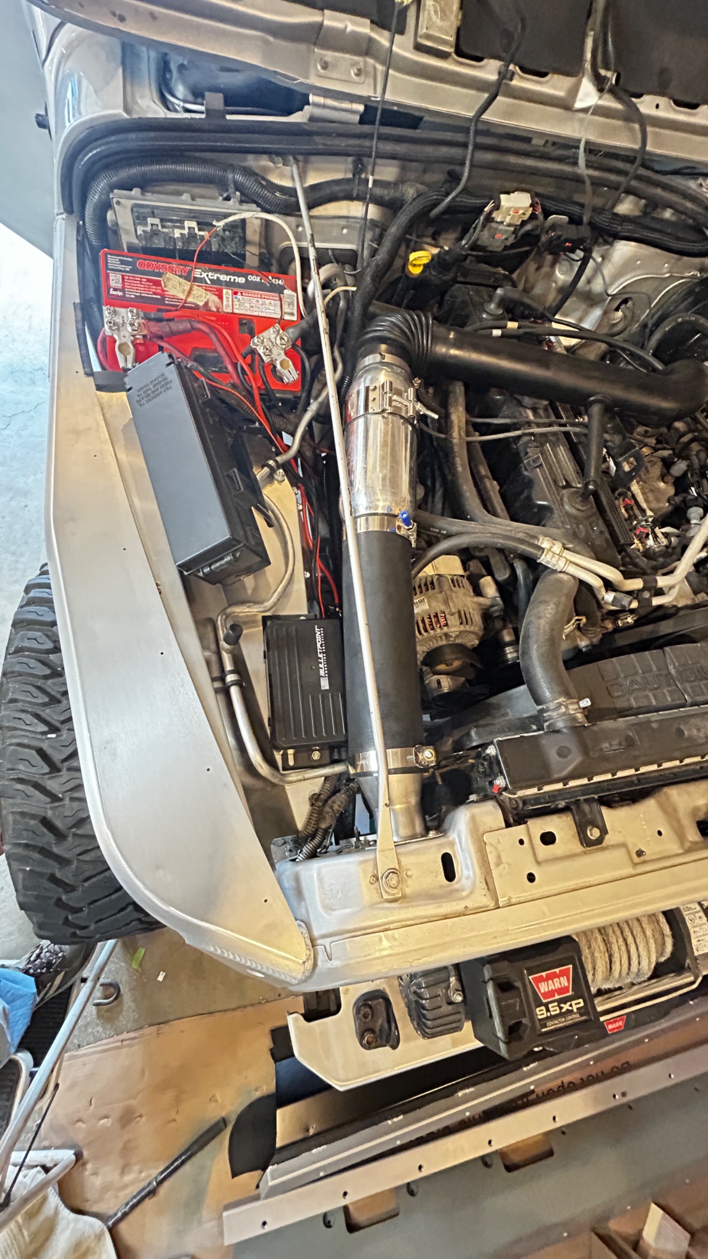

The passenger side lives and breathes. I’m unhappy with the + battery terminal location and the battery terminals. Going to have to do something. But, for now, just need to cut the hood on this side.
If you turned the battery around so that the negative terminal was towards the outside would that help any?
Reactions: JMT
I’ll look at that! It will definitely get the terminals farther away from the aluminum. I may get new cables, so it might work better as an overall solution. Thanks!
Reactions: Wildman
Reactions: JMT

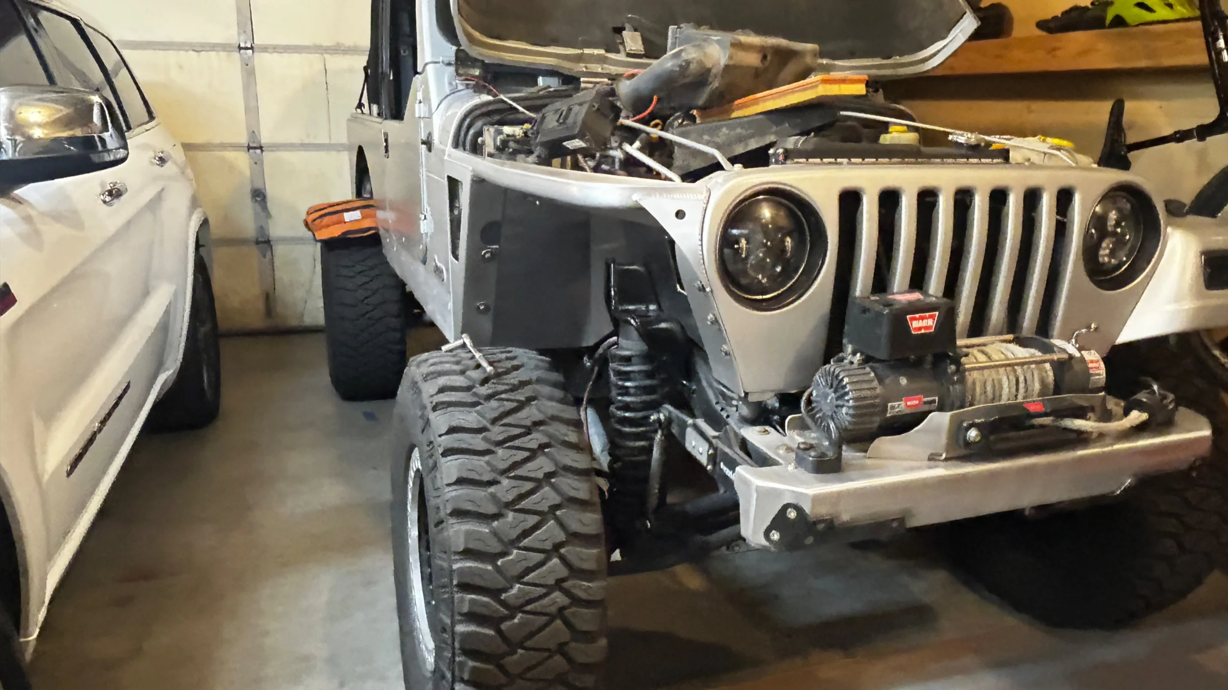

I went with the GR 0* Boulders with inners and the battery tray. I wish I’d gone with Savvy or Crawltek, but the fitment is good. I just don’t care much for the aesthetic. Functionally I get 3”up and 2.25” back.

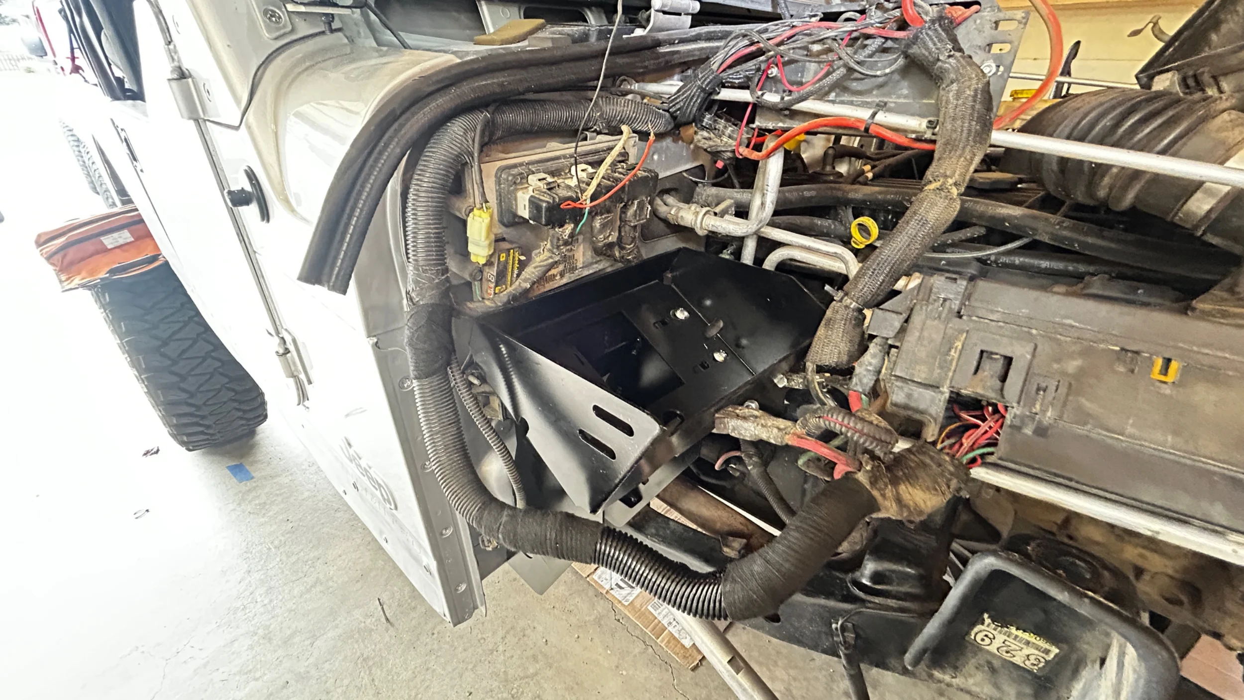

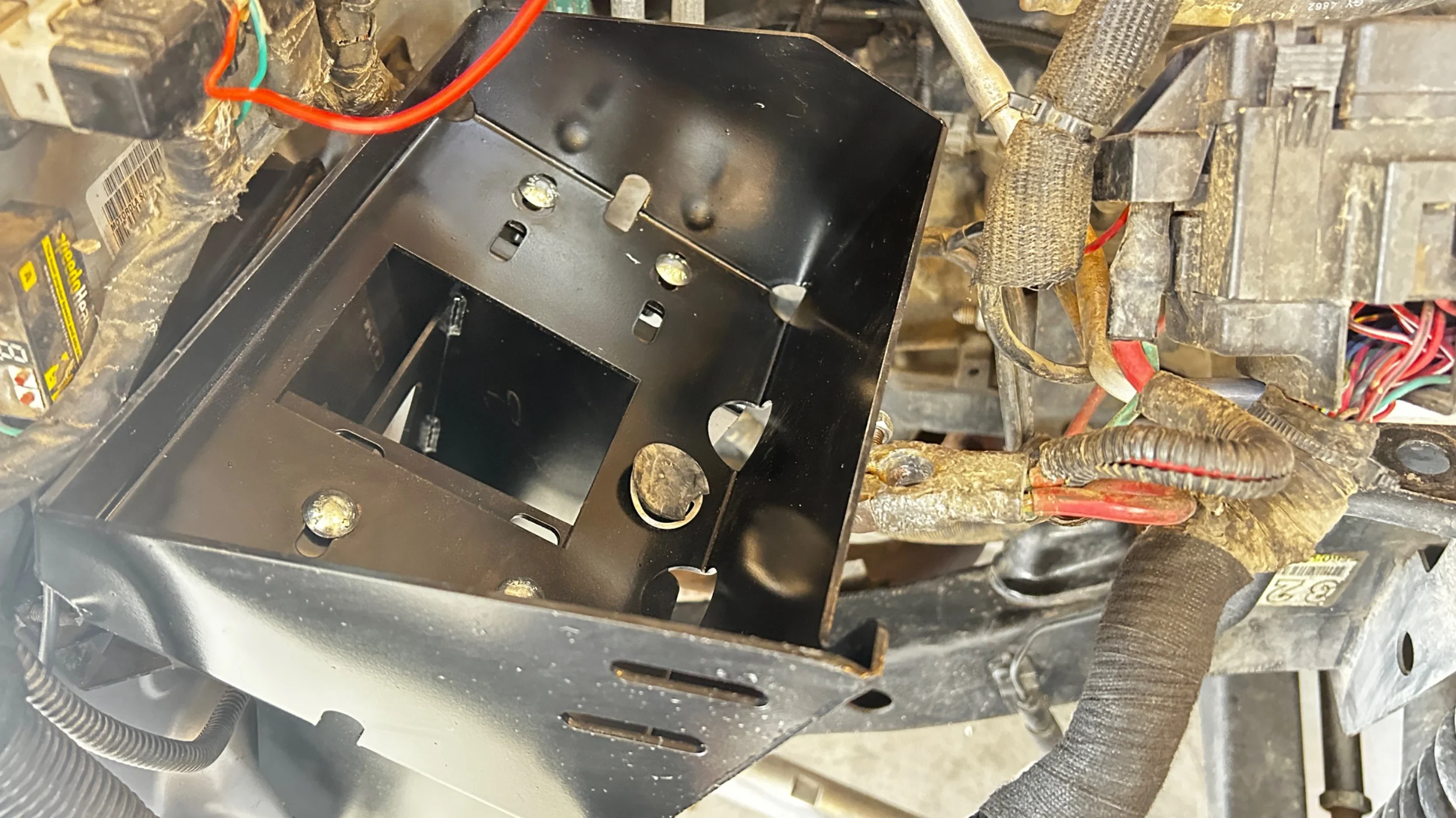

The battery tray is just ok. It needs some work. The battery won’t slide in because the battery GR suggests has fins that get in the way. Trim those off and it still won’t fit. The extra front terminals hit the tray so you have to trim it. The upper protruded portion of the battery hits too, so you just have to trim all over. The front terminals are useless because there is hardly any space between the battery and the inner fender. Other than that it works.
Not that you probably want to spend more money, but the Nemesis battery box drops the battery much lower in the fender space and in a better position. I debated the two boxes during my TJ build and went with the Nemesis.

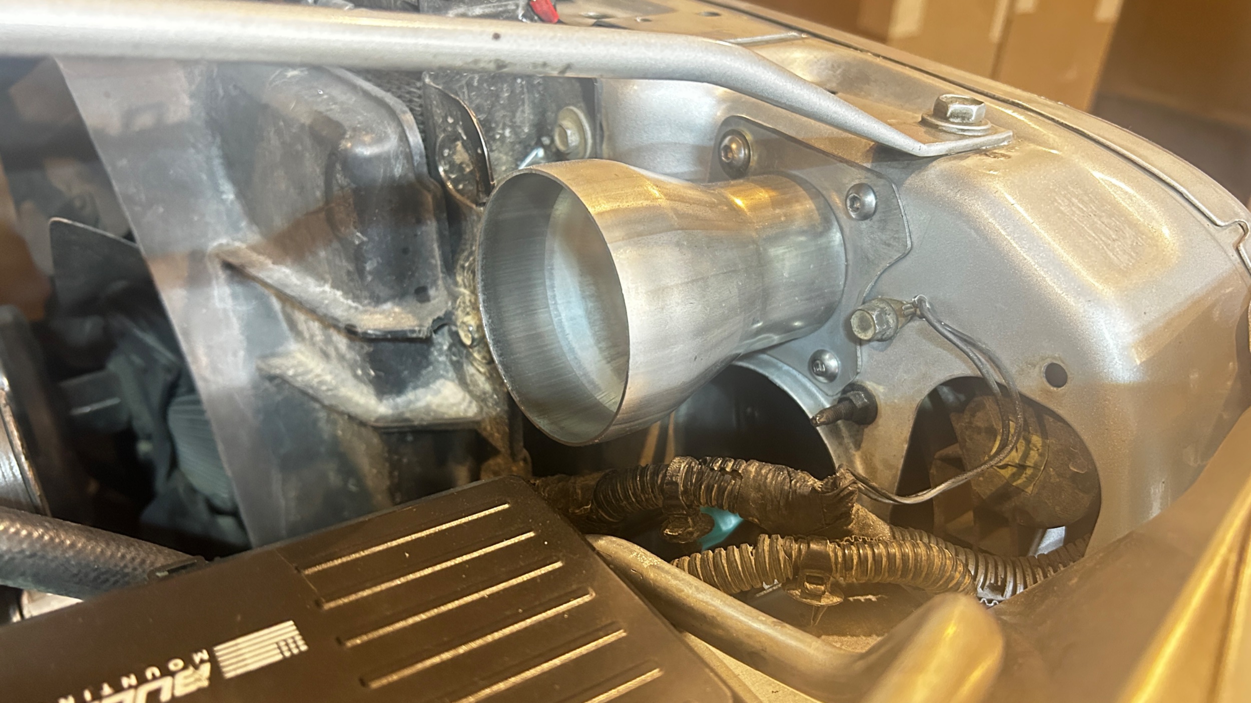

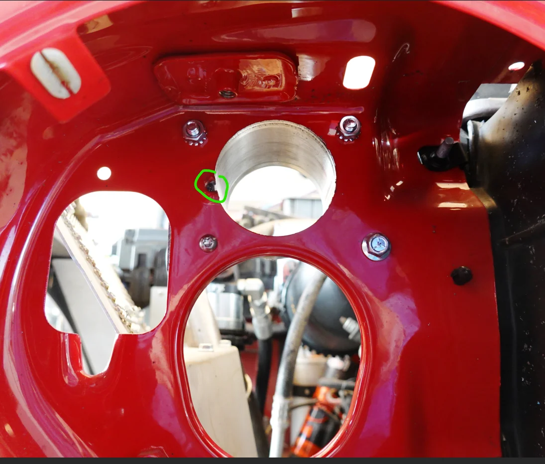

It’s a Spectre 4” aluminum box with the 9833 filter. Got the idea for the inlet behind the headlight from @mrblaine. The pics I saw of his looks better, but I’m happy how it turned out.
Did you fab the grille piece?

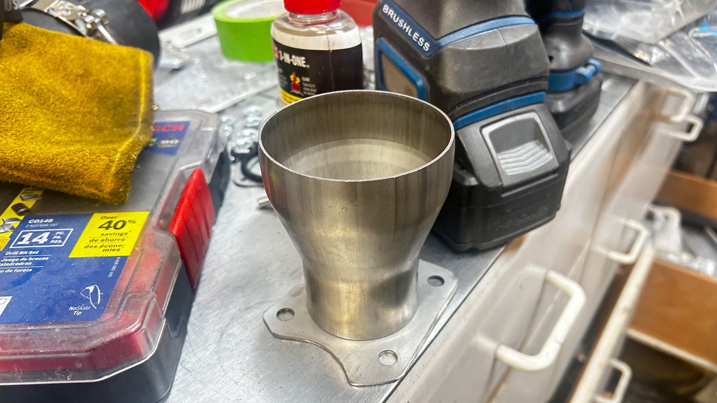

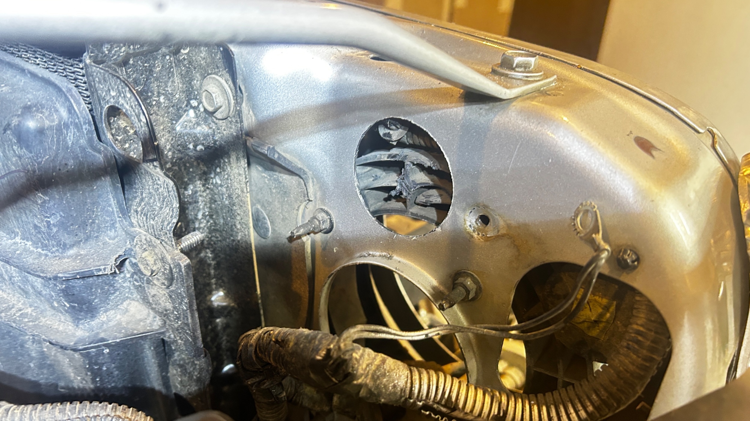

I found a 2” SS tube with base and cut and trimmed the base till it fit the hole I drilled behind the light (2” OD). Then found a SS exhaust tube 2” OD-3” ID. They didn’t quite fit together so I put the exhaust tip in the freezer, then block of wood and hammered it right on. Silicone 3” ID intake turbo inter cooler tube fit over both the Spectre and the exhaust tip. It all worked out better than I thought. Was able to preserve the stock accordion and tube.

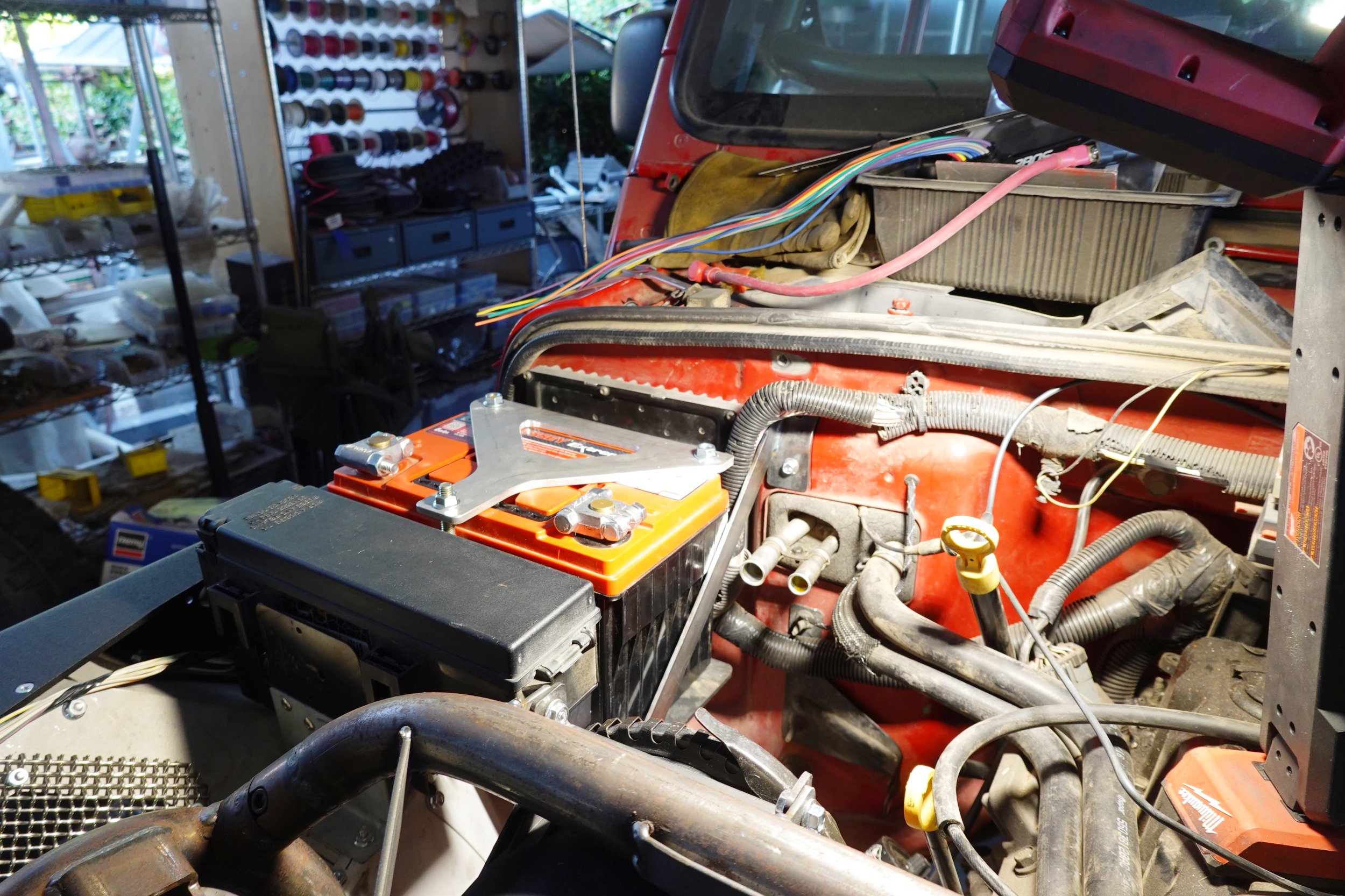

Building a new battery tray or building a new bracket for the factory tray is also an option. On my Krawltech fenders, I set the factory tray on top of the tiny Krawltech tray and added more bracing to the firewall. That was a reason to move the PCM higher. Most are little Wizard tricks for this type of project.

After multiple looks at yours I thought it might be 2.5”, especially after I received the 2” tube. I went ahead because there is so little real estate there and it opens up to 3” within 1.125”. Both are larger than stock, so I hoped for the best. Nice job on yours and thanks for the idea. I could have done the Windstar out the cowl but really liked your solution. I can still use one in the current location if I decide this filter isn’t working out.

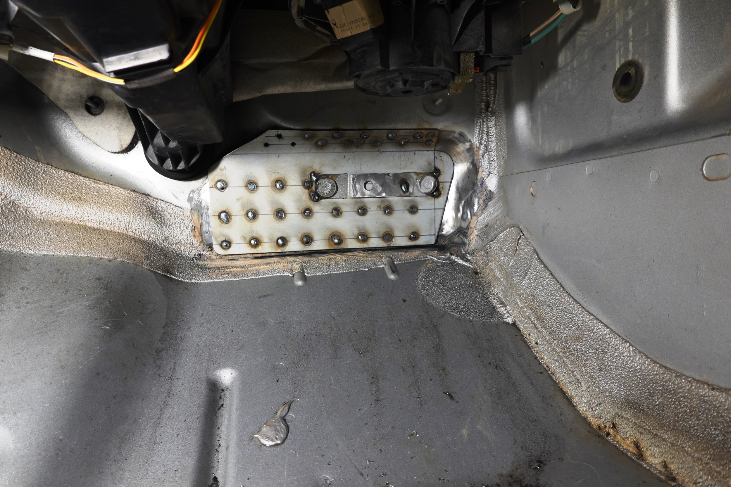

It is far too often overlooked by the sellers and designers of these type trays that setting 50 pounds on top of a tall pedestal and only using 2 or 4 of the firewall fasteners is a recipe for disaster. The below is the result of a Metal Cloak tray and I've done similar to the damage a Genright tray caused. My first 2 Crawltek trays didn't have any holes that lined up correctly so I had to do that from scratch and they've been fine. What they miss is the front of the OEM battery tray is bolted to the fender stamped wheel well and while it appears to just be thin sheetmetal, it supplies a shear panel to the front of the battery tray and prevents up and down movement that stops the fire wall from cracking.
The round fastener heads are the two studs you see on the engine bay side. They were completely cracked out of the firewall sheet metal. I built a 14 gauge repair panel and spot welded it back in.
If I can't pick up enough bracing to stop the tray from moving around at the fender somehow, I add a brace as high as possible.

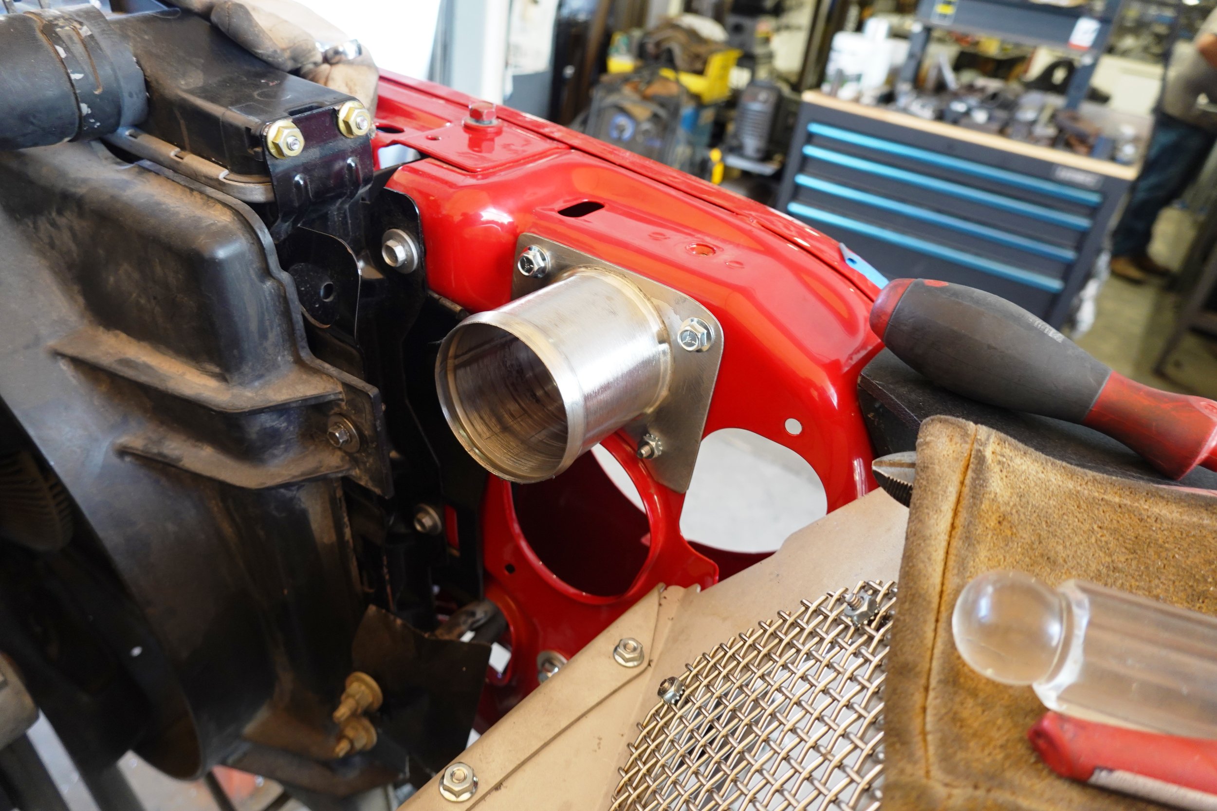

There is plenty of real estate, you just have to be patient about your lay-out. You protected your grill harness grounding location. I know that metal is metal and where the grounds attach to the grill is of no consequence so I simply relocated them to one of the inlet base plate fasteners at final install.
I also know that the headlight bucket studs don't care if they go through 1 layer of sheetmetal or 2 to hold the headlight in, so the lower holes are clearance for the head light studs to go through.
