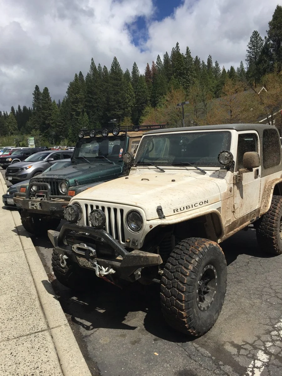

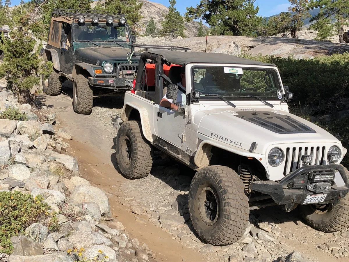

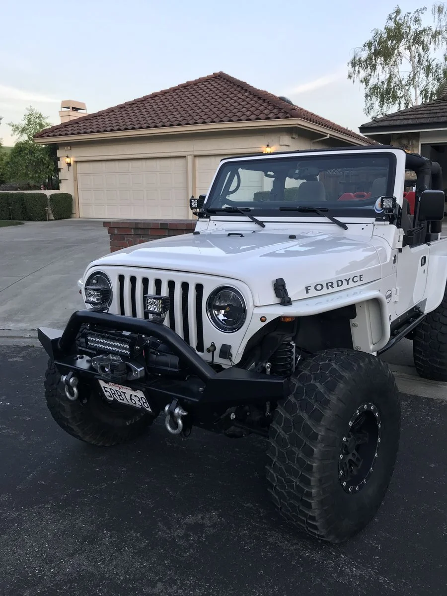

I have all Rigid LED's Long Range on the windshield, Floods w/ side shooters and a 10" Driving Bar light on the bumper. I used to have the KC slim lights but I like the LED's much better

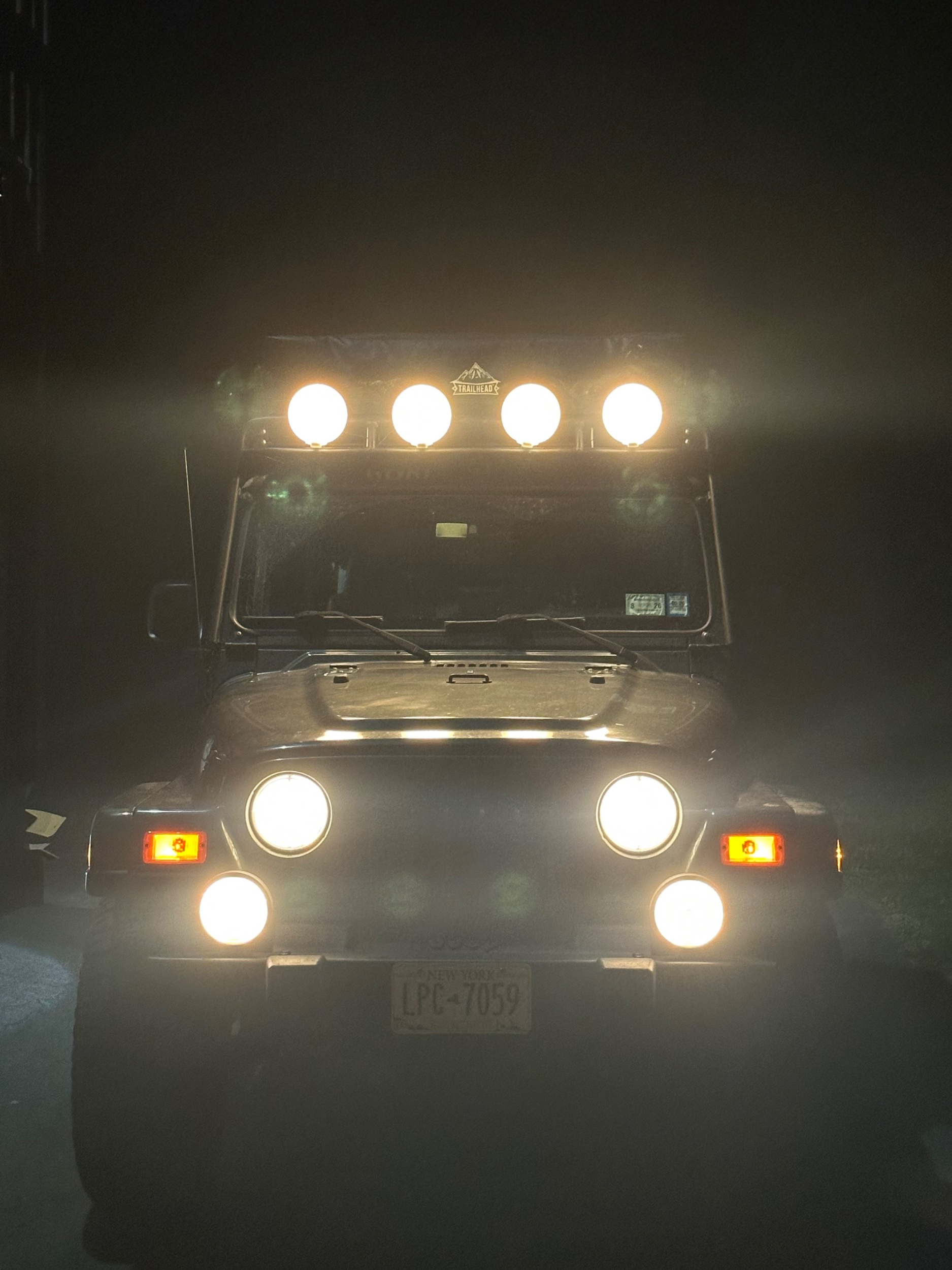

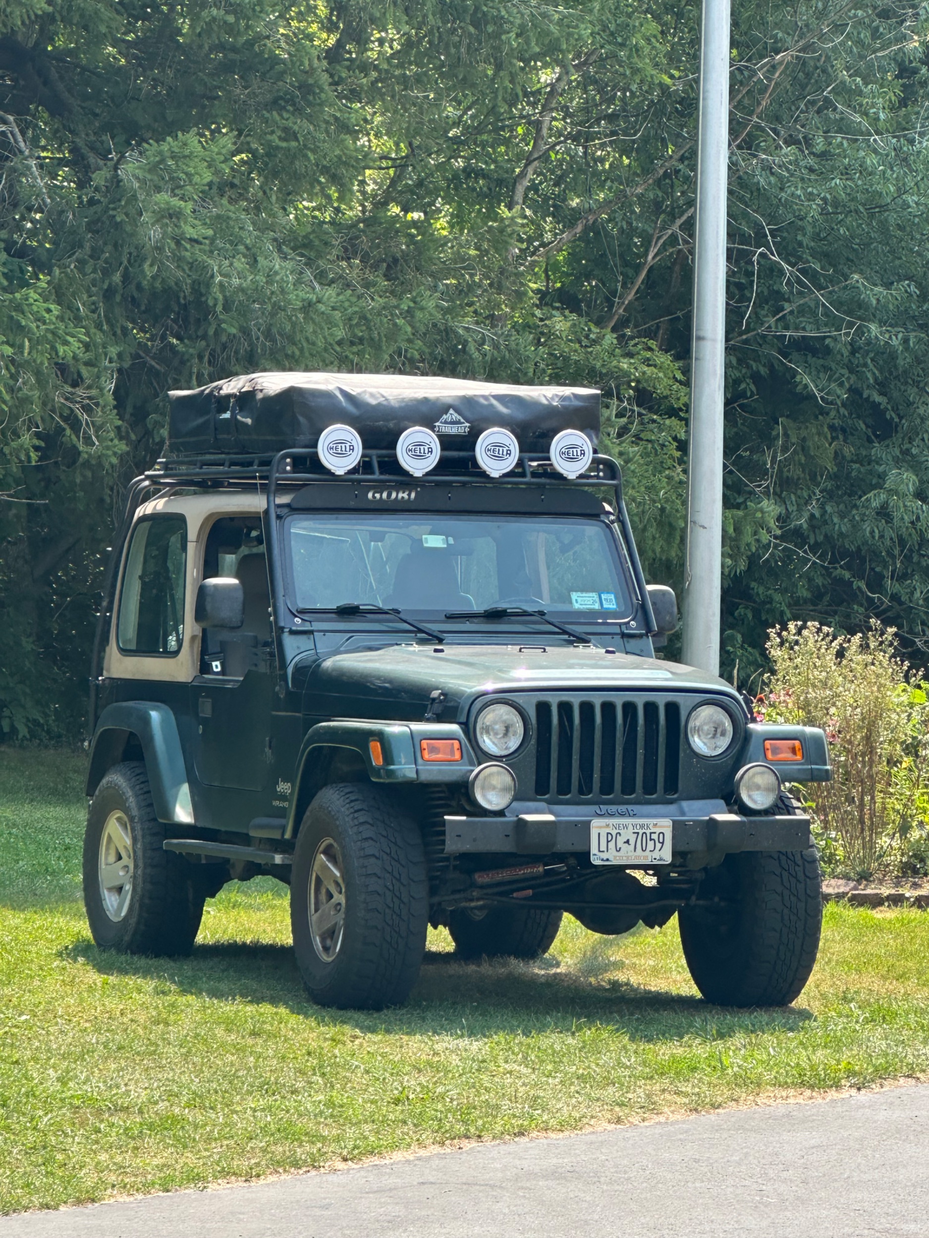

I did the combo of hella 500 and 500ff on my roof rack. Wired each pair to its own relay with shared hot and ground. They are very bright! I preferred the classic look, and if it gets cold the halogen bulbs will melt any ice. Also hella are a very affordable option.
