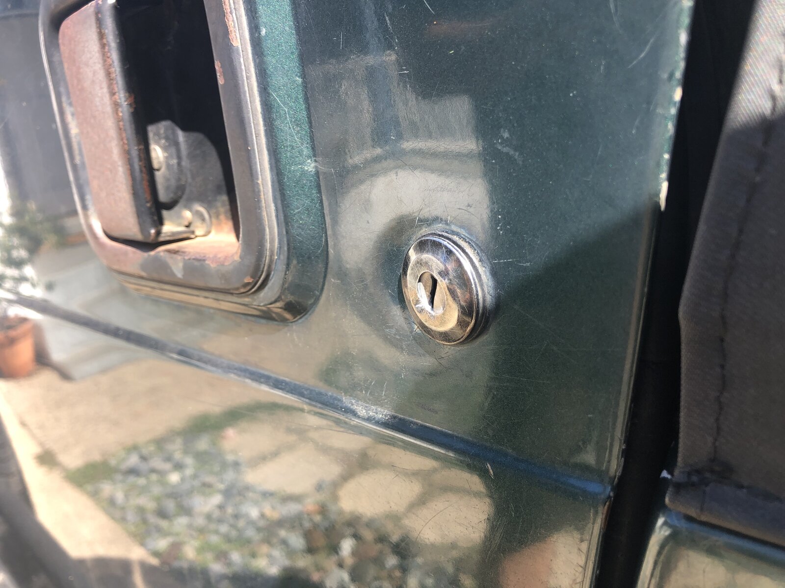

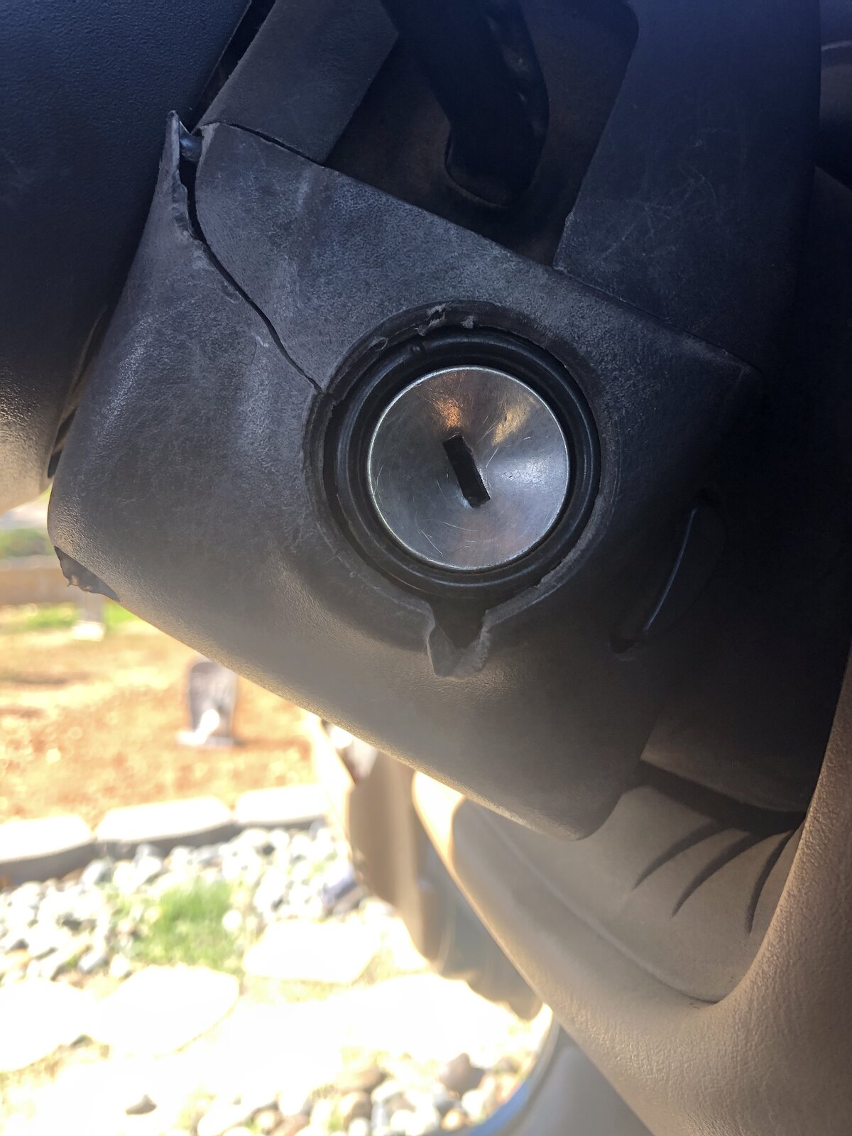

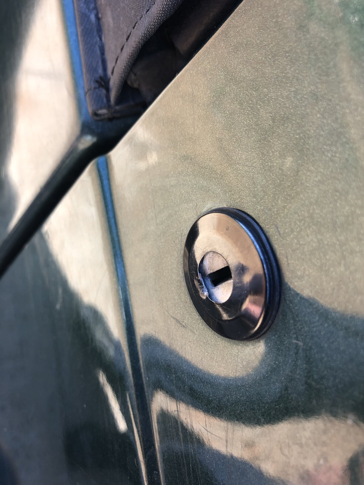

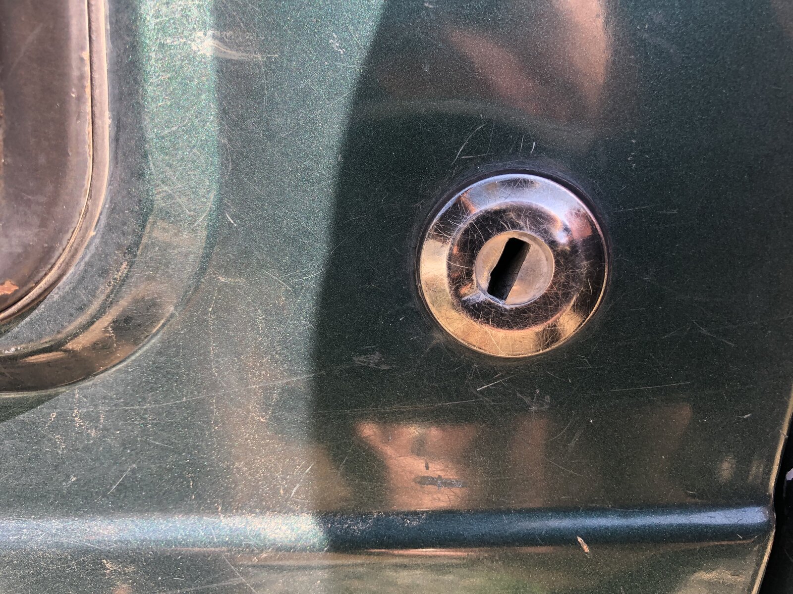

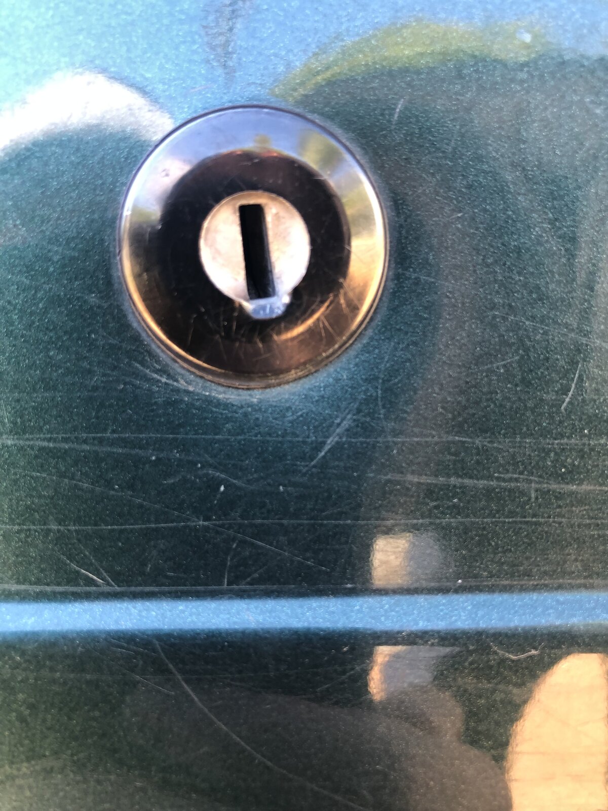

Went to see my buddys jeep today. Here’s the obvious damages View attachment 285154View attachment 285155View attachment 285156View attachment 285157View attachment 285158hard to tell from the photos but the lock cylinders were both damaged with denting to the doors. Other than the steering shroud damage the cylinder looks intact but something was shoved in there and when the battery is turned on the skim key light is illuminated. No codes.
Will it start and run?
it will start and run for a few seconds then die. I pulled it up the road for him to his house today.
They likely broke the antenna around the ignition lock cylinder or managed to unplug the SKIM somehow. The key symbol should illuminate when it is dying in 3 seconds or so since it isn't recognizing a valid programmed key.
