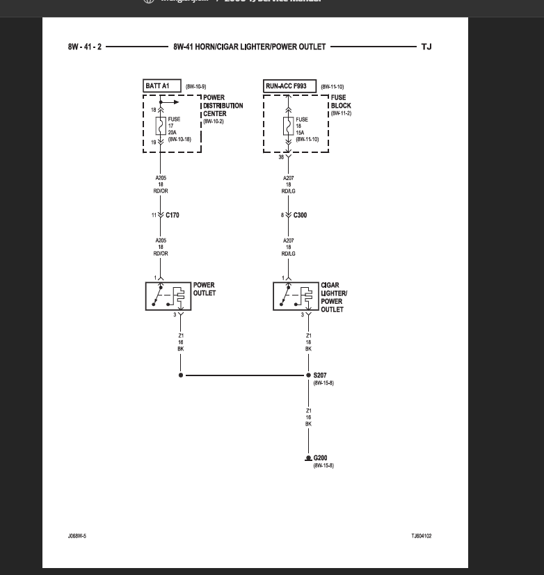

Problem statement: I want to make the second 12v port (Cigarette lighter port) and make it switched so that it only has power once the key is in the ON position. Has anyone done this? How would I go about it? My electrical skills are as a good as Red to red and Black to Black. I can do Basic wiring and understand how switches work.

Use the cigarette lighter power to trigger a relay to control power to the aux. Better yet add a bypass switch so you can select modes.
-Mac
Yep this is the easiest solution. Power the new relay coil from the cig plug that is switched then just cut into the power wire to the unswitched plug and wire the ends to pins 30 & 87. (Get a relay that comes with a pigtail socket)
Would you need a relay, Looking at the diagram, you could just splice the switched power wire into the un switched power wire on the Aux port and that would suffice? I may be missing the point of the relay.
You could but then everything would be on that one circuit, unless it already is on the same circuit? I did not look at the diagram.
edit: took a quick look at the 2006 diagram, your switched outlet is on a 15 amp circuit and your unswitched is on a separate 20 amp circuit, so if you tie them both to the switched 15 amp circuit you will be giving up the separate 20 amp circuit and losing 57% of your total capacity..
From the diagram, the Cigar lighter is tied fuse 18 and the Aux power is tied to fuse 17. I am not skilled in reading electrical diagrams so it may be the same circuit.
