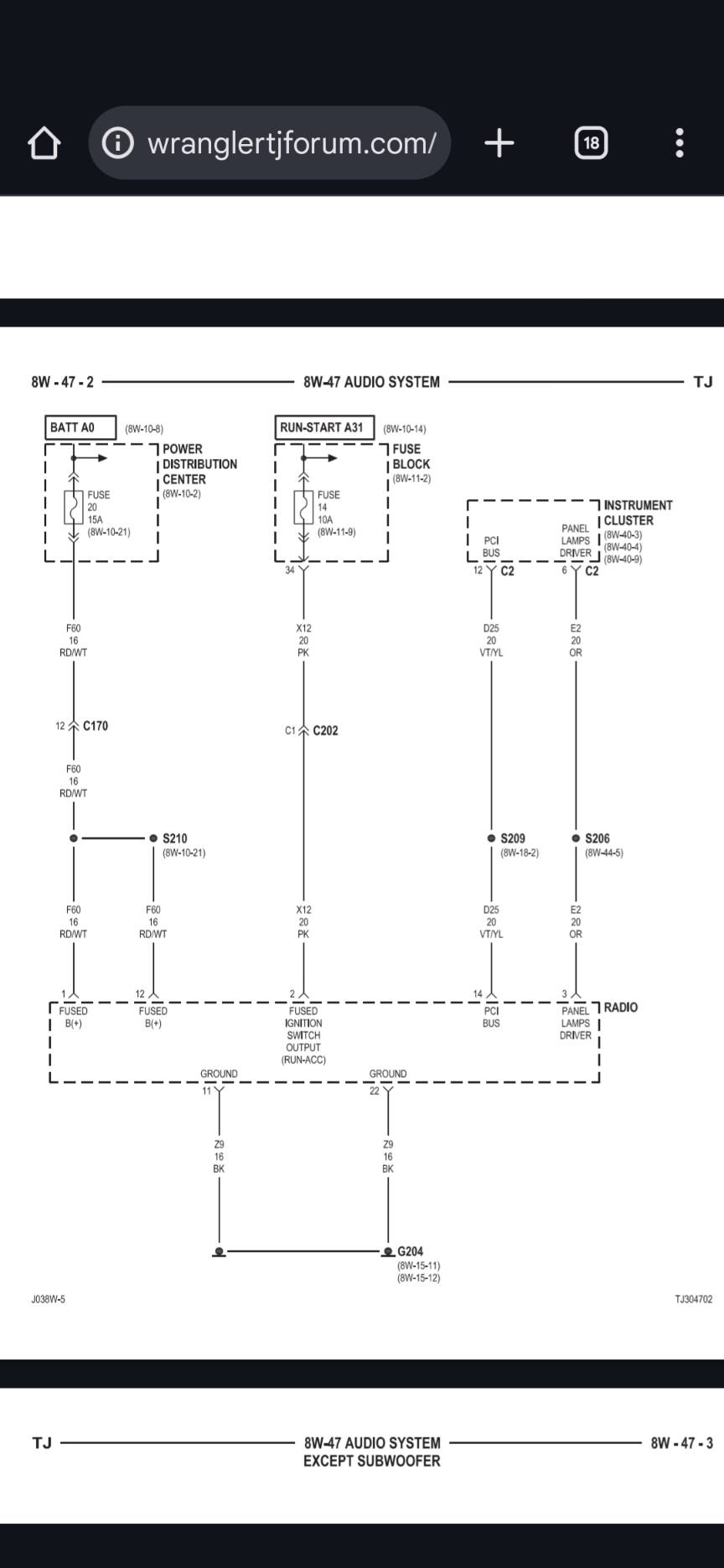

I confirmed tonight the radio gets power regardless of the gauge fuse being in or out, it's just the display & sound through the speakers that are affected. Also it's just the display & sound that kicks on when I push the key in. So bypassing IGN switch power won't do anything for me I guess. The wiring diagram was helpful though, thank you @Wildman.

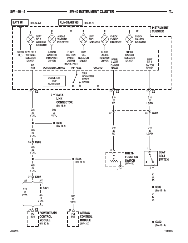

I went through this a few years ago for a friend but the guy needed the jeep back. He then sold the jeep. I think that I traced it down to the data wire between the cluster and the radio. I never got the chance to disconnect it and test my theory. I forgot which wire was though. Check the FSM.
Are you referencing the VT/YL wire in the screenshot? Would I be looking for a short somewhere? Maybe in the radio connector or the cluster connector?
Yes. See if you can un-pin it from the radio or cluster connector. Then test and see if it still acts up.
Alright @dbbd1 you have sent me down the path to finding a solution. Not sure if it's the "right" solution yet LOL.

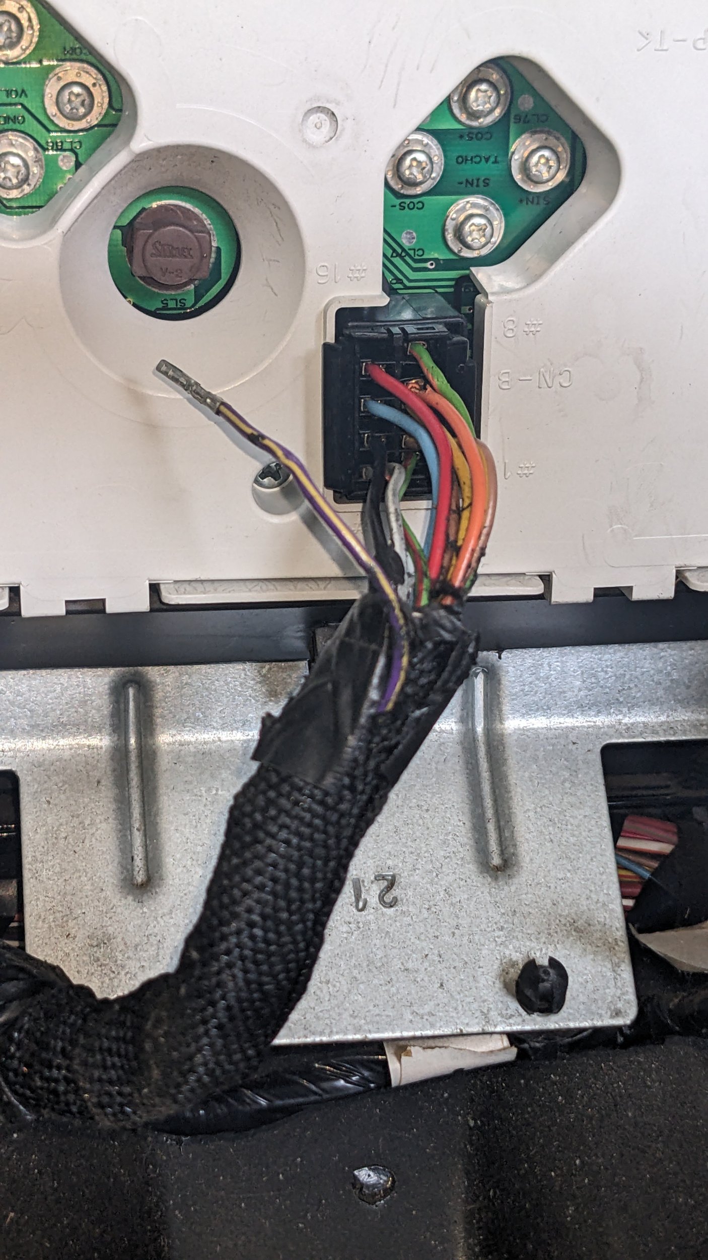

- I took the instrument cluster off and there are two wire harnesses that clip into it. I unplugged both, IGN ON, radio works. Plugged the bigger of the two connectors in, IGN ON, radio works. Plugged the last (smallest) connector in, IGN ON, radio does NOT work. I then identified the VT/YL wire pulled it out of the connector plugged it back in, and what do you know, radio WORKS.
So... Experts in the forum, help me understand what I'm working with now if I leave that wire undone, obviously it's there for a reason. But the radio works so I'm tempted to leave it, haven't driven it yet so I'm not sure if everything functions. See the screenshot from a few posts ago and below. Data Link Connector, PCI Bus to the Airbag Control Module & Powertrain Control Module. What does all that mean if the wire stays disconnected?

Including a picture of the connector and wire in question for any future folks interested in chasing this type of issue.
