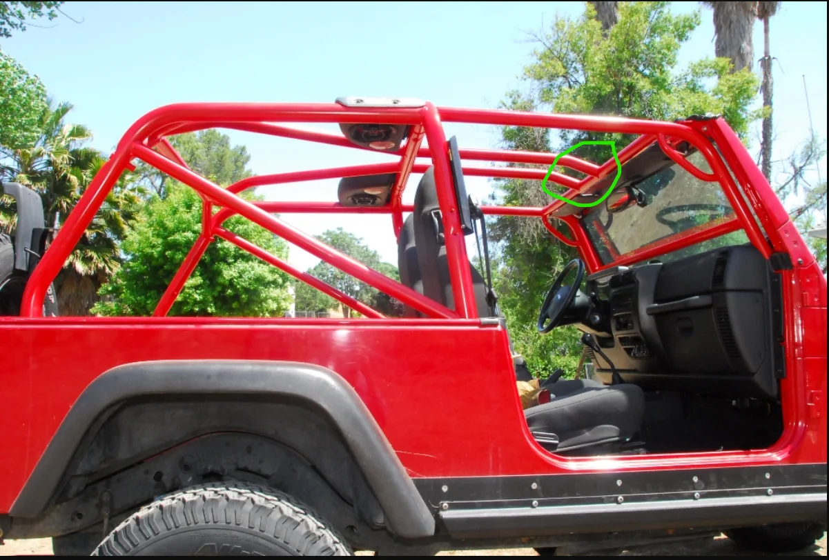

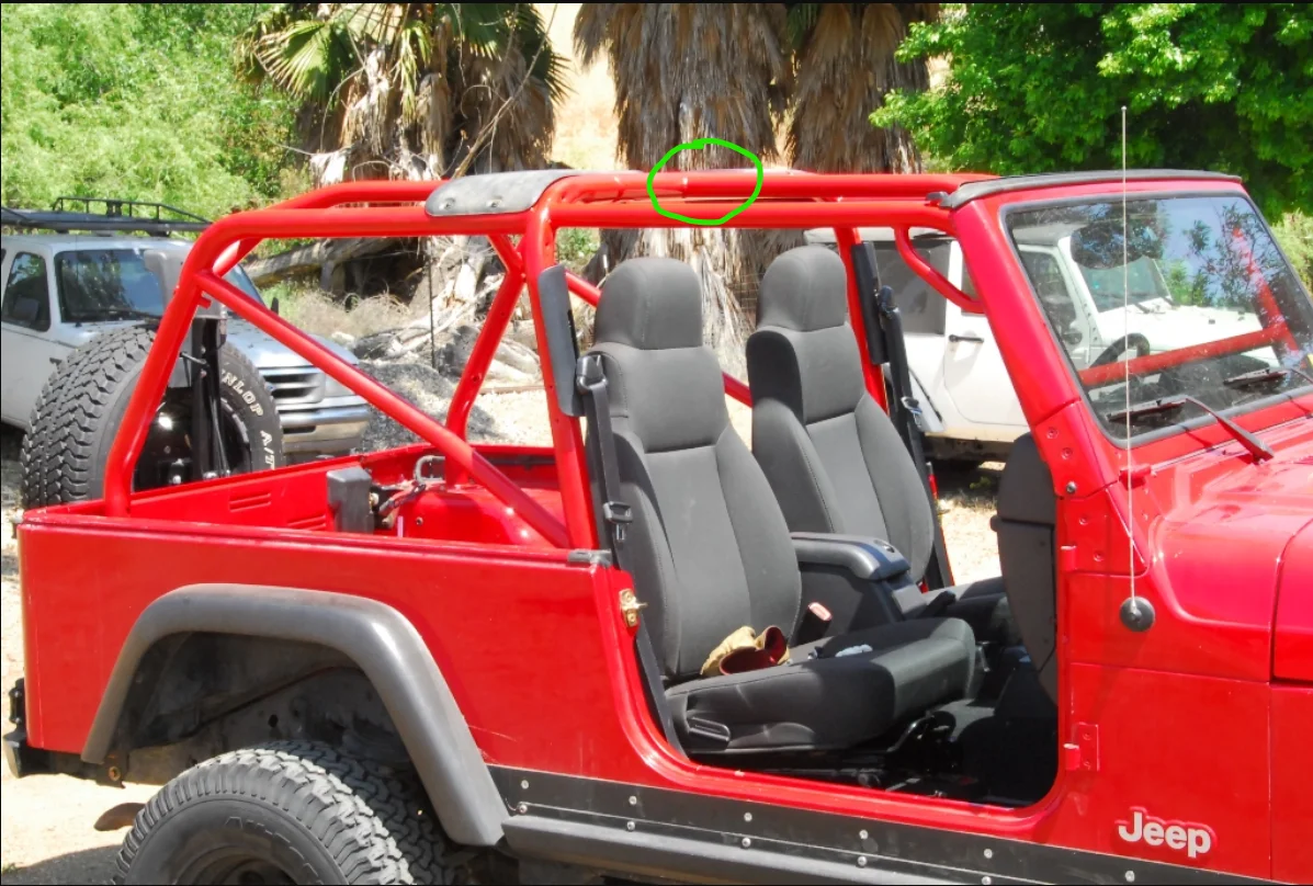

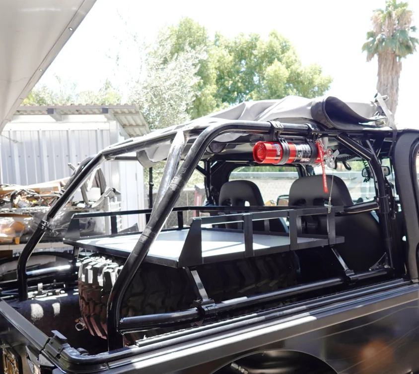

The reason that Poly retained the B pillar is there is nothing wrong with it. It fits, it has good head room, and it has all the attachment points for the seat belts already done. It is also stronger than the hoop that was used on the one you had built. If you study how they did it, note that the bars over the seats bend upward starting at the highest point they can push the A pillar connector. Or put another way, the bars go forward off of the B pillar parallel to the streamer bars until they hit the A pillar connector with a downward bend.

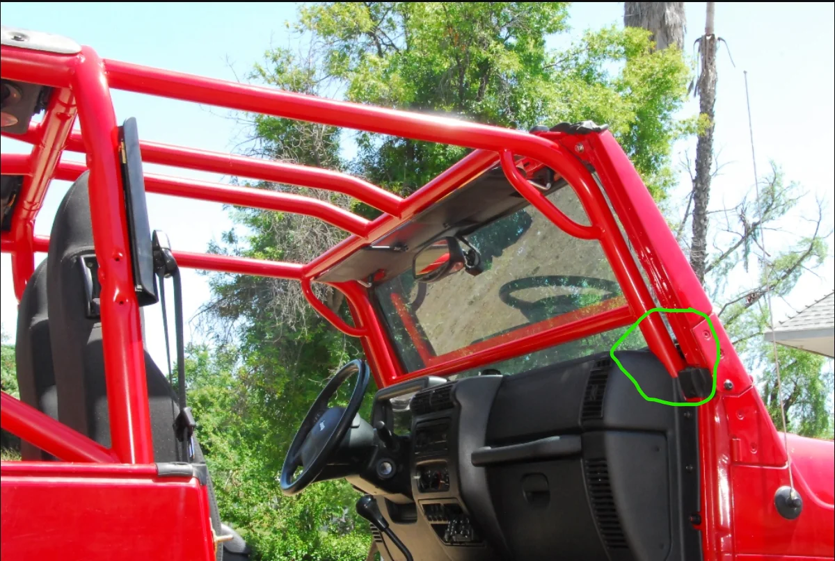

Also note that the A pillar connector is far enough back to operate the visors and the hard/soft top latches without cutting them off like yours are.

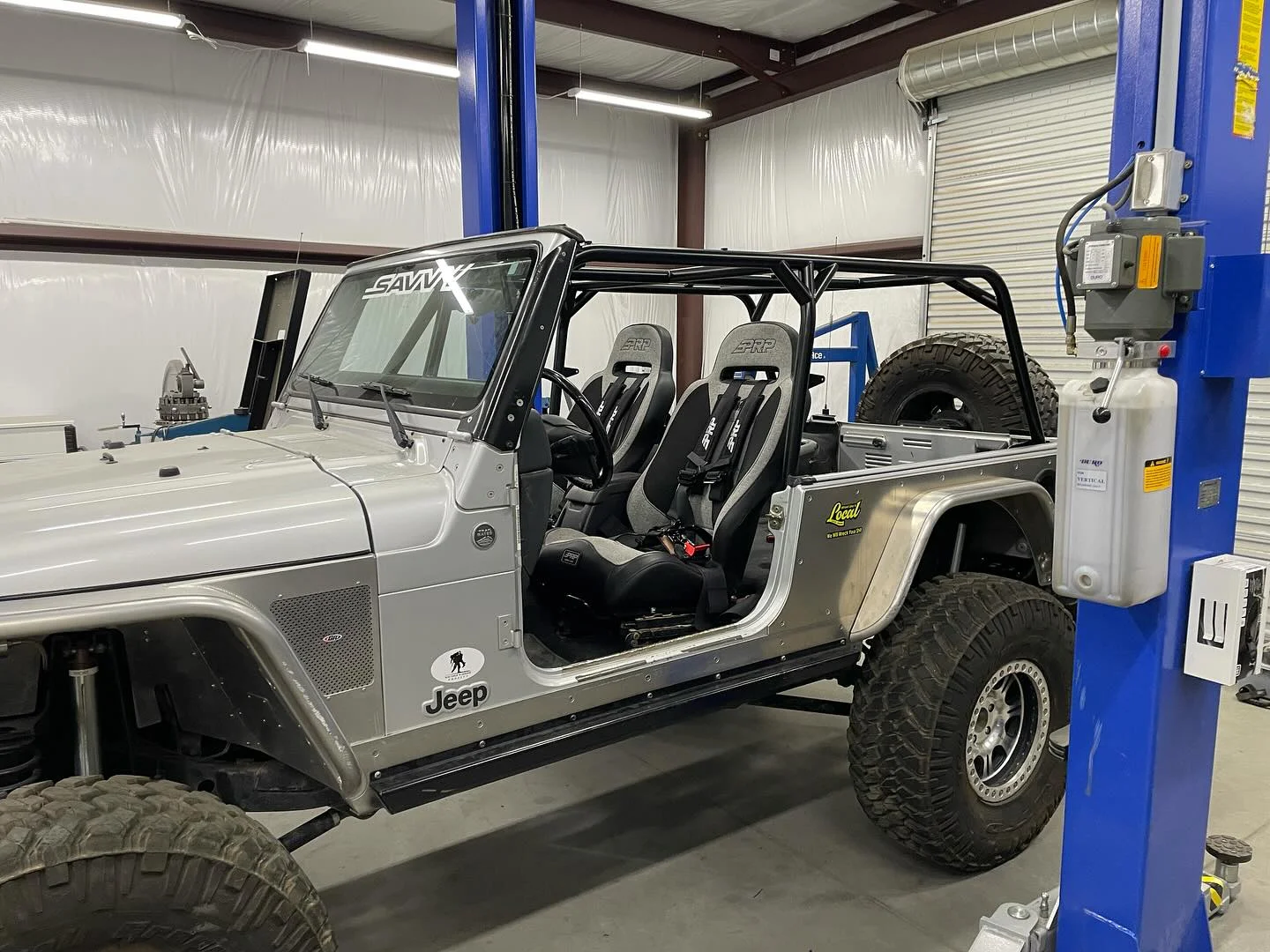

The issue is always the same. By the time you account for all the nuance that is required to get something in the rig that allows the dash to be worked on, head room, and some sort of brace behind the seats, it winds up looking like a wonky fucking mess. If you make it look like a more traditional "cage", then the inconvenience factor is stupidly high and unsatisfactory. There are many things wrong and incorrect about this red one except for convenience. It works around all the problems that make it less than fun to be in while driving, but it solves very few of the problems that make it safe enough to trust.
You can however, use it to figure out some changes for the repair or replacement of yours. In the first pic, the bars over the seats are above the top of the windshield frame. If they are not that way, they are too low and that is also one of the things that makes a TJ cage look like crap.
