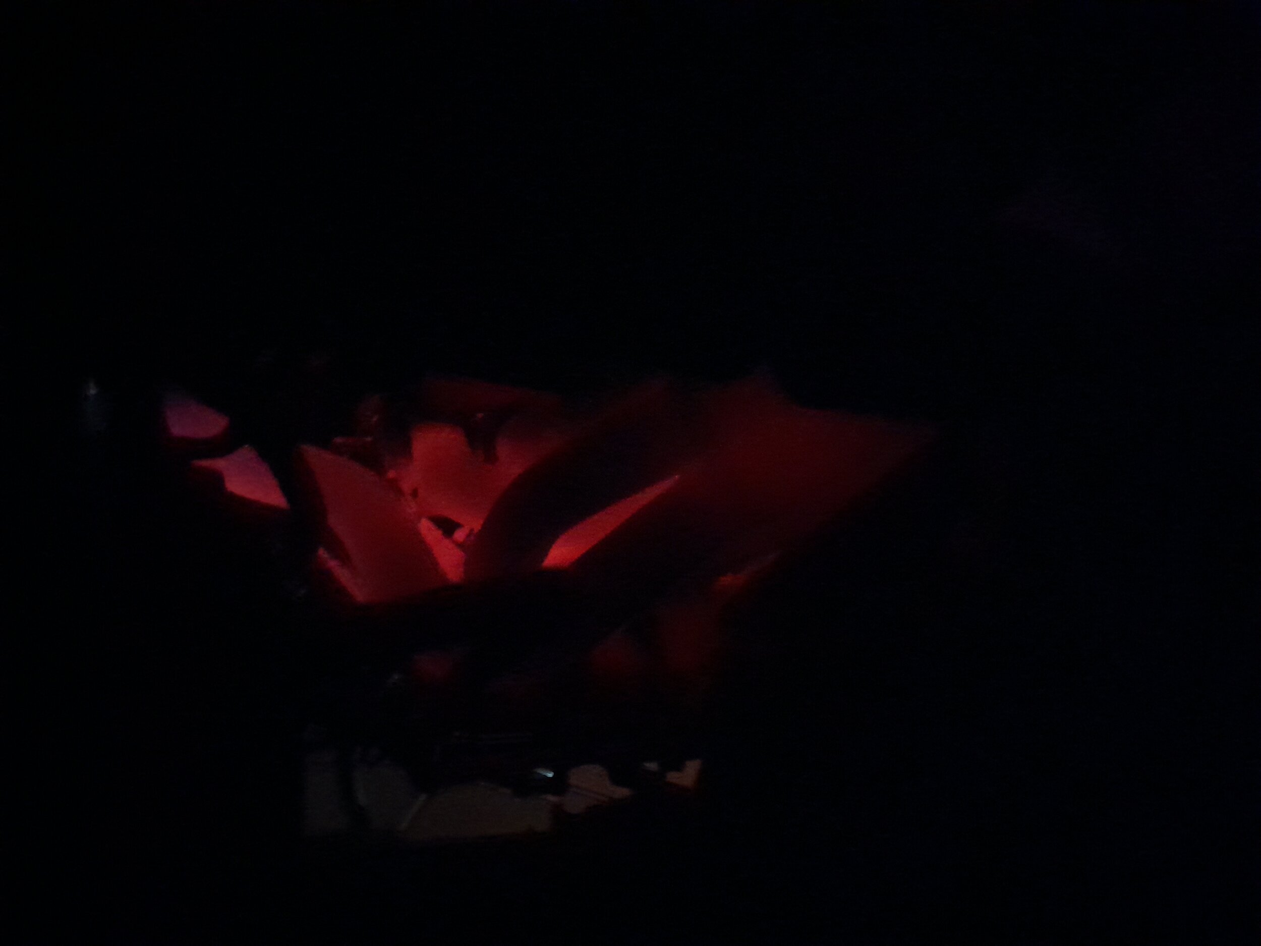

I have a tune on my jeep since I tuned it,My header from ARH likes to glow red or purple ish when I'm having fun,they get very bright but no overheating though 😁

That’s pretty warm. But I think you could open my hood and land helicopters by the glow it’s so bright 😂.

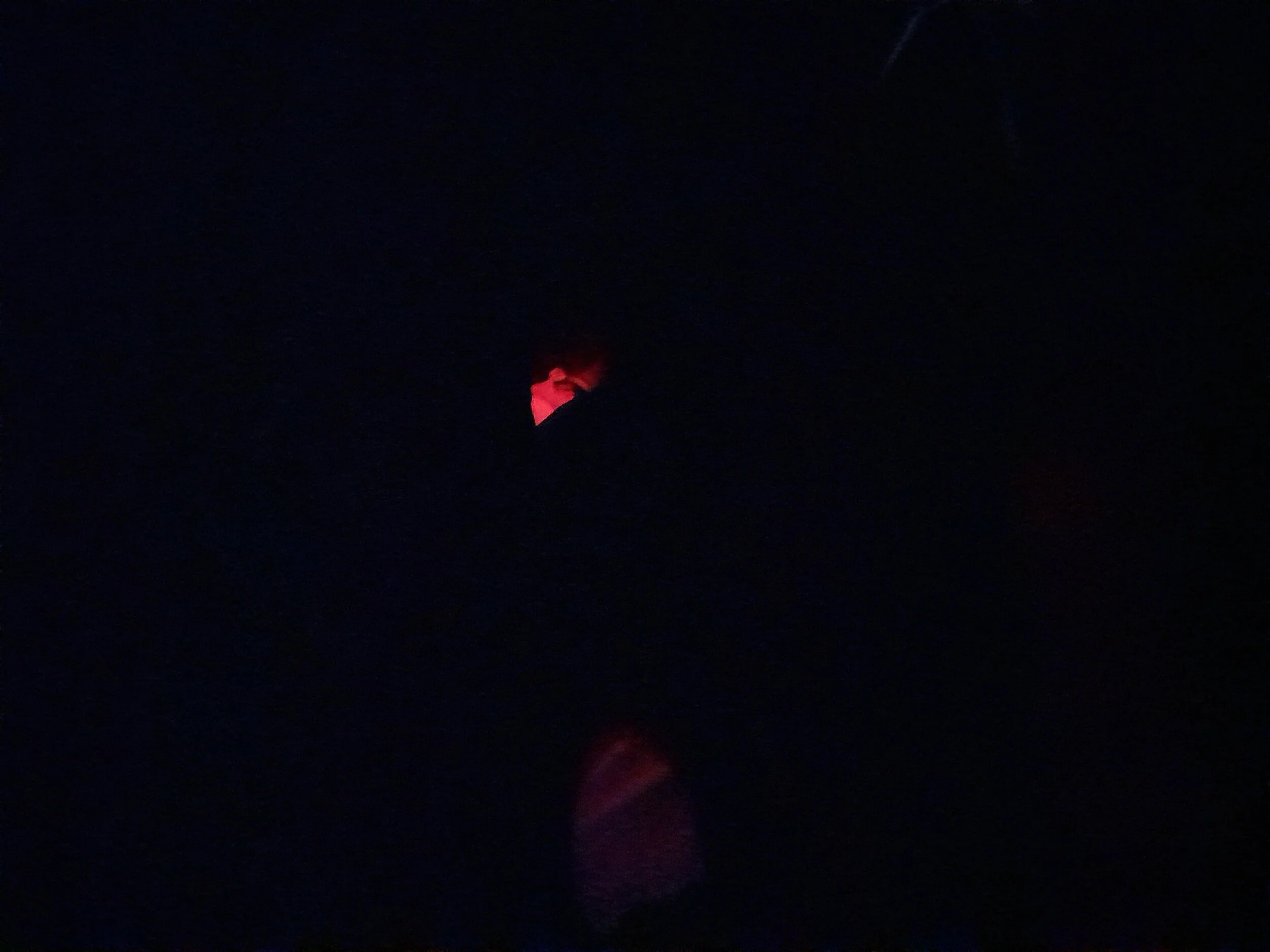

At the center is the 1st cylinder,center of the bottom us the 6to1 collector
This was on the side of the street from what I remember,I told myself "After all that I wonder what my header looks like *opens hood*.......OH DAMN,she's a bit hot 😳! "

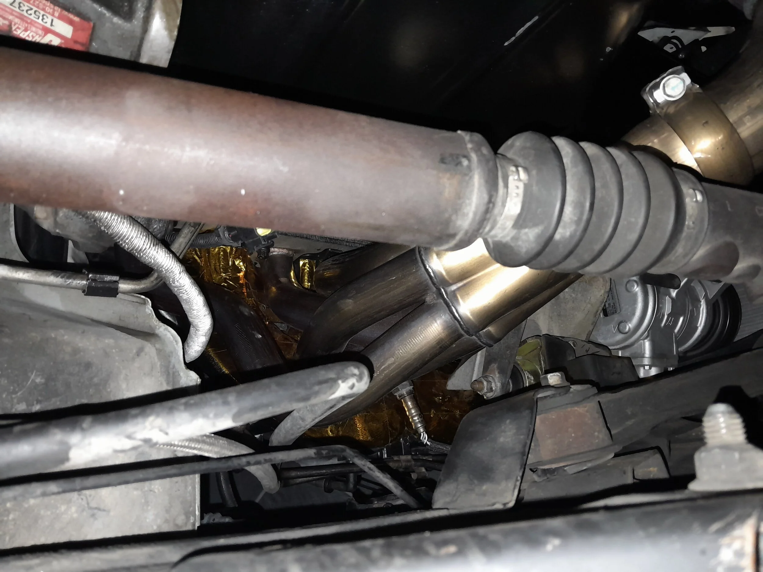

Didn't bother going under the jeep to snap more pictures cause again,I was on the side of a road🙃
Edit- I've had this header for a few thousand miles and many heat cycles of them getting cherry red/orange and they hold up great, Same with the header washer&stud kit from Jezza 😁

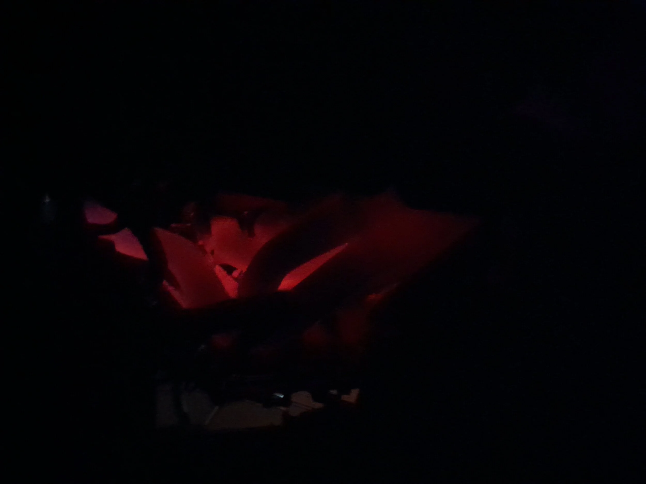

MO BRIGHTAAH😜View attachment 544826
lol. Mine is the brightest on cylinders 2 and 3. Right in the middle. Dunno why except those two are smashed together and the heat is combining there whereas the front and back is kinda solo. I had to take the scanners back to the shop today so they would have them for work. I’m about to buy an Icon T8. It says it’ll do everything I want it to do with two years of upgrades for $899. I work on enough cars and friends cars it will be handy to have around.
