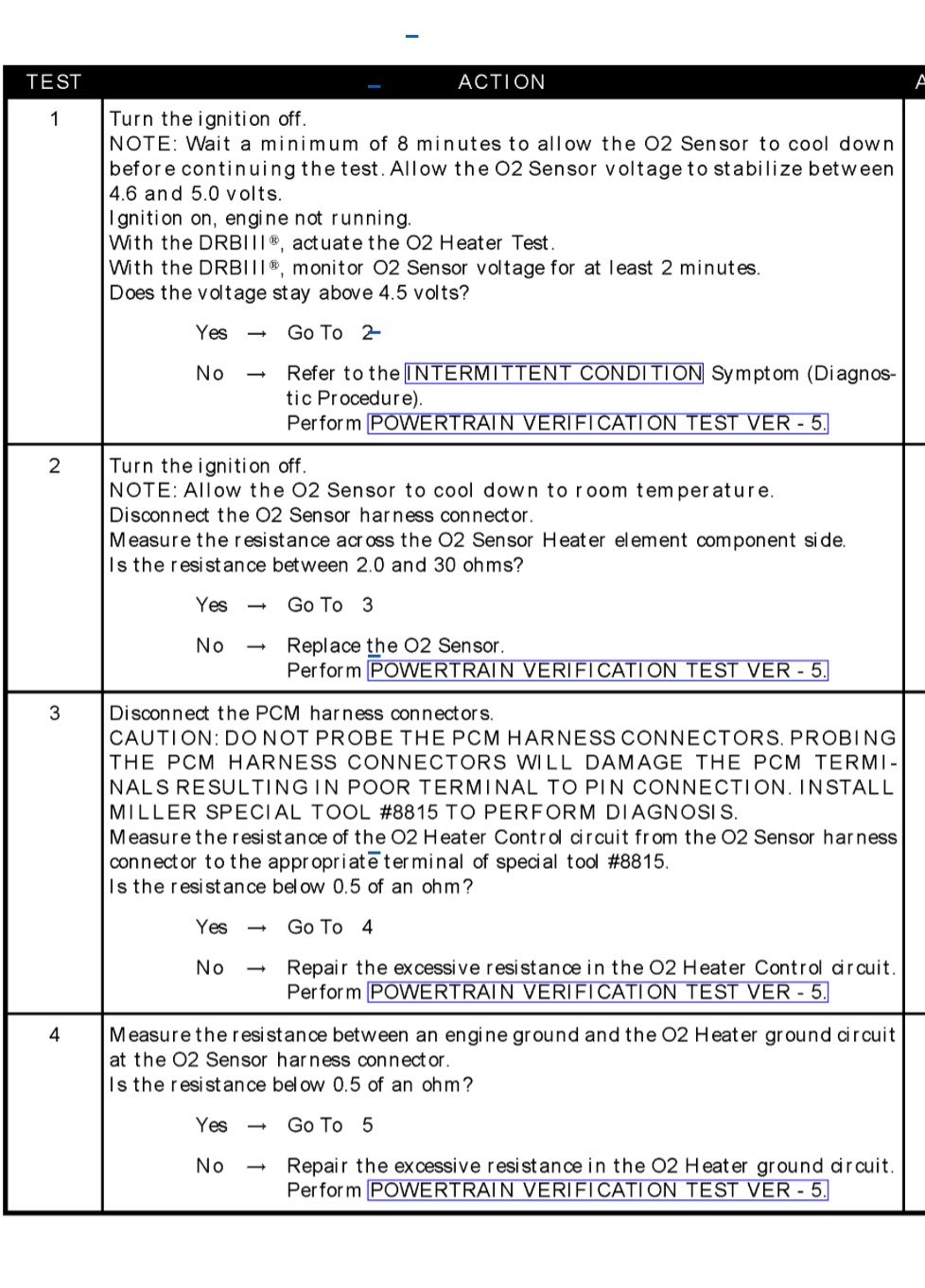

Here’s the P0135 test parameters if you want to break out the multimeter. Should be 1/1 from my earlier diagram.
