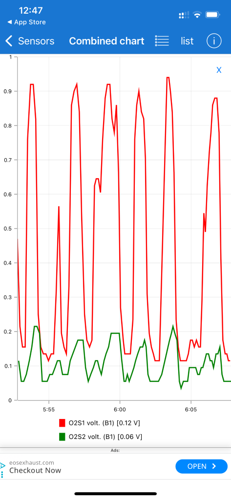

Did you get DTCs with both of those sensors? Maybe going above 0.9V is not really an issue? Or maybe the engine is running too rich because of an unrelated issue?
Andy
.9v isn't exact science. The correct explanation would take pages.
It's not much over .9v.
But it is over...
