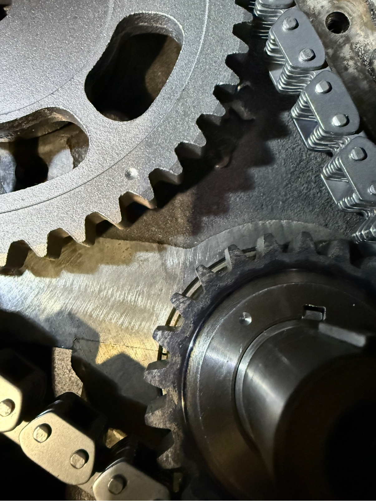

Nah, the slack were sefinetly on the bottom part. I rotate the engine without the valve before replacing chain. Even have a photo before changing timing:
The issue was very same before, and after timing replacement.
Very smart taking that pic. And that certainly looks like a non-adjuatable timing set to me.

Well, the PCM controls the ign timing, the cam/crank timing is correct per the photo above.
