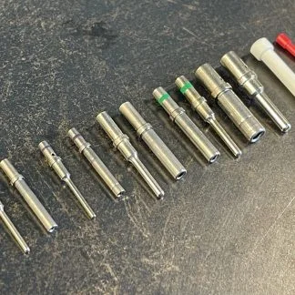

I'm a fan of Deutsch, their Solid pins and contacts are excellent over stamped.

Deutsch are very easy to work with once you can get past the price.
Reactions: NashvilleTJ
In my experience the Deutsch DT connectors are the best for general all around use. They have good sealing and the crimps almost never fail. They are also probably the most expensive option in the home game market. A good Deutsch crimper is $400.
