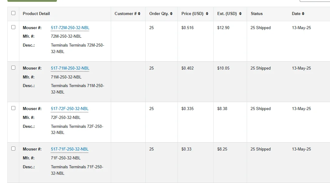

After your suggestion, I spent more time than I should have looking around for a simple quick disconnect connector... That being said, I appreciated your suggestion and then did my own research. And from that research time I spent on a ~$0.50 connector/ea, I went with the 3M products... I continue to respect your opinion and how much research (and buy & error) you work through for your suggestions!
Picked up these that should cover me for 14-16AWG and 18-22AWG.
Went Mouser for their ability to go smaller quantity over WayTek and other sites.

@mrblaine - You got me on the 3M product!
