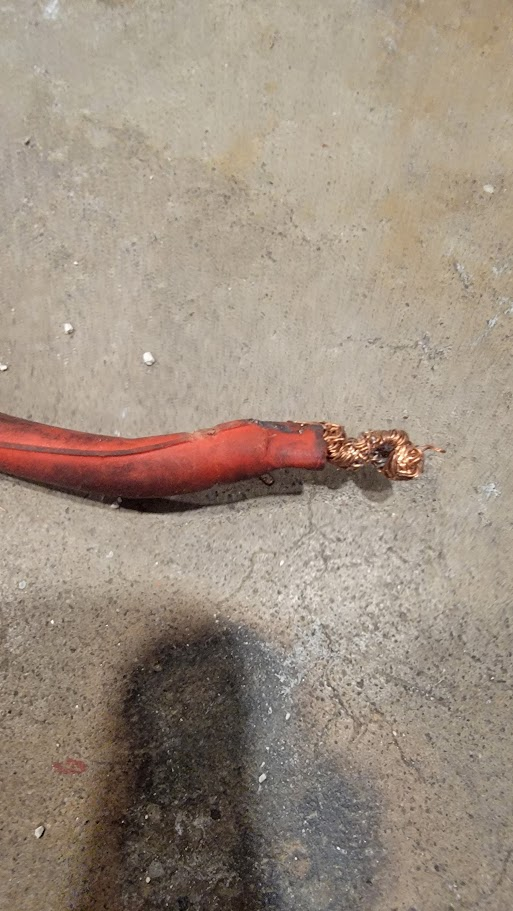

Taking your jumper cables cut 4 - 6 inches away from the terminal connectors on each end with a pare of wire cutters. *(Do this on both ends)*
save these for later.
step 2.
taking the what is now the lenth of copper wire strip the ends so that there is about one inch of copper wire exposed on both ends on each wire. *(both the ground black wire and the red positive wire.)*

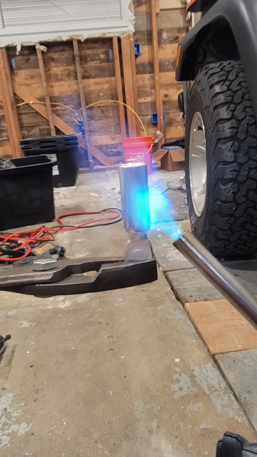

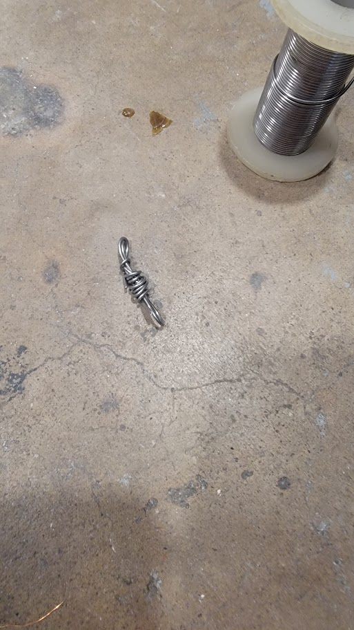

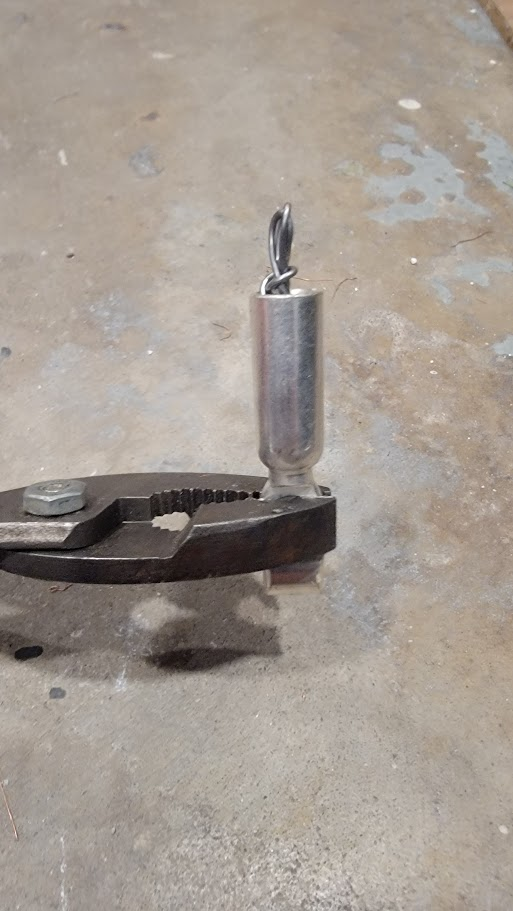

taking your Solder wire take it and wind it up in to a configuration like this:
next place it in the Anderson connection terminal

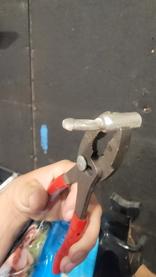

grabbing the terminal with a pare of vice grips or similar gripping tool, grab their terminal like so:
then apply heat. lots of heat.
*you can use a propane torch or a gas oven.
melt the solder in the terminal then take the end of the exposed wire and dip it in the terminal and hold in place for about 1 minute. (being carful not to touch the terminal because of the heat. )
* congratulations your a blacksmith *
let cable and terminal cool for about 3 minutes, you can move on to the next one while you wait.
repeat this for each end of the cable.

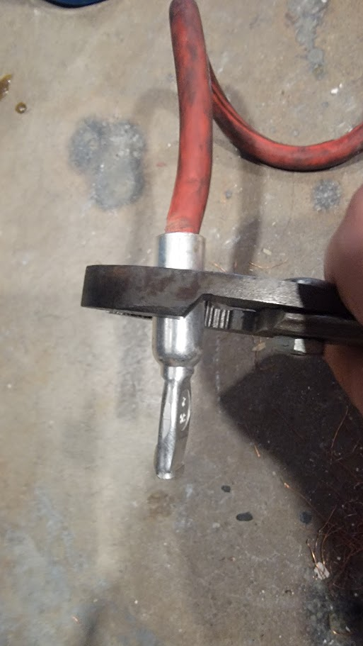

— connection method #2 —
step 3b.
placing you terminal in the hydraulic hand press make sure the terminal is aliened horizontal *ask me how I know.*
gently squeezing until the hydraulic hand press is holding the terminal.
photo for reference on horizontal
place the exposed of wire in the terminal
press the terminal until completely sealed.
repeat until each side of the jumper cable has terminals on it.

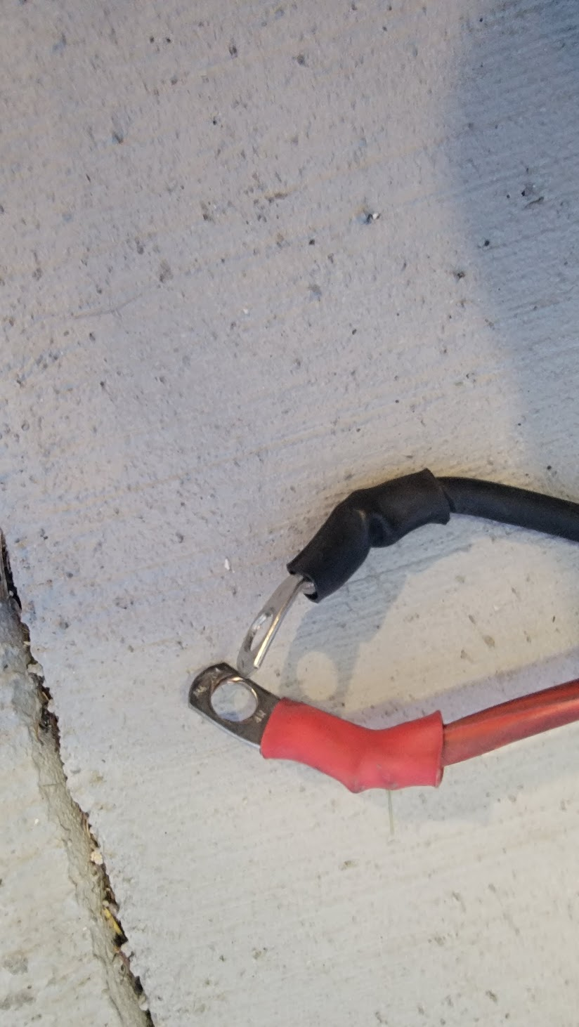

repeat step 1 and step 2 leaving enough length to be able to teach each of the battery terminal.
repeat step 3 and step 4 this time using the copper terminal connectors.
*note: copper is a softer metal* and would not require a hydraulic hand press, a hammer would be as effective*
step 5.
Optional Additional Functionality
place the shrink wrapping over the terminal and the jumper cable wire, matching red to red and black to black.

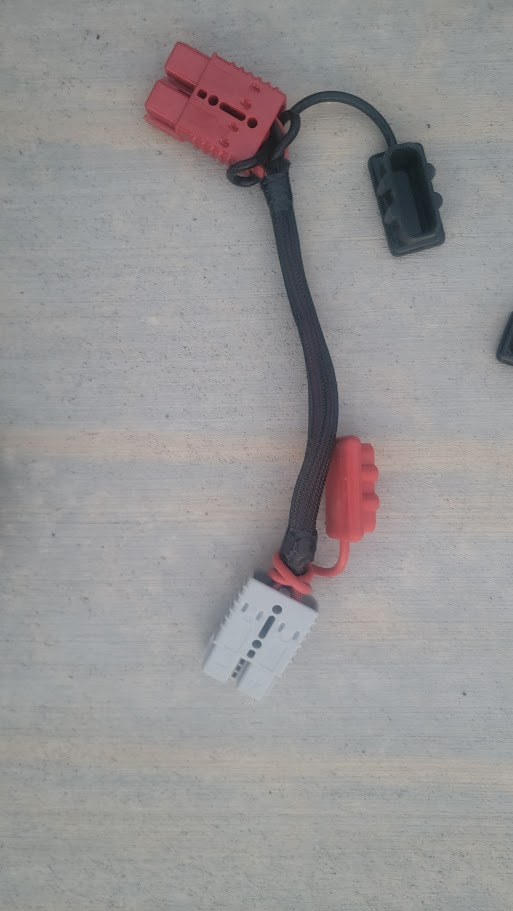

Gray to Red Adapter Cable.
*If you have both red and gray connectors:
repeat step 1 and 2 on one side of the of the jumper cable.
taking what is about 12 inches of cable apply steps 3 and 4 to the newly cut section of wire.
set aside a gray and red Anderson Connector for each end of the 12 inch cable.

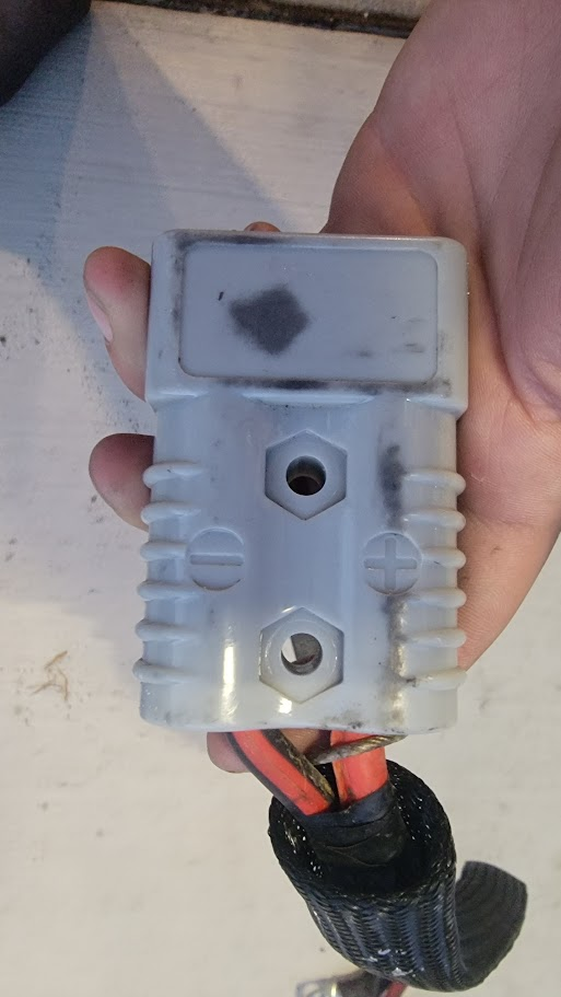

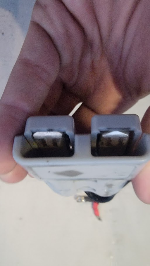

with the red end of the cable where applicable :
*make sure you place the red cable in the correct location of the Anderson connecter*
*these connections are a bitch and a half to take apart, ask me how I know.*
denote the terminal and face it that the hook bit is casing down like so:
force the connection in the correct hole of the Anderson connecter.
then apply the same method to the black ground cable.
do this for ever connecter terminal and Anderson Connector.

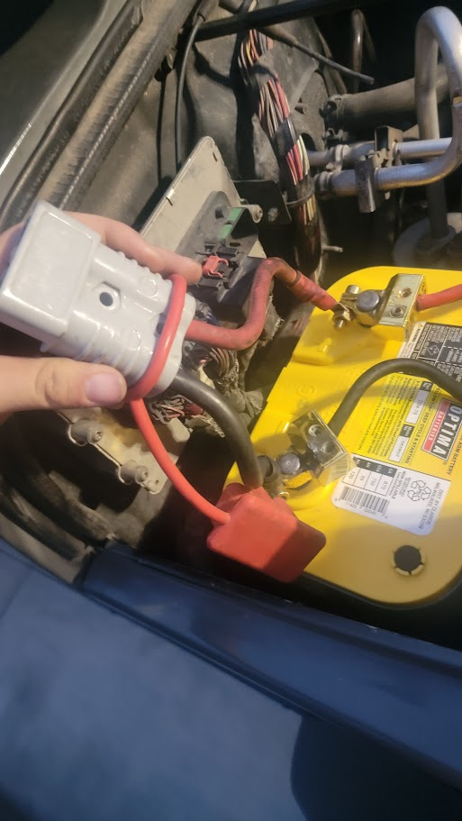

attach copper terminals to the battery:
now you should have advanced connection capability's.
apply this to your winch and a second pair of jumper cables for more capability's.

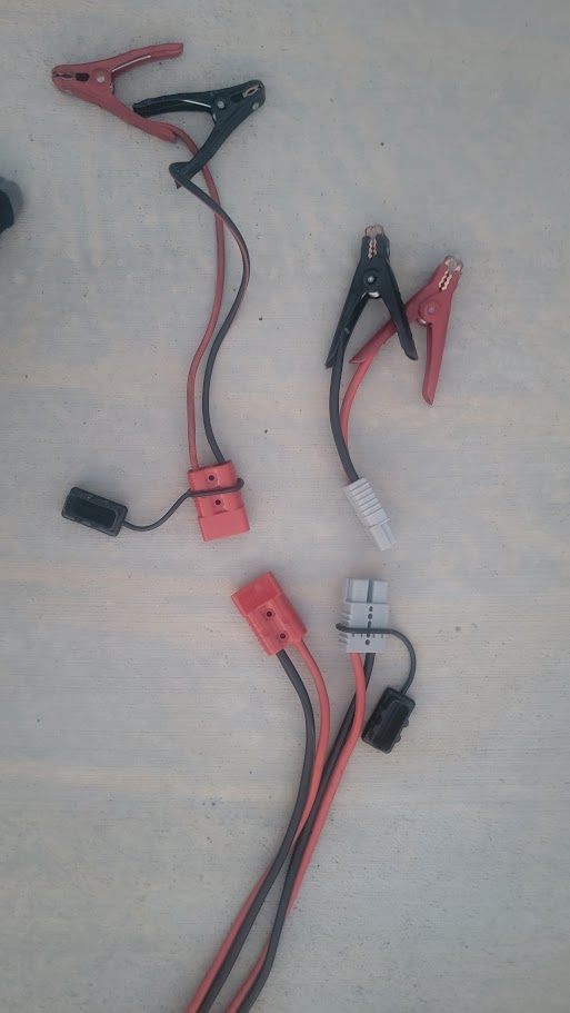

*Additional functionality*
This will allow you to create terminals to the front or the back of your jeep so you never need to pop the hood if you so wish:
https://www.amazon.com/dp/B0CWL65YQK/?tag=wranglerorg-20
This would you allow you to plug you winch directly to your front bumper to avoid potential voltage drain..
The jumbler ends on my jump box were too short for my liking, now I can pair them with my jumper cables.
*additionally it makes it harder for someone to steal, and now I can jump a forklift *
