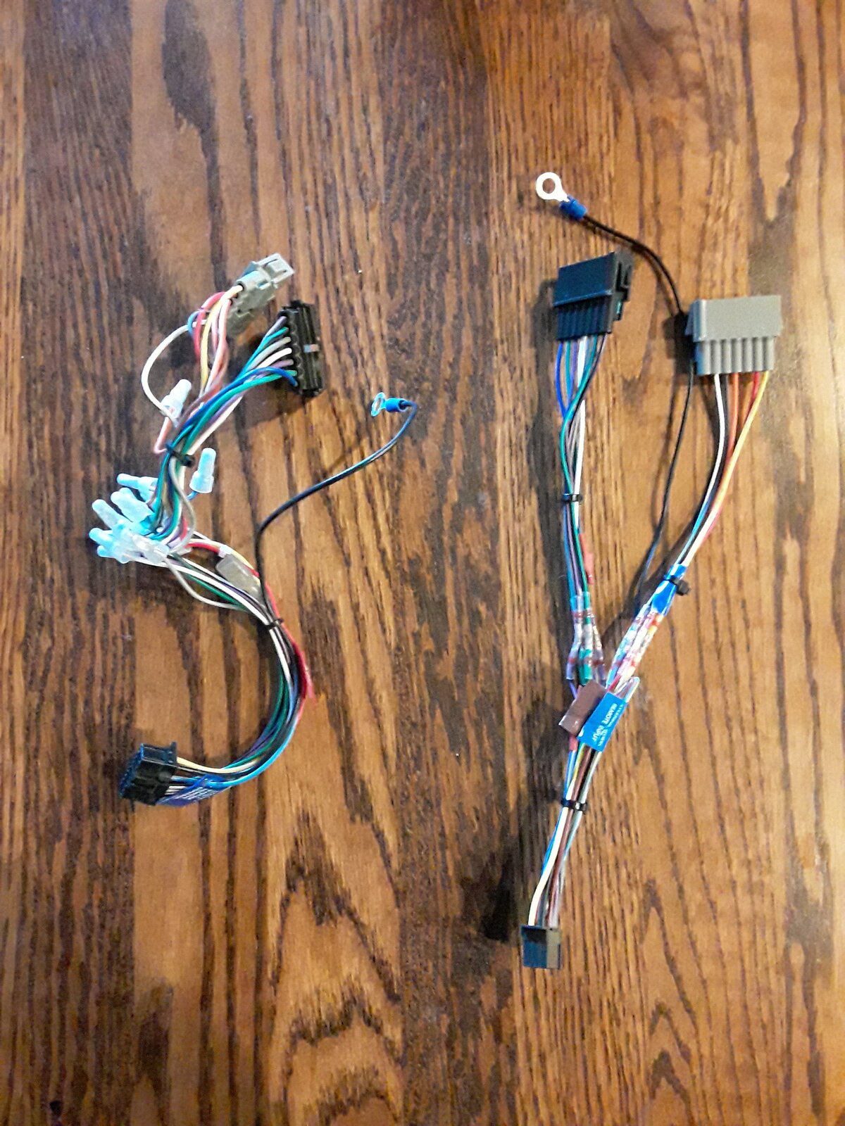

I bought a box of the Chinese solder seal connectors a couple of years ago. I've used them to install a couple of head units (as a test on a non critical circuit) and they came out the cleanest looking head unit harnesses I've ever put together. I haven't had any issues with melting or burning the rubber before the solder since the first 5 I did, and I haven't had any fail yet.
Not ready to endorse them, just sharing my experience.
Should have staggered the splices by the length of the splice, makes for a smaller footprint

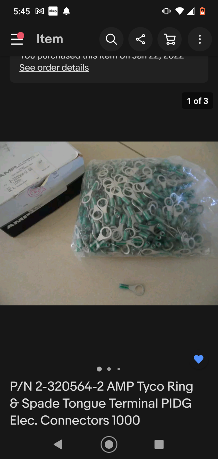

Needed 1 single 14 gauge 3/8" stud ring terminal. So I bought a 1000 of them for $35 on eBay.
Shouldn't need to buy that size for the rest of my life at least lol
