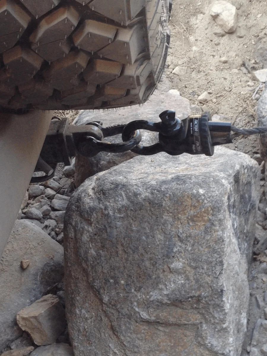

OK, on the topic of soft shackles, you would still need to connect it to a hard shackle on someone's bumper, for instance, if you were winching them out. I guess it comes down to if you have a thimble or a hook. A hook would just clip on their hard shackle and a thimble would need the soft shackle to connect.
Which brings up an interesting point. I know there is a thread on this forum that poo poos thimbles because (like in the case above) there is an extra connection (extra possible break point) that needs to occur.
Sometimes a picture is worth a thousand words or perhaps, 4 connections.

Those pics above showing the Factor 55 design and the Safety Thimble in the same post are great examples of the very worst and best designs. The last product I'd have in my TJ is the Factor 55 shackle-thingy. That original design caught so much crap from the more knowledgeable wheelers that they finally changed its design to wrap the rope around the load... copying the original Safety Thimble design. Safety Thimble designer mrblaine neglected to patent his Safety Thimble design so it was ripped off/stolen by Factor 55 for their second-generation design. :mad:

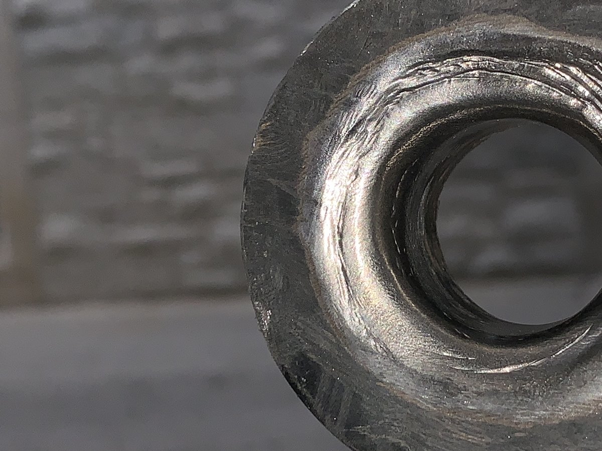

If anyone is wondering, this is how I’m modifying my bumper for a soft shackle. I’m about ten minutes in, but it could run it this way no problems if I wanted to. A few more minutes with the dremel to smooth the outer edges and the top parts and I should be good to go on this one.
The bevel-ish drill bits I bought don’t work all that great and leave the pattern you see at the top right. Nothing that can’t be fixed with a dremel and some patience luckily.
