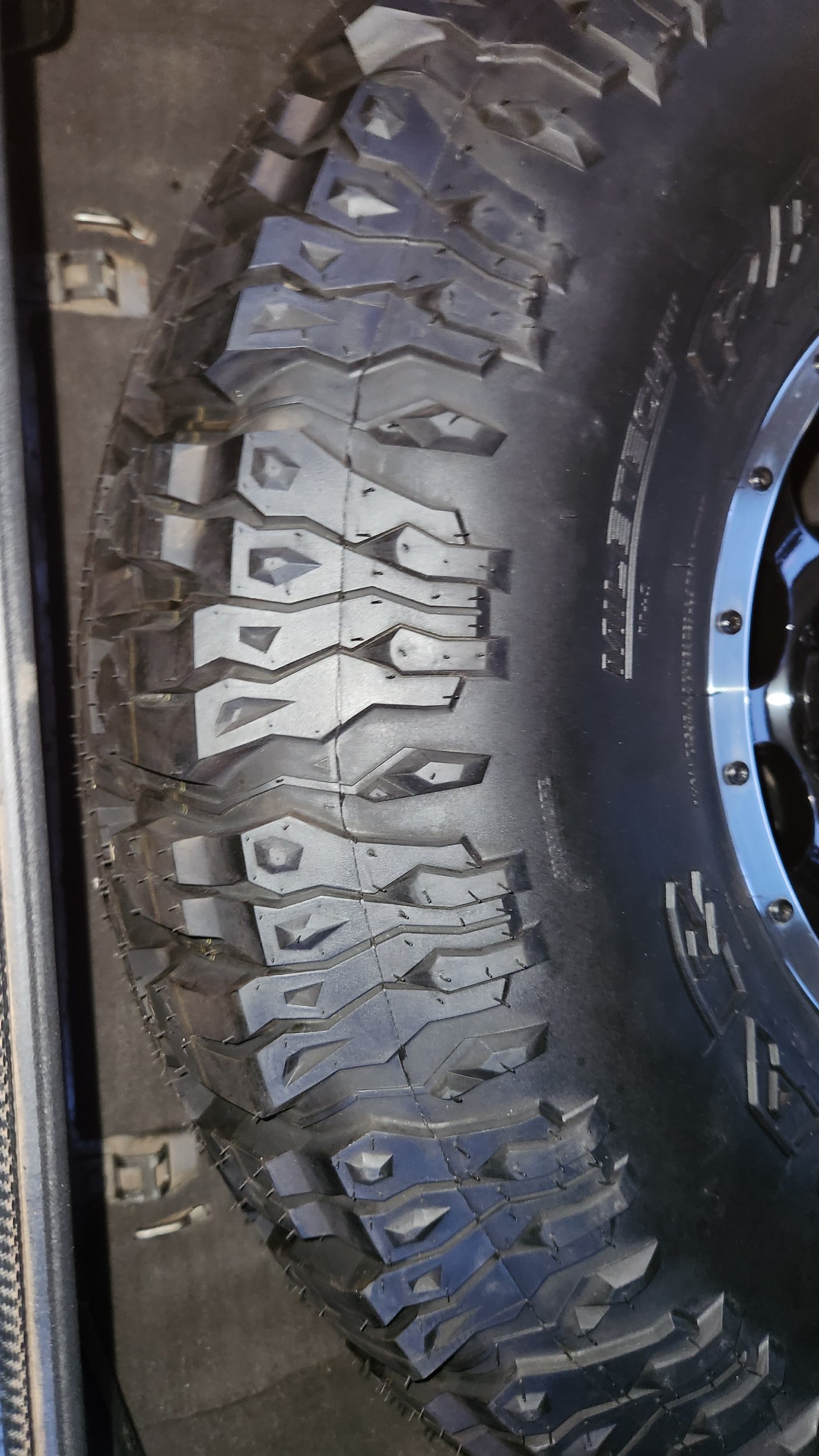

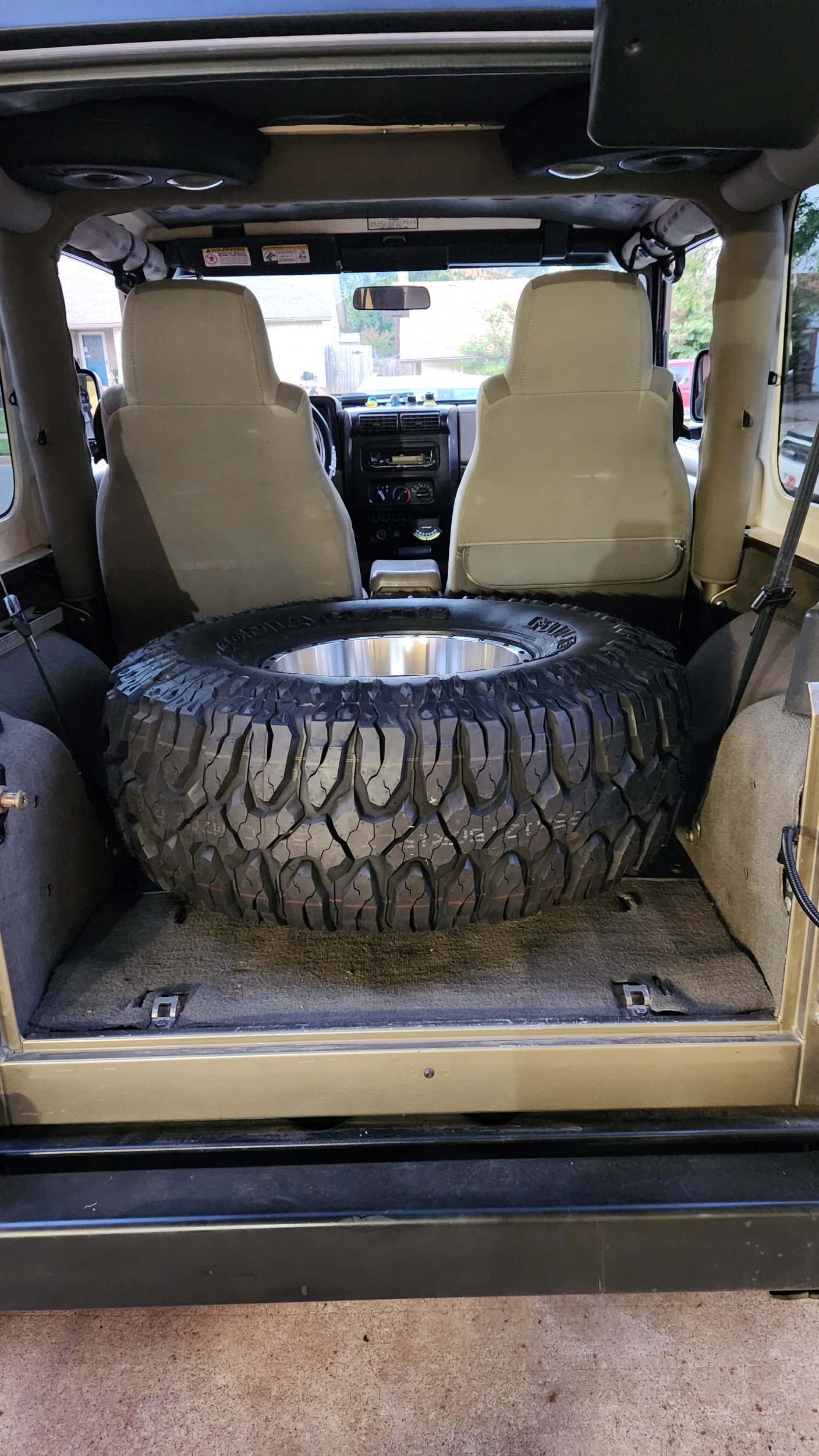

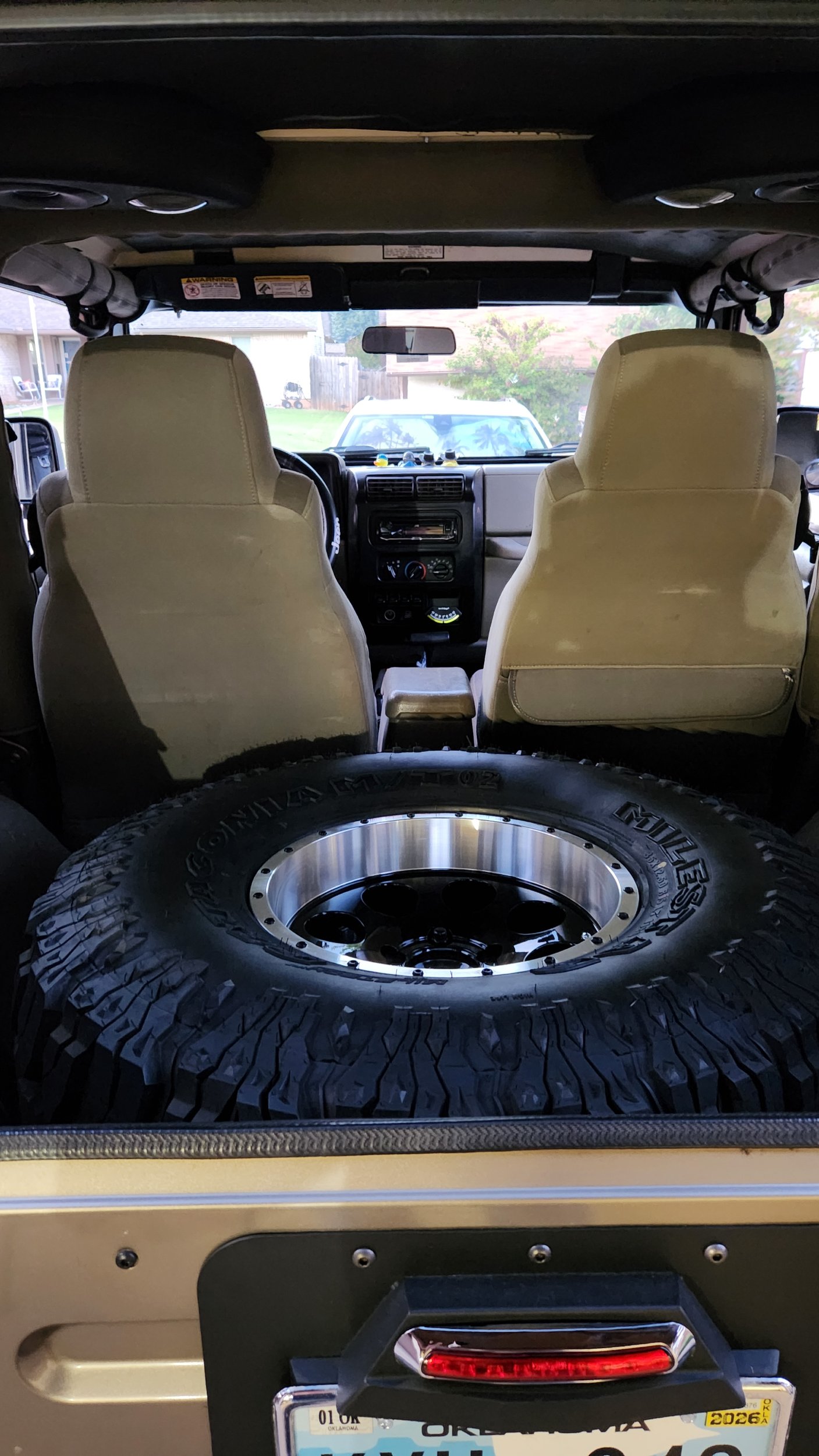

2003 Sahara. Since I got 35's I wanted to move my tire inside rather than a new rear bumper with swing out or the additional weight on my tailgate hinges.
My rear seat sits on a shelf of a rack I made to hold my top when its off ad I don't ever use it.

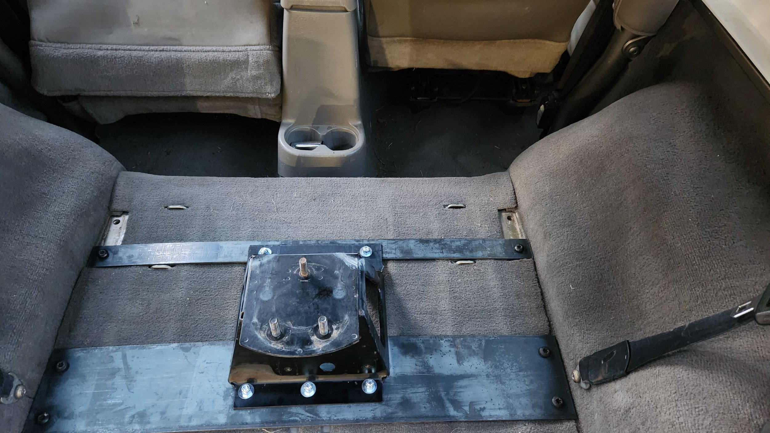

I repurpose the stock carrier bolted to a couple of 1/4" thick steel plates that bolt where the seat mounts were using the stock seat bracket bolts. The oem mount actually holds the 12.5 wide tire off the carpet a inch. My wheels are 15x8 with 4.5 backspacing.
With inflation what it is I spent $50 on the 2 plates. I have an inch clearance between shut tailgate and tire
