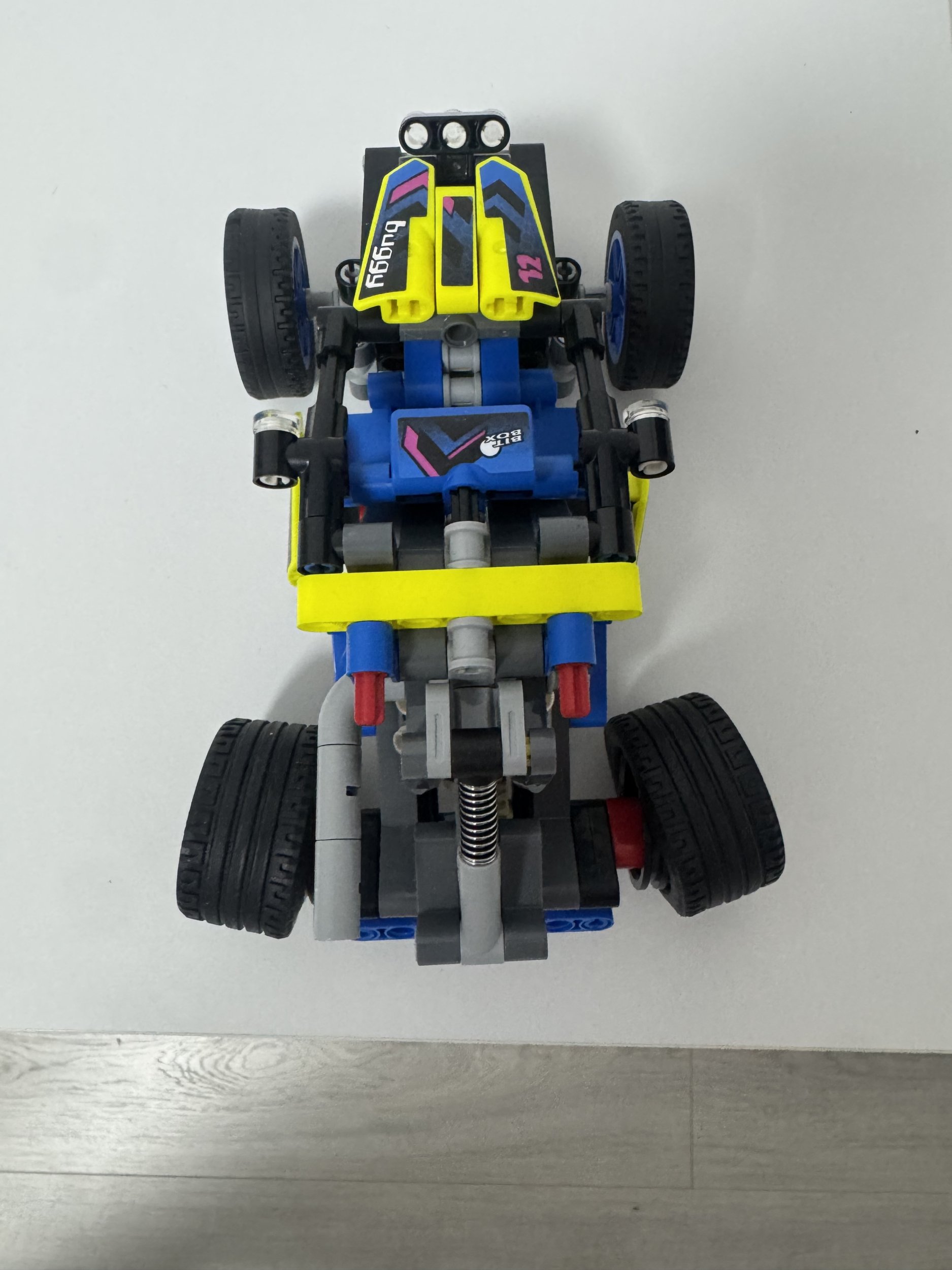

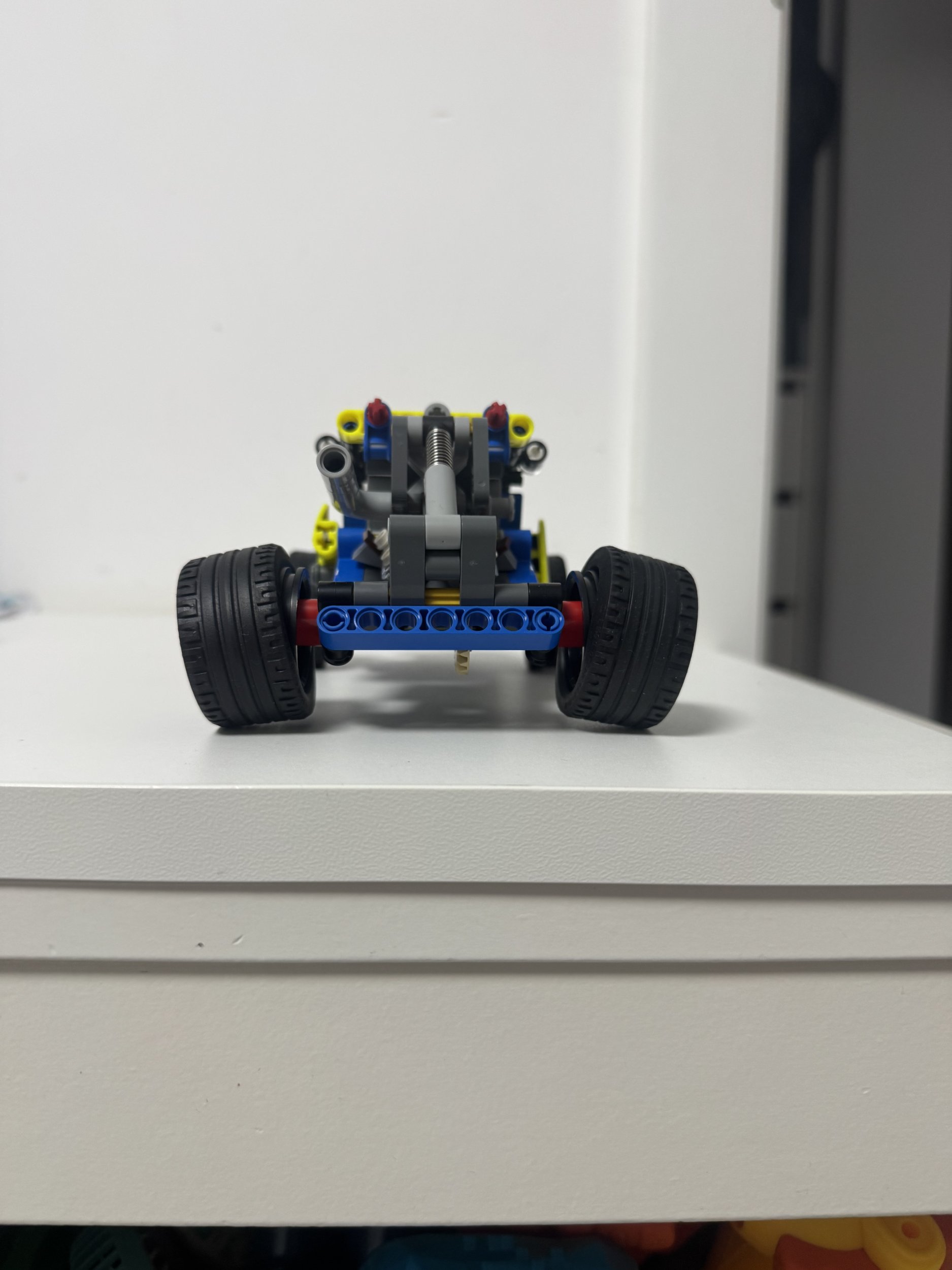

sorry,It’s not very easy to see, but at the beginning of the video, you can see that the top of the wheel sticks out more. When the car moves forward, the top pulls inward and the bottom of the wheel moves further inside.”
Before filming, the car had been put in reverse.”

I think i see what you are saying but…

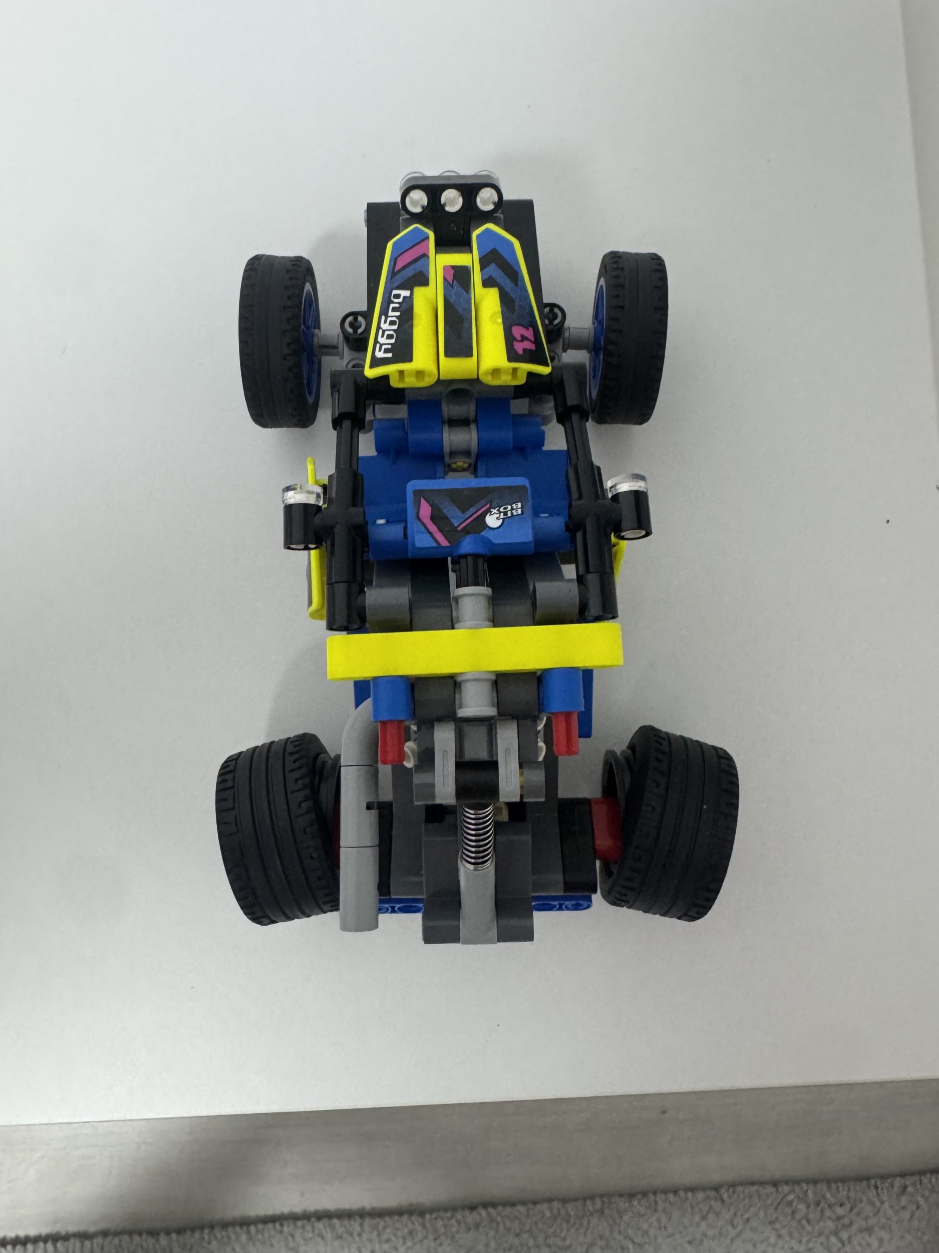

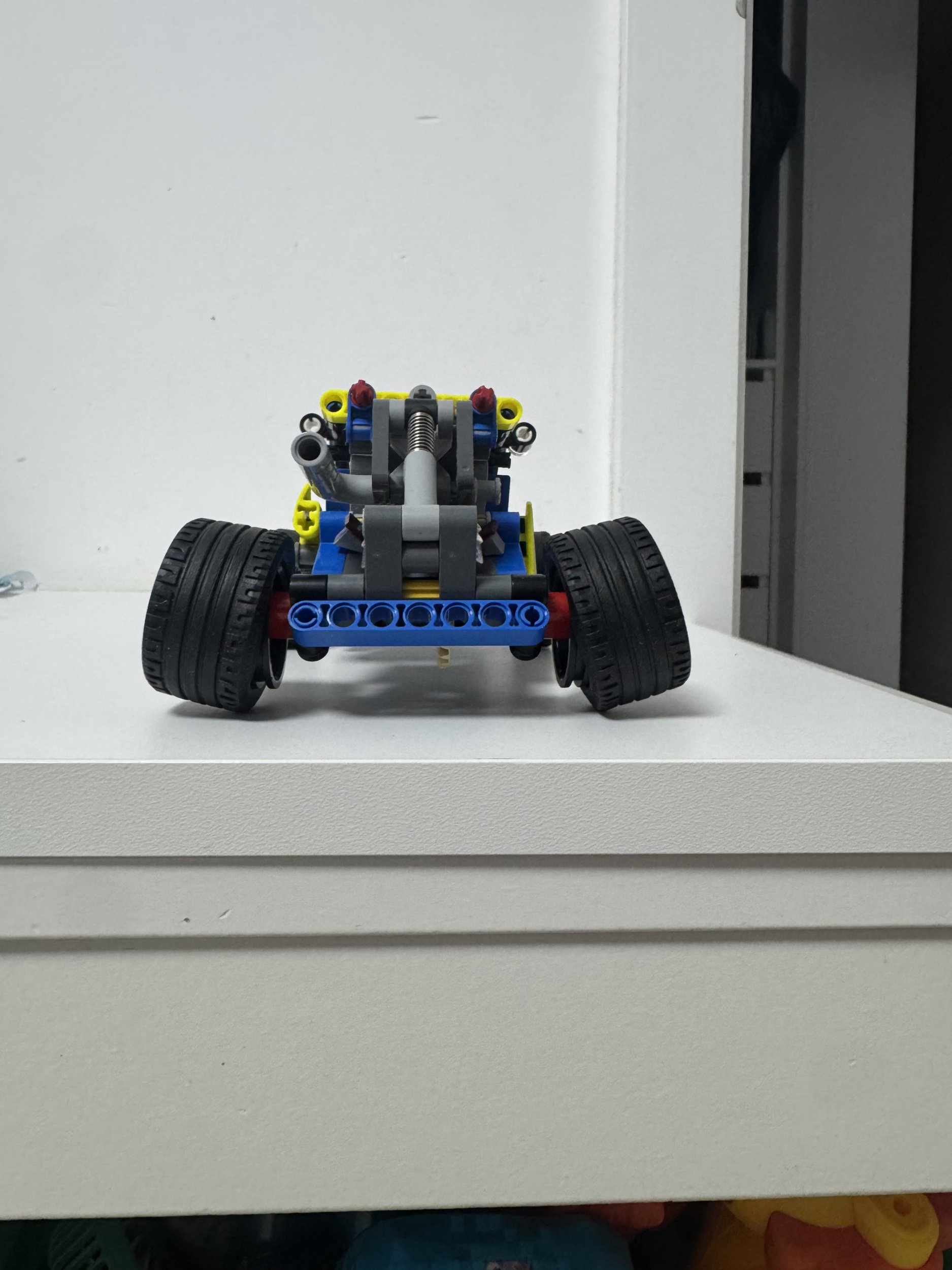

forward drive
Sorry, this is the correct image for driving forward
Of course, the difference isn’t that big, but it’s enough to cause the tires to scrub / be pushed sideways.
The wheels turn like this after about 5 meters, then they keep going the same way (the camber only changes when switching between driving forward and backward).
It's a solid rear axle. A bent axle shaft would cause the wheel to wobble. Since it is not, it can only be in the bearing. That is the only part that would allow the camber to change between forward and reverse. When the rear wheel bearings were changed either they were installed incorrectly, or they are the wrong bearings. I would pull it all apart and verify they are the correct bearings and everything was put on correctly. Look up the procedure to correctly change the wheel bearings in the factory service manual. They are available for free through links on this forum.
