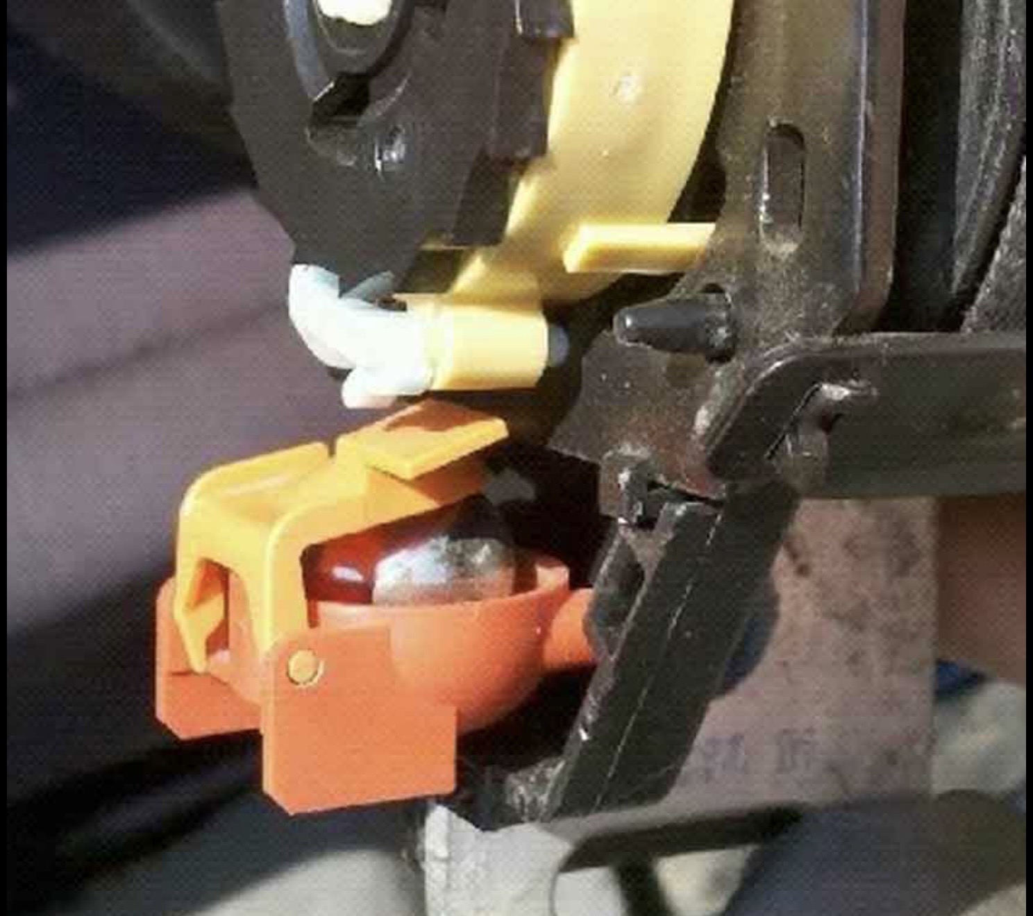

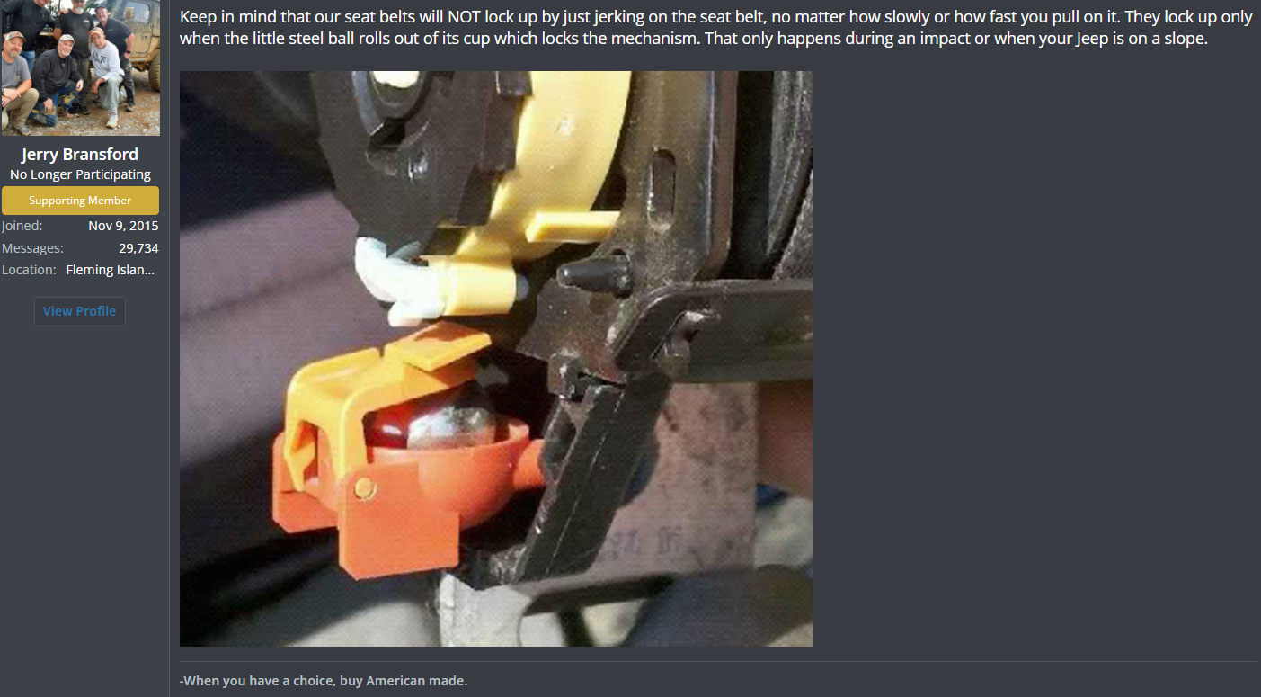

If you are parked at an angle, inertia is not in play. The seat belts have a tilt + inertia system that locks them. There is a steel ball that sits in a little cup, in the bottom of the little cup is a little plunger that sticks up that the ball pushes down when the vehicle is mostly level that keeps the locking function deactivated. If the ball moves out of the cup and lets the plunger rise, that locks the seat belt free spool. The ball can move from inertial forces and tilt.
If the OP would remove the seat belt retractor from the roll bar, he can check it by tilting it and trying to pull out the belt. It is very likely functioning as designed.
Thanks for the info. I'll include that test when I get in there to clean them.
