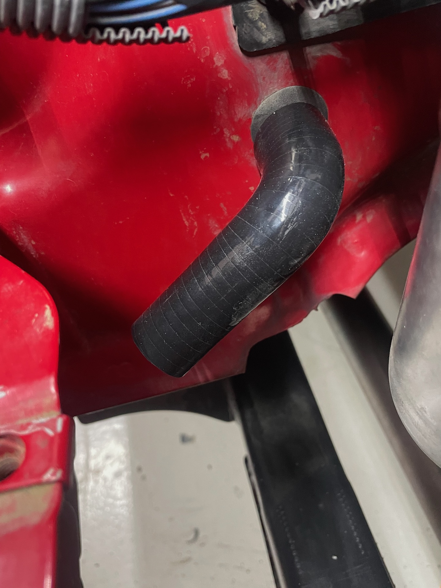

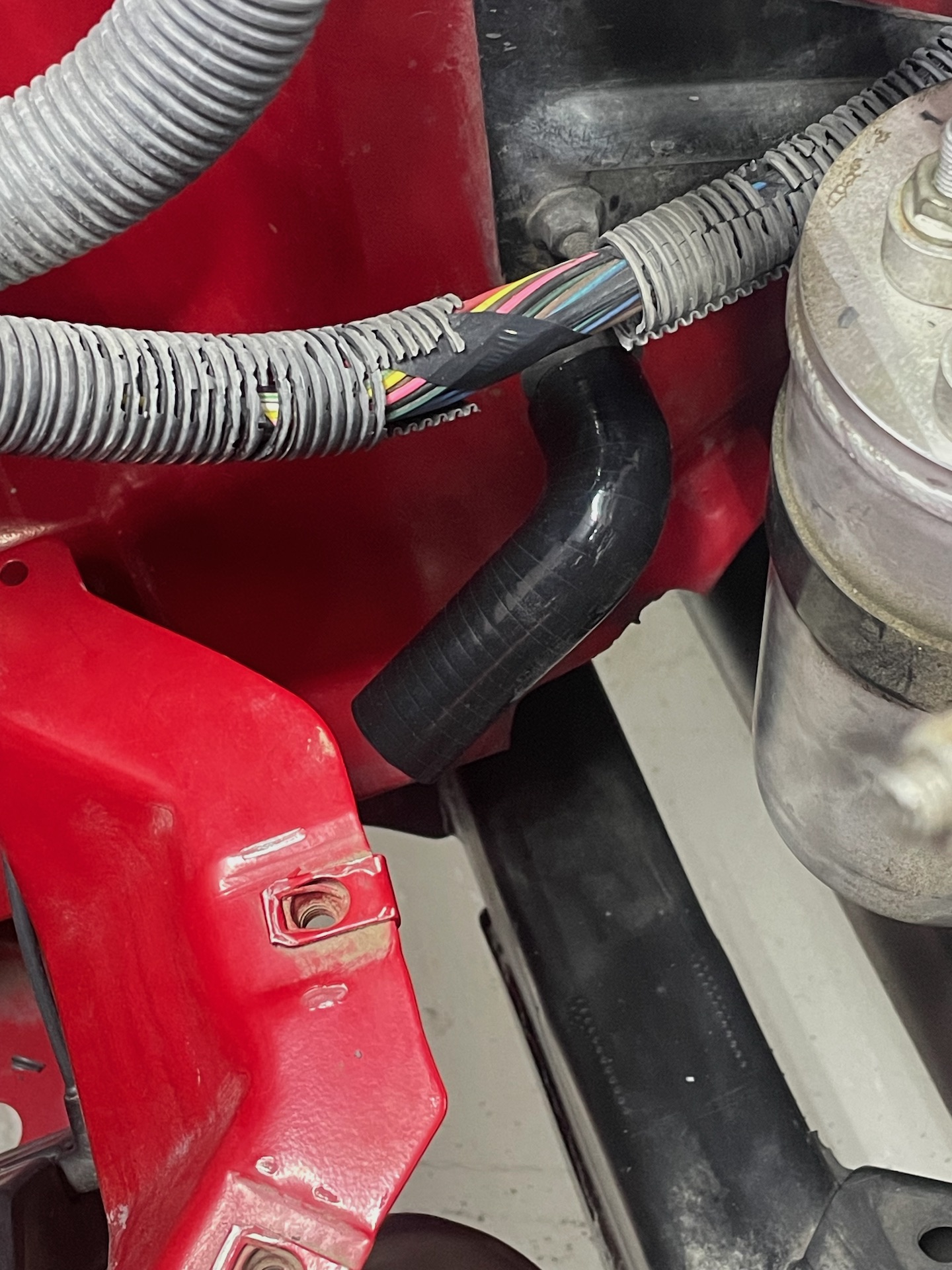

First item is adding an extension on the small AC drain line inside the engine compartment. This "L" was purchased off Amazon and when it arrived I cut off one side of the "L" 2". This keeps is close to the firewall. I also angled the hose so it does not drip straight on the frame. Please ignore the wire loom....I am also replacing all the cracking wire loom protector tubing. Here is a link to the hose that fit perfect.
https://www.amazon.com/dp/B07XH2SJJB?tag=wranglerorg-20
If link does not work in future, search: (ID 3/4" (19mm), 90 Degree Elbow Coupler, Leg Length 3.5" (90mm), 3-Ply Reinforced, Universal Automotive Pure Silicone Hose, Black)

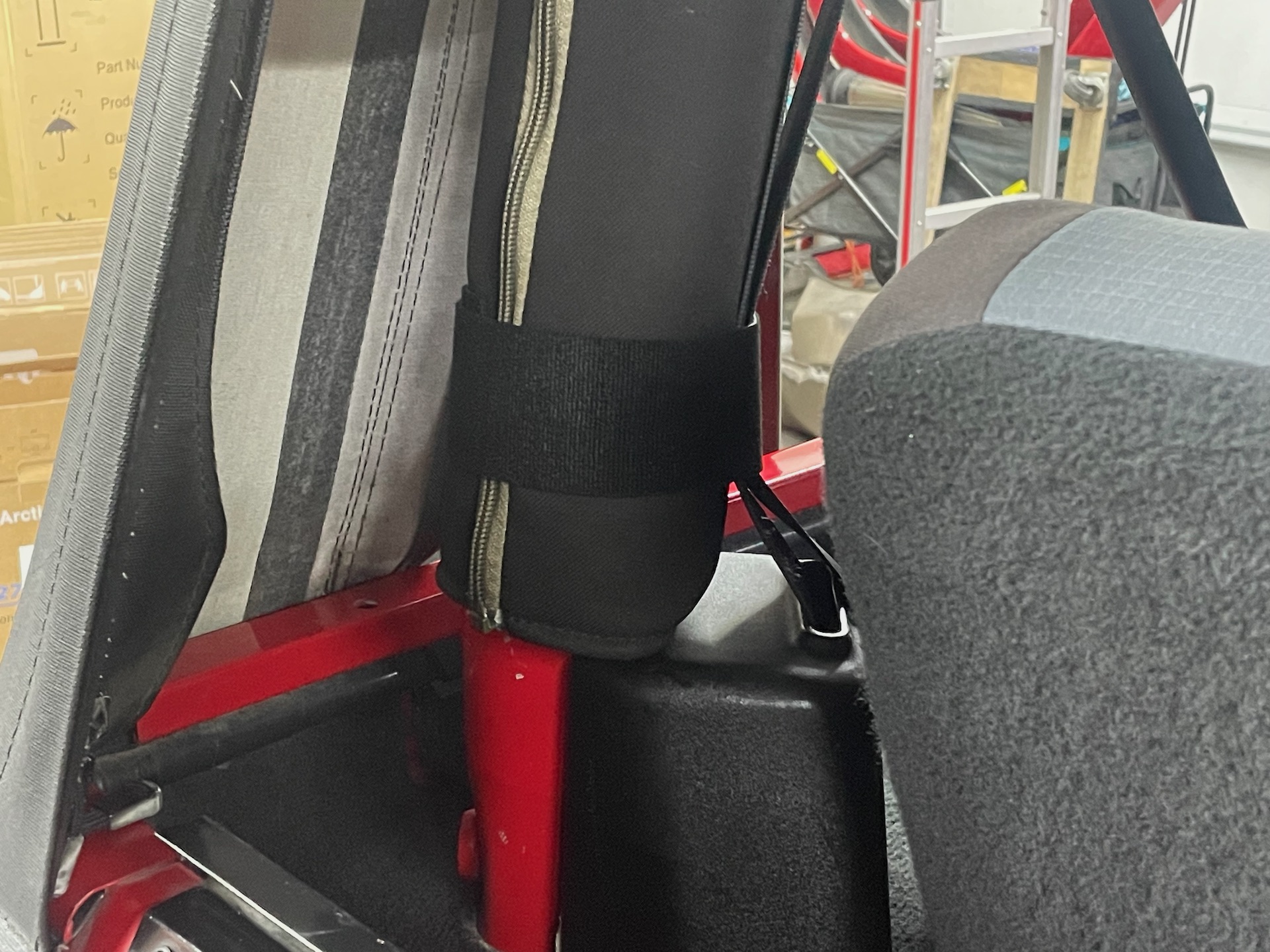

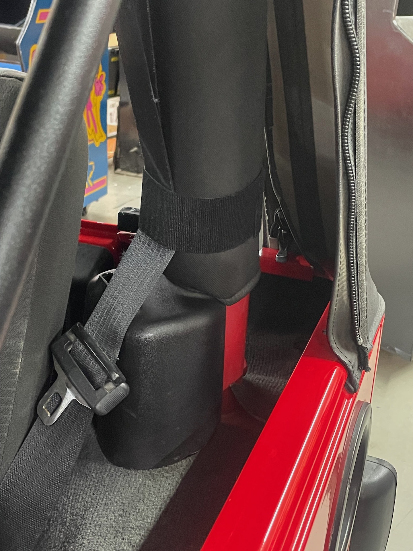

Second item deals with the rear seatbelts flapping in the wind while driving with the top off or windows out. It bugged me so I ordered 2" velcro strap from Amazon and cut two pieces 16" each. I wrapped these around the rollbar and seatbelt to secure them. Easy to remove whenever you have passengers. Looks factory! Here is the link:
