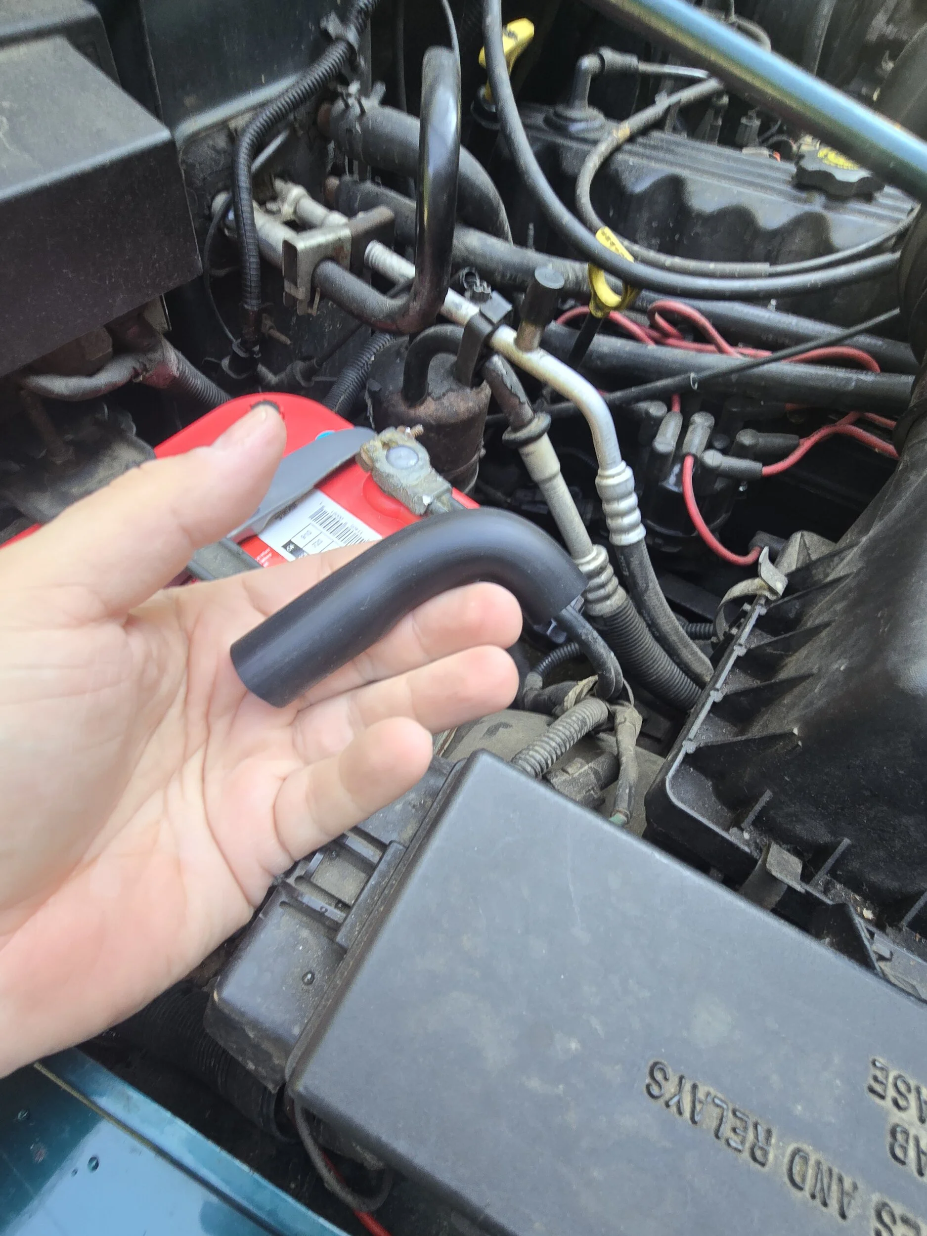

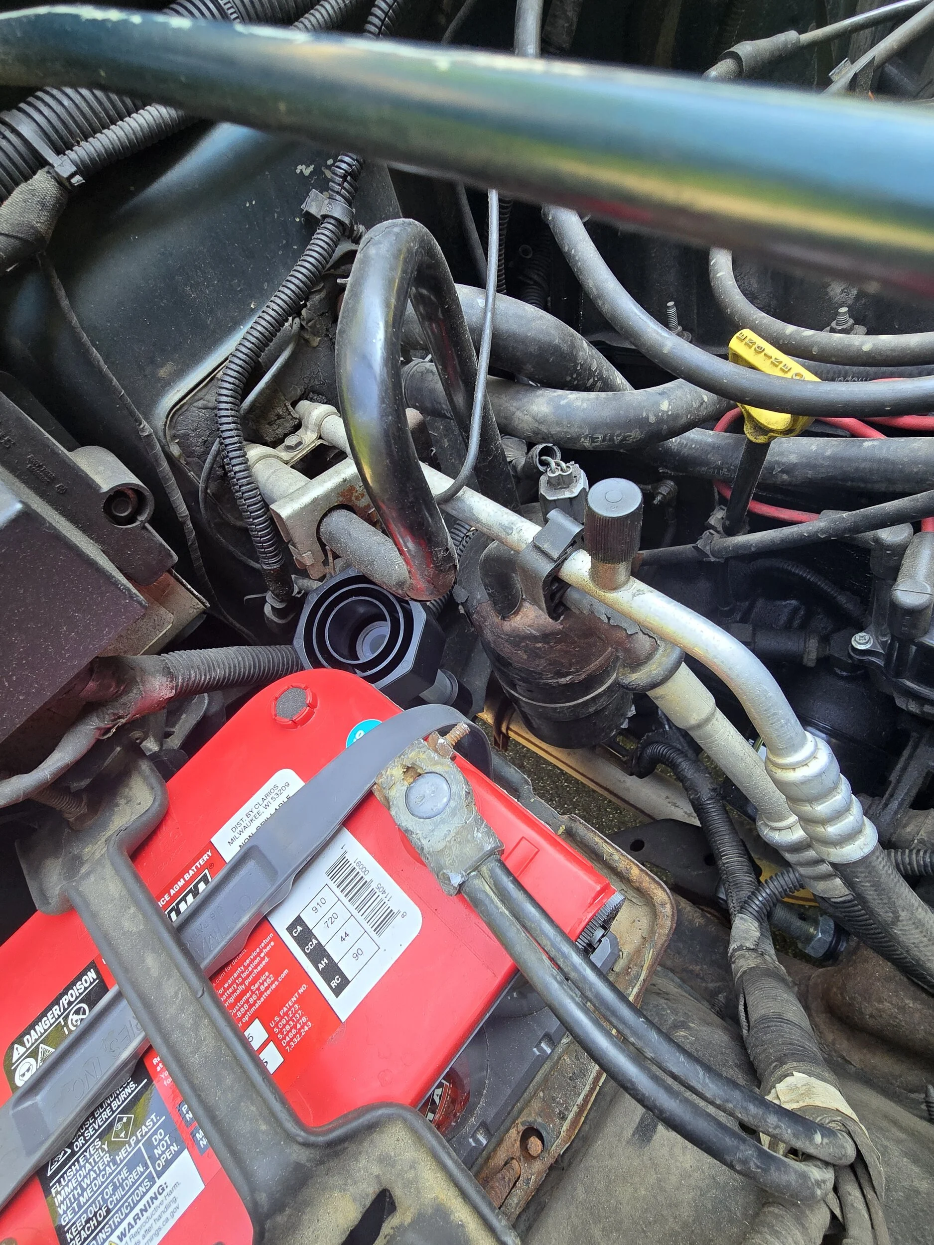

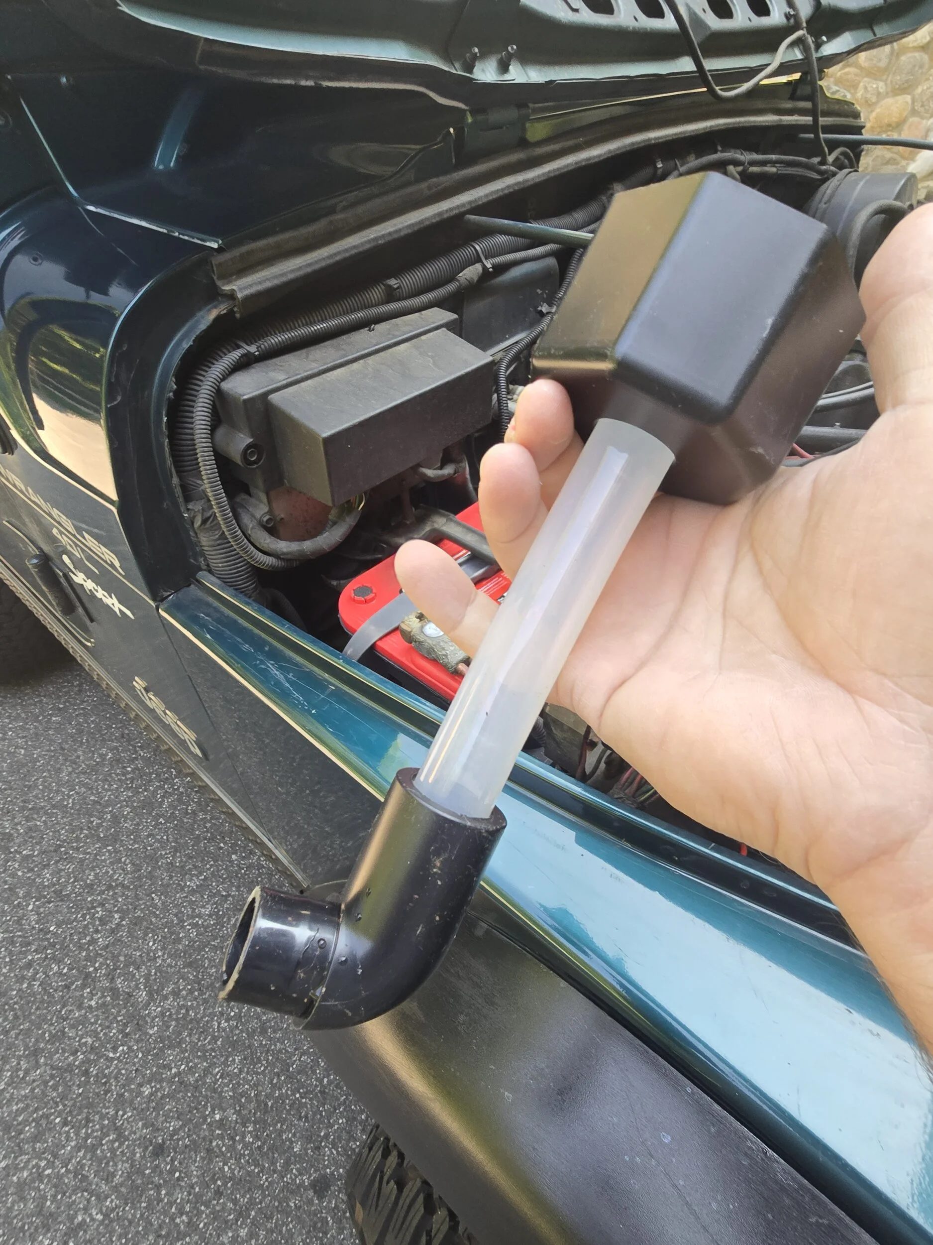

I picked up this household AC drain plug attachment on Amazon as I was getting a steady stream of water in the passenger side foot well. It fit well and was able to snug it against the firewall while sucking out the crap. Also added the elbow joint after. No more drips.
Here's the link in case you're interested: https://www.amazon.com/dp/B0DMDRBLQV?tag=wranglerorg-20
Great work.
Here is one other thing to pay attention to. As the water drips from the tube it gets blown back to the cab along the tube and many times the rubber grommet is degraded to the point the water gets blown into the cab and onto the floor.
