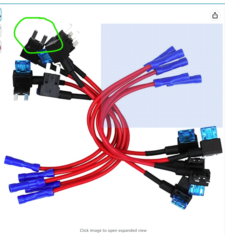

The best, simplest, and easiest method is to use a fuse tap and stick that into the cluster power fuse slot. Get the tap with slightly longer tabs on it, not the short ones.
We done well over 40 that way judging by how many I've purchased on Amazon. We cut off the crappy butt connector and replace it with a good one.
A fuse tap will be simple. You’ll also need to consider how to route the sensor wire. I used a crochet needle to pull the wire through the throttle cable grommet. The bulb is wired to the transmission indicator light.
