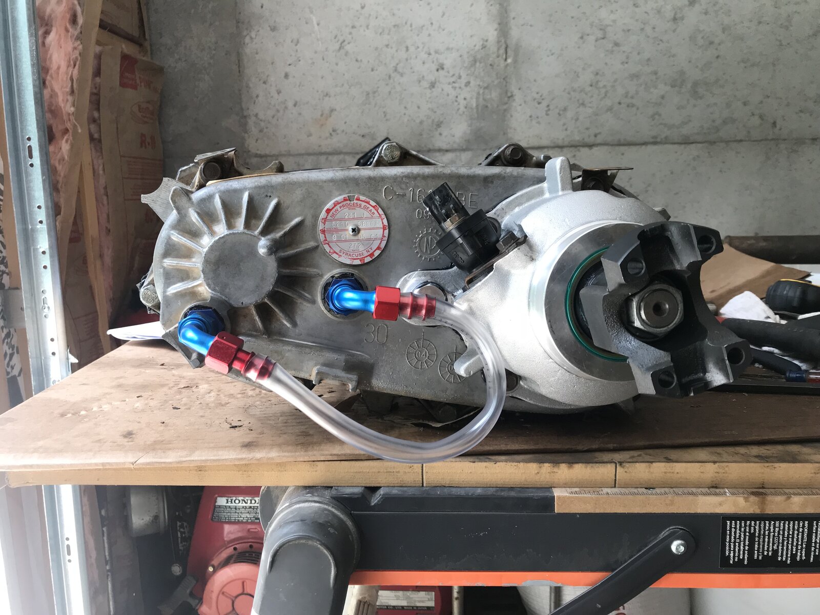

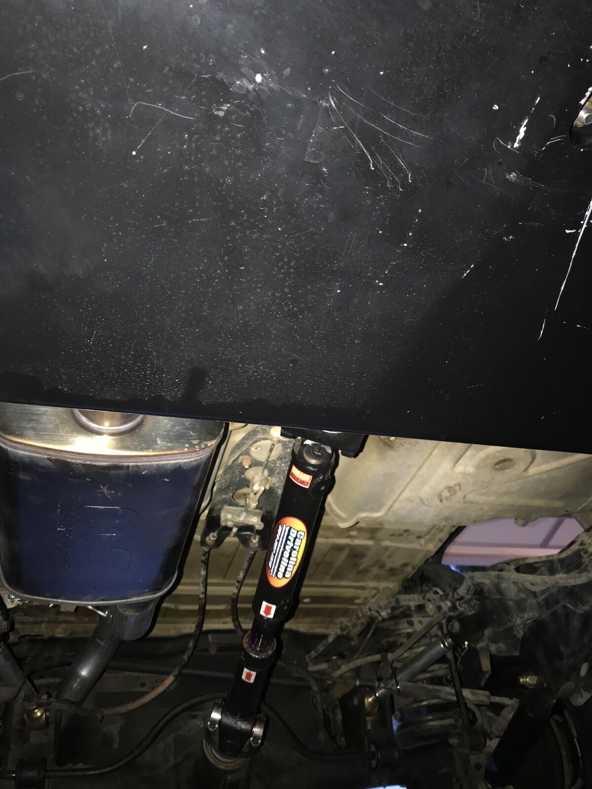

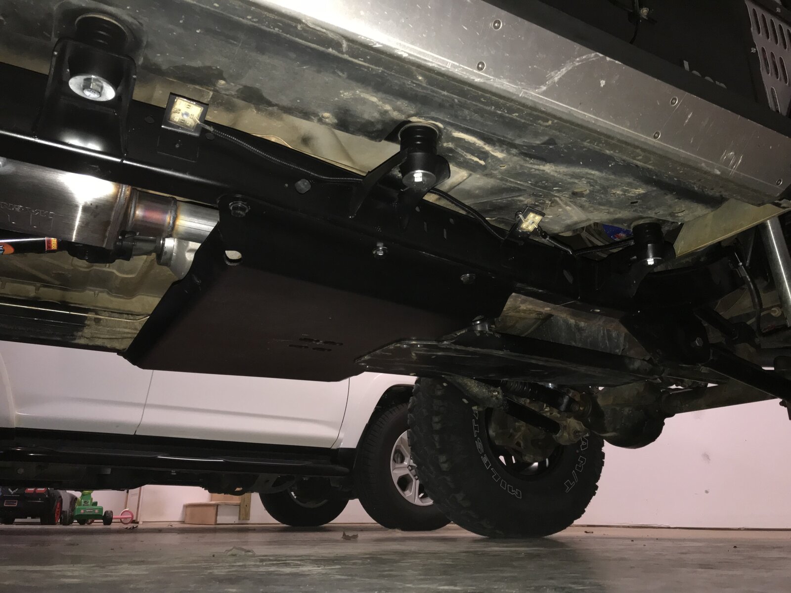

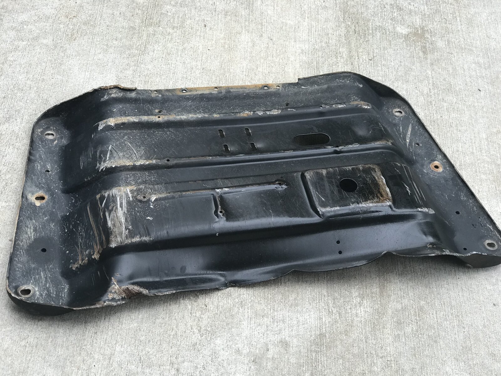

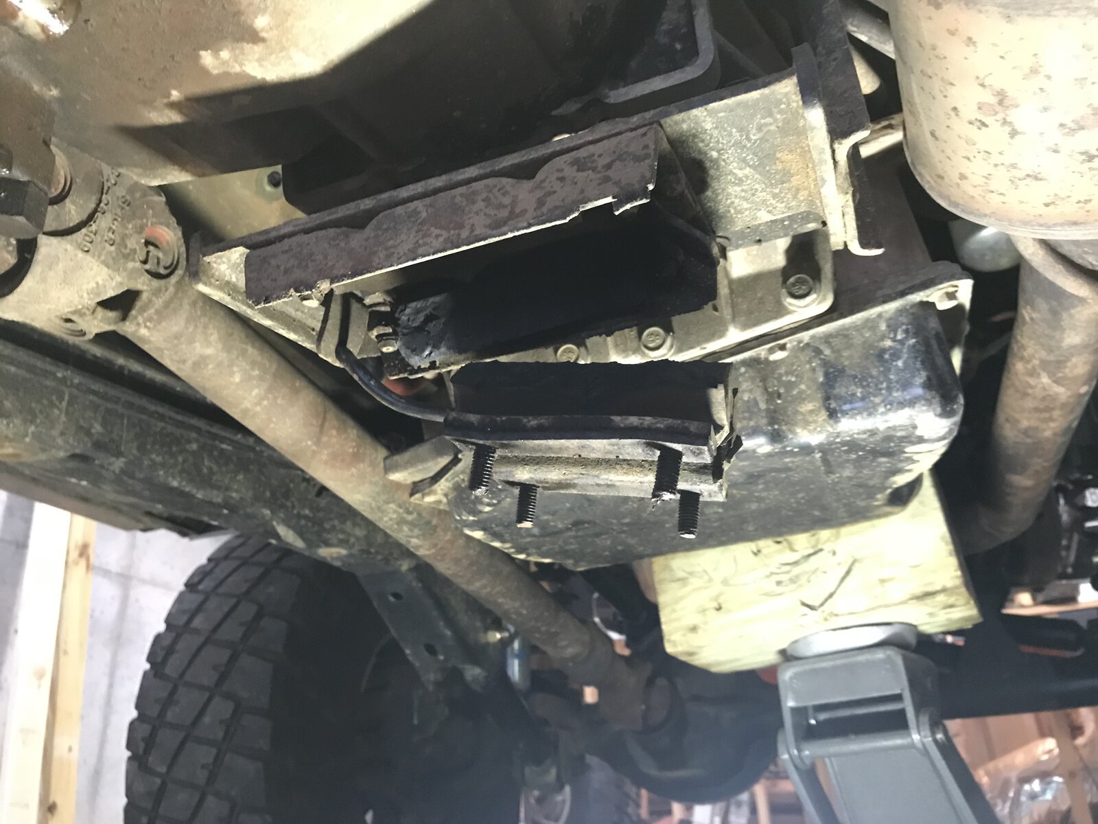

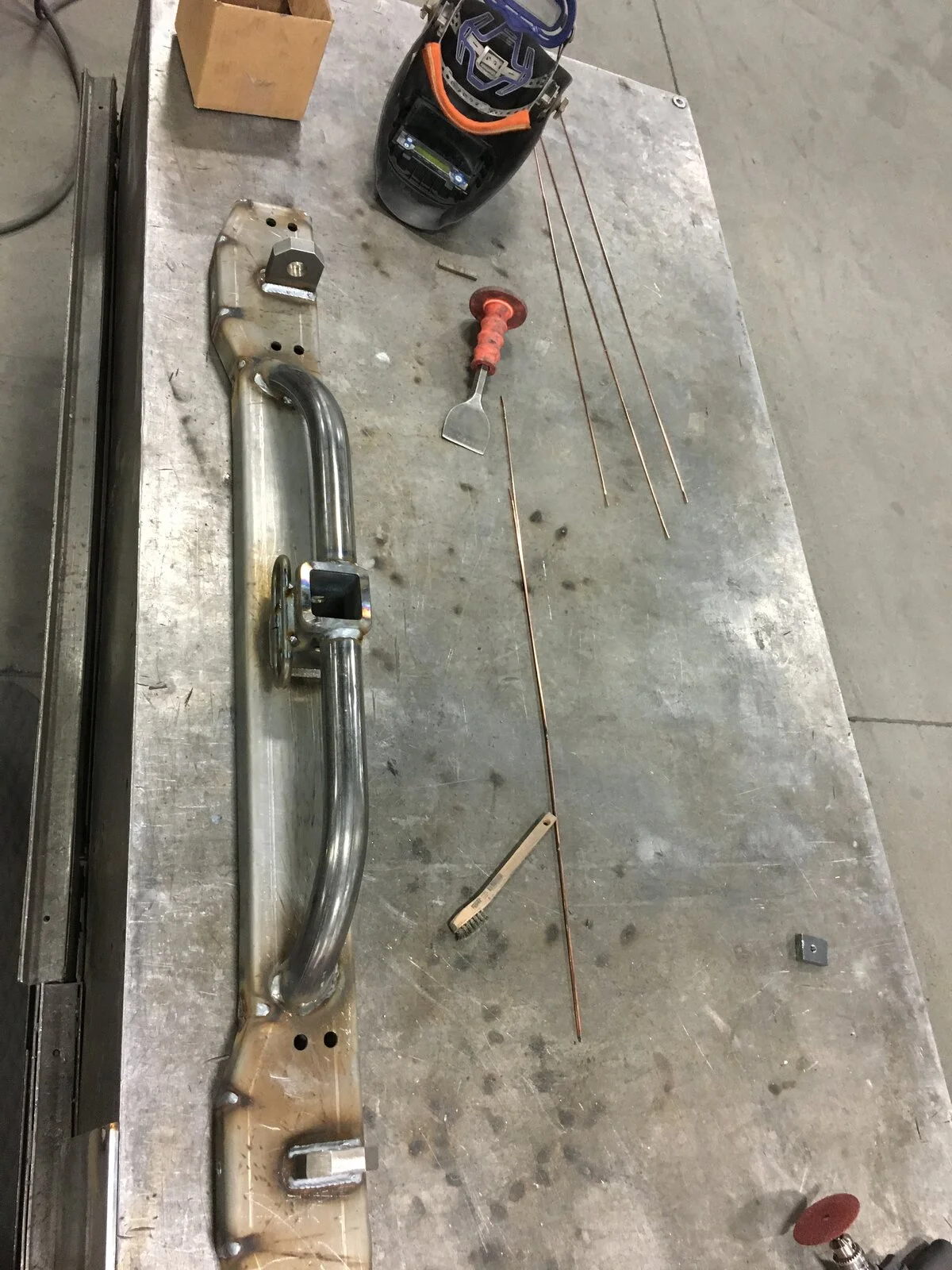

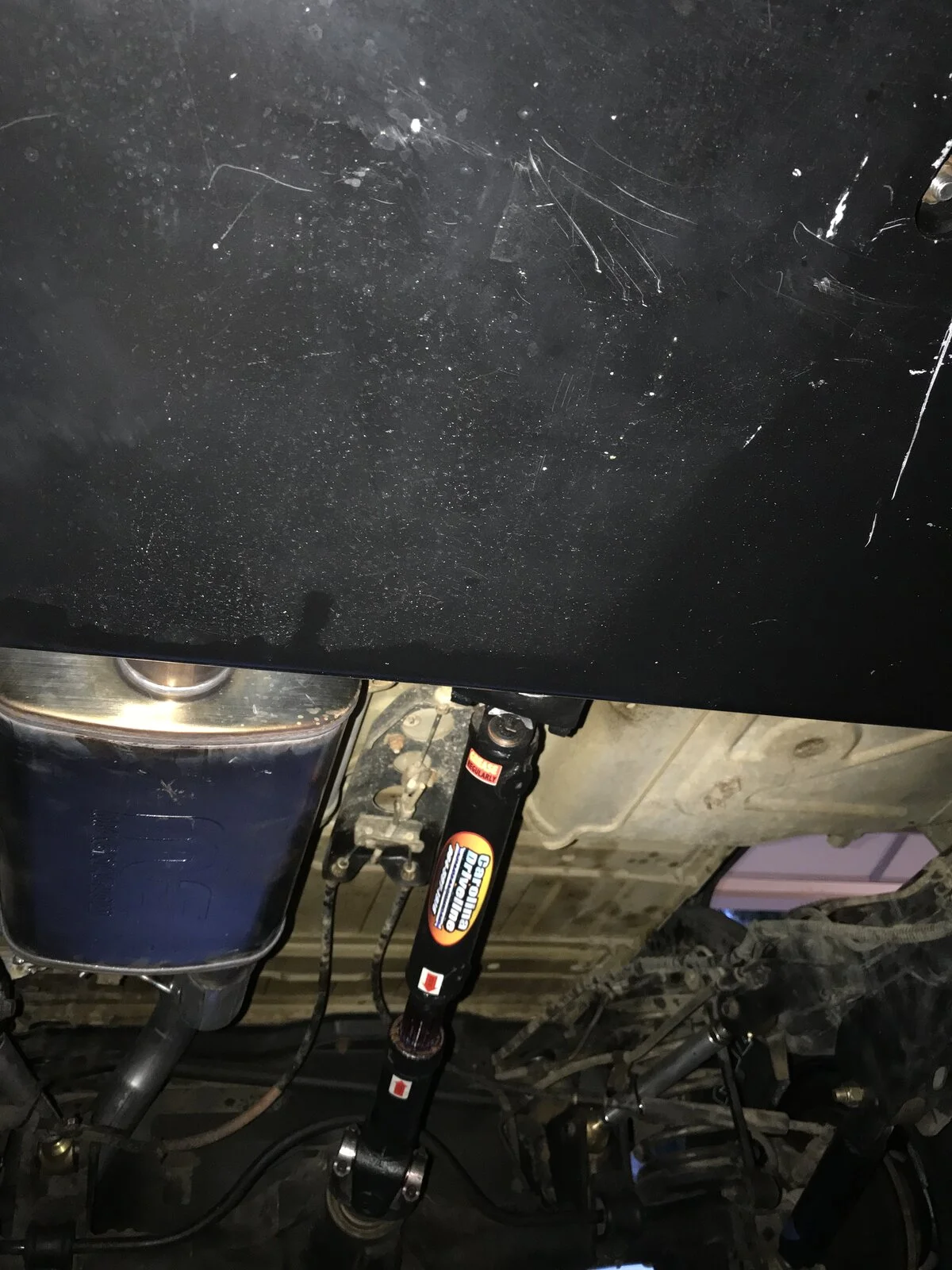

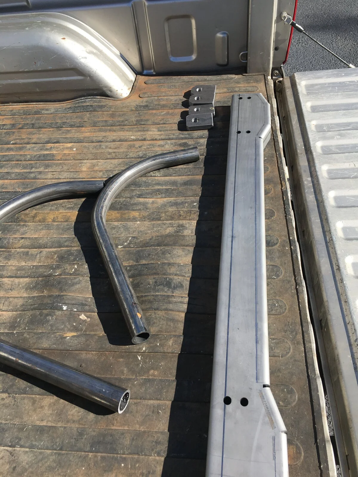

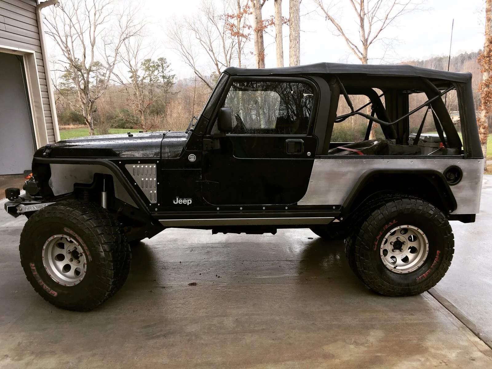

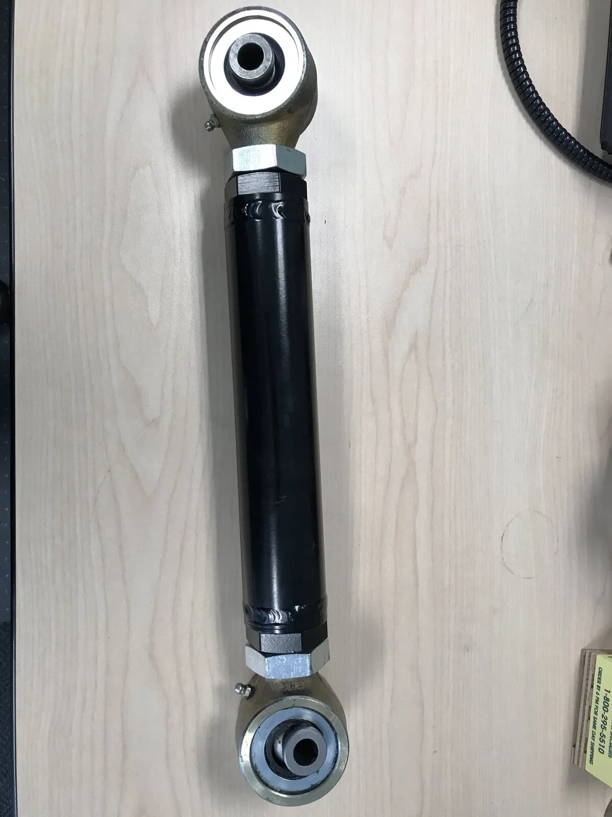

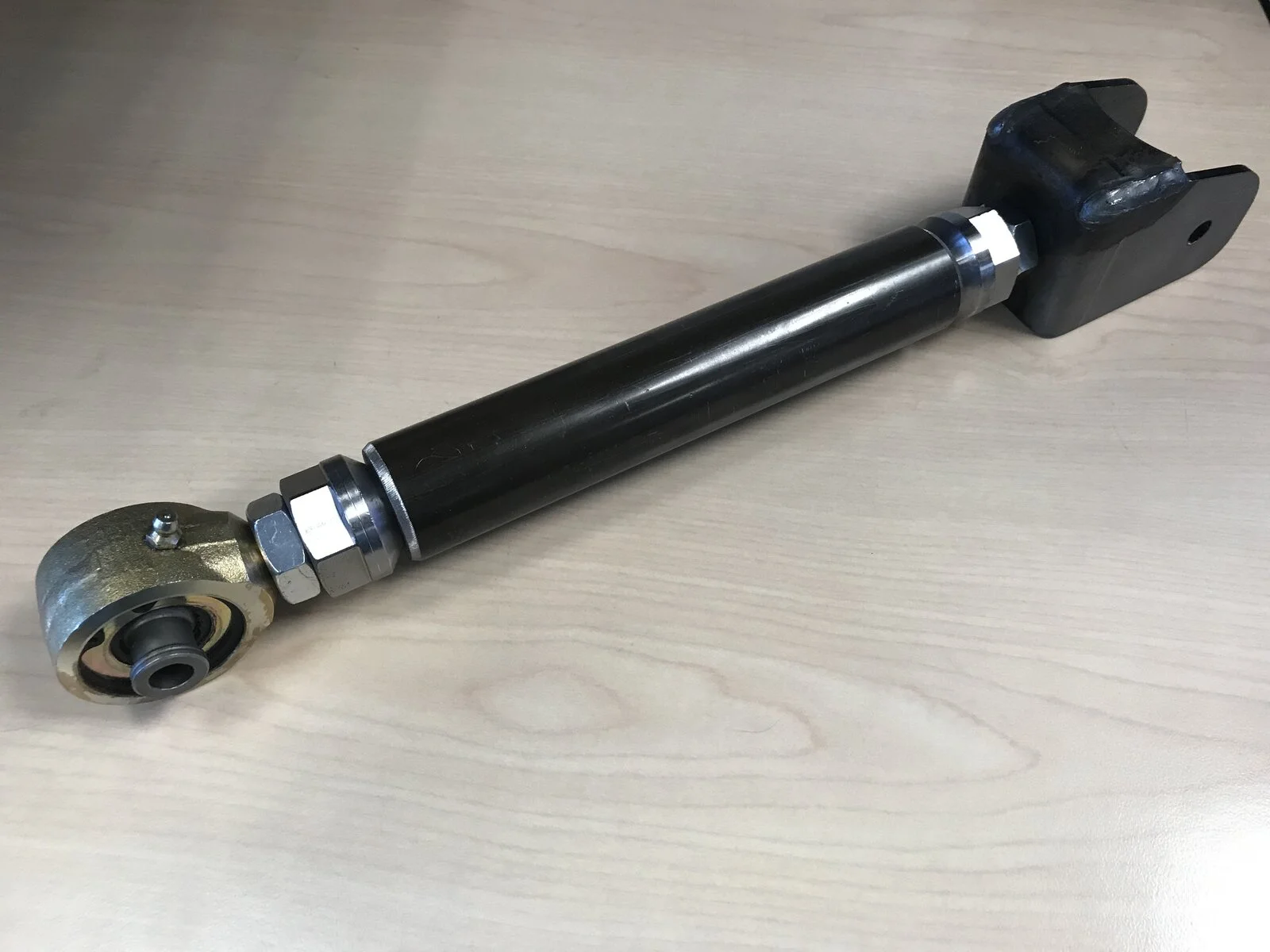

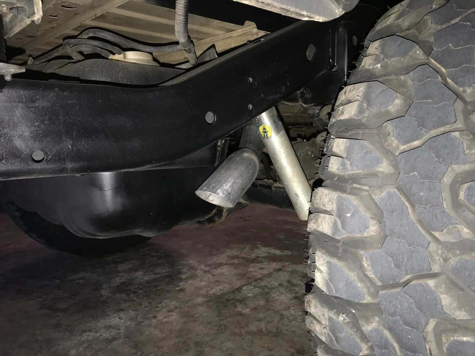

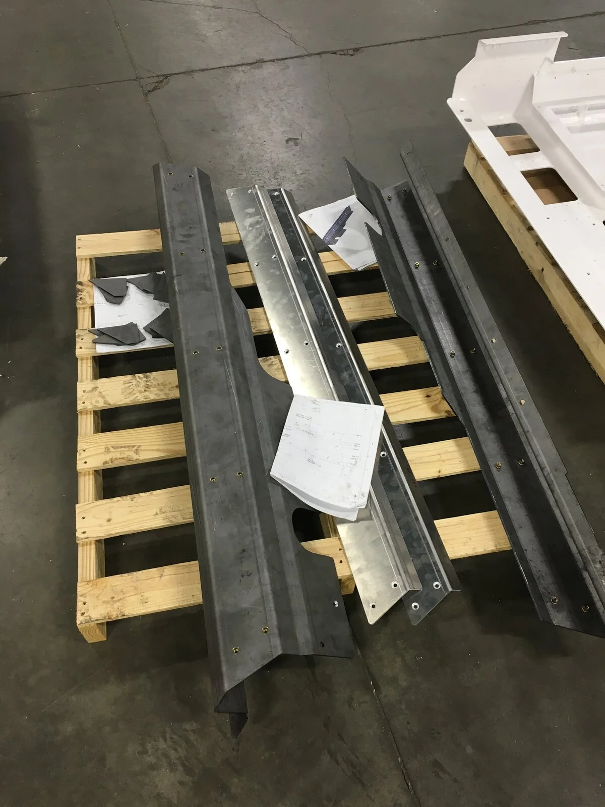

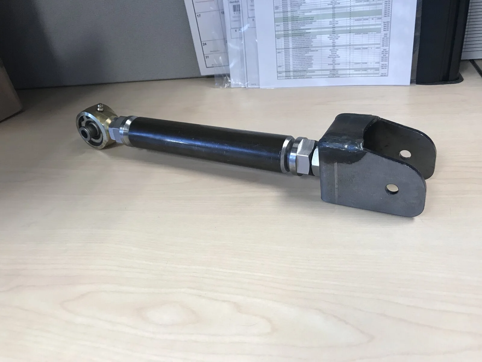

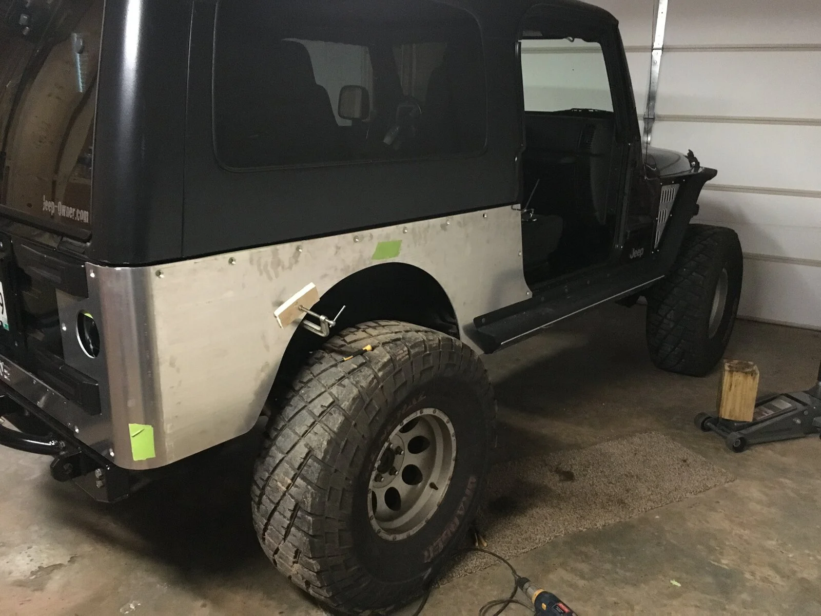

On another recent wheeling trip I got high centered pretty bad on the stock skid. It got mangled and was causing horrible driveline vibes. The time had come for a tummy tuck and SYE. I went with the UCF extra clearance skid in steel, Advance Adapters SYE, Savvy upper rear CA's, Advance Adapters Cable shifter, JKS motor mount lift, 1" Body lift, and Carolina Driveline HD rear driveshaft.
