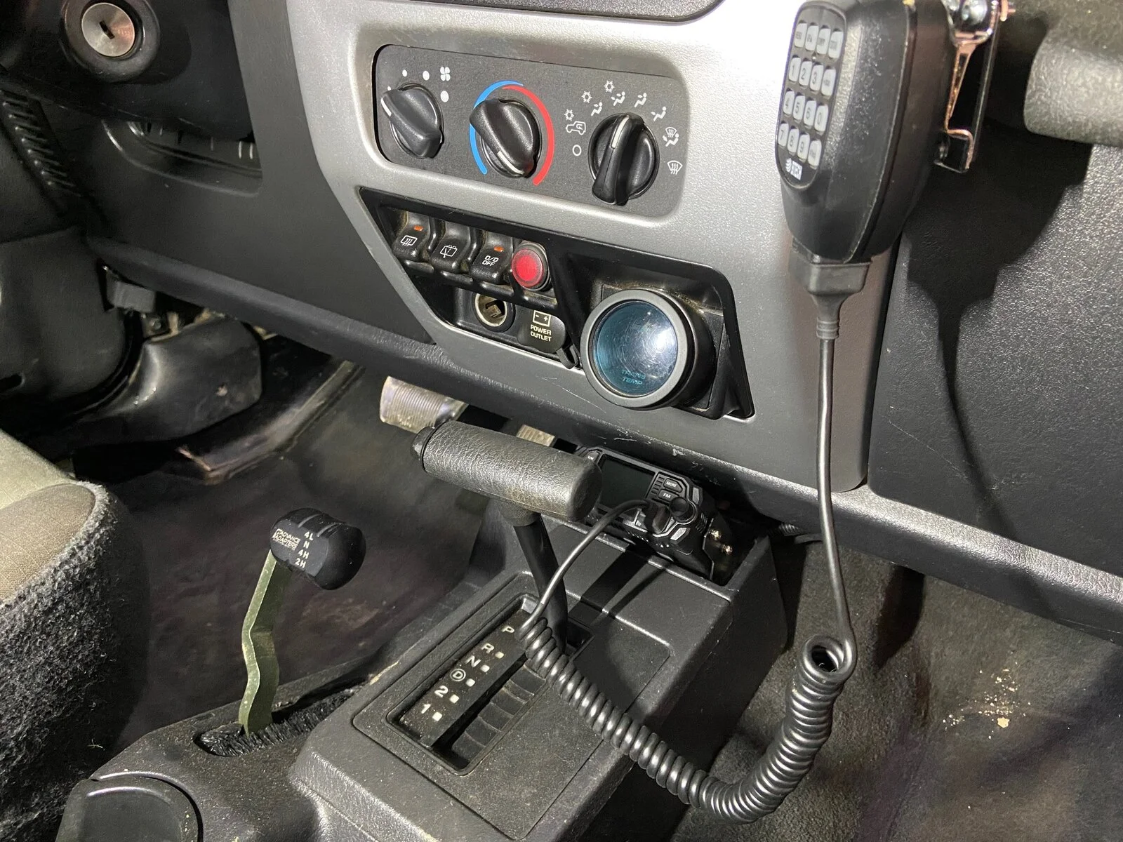

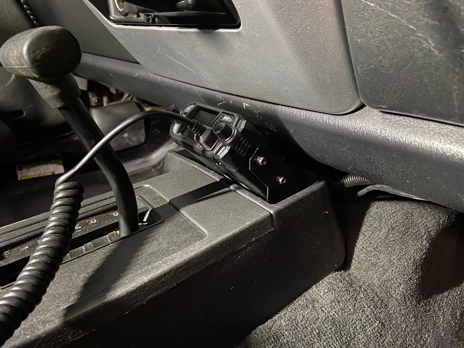

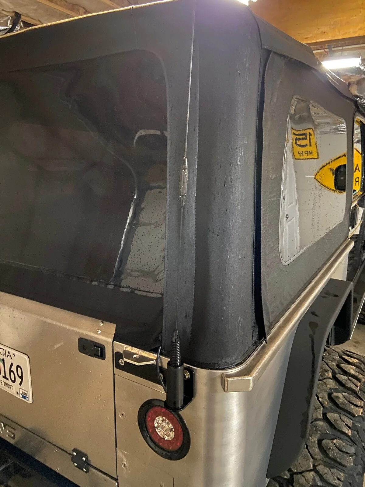

Over the last year my wheeling club made the switch from CB to GMRS. I had been using a Baofeng UV-5R handheld radio with great success but wanted the extra distance a hard mounted radio has to offer. After much back and forth I purchased a B-Tech UV-25x2. These radios are tiny compared to their ancient CB brother. This made packaging much easier. I was able to remove the overhead CB mount I pieced together and mount the radio behind the shifter. Previously I had my CB antenna installed on the tailgate hinge delete plate but that location would interfere with the rear glass if I ever decided to reinstall my factory hard top. So I came up with another bracket to move the antenna further over and out of the way just in case. (I've since cut a new delete plate without the CB antenna tab)

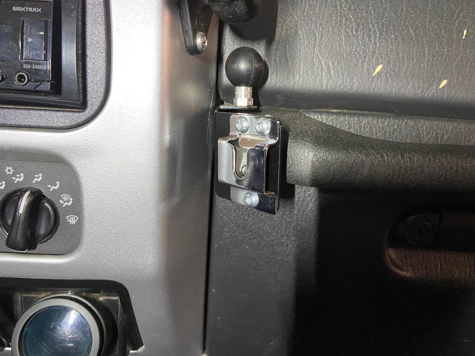

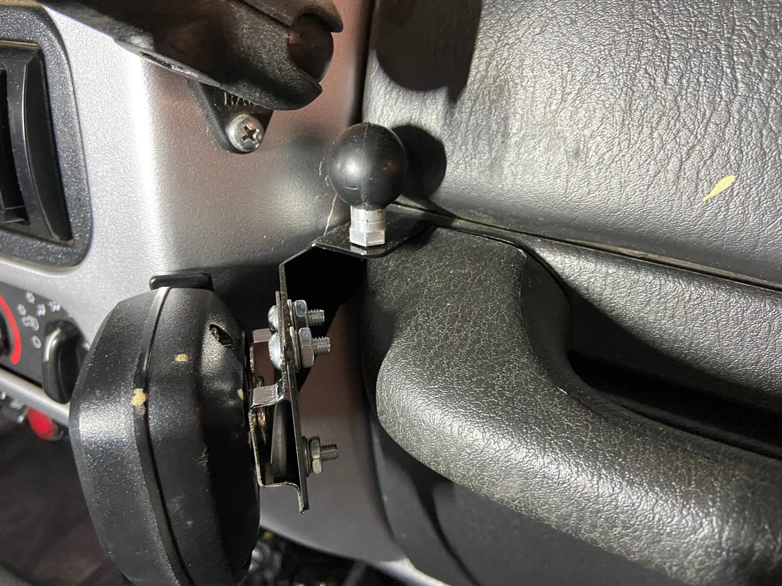

Since I removed the overhead mount I needed a place to mount the mic when wheeling. I came up with this simple combo bracket that mounts behind the factory grab bar. There are several on the market similar to this but I wanted to integrate a RAM ball to it for a phone holder. The one on my center dash will be going away as it shakes too much for my liking.

Whats the glass circle below the vent defroster? BTW we see that rubicrawler ;)
That's a trans temp gauge from GlowShift.
I wish It was a rubicrawler :cry: Its actually the replacement handle assy for the Advance adapters cable shifer.

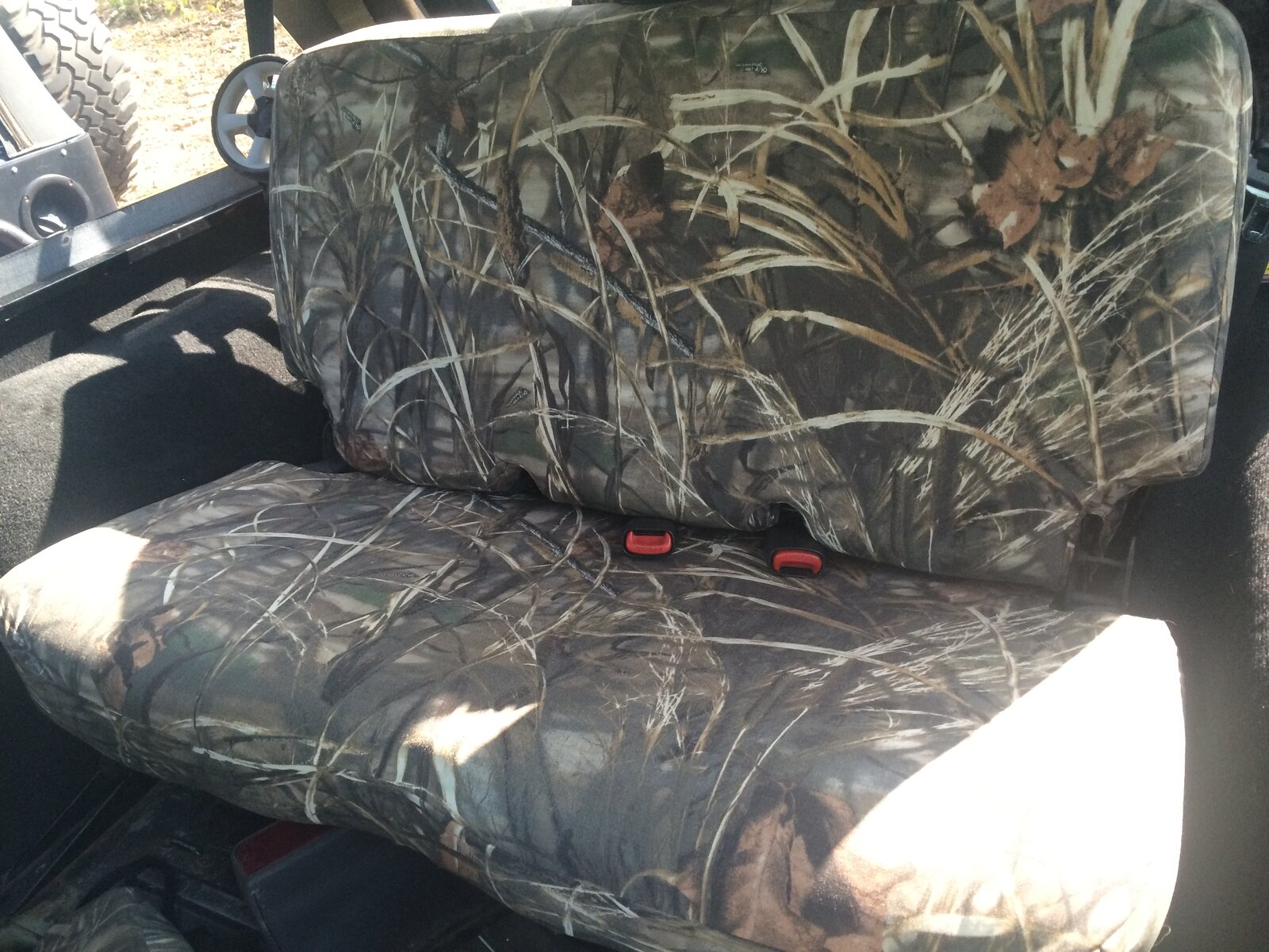

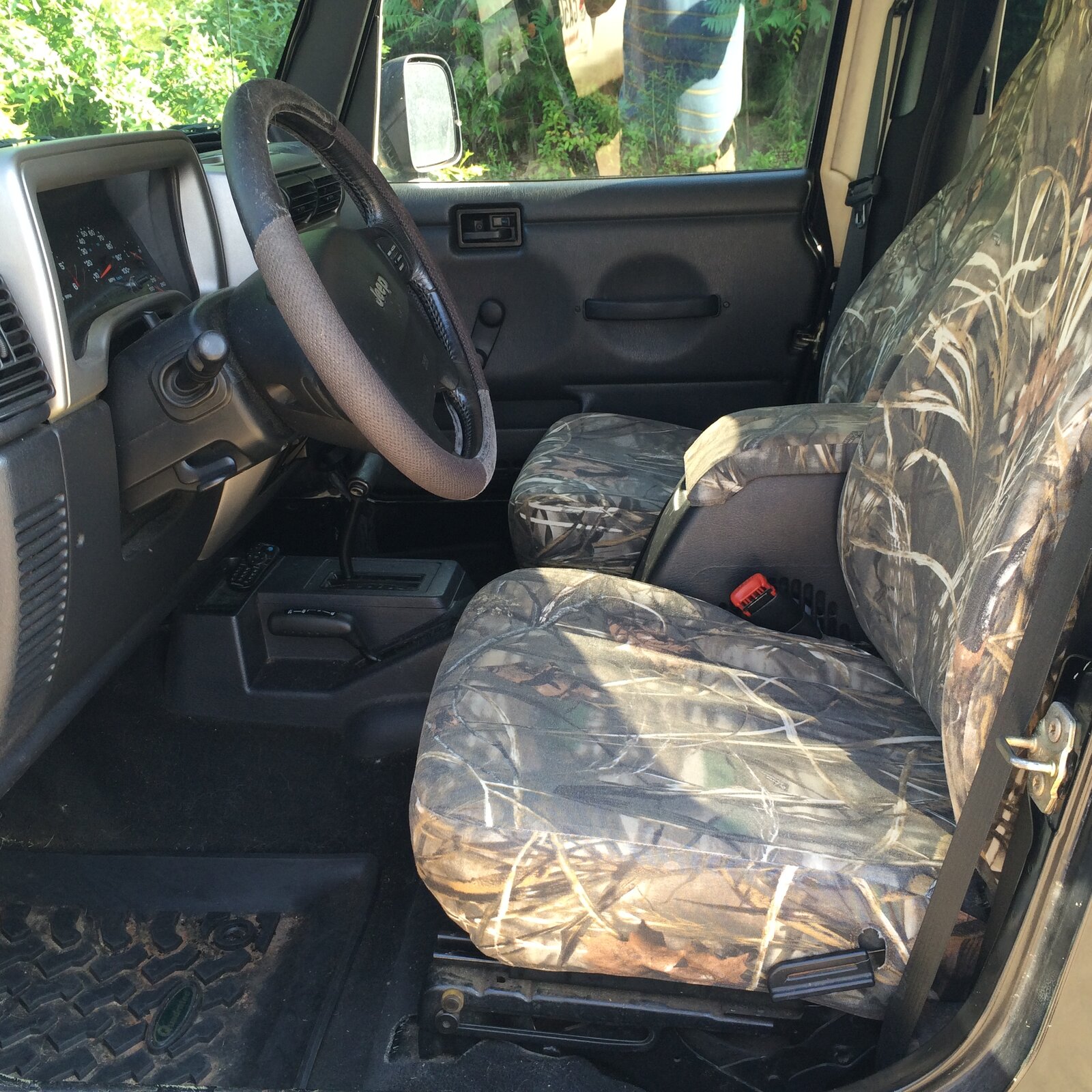

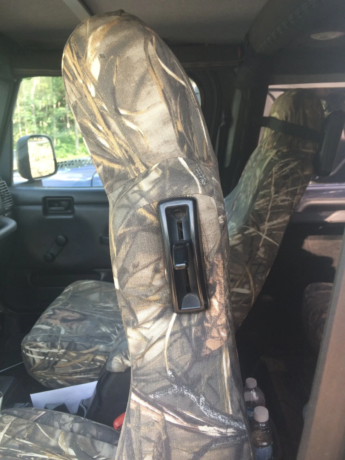

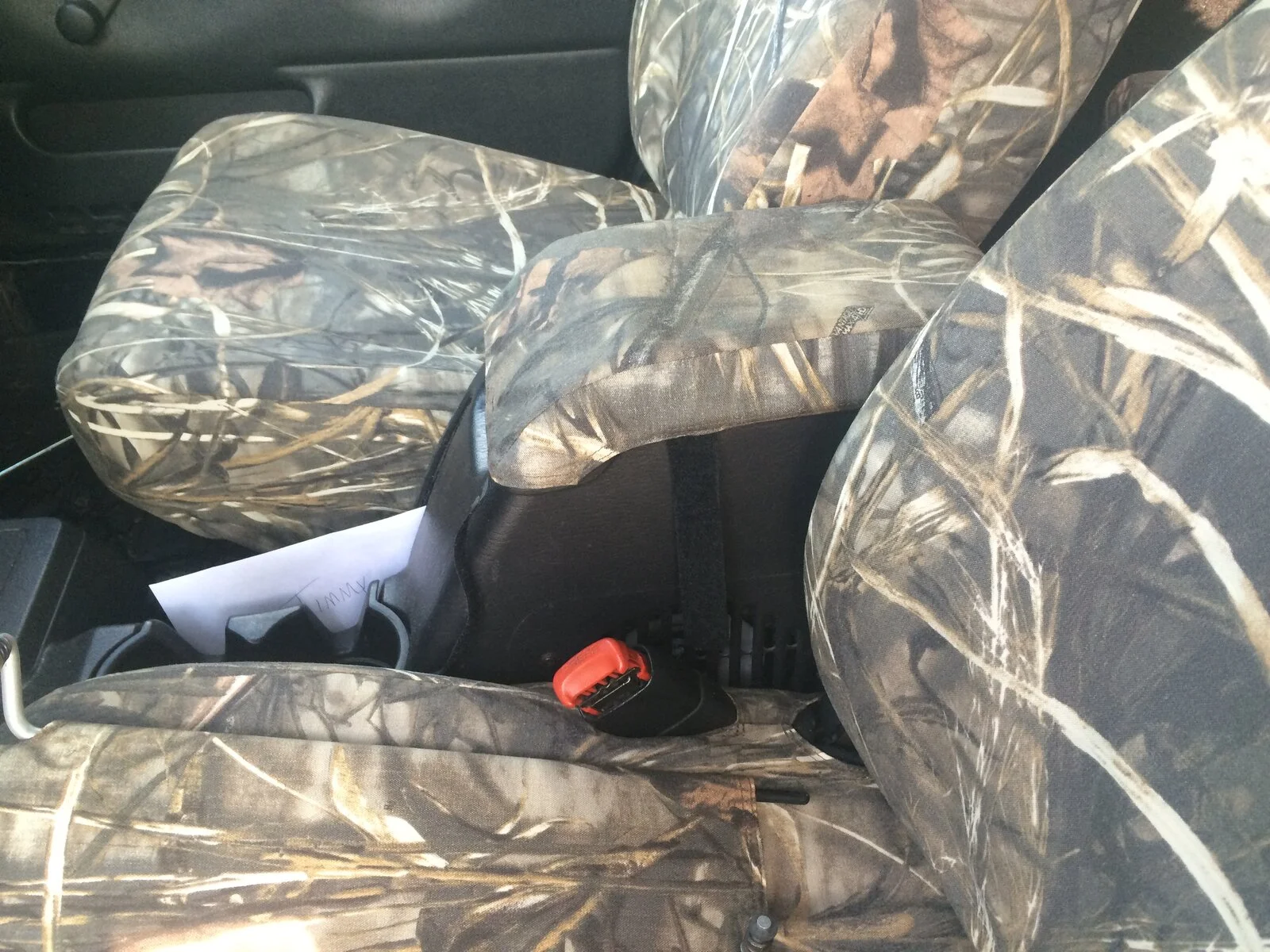

Really like the work looks great! Especially the metal Fab. Did you sell or toss the Camo seat covers?

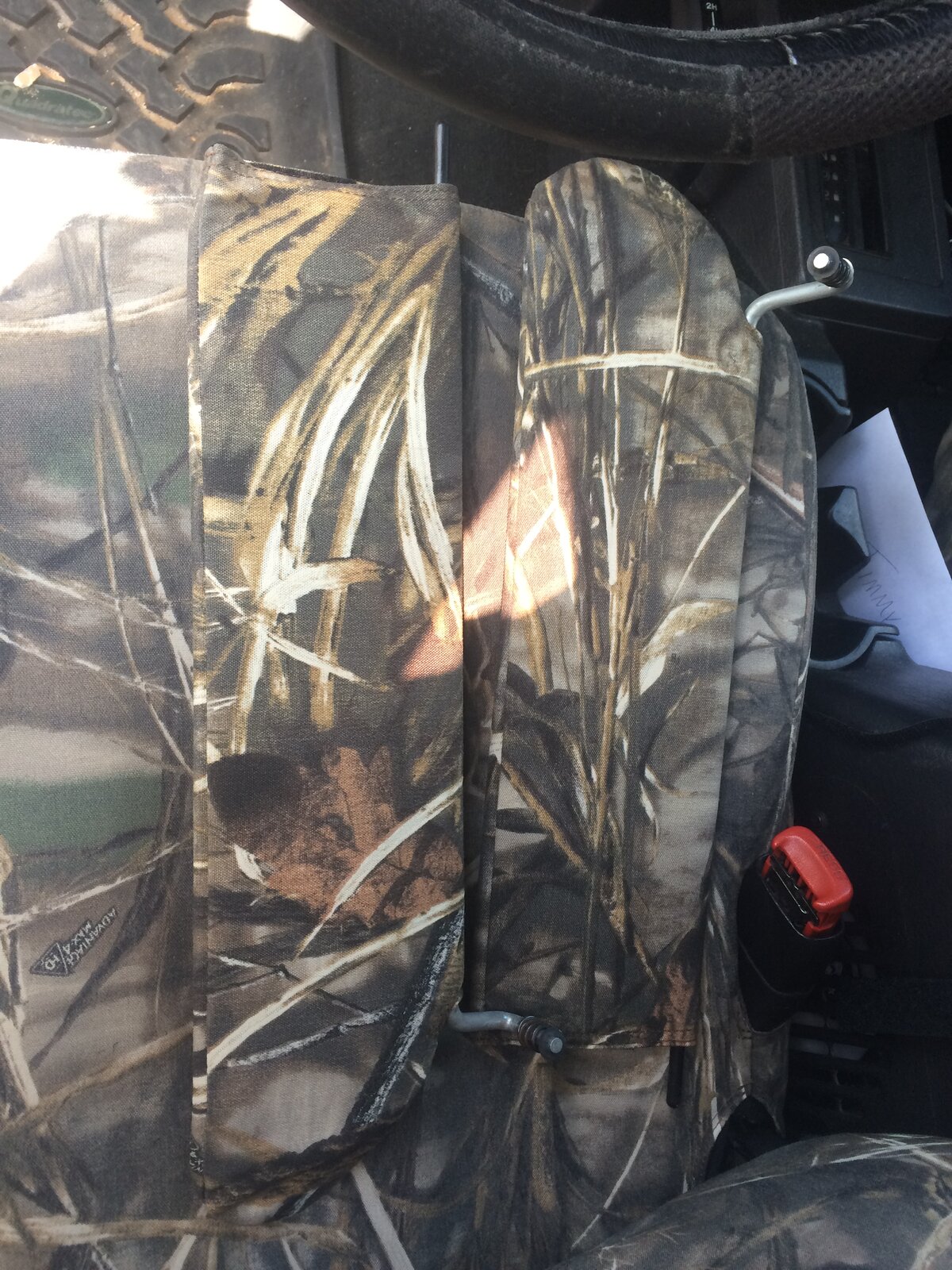

Not sure how I skipped over this part. I ended up selling those. Honestly they were some of the best fitting seat covers I have ever seen.
Those are nice. That company is in Montana near where I used to live. I talked to the owner once on the phone, seemed cool. He would build you all sorts of attachments for those also. Gun holders and pockets or drink holders stitched on.
I can see how you may not have wanted the camo tho.

That sounds interesting, based on a google search for these they appear to have been made in Three Forks, Montana . Had they been black or gray I'd still be rocking them.

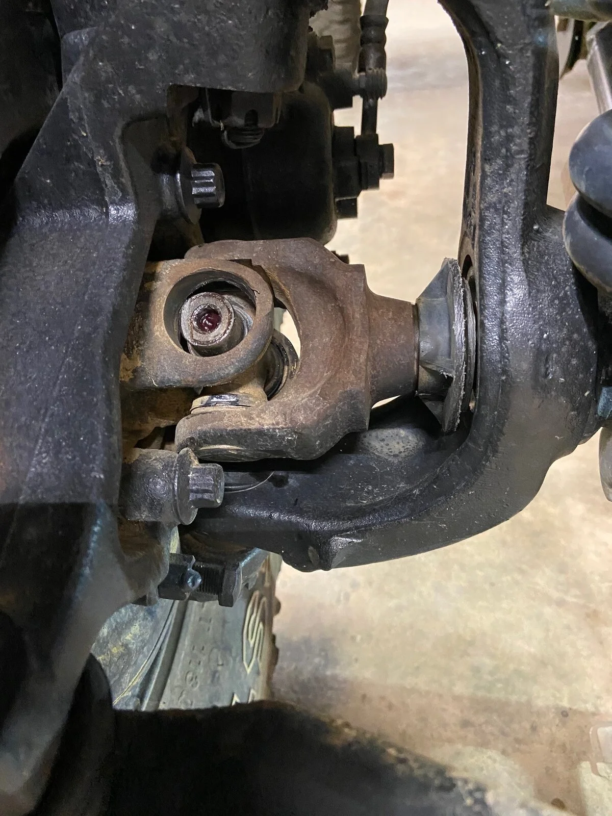

I drove the Jeep to dinner on Friday and somewhere along the way I started to hear a loud clicking/binding noise when turning. After I got home I found a spit u-joint cap. Looks like some new Spicer 5-760x joints are in store. At first I didn't see the joint so I popped open the diff cover. Everything looks good in there so I guess it just gets a gear oil change and new pinion seal since the old one was leaking. Trying not to spend to much money on these 1/4 ton axles since there not long term. Only fixing what breaks and routine maintenance.

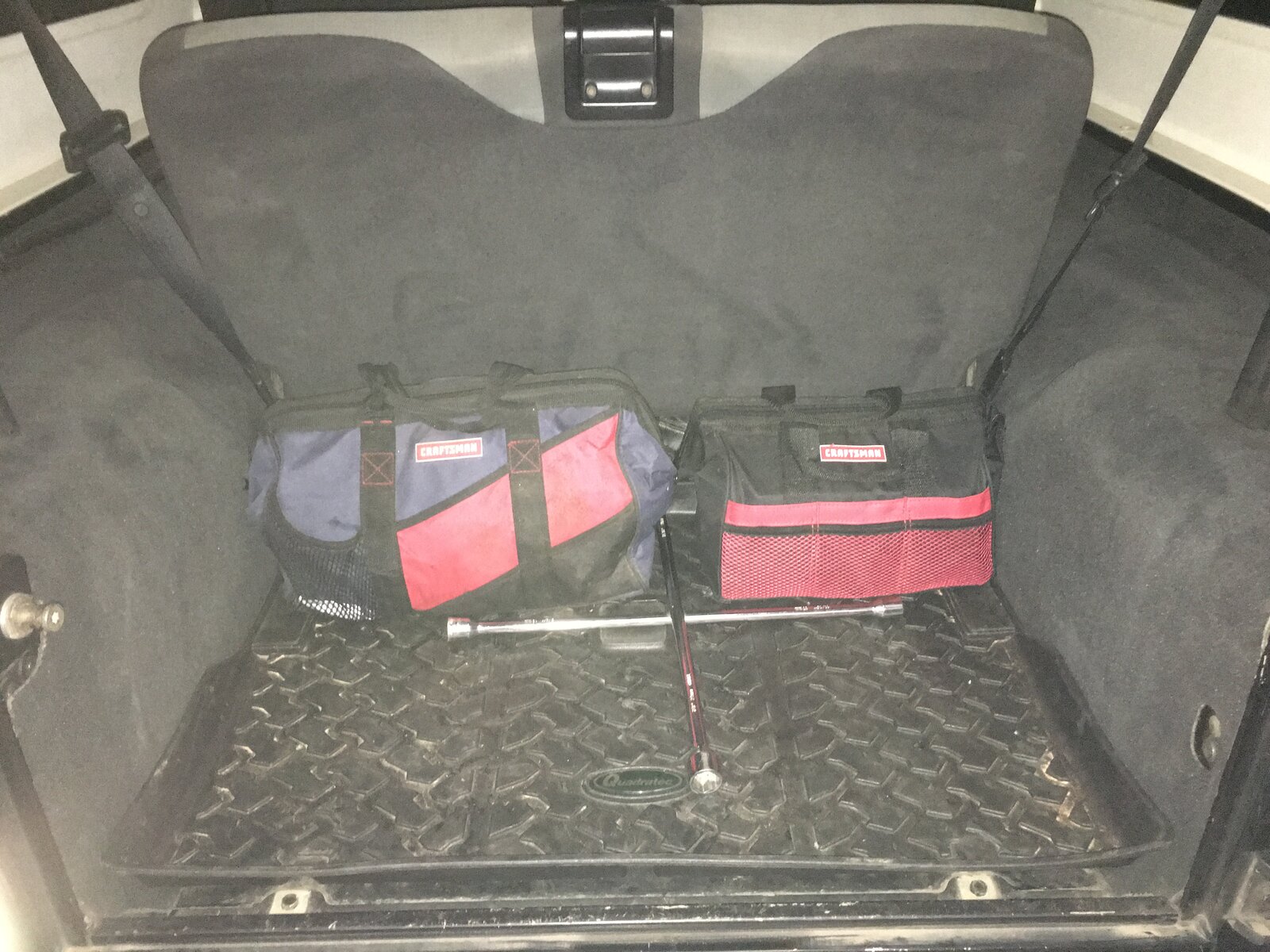

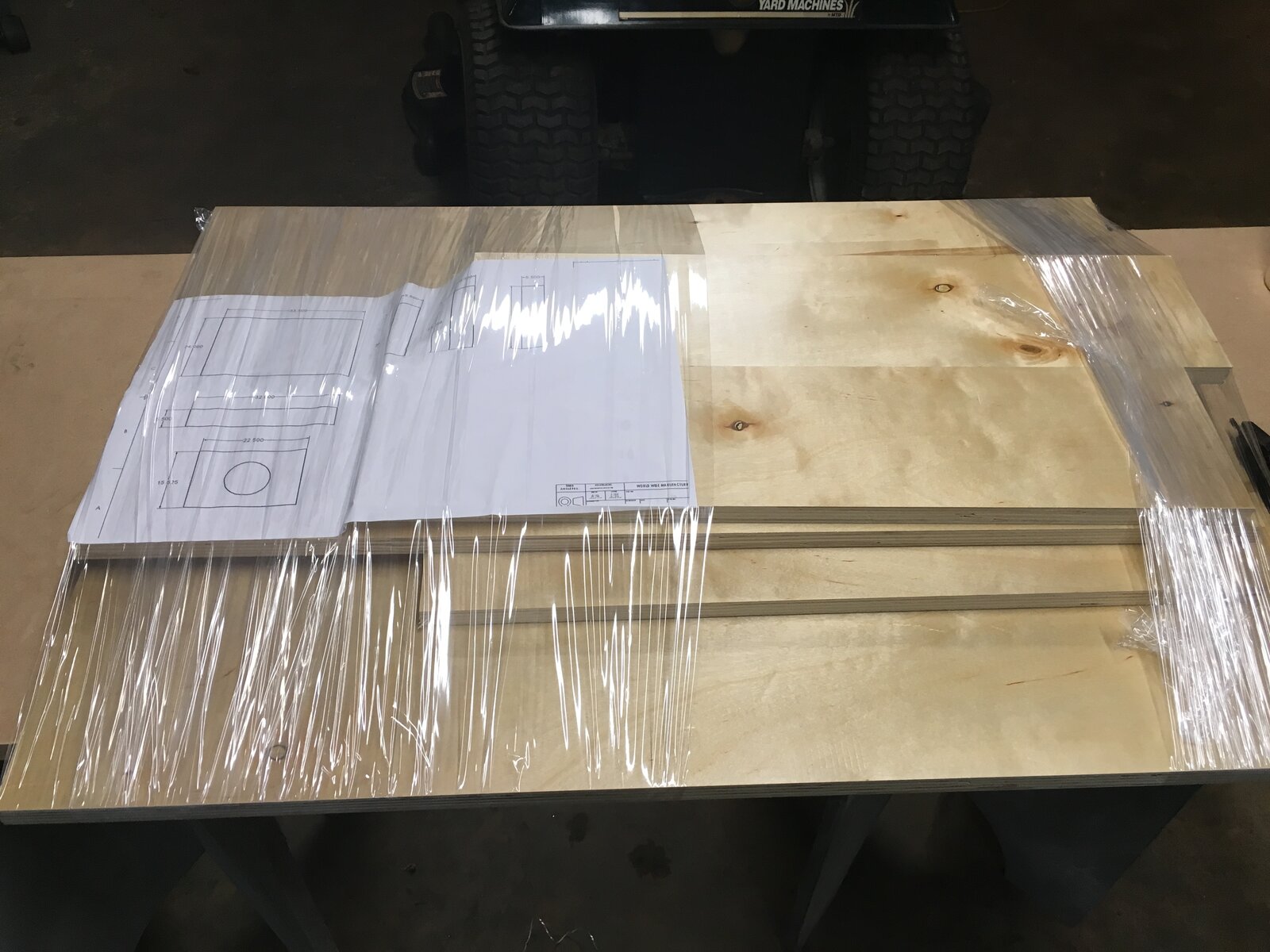

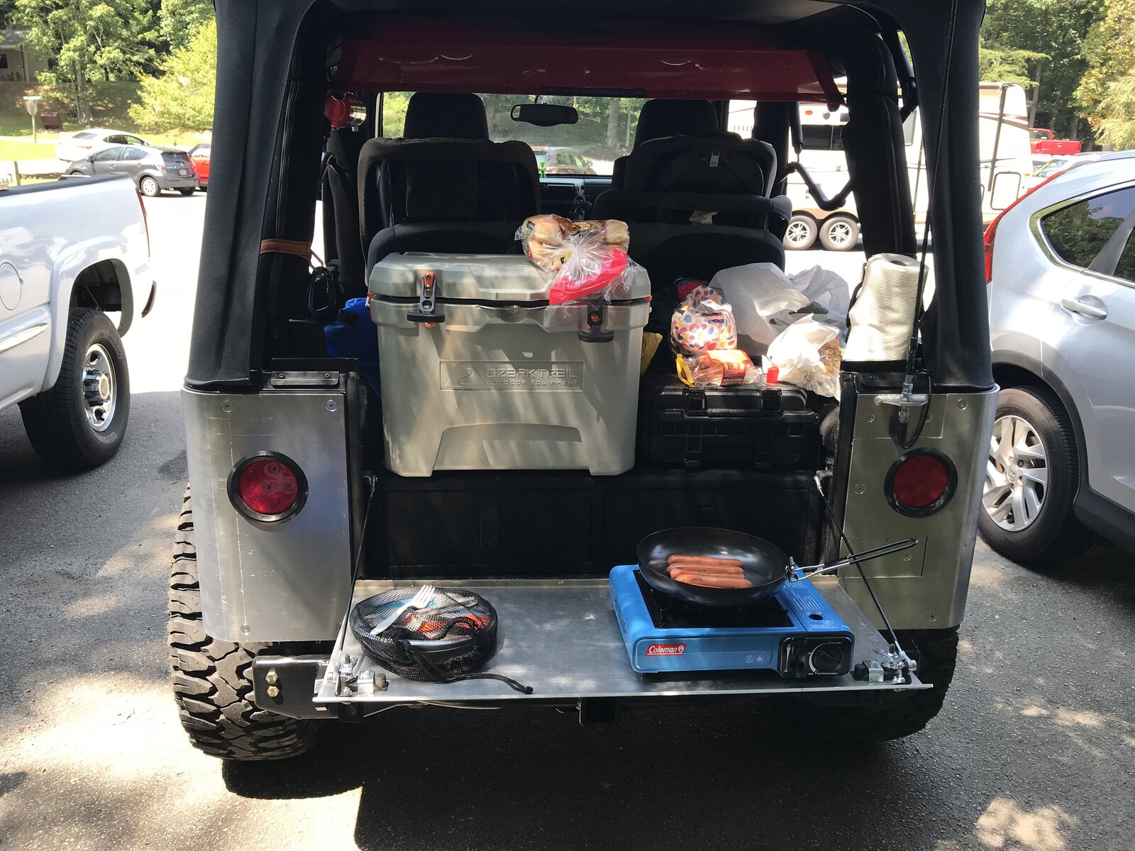

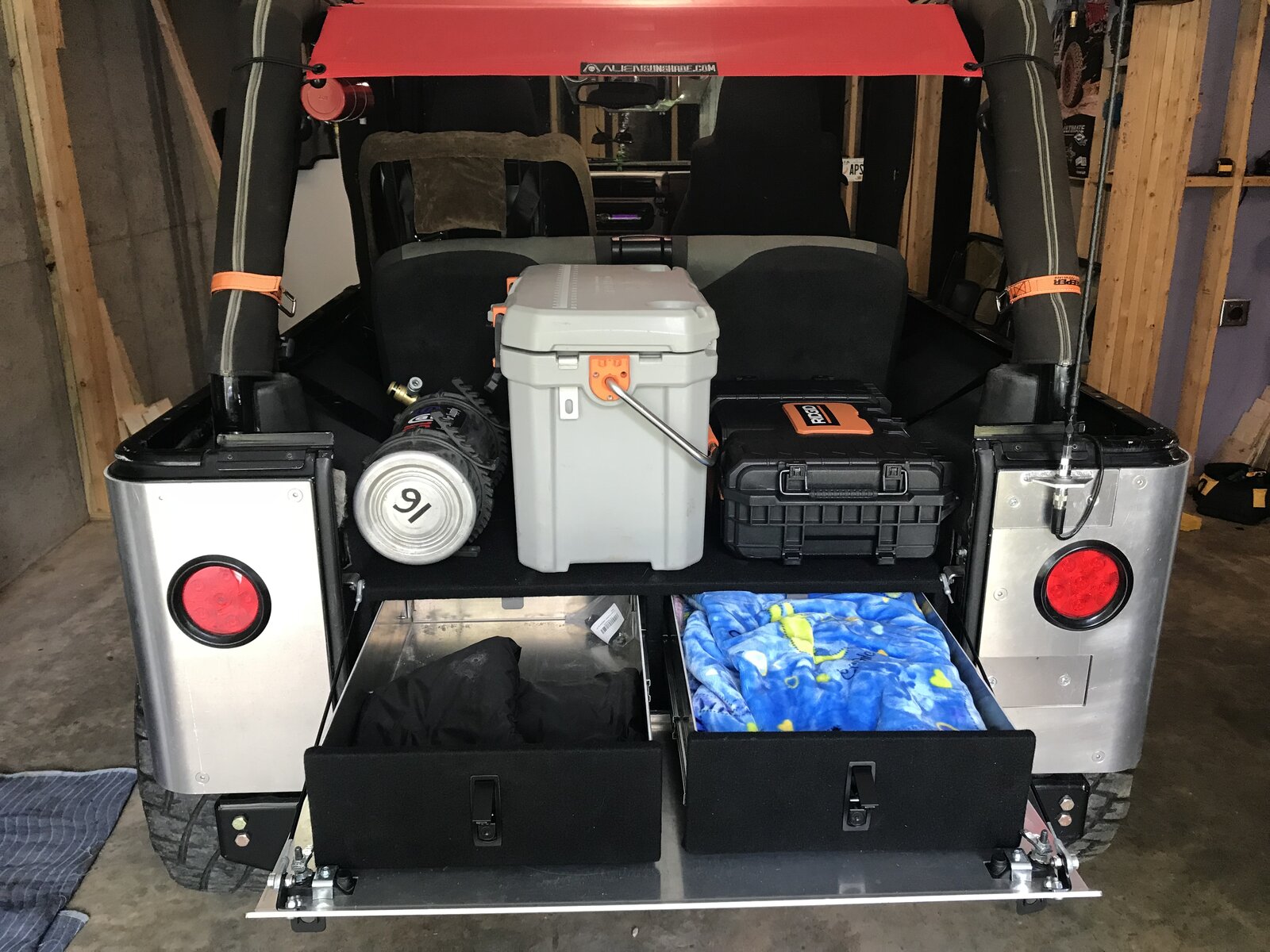

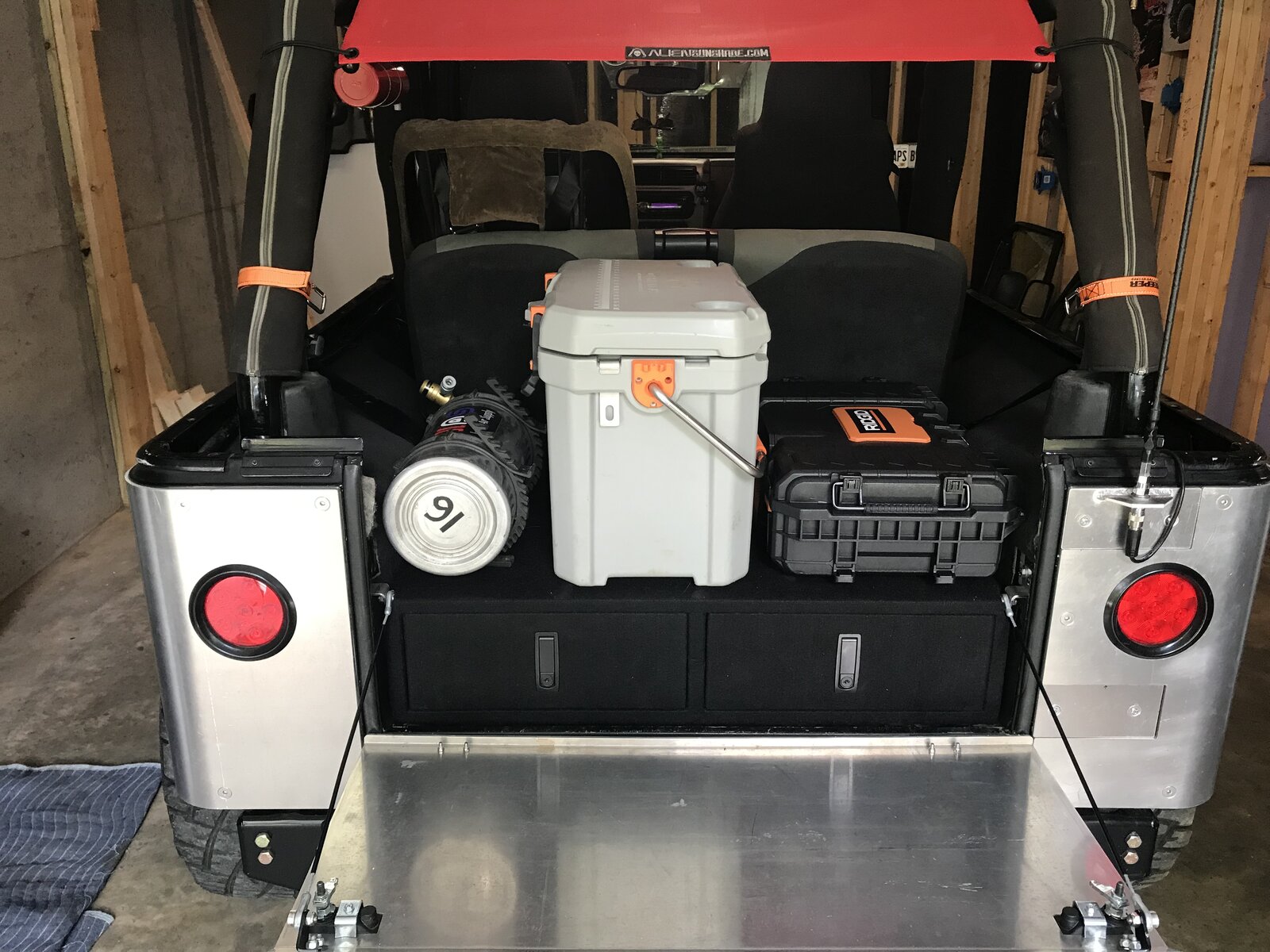

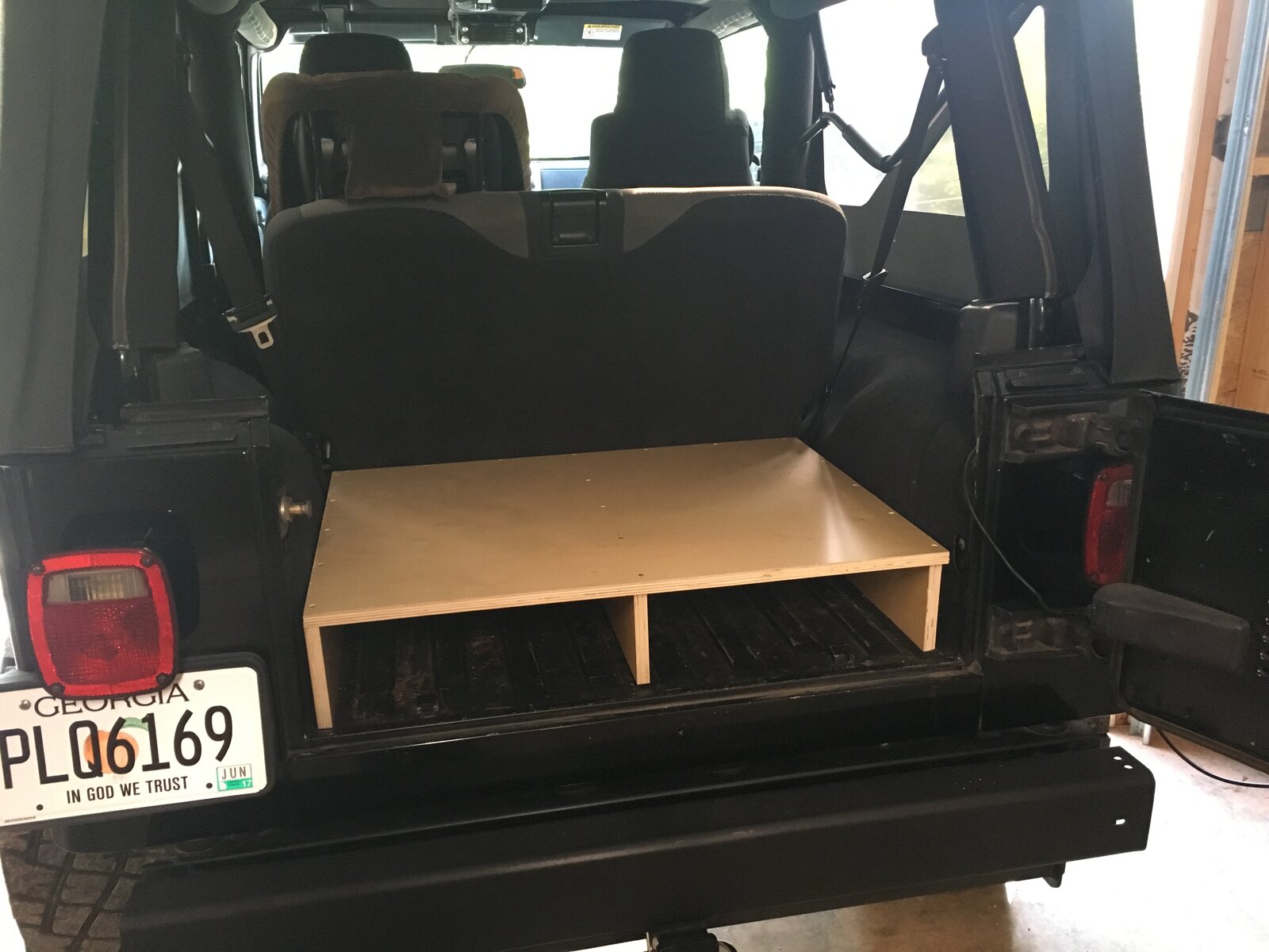

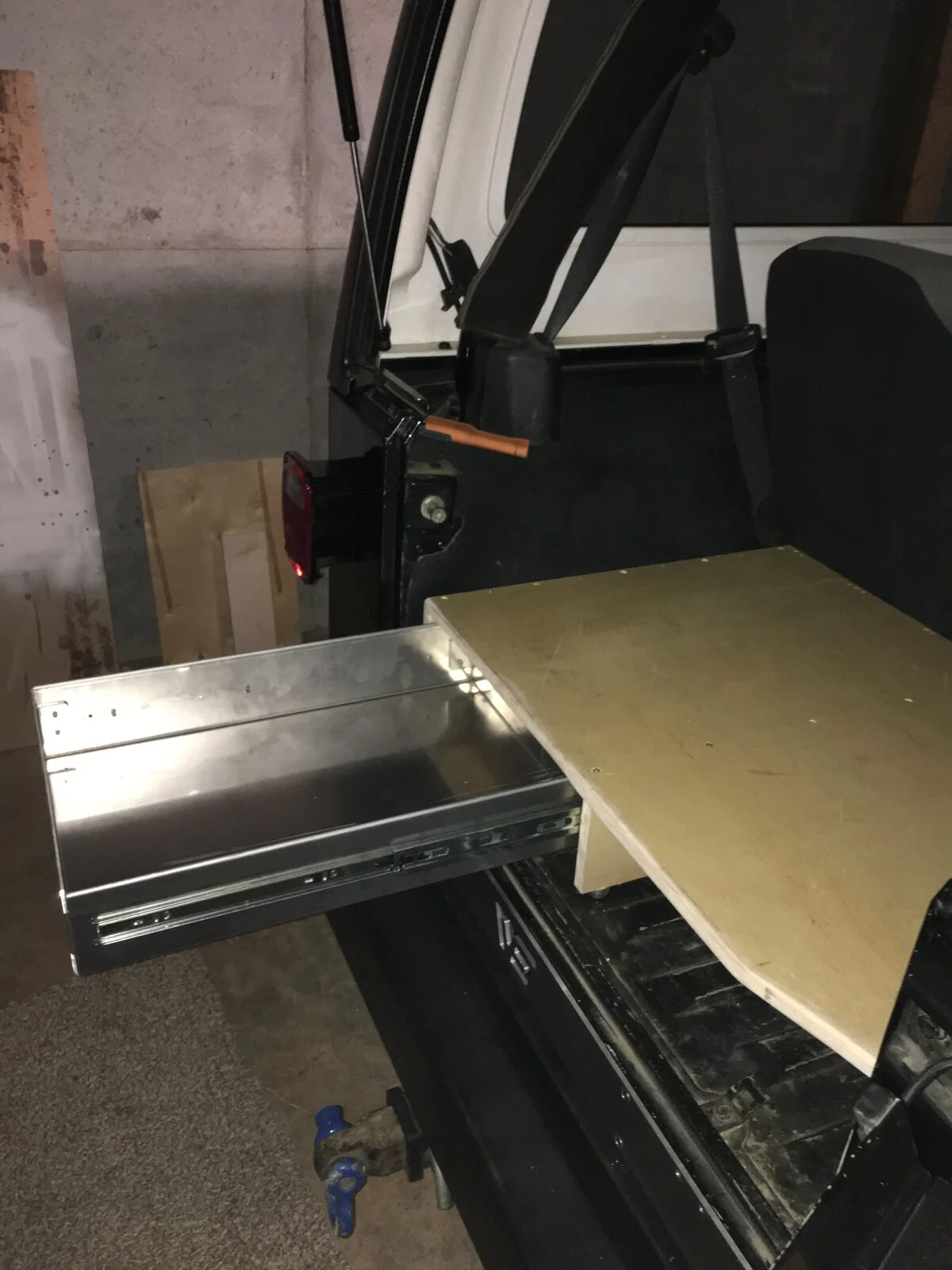

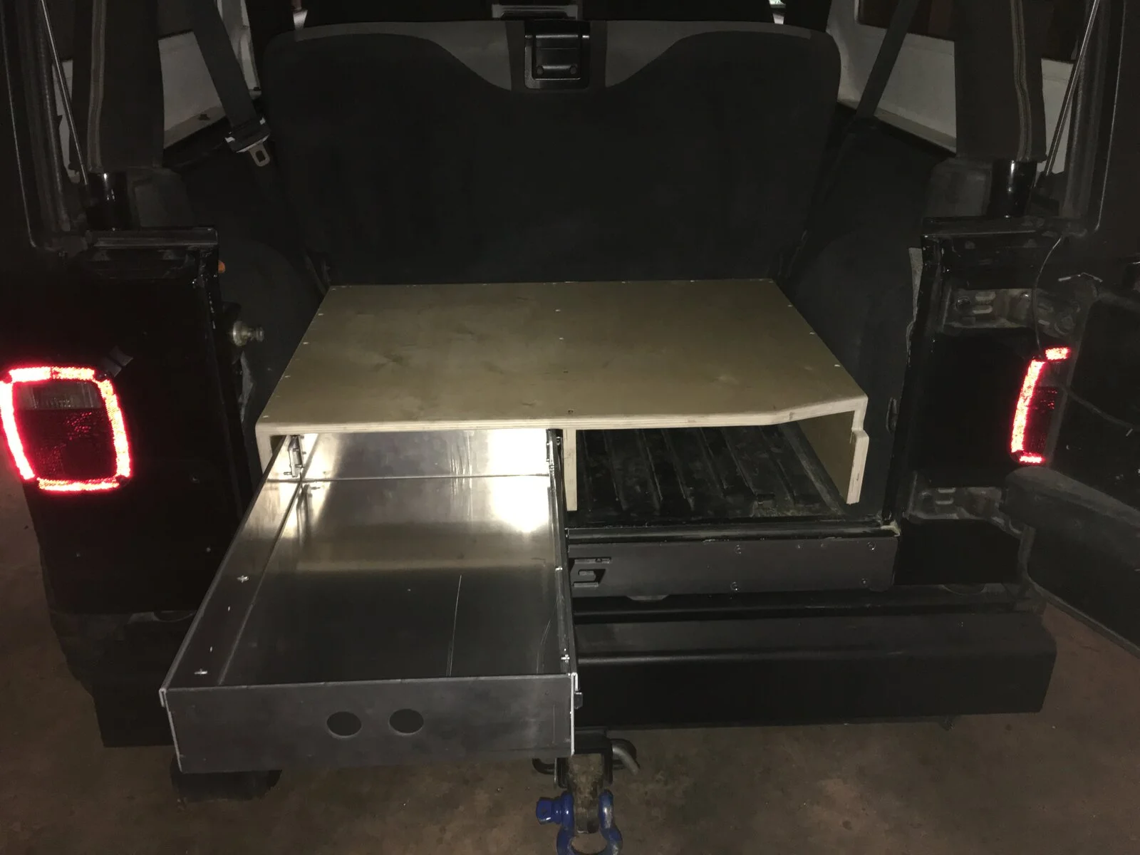

I wasn't super happy with just carrying my tools and recovery gear in bags and strapping them down in the tub. After some collaboration with a friend who works at a cabinet shop I came up with a slick drawer setup. The drawer body is made from UV sealed 3/4" Plywood and wrapped in automotive carpet. The drawers are 1/8" aluminum. This setup has been super nice and rattle free. It bolts down to some factory holes in the tub so in the event of a roll it should stay put.
Did you make the aluminum drawers or buy? They looks like good size. How does the size work for wheeling gear?
I made those as well. The size seems to work out great for my needs. I used some oak hardwood and made drawer fronts and screwed it to the drawer body. Then I wrapped everything in Black automotive carpet.

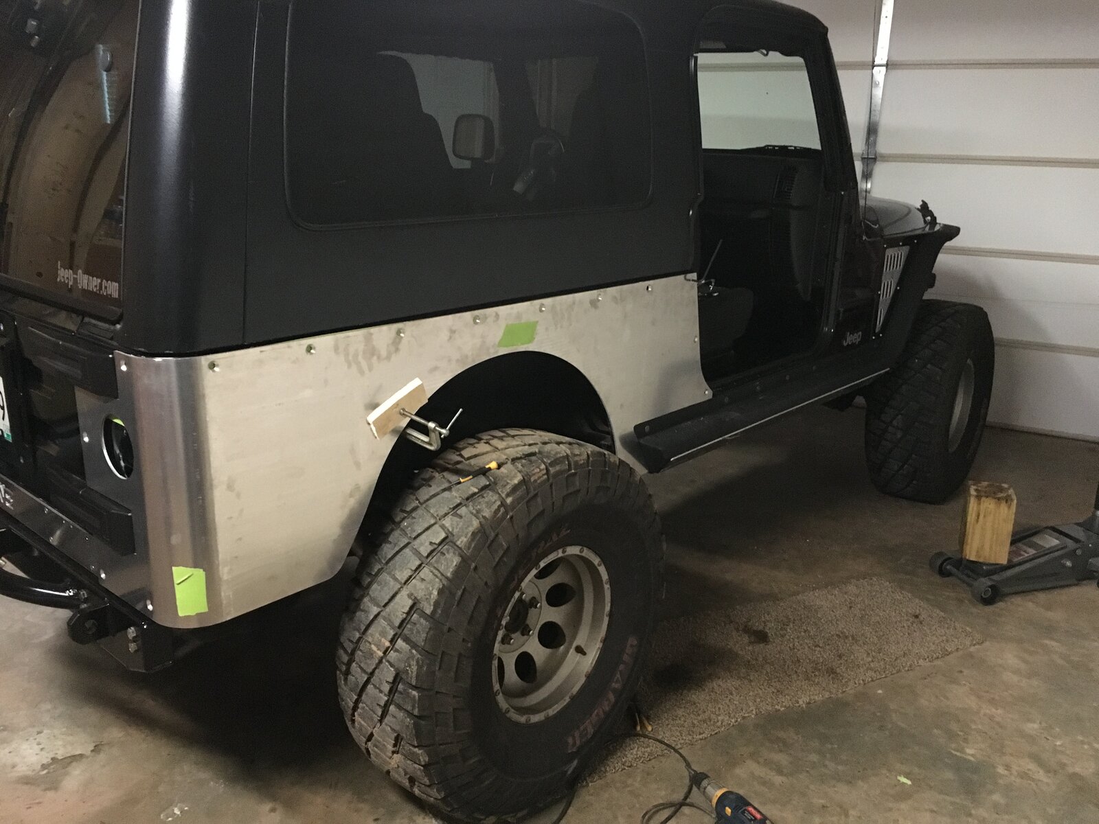

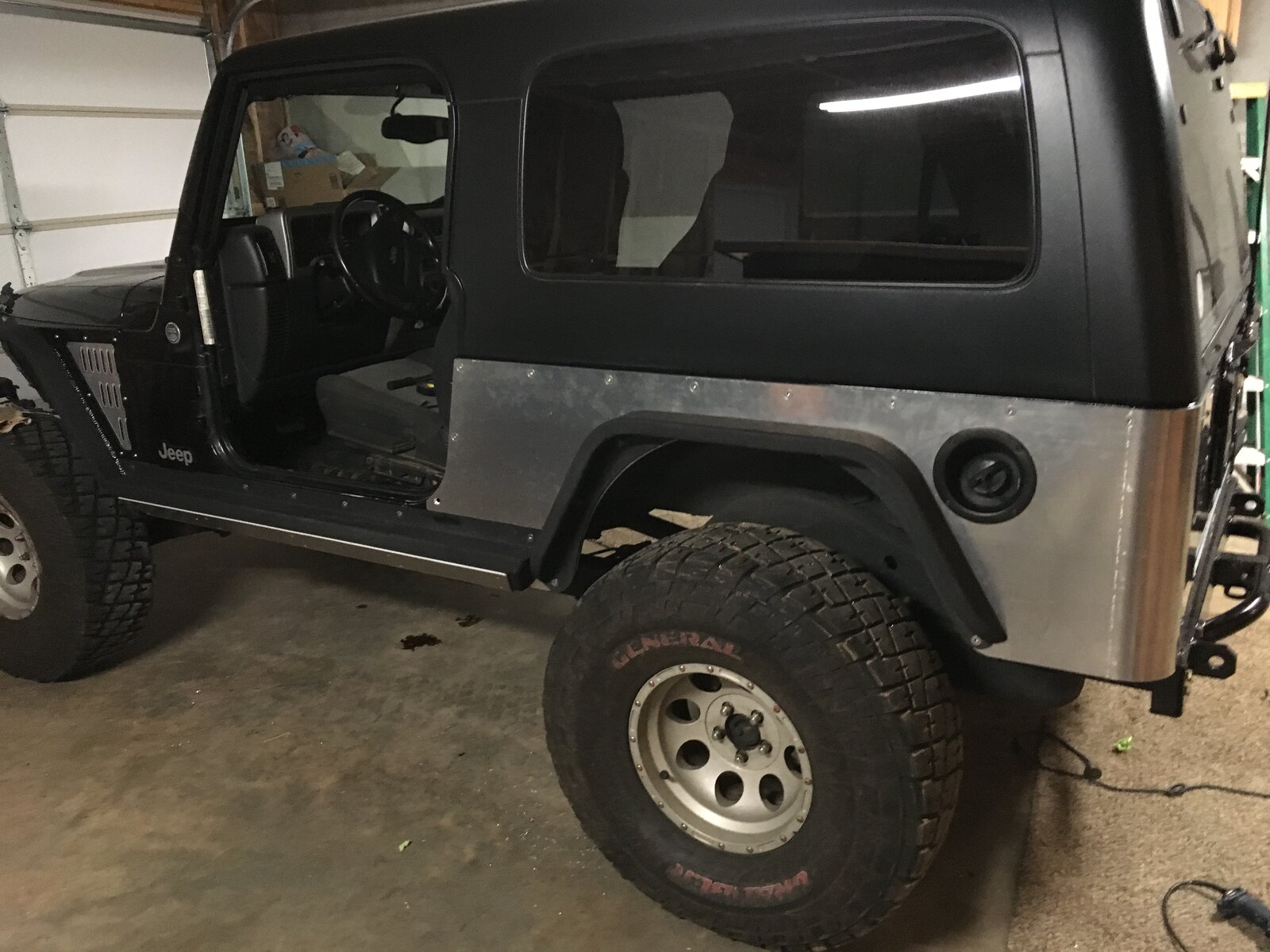

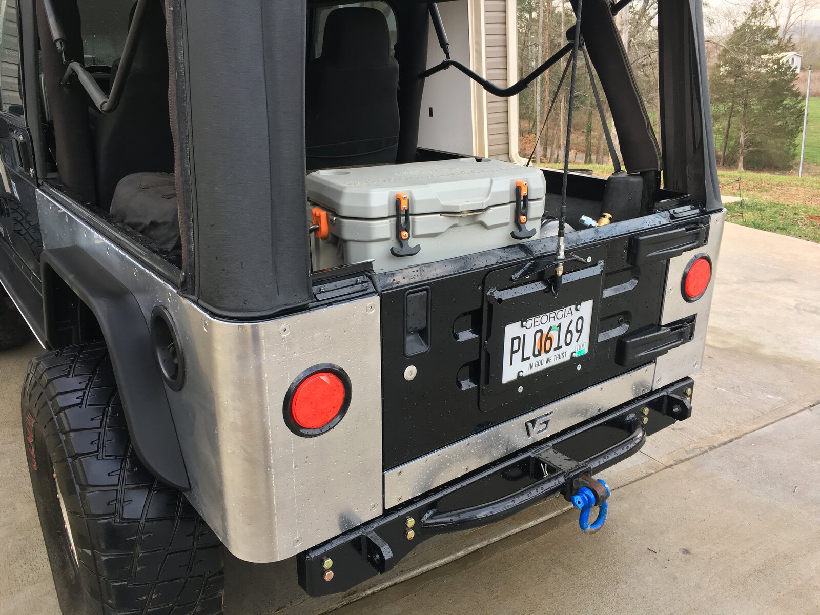

On one wheeling trip I managed to catch the rear corner on a tree, caving the corner in slightly. I pulled the corner out best I could but knew it would happen again. Time for rear corner armor. Rather than making tooling to build them myself or bump forming them I went to Stout Fab and they built a set for me form 3/16" Aluminum. Fit was great and cost was far less than anyone else.
