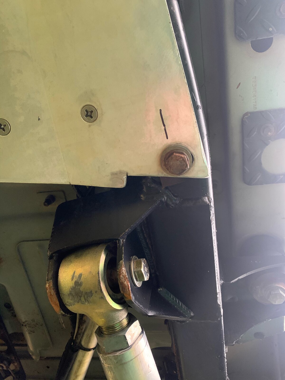

If I cut in front of the bracket I am now into the bend of the frame
@mrblaine in the case of someone already having the mid arm installed, with the front of the bracket right at the bend in the frame, would you prefer to cut the frame and deal with the bend or remove the brackets, stretch within the straight part of the frame and reweld the brackets on?
Deal with the bend, it isn't hard to deal with at all.
Does this involve bending the extension pieces to match the angle of the frame? I’m assuming this is what is referred to as dealing with the bend. I could be thinking about this incorrectly.
The frame extension would start after the bend. The inner and outer plates that overlap the bend would match the bend.

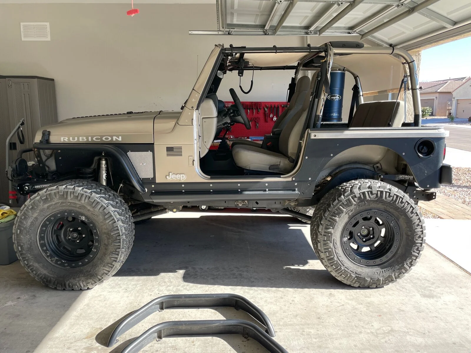

Got the rear fender flares off this afternoon, now I'm just waiting on the GenRight Boulder 0" front fenders to complete the no fender flare look. I think this will fair better in the rocks, as I have been pretty close to smacking the flares themselves on rocks and I know they aren't going to bend nicely like plastic will.

I once told a gent who was intent on going to JV that he really shouldn't run the high line version of what you have now on the front. He looked at me in a way that says "yeah, I hear what you are saying, I'm going to ignore you though". First run to JV we ran a trail known for taking out your hood. When we got done getting him through, the flare was pushed in until it was flush to the side of the tub. Genright would not warranty it nor would they sell a single fender.
Flares and rocks don't mix.
With the flares off, you can see the next product I wanted to do for Savvy. The slider needs to go wheel well to wheel well with both ends tapered back at a 45 degree angle from the long point.

I can see what you're saying 100%. A few weekends ago when I almost went right into a rock, the flare was the very first thing that was going to hit. It was right then and there that it clicked in my head why you (and many others) don't like anything other than plastic flares.
I've watched @starkey480 hit his flares a number of times, but being plastic they bend easily without inherently wanting to take out the sheet metal with it. Still, with enough force I imagine they will damage the tub even being plastic.
I get it though 100%, flares and rocks don't mix.

Never realized how square your tires are lol
Probably just the profile of those Nittos. When they go bad I'll replace them with MT/Rs, but so far I don't have any complaints about them.
