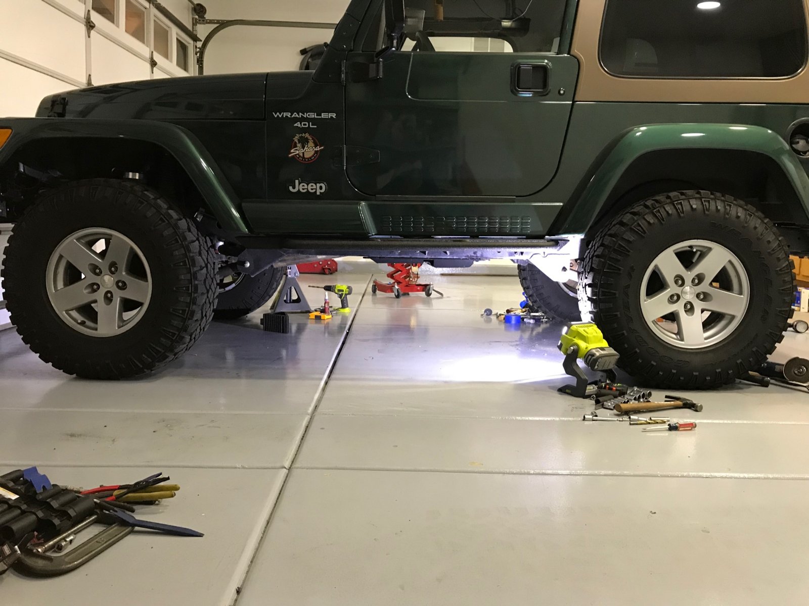

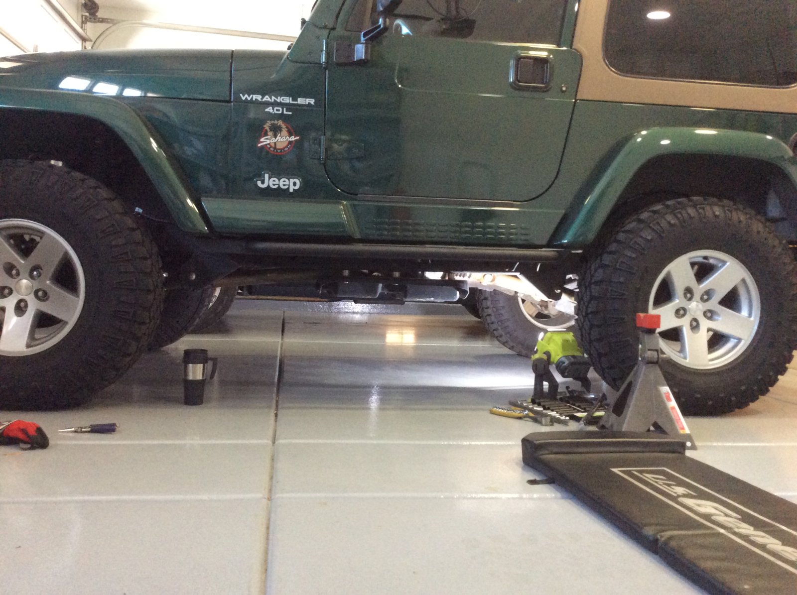

Nth Degree Tummy Tuck Install
Todd, sweet right up. Im wanting to do a tummy tuck and a 2-4" lift on my 04 Rubicon 5 speed. But Im allergic to the idea of a body lift. Did you not have to lift the motor?

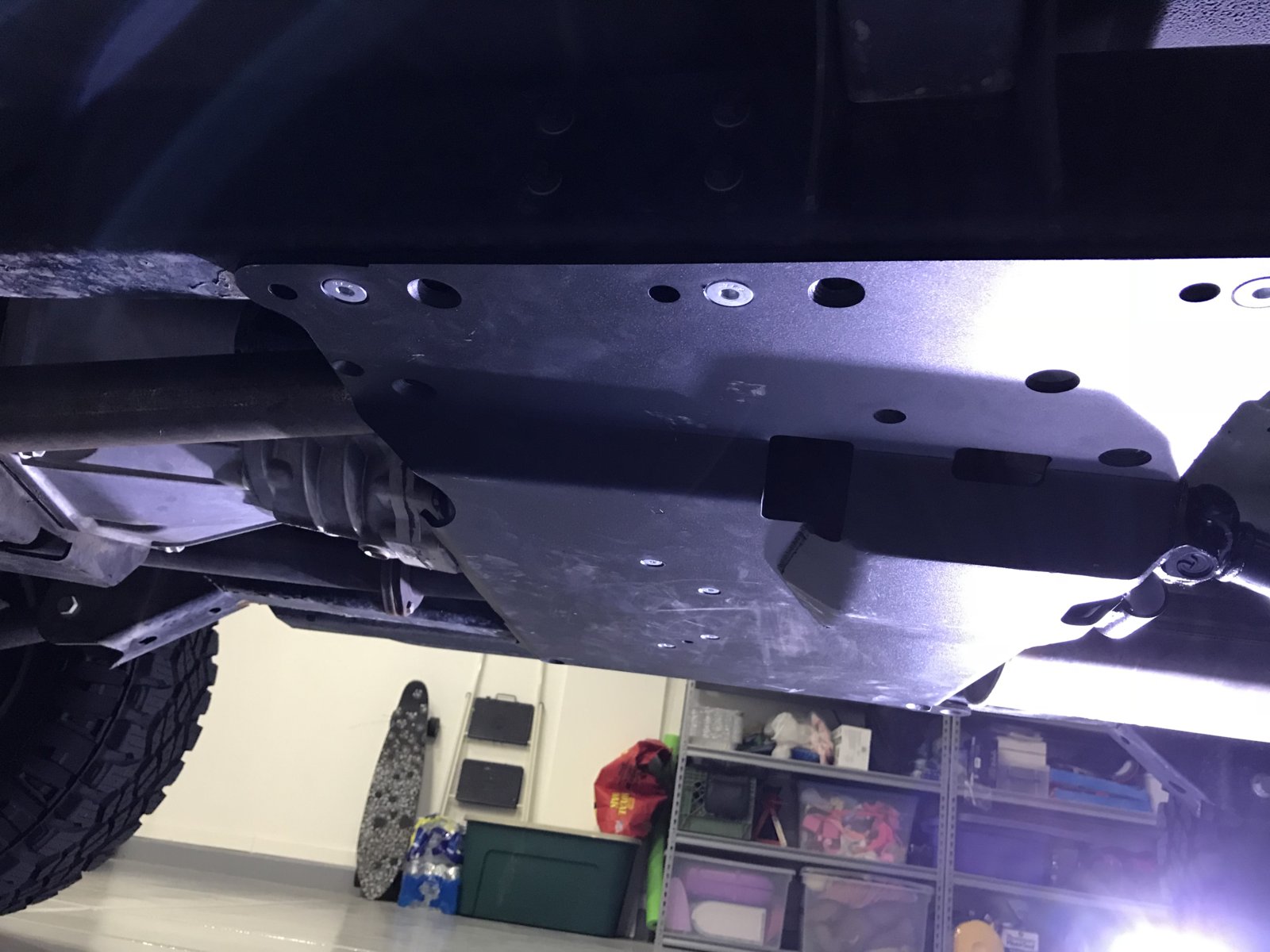

Thanks, that’s good to know too. Back then when I did my TT, it was a DIY, without the case bump welded in.
Nth Degree left that up to the TJ owner who runs the Atlas II depending on how it’s clocked.
In my case, with a 1” BL, I was able to clock and tuck the case with no body massaging needed thanks to those low profile mounts.
