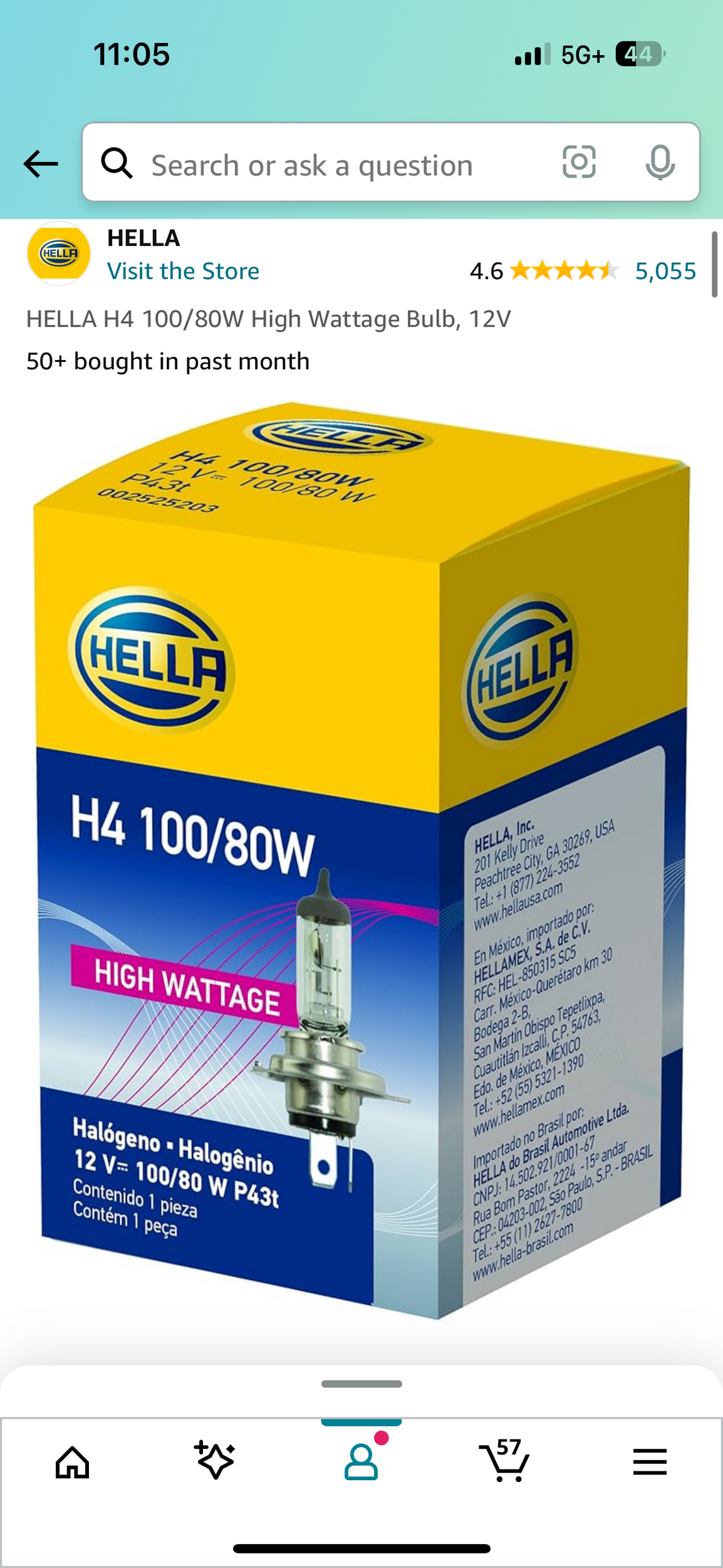

If anyone needs them I found them on Amazon for more. Depending on shipping from quadratec the total cost might be the same.
Hella H4 100/80 W
