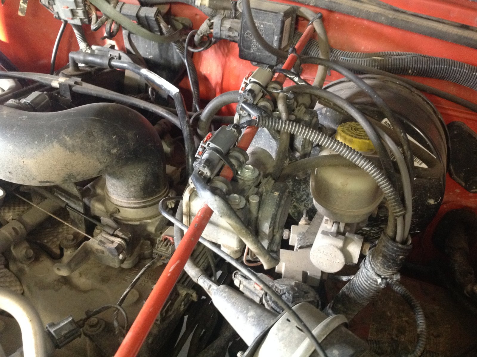

I went down to the starter feed connection. I had to ream the harness connectors out a bit. Got ground right nearby on the frame. All is working good with this and the lites look plenty bright to me. Glad I got the kit.

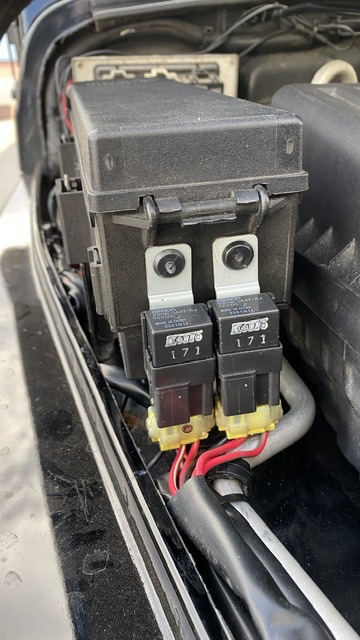

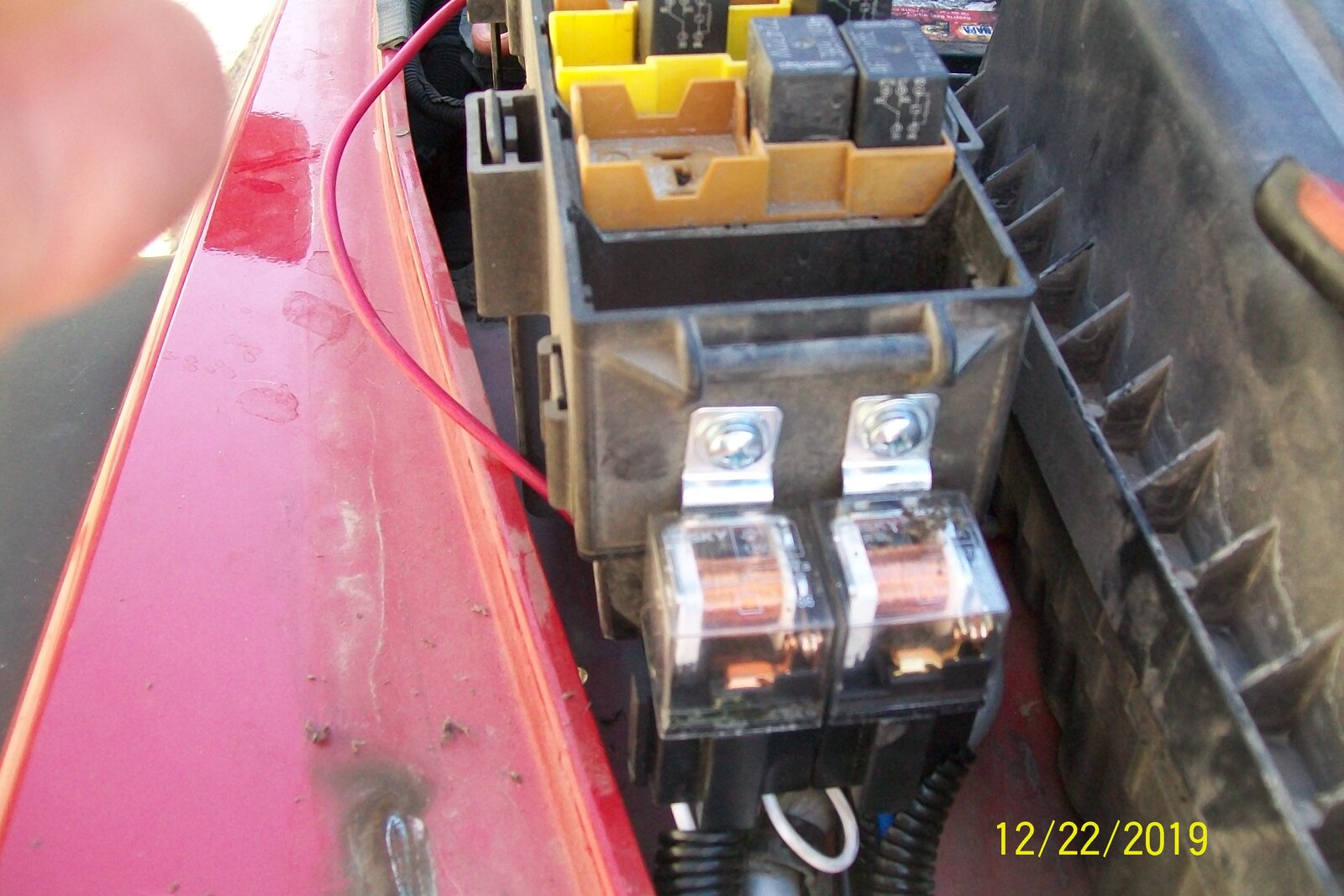

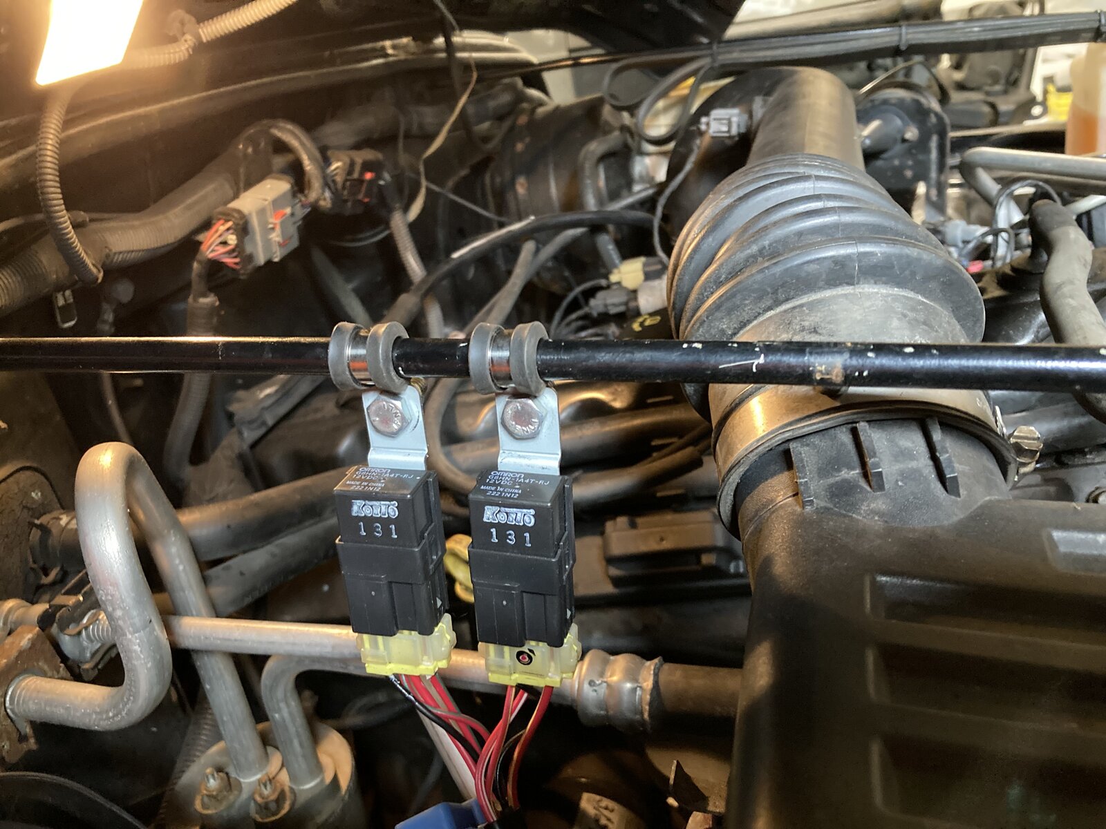

Also, where exactly are y'all mounting the relays?

Nobody else has mentioned it. As for the relays, unless you are using 100/ 80 watt bulbs, you don't need them. However, I mounted mine here:

Page 3 shows in the link below shows where I mounted my harness and relays. Basically I just put them on existing bolts by the passenger headlight.
