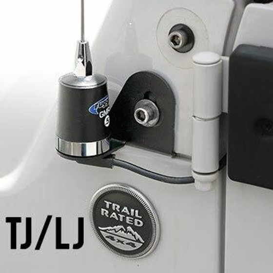

Mounting GMRS antenna
Flipped the brass disc over and tightened it down.
The stubby antenna is a 3db and the whip is a 6db. And according to Midlands website the higher the db the better the antenna.
Do those mounts require the hole to be free of paint so that it grounds well, like a CB antenna mount? Just curious for when ever I add a GMRS radio.
I have one of the 6db antenna's that I got for cheap a few months back.
That is certainly antenna theory. However, if the stubby antenna lets you communicate with everyone you need to communicate with, and if you don't particularly care for the longer antenna hitting overhead obstacles, the stubby may actually be the better antenna for you.
Antennas are very much about real world experimentation.
Ours are not free of paint. The base piece (silver) has little teeth on it, I am not sure if that is to help create a ground on the mounting bracket it help hold it in place. So far our little stubby antenna works fairly well. I am thinking about getting the 6db for the TJ.

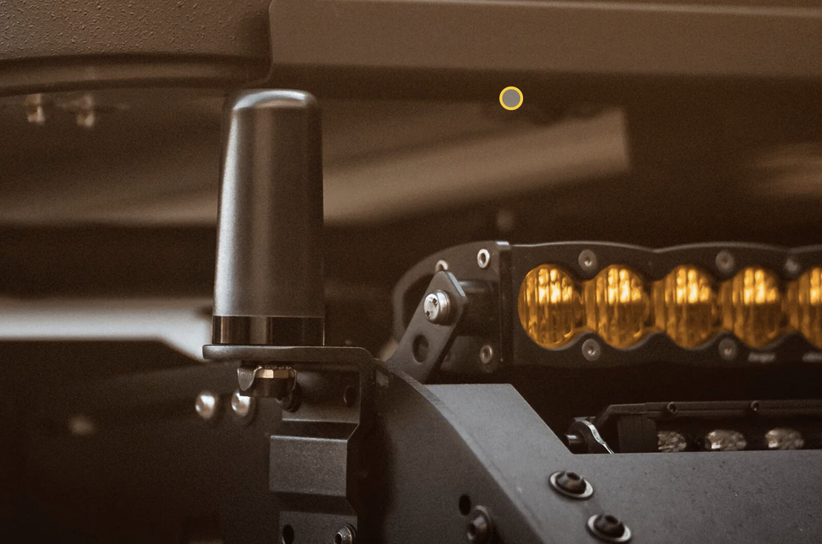

IMO it’s not about the range as I’ve never had range be a limiting factor. I run a fairly small antenna. I’ll find a picture.
Here’s a pic, don’t mind the random guy in the background. The antenna is on the left tail light mount and it’s from Rugged.

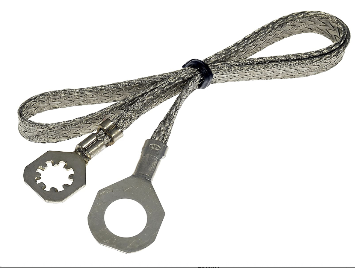

That should work for you now. You can also buy tinned copper braid and crimp on your own ring terminals rather than be limited to pre-made lengths.

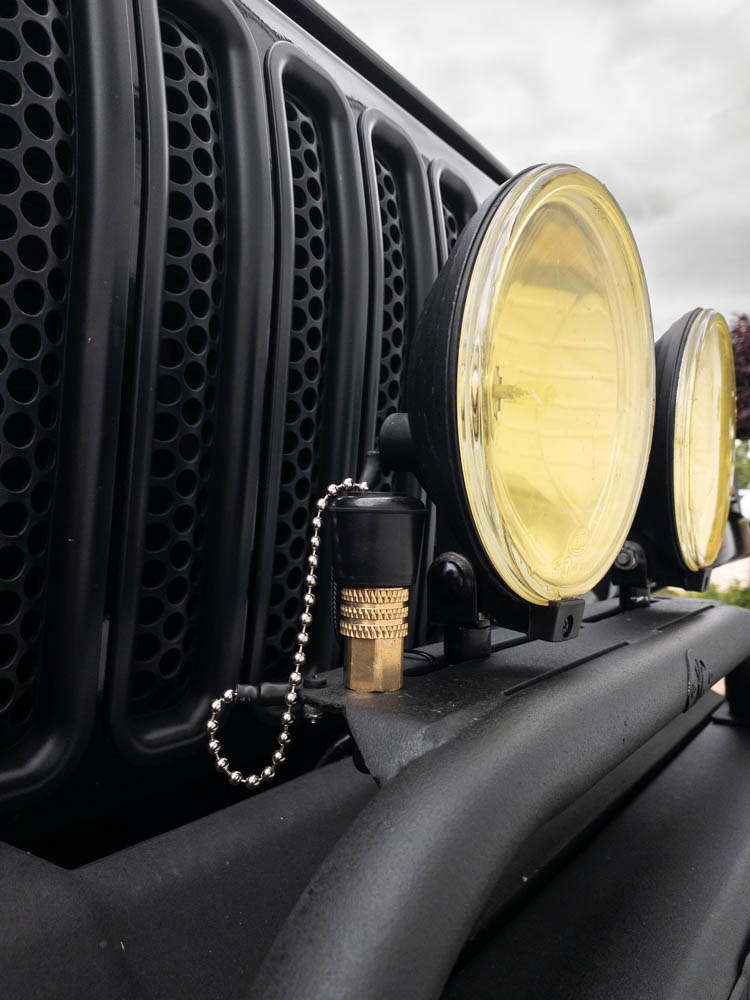

As for front mounted antennas, I am not a fan. It is a personal preference. I don't like antennas banging on my grille, hood or fenders when they hit a tree branch or something else. I also don't like mounting anything in a location that can interfere with my forward vision.

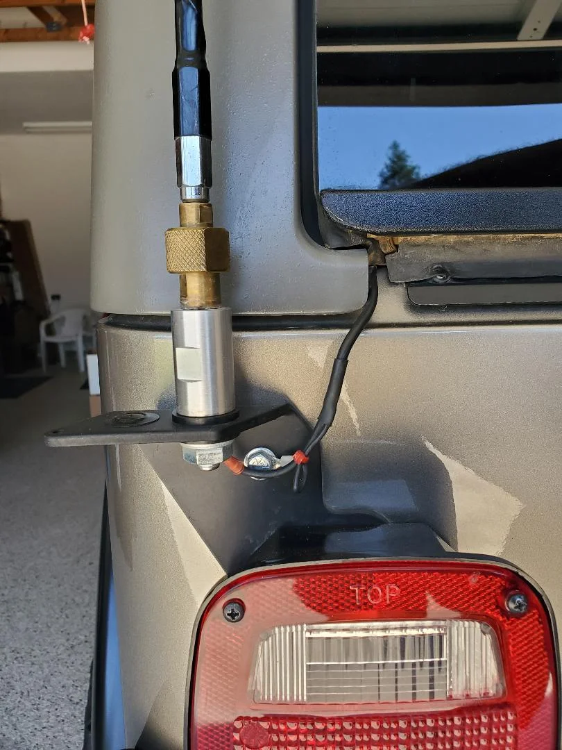

These are my antenna mounts:
How are those mounts grounded to the body? I have been using the same mount for my CB, and sanded off a little paint on the back of the bracket and body where the taillight bolts mount. But......it rusts over. Looking for a better grounding of that mount.
I sanded to bare metal around the bolt holes of the antenna bracket and around the corresponding holes in the tub. In addition, I ran a short grounding strap inside the tub from one of the antenna mount bolts to a nearby bolt, again sanding to bare metal at all connection points.
Reactions: Apparition
Thanks. I sanded mine exactly the same. I have to re-sand it every couple of years as the bare metal rusts over.
