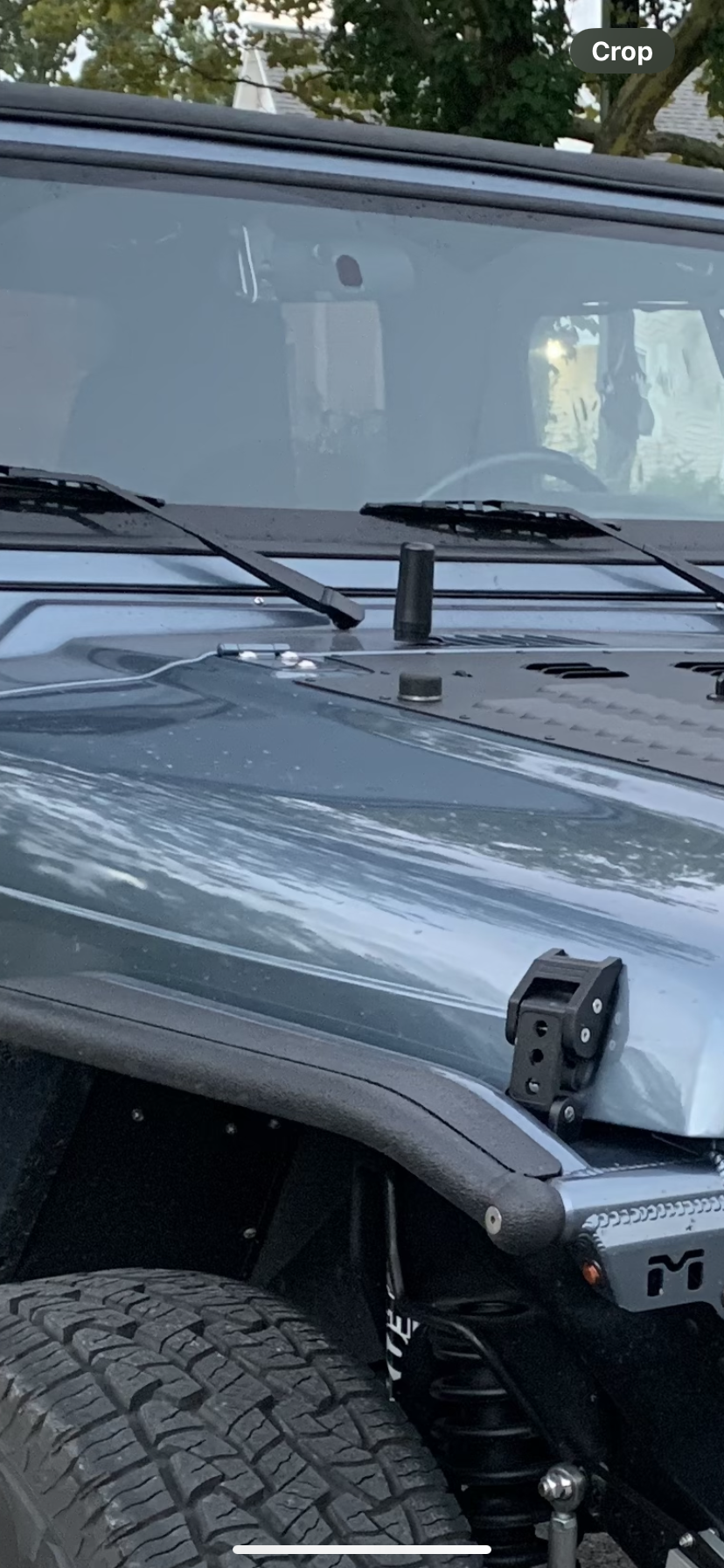

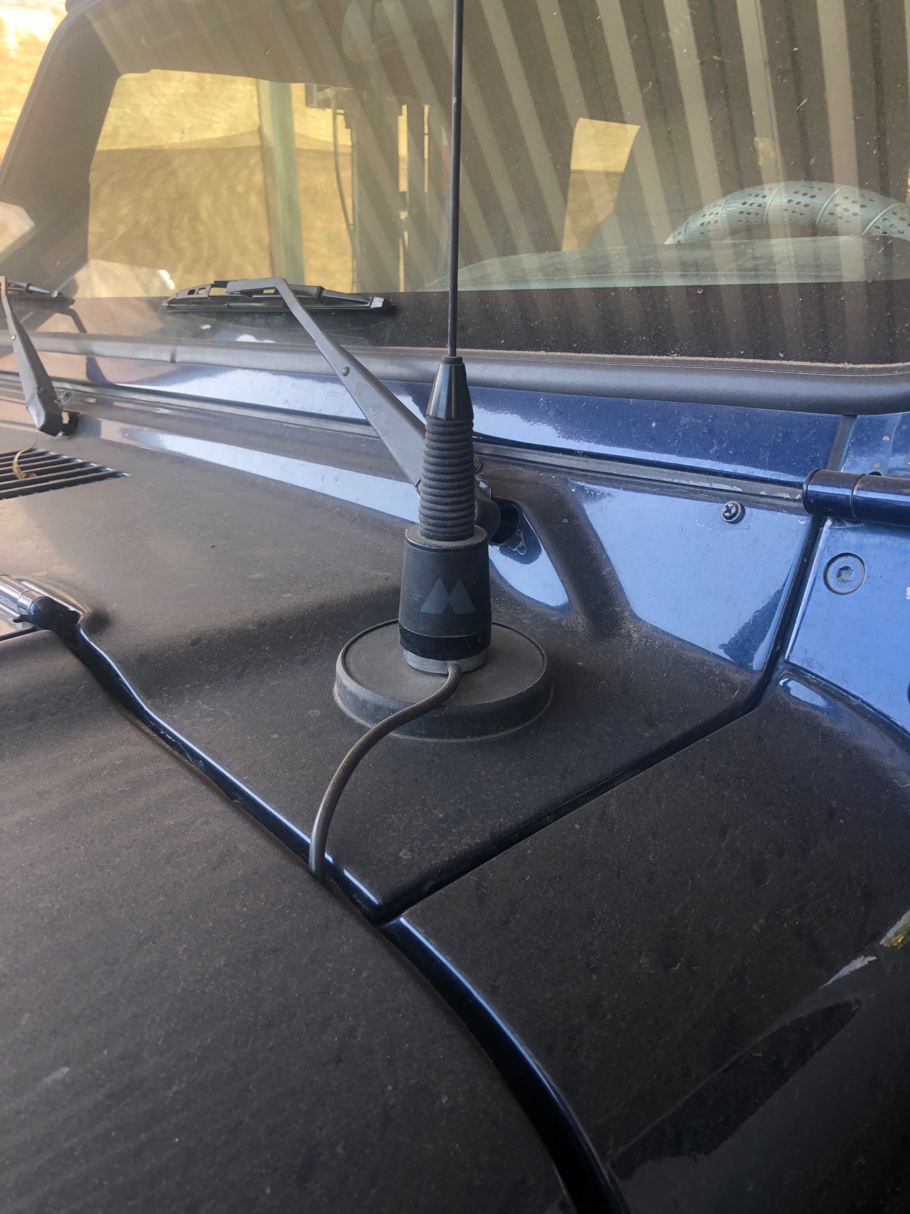

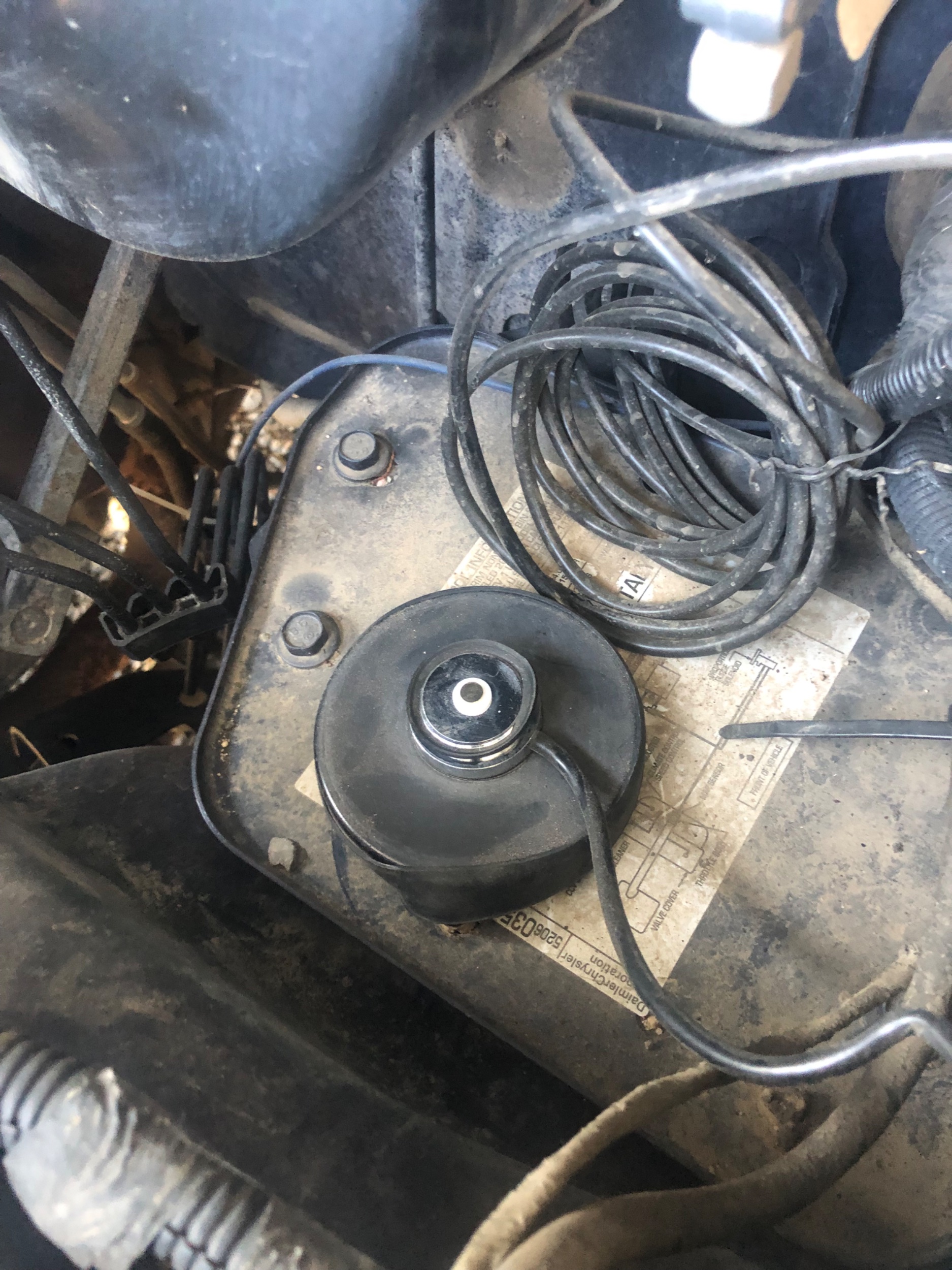

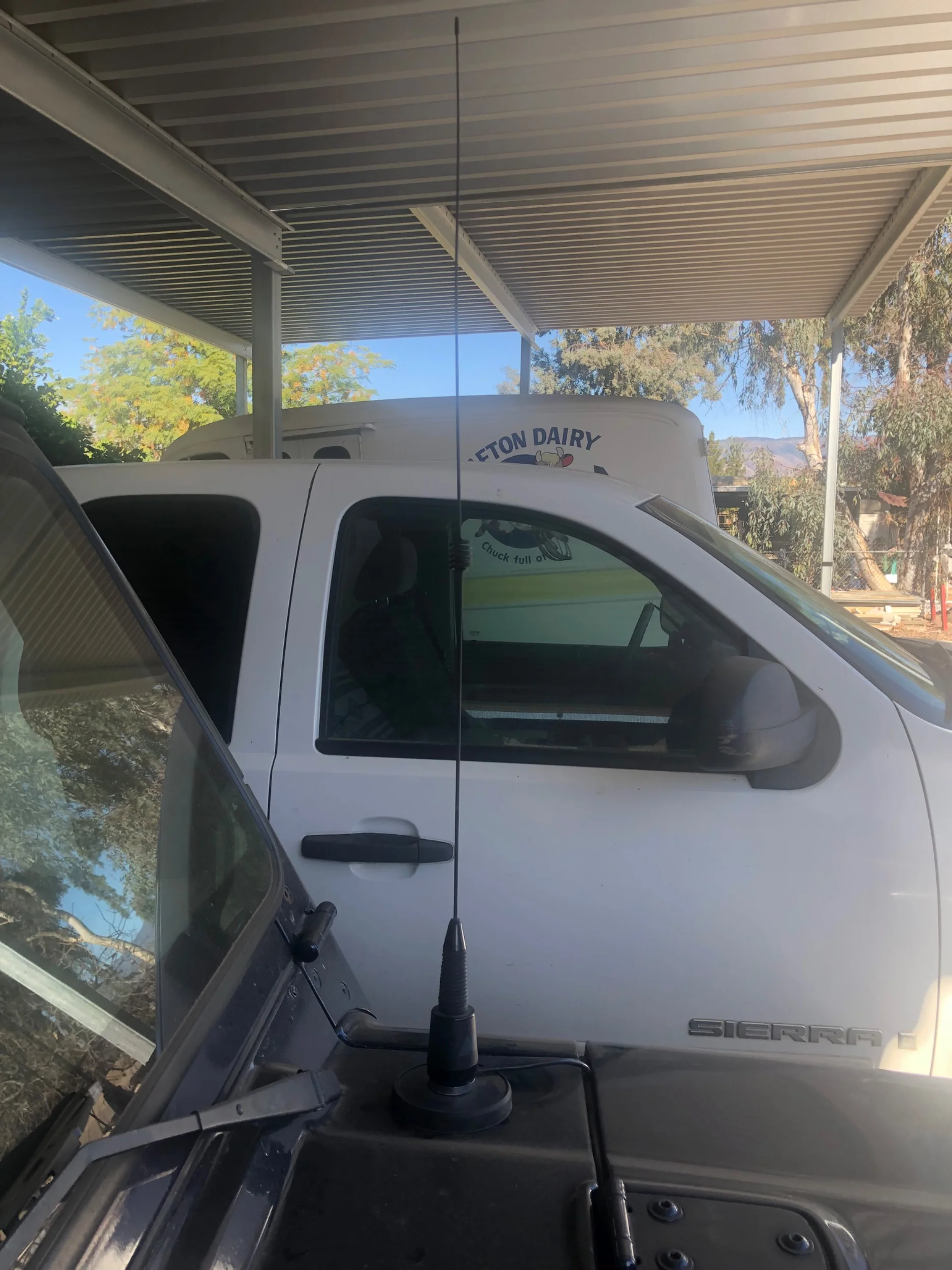

I mounted mine on the cowl and ran the cable through the wiring harness grommet. The base stores nicely on the plate in engine compartment when not in use.

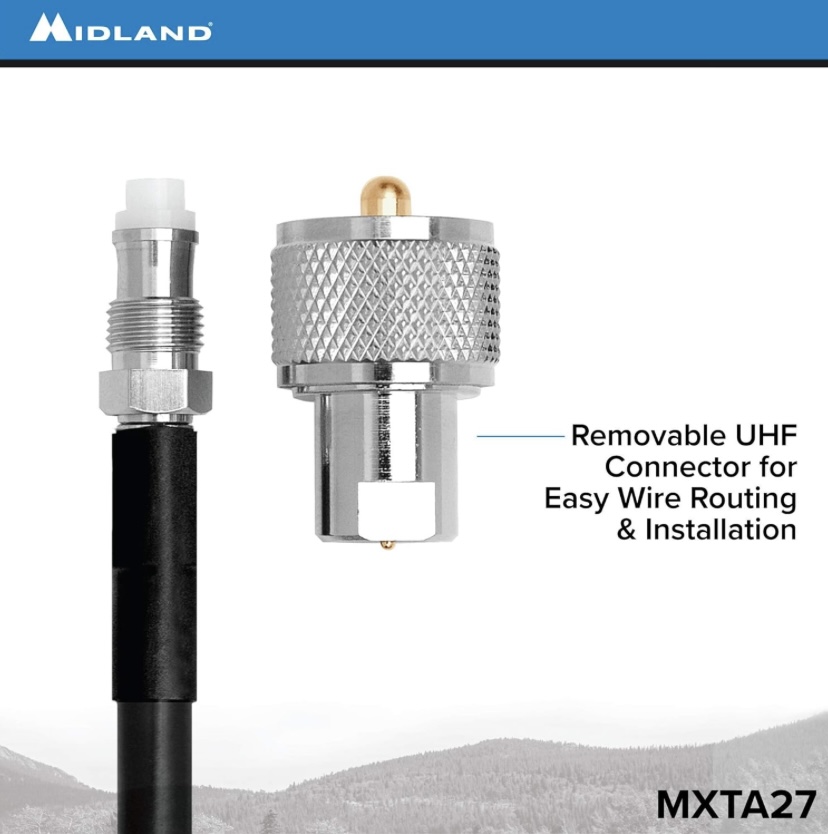

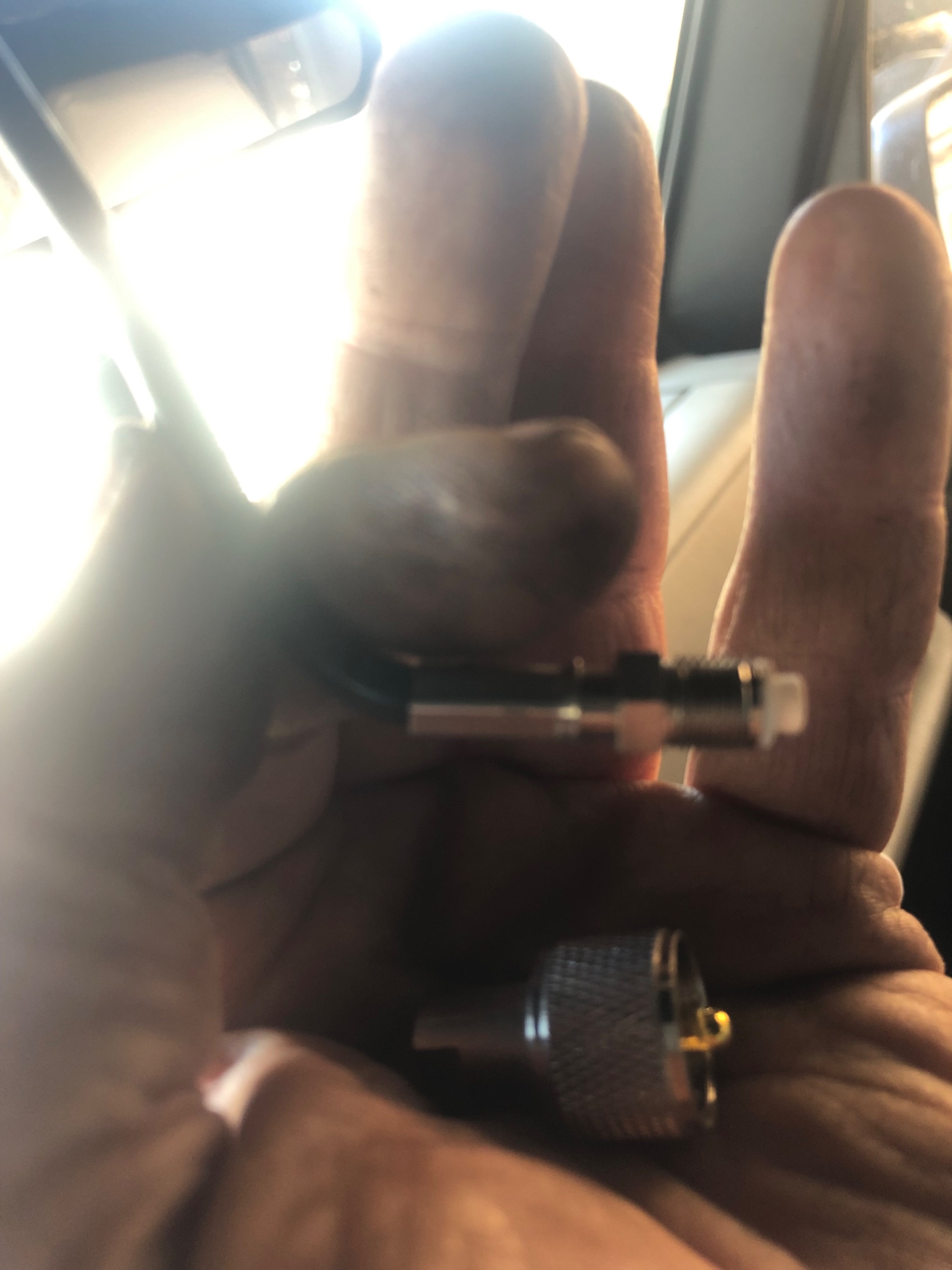

As for the OP, check the existing connector and see if its the type where the outer shell will thread off, leaving a much smaller inner core that you can fish, then screw the shell back on.

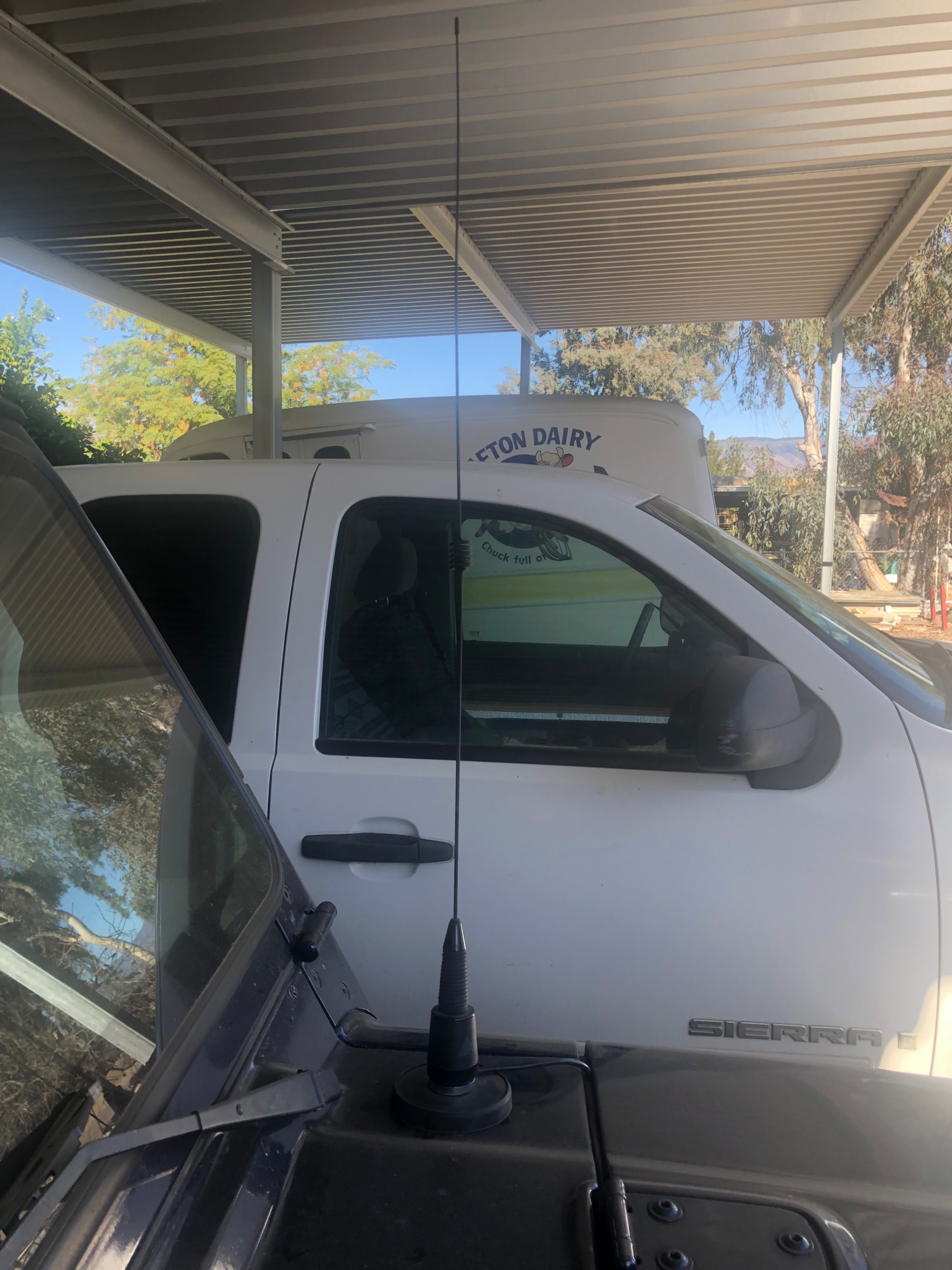

I have the same base the connector comes apart and allows easy fishing through a grommet. I kept the cable full sized and just coiled it up. My Midland MXT500 works fine with this setup.
It’s a MXTA51 base with 6” antenna. It came in the box with the radio. I upgraded to the MXTA26 6dB antenna.
The MXTA12 base has a different connector and I don’t know if it comes apart like mine does. Seems like it has a rubber cap on it.

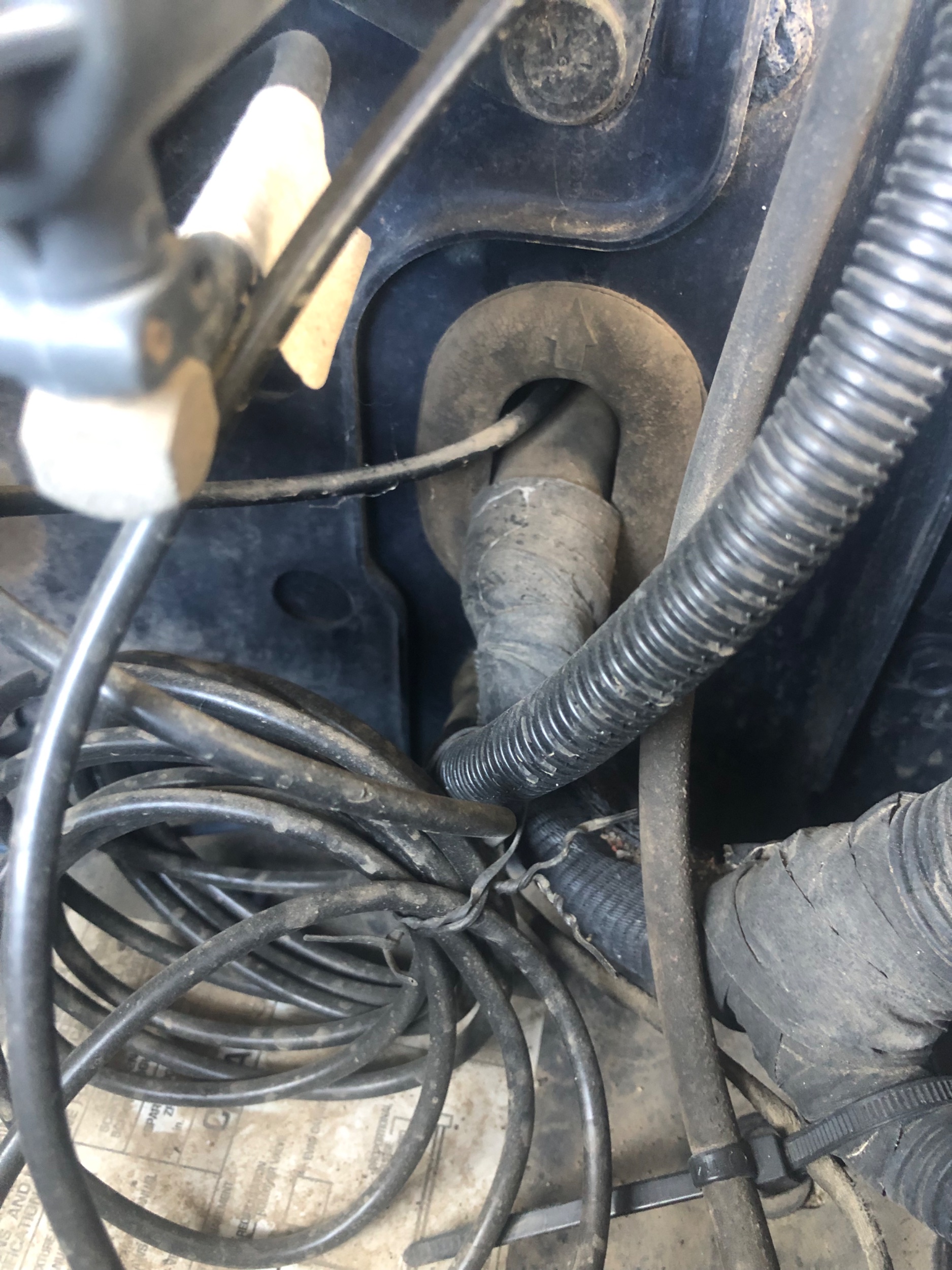

Ran antenna cable through windshield wiper harness grommet. My Midland radio is mounted under the steering column. And the cable ended up being a fairly straight shot into the back of the radio. I cut out the excess cable, so I wouldn’t have any coiled up.

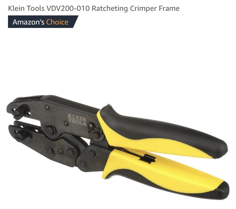

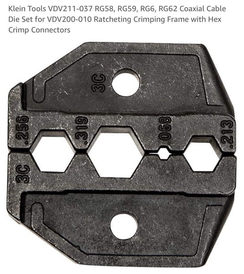

The pliers I used to crimp the cable ends…

I used an 1/8” piece of plastic underneath, where the set screws tighten down. As not to chip the paint and cause corrosion.
Some will tell you that the set screws need to touch metal, to complete a ground.
That is not the case with this antenna mount.
Mine works perfectly.
