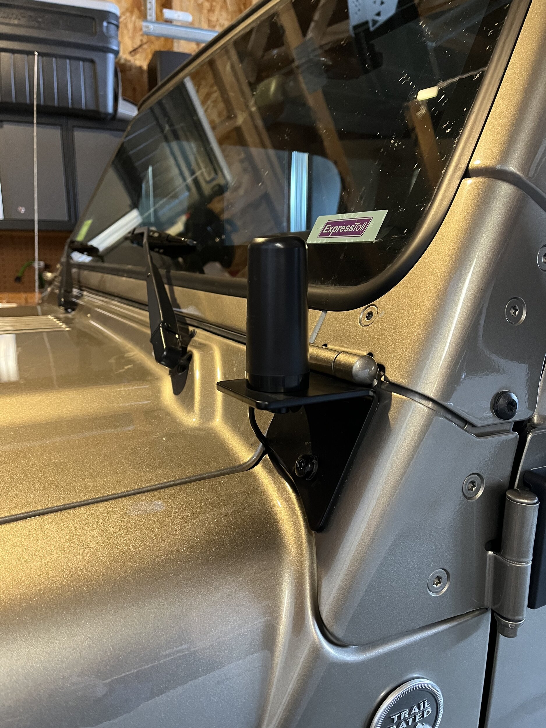

I installed the 3dB ghost antenna on a windshield corner light bracket. It receives well and I hear a lot of conversations on the local repeater channels. I have made a couple of radio checks and have received responses, but haven't had a chance to try it on a trail run yet.

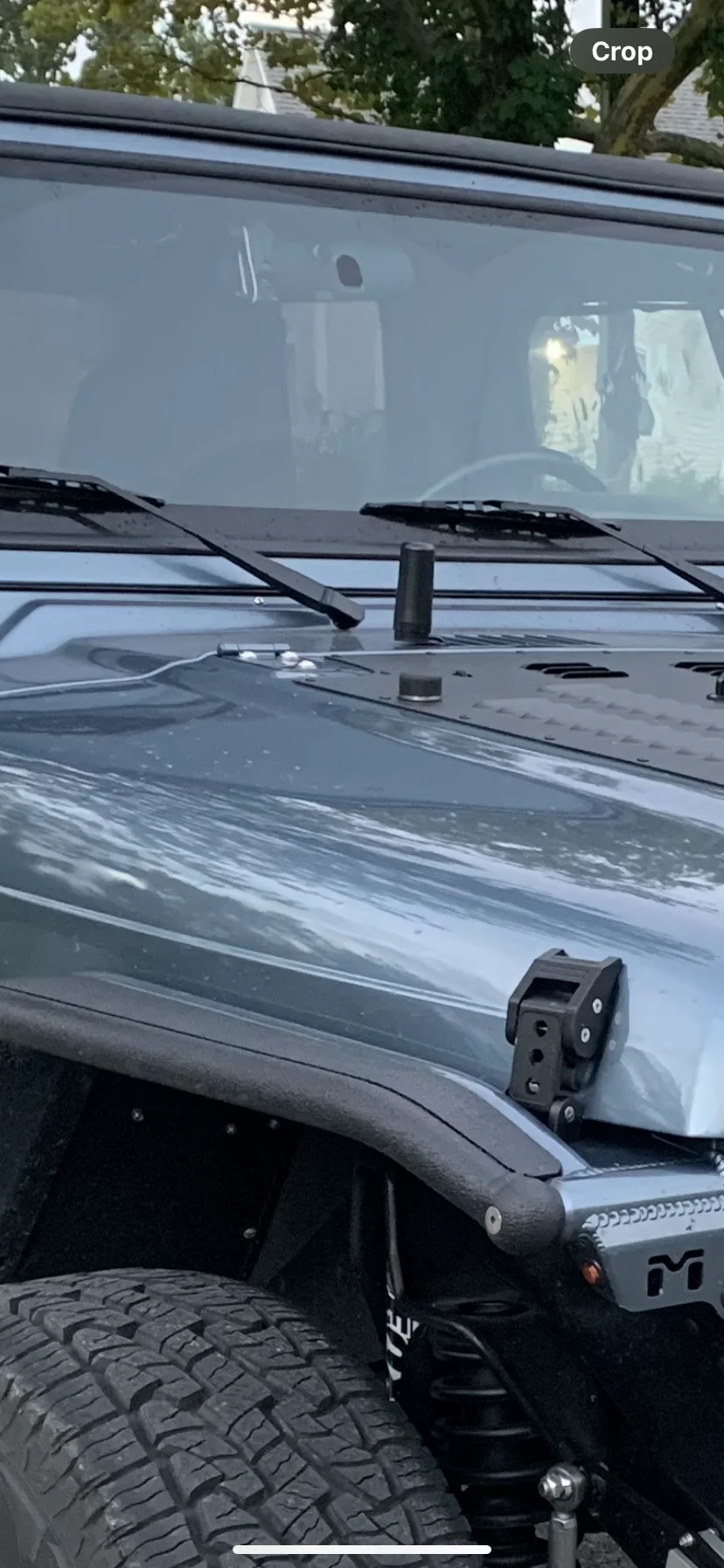

Mine is a Midland 3dB gain Ghost Antenna. Mounted on my cowl. Shocking how far I can reach. Several miles on relatively flat’ish terrain. Sounds like they are standing right outside my door…

Yea - I was looking at that thing. Just don't want to induce rust with the grounding screws.
They are just set screws. No need to take them to metal. I have a thin rubber/polymer piece that is under the cowl that I tightened them into. No paint was harmed. Works like a champ…
