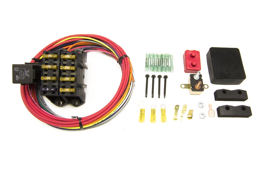

Painless Performance CirKit Boss
Power and ground direct to battery. Adds seven additional fused circuits.. three hot & four ignition switched.

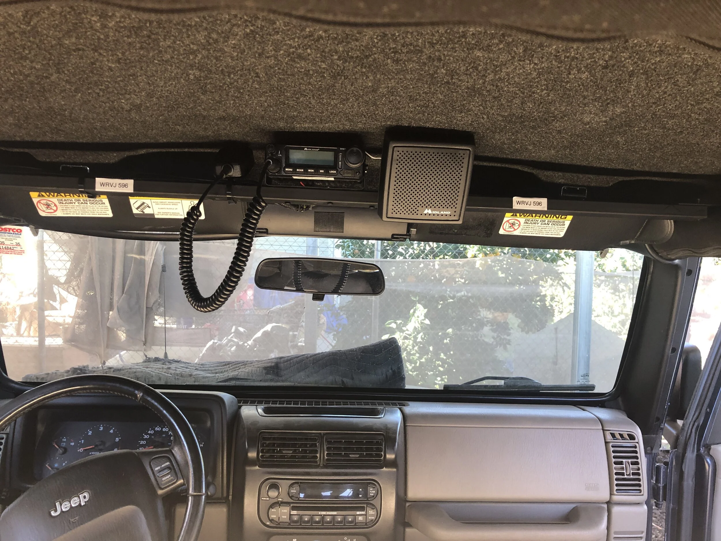

Up and running. For now antenna will be hood mounted and I’ll order an A-pillar mount later. I’ll pick up a retractable mic holder at Pilot on my way out to Anza Borrego next week.

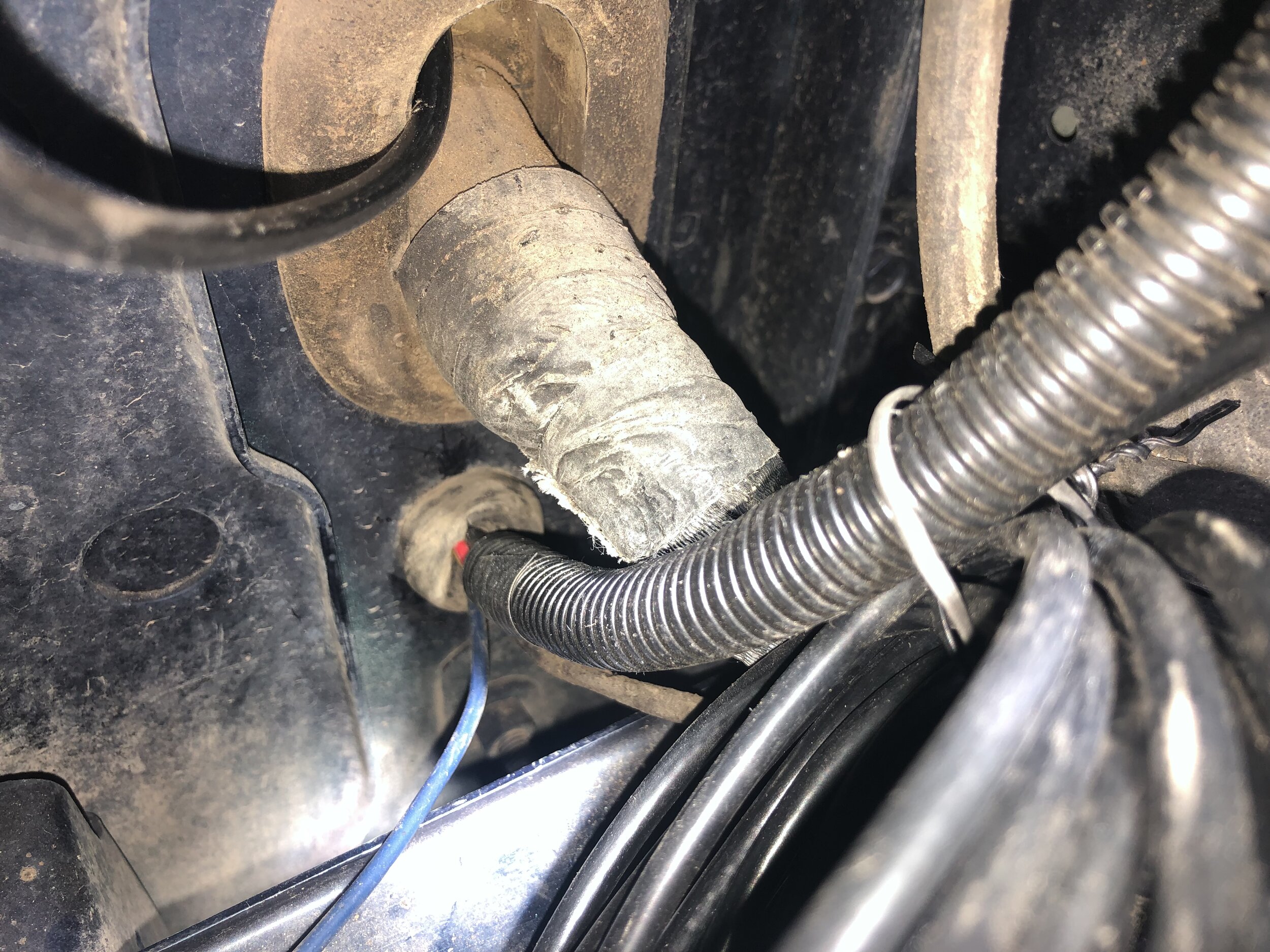

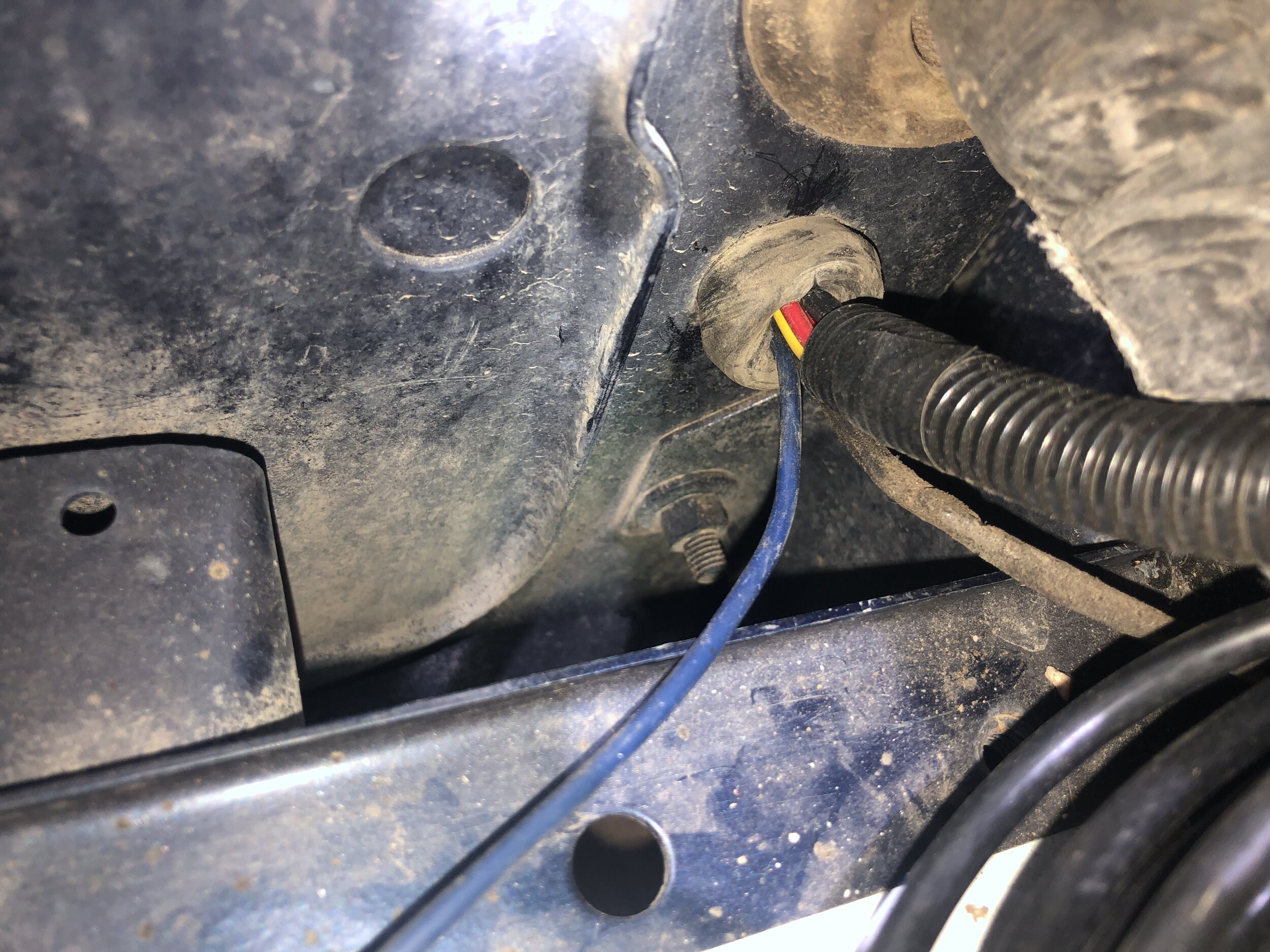

I apologize if I missed it.. what route did you end up taking through the firewall?

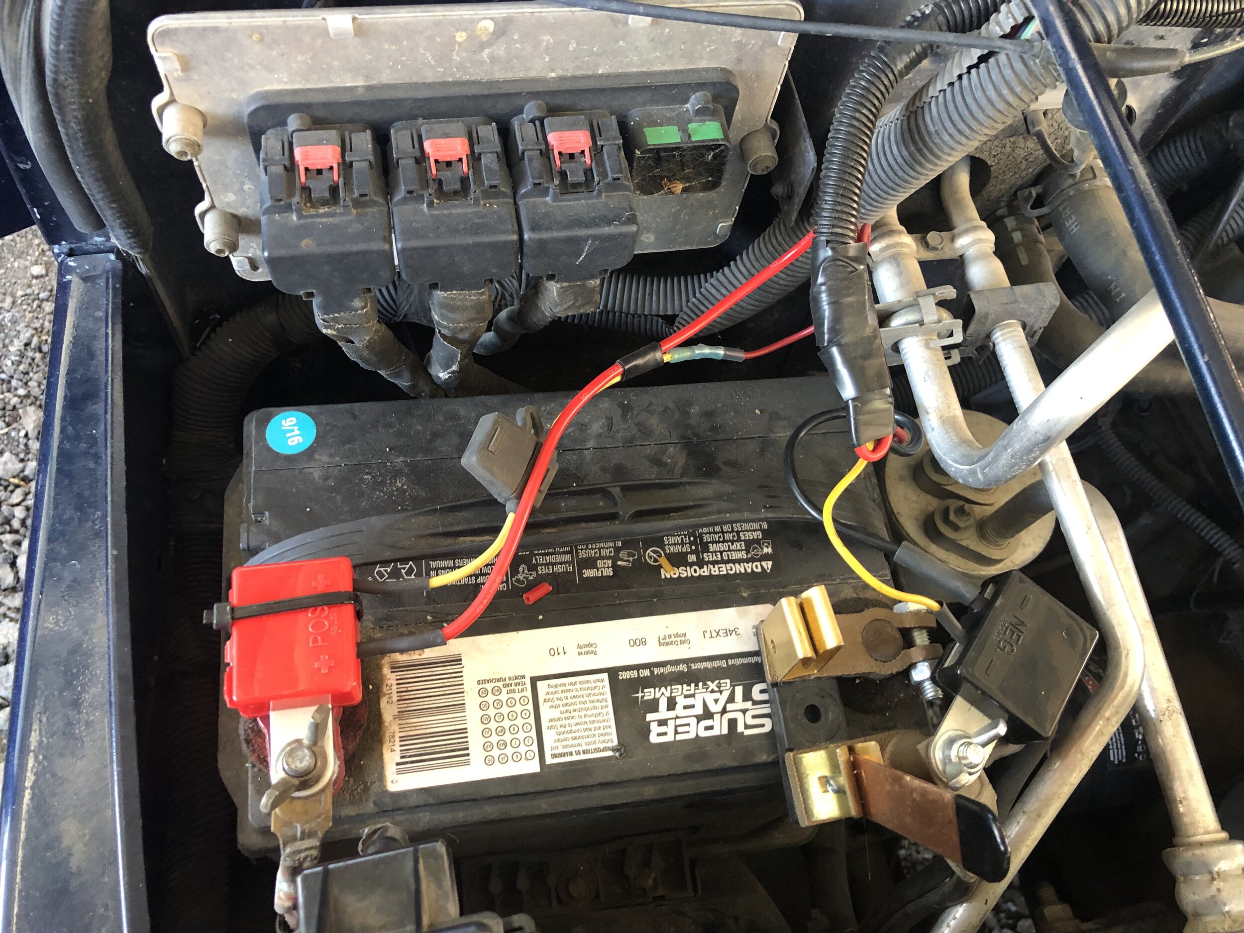

And what are you using the huge on/off attached to the ground side for?
When I installed a CB in my TJ I just used a fuse tap and the nearest ground. Later I heard that was not the best way so when I got the LJ and moved the CB over I ran relatively heavy pos and neg wires through firewall directly to battery in a 4 fuse block like pictured above. I could tell no difference in performance.
@bucky
Battery switch is used because as the TJ is a toy it sits for long periods of time and it prevents parasitic battery drain. I use them on my YJ, tractors and forklifts. Adds some level of security also. Originally I was going to tie into the fuse block but the Forum advised me not to. 50 watt radio take a lot of juice. I did not want to risk drilling the firewall so I went to the drivers side. The antenna went through the main wire harness. The power and ground went through the factory grommet below then through plastic loom across to the battery. Easiest part of the job. I just ordered a low profile antenna cable from Midland and am researching which mount to buy to mount on the a-pillar. Everything works for now but the a-pillar mount will illuminate the exposed wire on the hood. Also I used 10ga wire to splice onto the factory wire.
