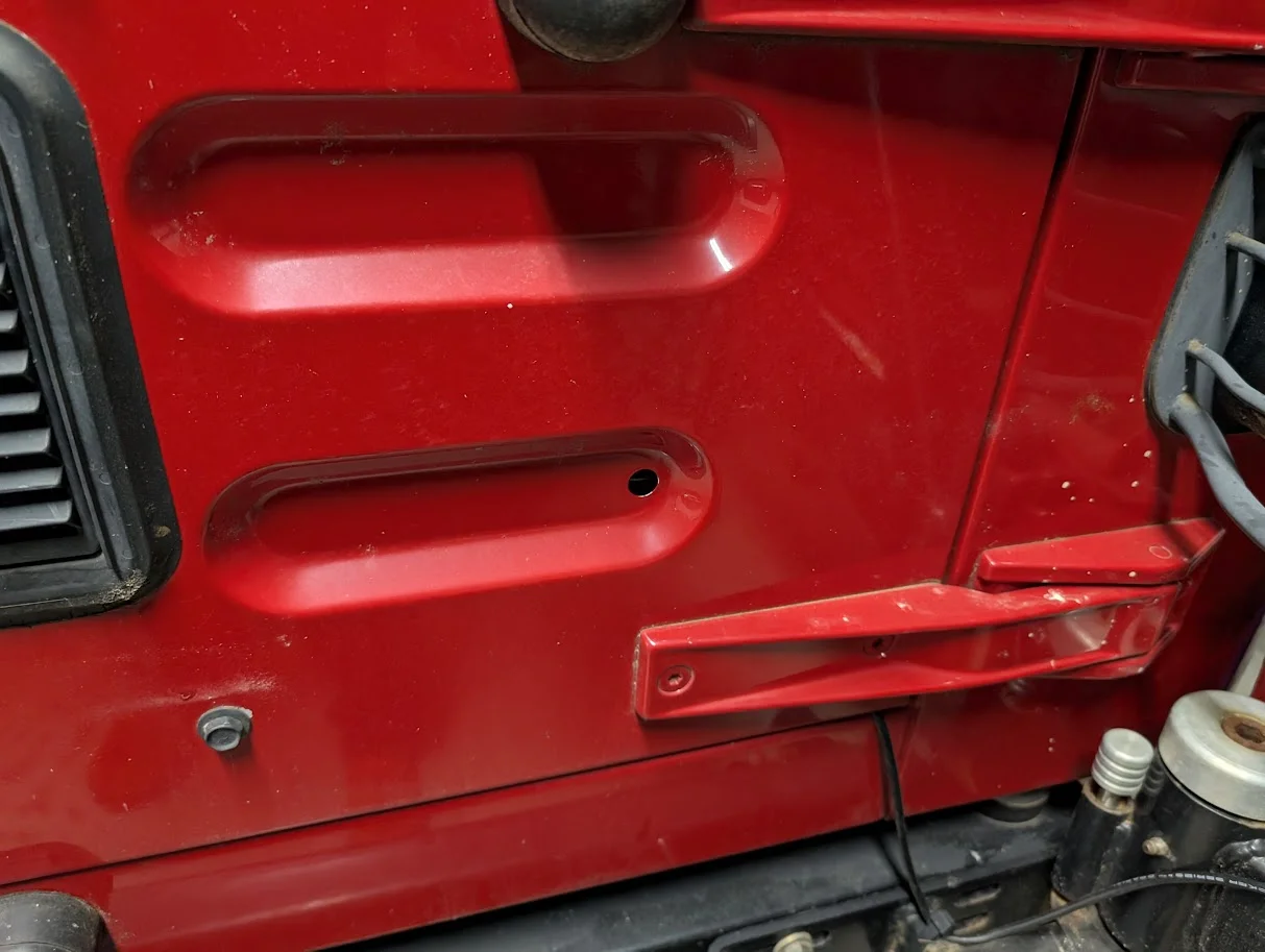

I mounted mine on the cowl and ran the cable through the wiring harness grommet. The base stores nicely on the plate in engine compartment when not in use.

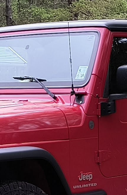

Where my Midland 3dB Ghost antenna is mounted…

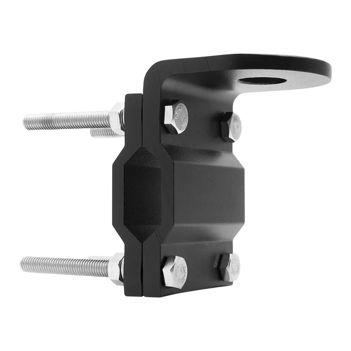

Mount I used…
Ran antenna cable through windshield wiper harness grommet. My Midland radio is mounted under the steering column. And the cable ended up being a fairly straight shot into the back of the radio. I cut out the excess cable, so I wouldn’t have any coiled up.

Works superbly!

Mount I used…

I have one of those panel edge mounts on the shelf, did you just slide it into the cowl vent?
Also you're making me regret not ordering my metalcloak fenders raw and having them powdercoated flame red to match the jeep
Essentially, yes.
I used an 1/8” piece of plastic underneath, where the set screws tighten down. As not to chip the paint and cause corrosion.
Some will tell you that the set screws need to touch metal, to complete a ground.
That is not the case with this antenna mount.
Mine works perfectly.
