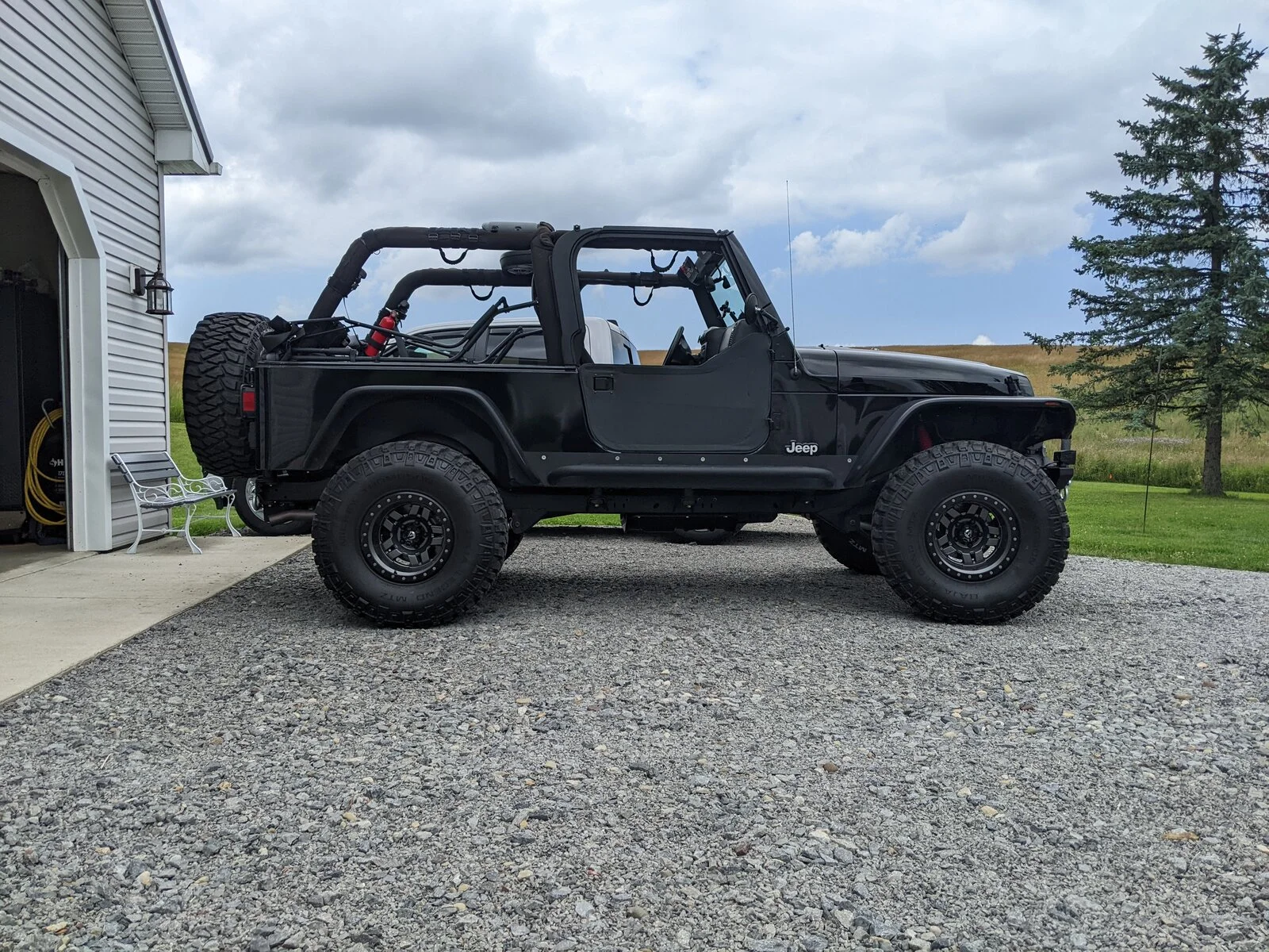

I added the black magic brake body lift and jks motor mount lift. That allowed me to get rid of the transfer case drop. I drove it above 55 mph with no unusual vibrations. My currectlync steering is coming today, and my teraflex belly up skid should be here Monday. My plan is to install those on Wednesday. I'm going to use the alignment info from this forum to do the toe in using square tubing and clamps. I did have some issue getting 4 low adjusted so it wouldn't pop out or grind when being engaged, but I think I may have got it 🤞 (I'll have to do it again with the belly up pan anyways). I don't hate the aesthetics of the body lift as much as I thought I would. Before and after photos included (before no doors).

Final update on the changes. I added the belly up skid plate and the currectlync steering. The PO had cut the exhaust at the transfer case, so right after I bought it I had an exhaust built for it. The shop had tucked it up close to the body for clearance (good at the time). With the belly up, the exhaust was extremely close to the body. The Jeep also got a bit of a vibration right around 2000 rpm's (I'm sure it's the pinion angle). I added the tcase drop back on it (still about 2" more clearance than stock) until I can cut the exhaust mount and reweld it, as well as get a SYE and new drive shafts. I'll likely rebuild the tcase then too and install chromoly axles. It'll give me some things to look forward to this winter. As for tire clearance, the body lift and adjusting the bump stops seems to have given me the room to not rub with what I do.
