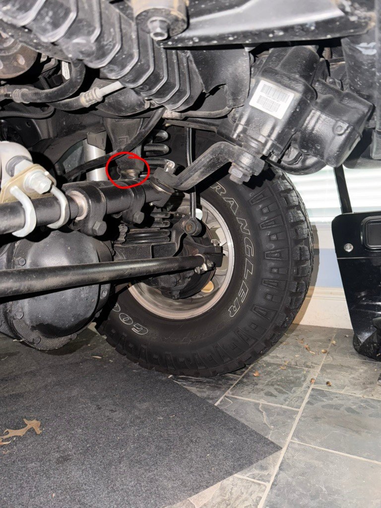

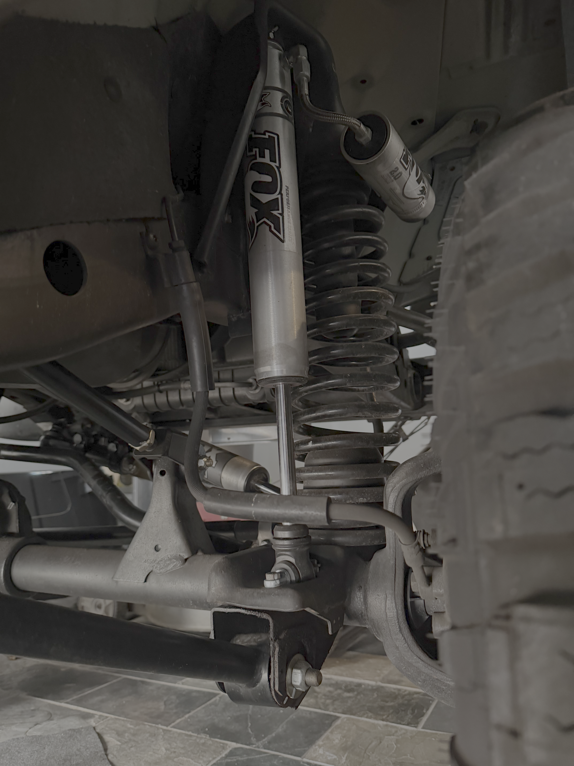

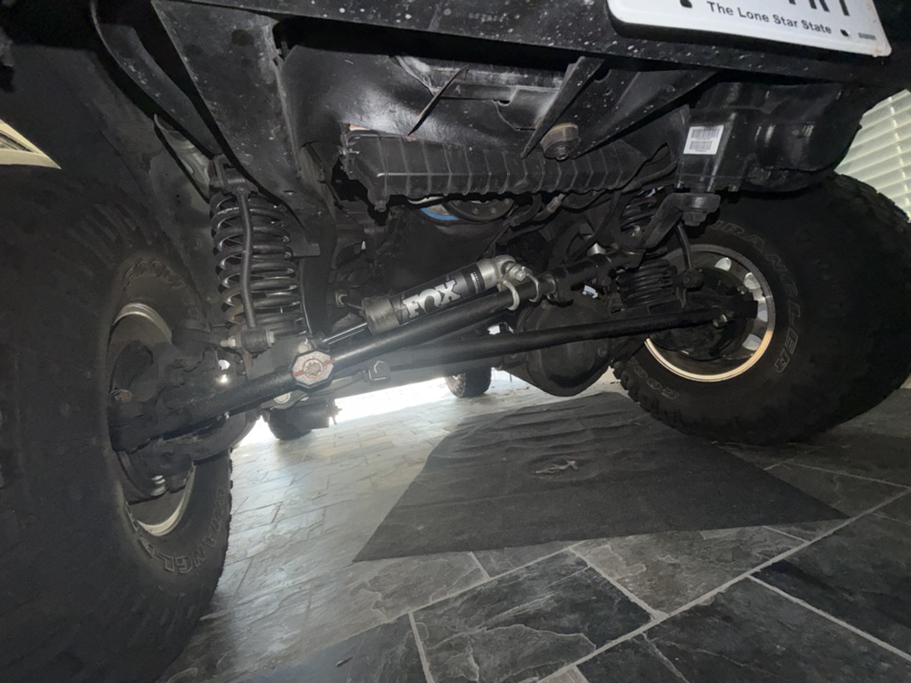

The track bar at the frame mount would benefit from being straightened out.
Thanks all and sorry for the late reply! This does appear to have a drop pitman arm as you all suggested. The shop didn't mention anything about the pitman arm. Not throwing anyone under the bus. Totally my fault. I should have been the one to research more. Now that I see this, it appears this is a pretty widely known issue in the community.
